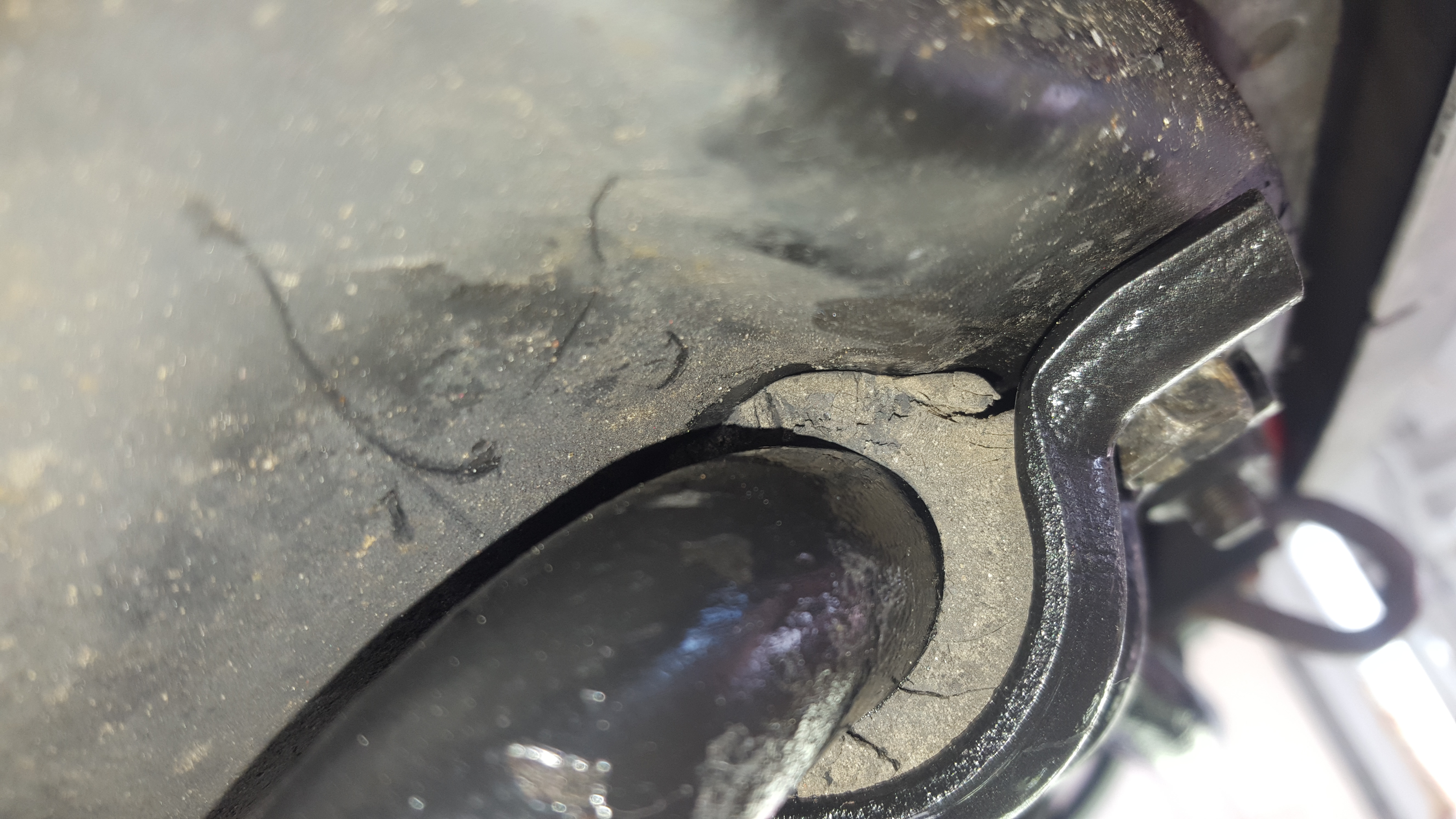

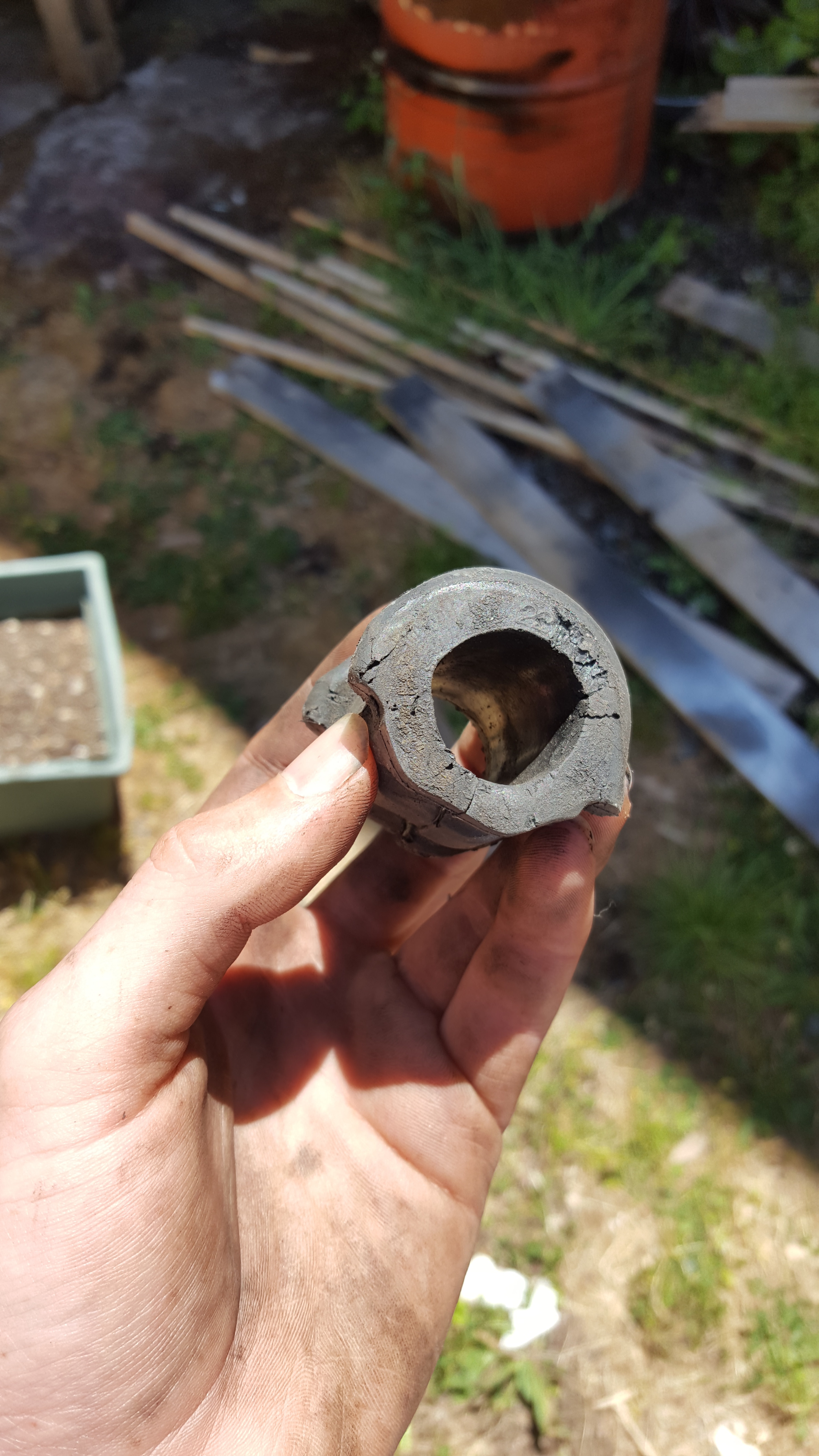

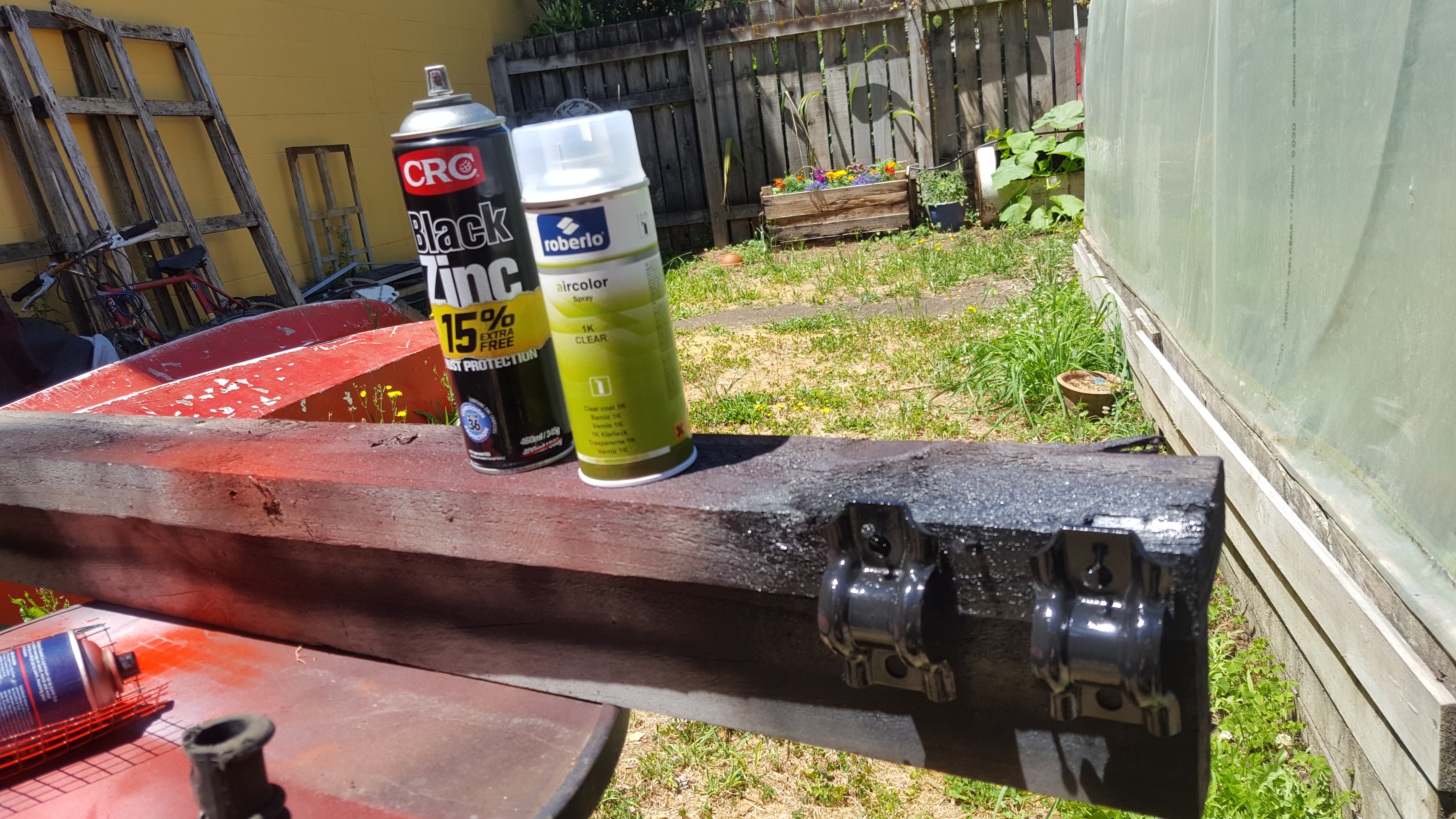

Well i took put the sway bar today and got it cleaned up and painted, the bushes are shot but i am ordering new ones. I have also found another oil leak coming from somewhere, but i will preform diagnostics and find it later tonight. 20171214_135820
