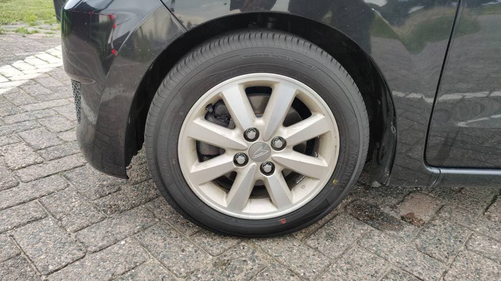

i was wondering if 185/50r14 would fit when 185/55r14 rubbed a little when fully steered
i am open to using spacers.
I have 165/60/14 and already sticking out wheel arches 1cm.
185/50/14 should fit with spacers or high ET wheels
I took the shot on a 175/50r15 on a 6j et39 rim and it worked! no spacers needed

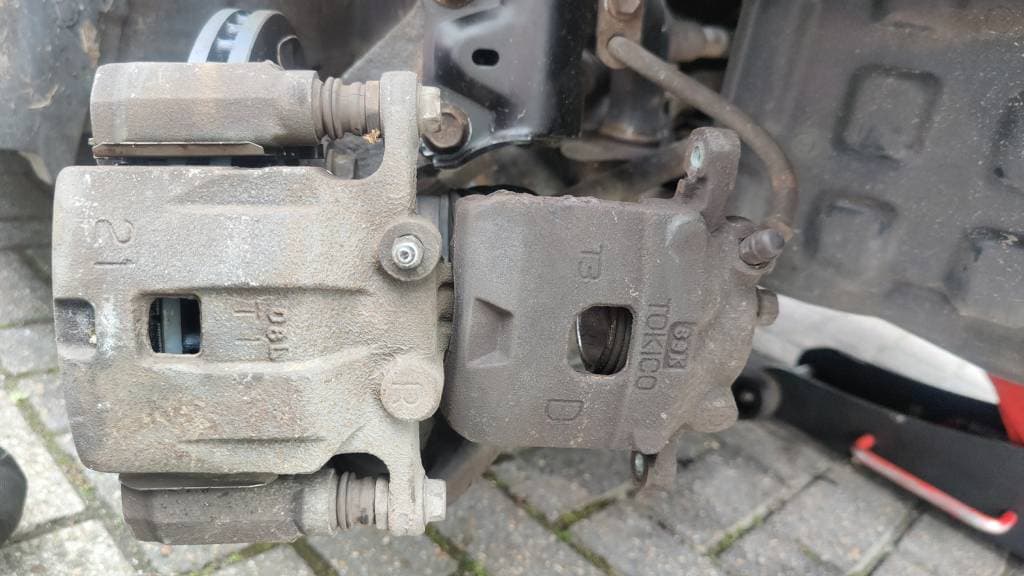

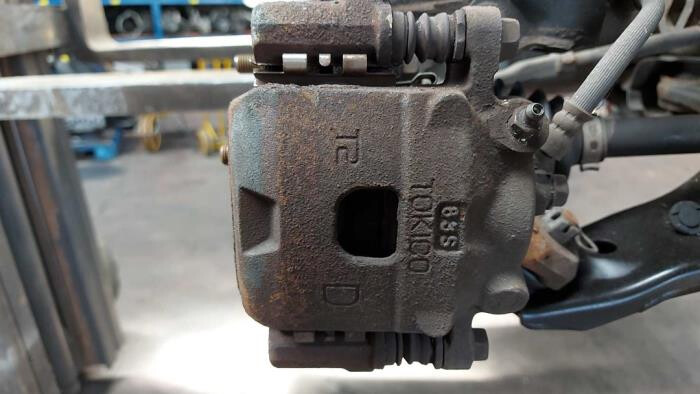

Materia 1.3 could be both check caliper (see pic)
Should be Mando calipers the 254mm
247mm calipers look like this:
So T1 - 254mm
T2 - 247mm
T3 - 234mm
Probably T means trim

If you have original cuore wheels 14x4.5J it wont fit with Materia calipers
Solution1 : a 3mm spacer to fit the caliper
Otherwise it wont turn
Solution2: get 14x5J wheels from a Sirion2 or Materia and tyre size 165/55/14 , 165/60/14 or 175/50/14
