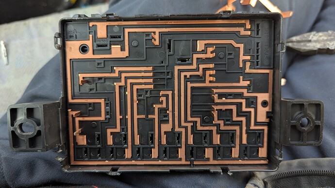

When the lid came off on mine, this what remained there, these can come out but mine preferred staying put.

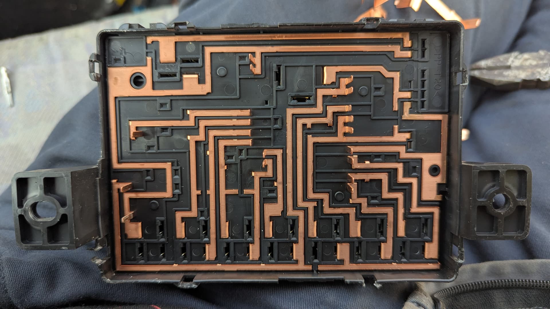

What was left on the bottom was this layer. When taking apart the pins likely will snag on the lid and one layers so take the lid/layers off gently and pluck the pins out of their slots. A screwdriver did this job perfectly well on mine.

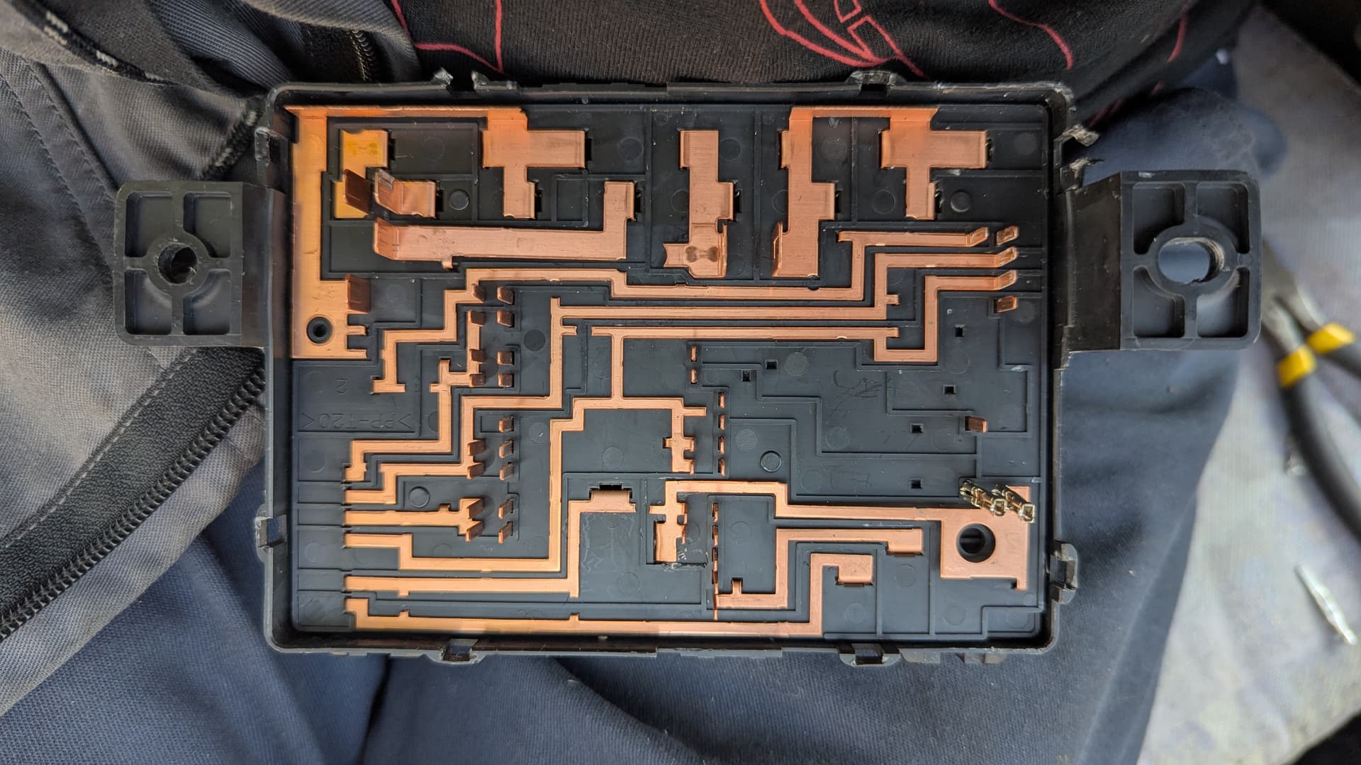

At this point to access the bottom layer, you’ll wanna take most or all of the copper tracks out. As I said, a screwdriver and some persistence did this best for me.

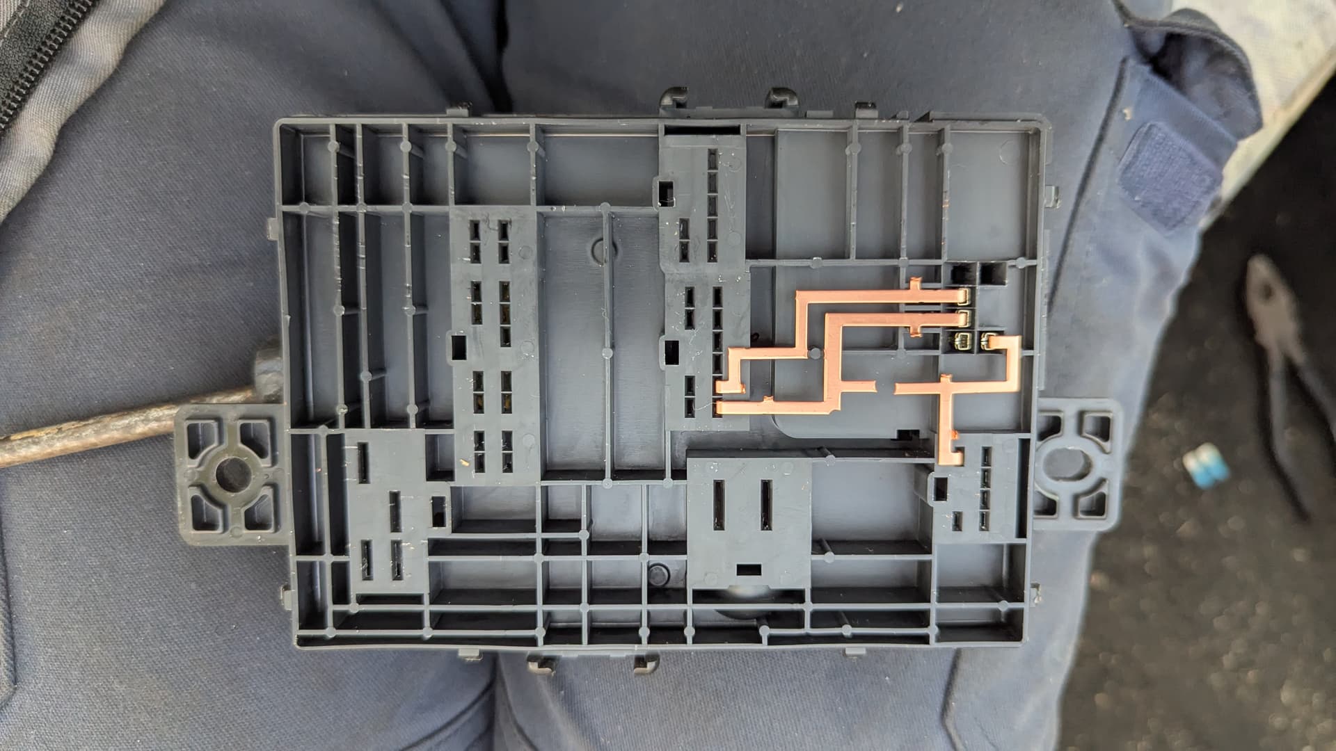

This allows the bottom layer to come or revealing the final layer.

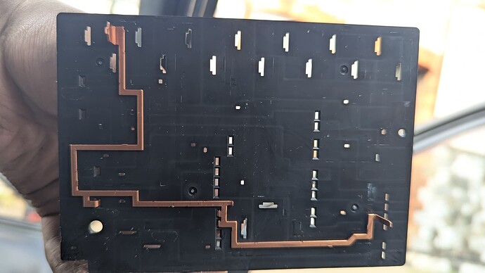

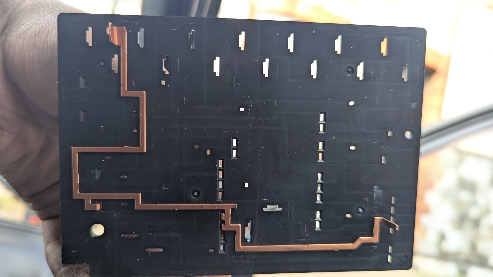

One track stuck to the lid of this layer too.
