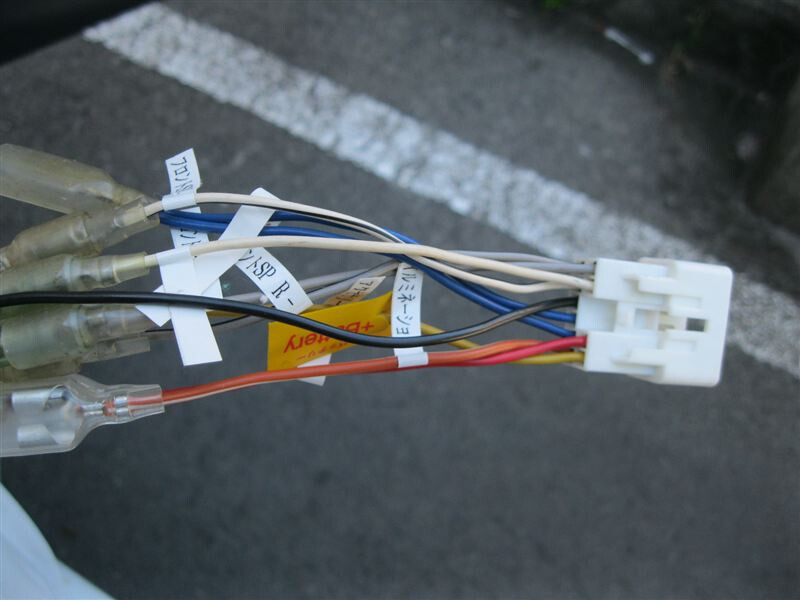

Does anyone has the pinout of the 9pin plug ? I have an adaptor cable seems be wrong wired

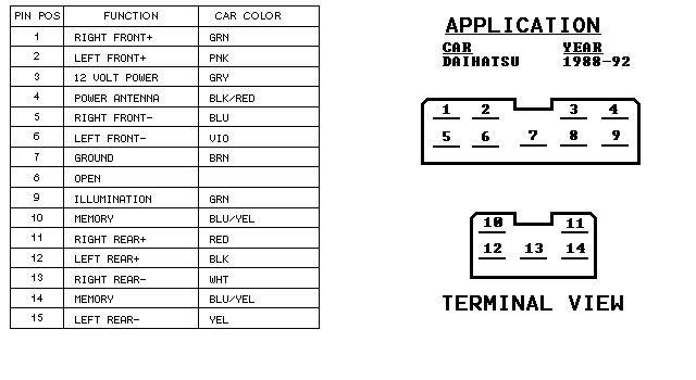

is this the correct one
even this is not the same year
