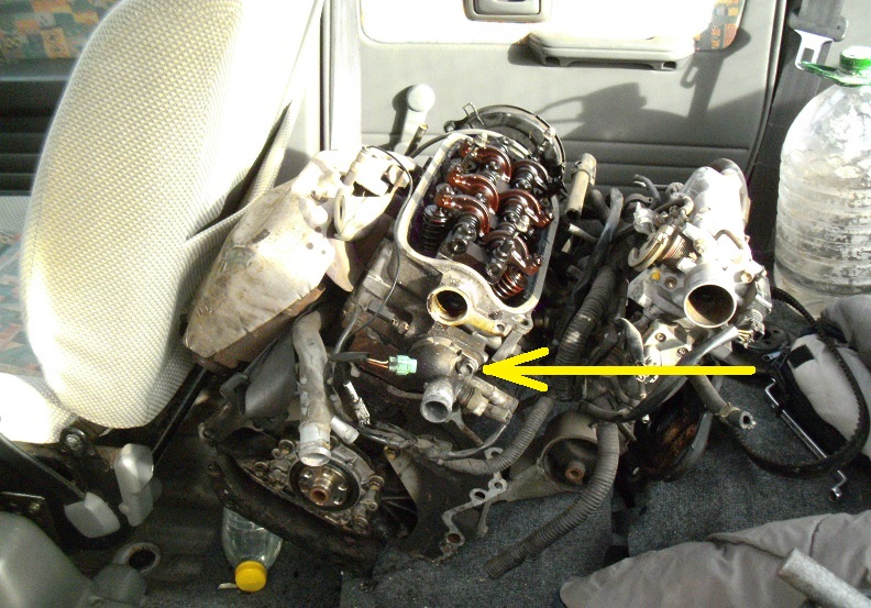

  2. Can anyone guide me to where the Thermostat is in the engine bay? I’ve followed the hose from the bottom of the radiator to something bolted onto the engine with a sensor plugged into the top of it. I’m pretty sure that’s it. Can I unbolt that when the car is cold without dumping tons of coolant?

There are only 2 bolts fastening the thermostat’s housing:
