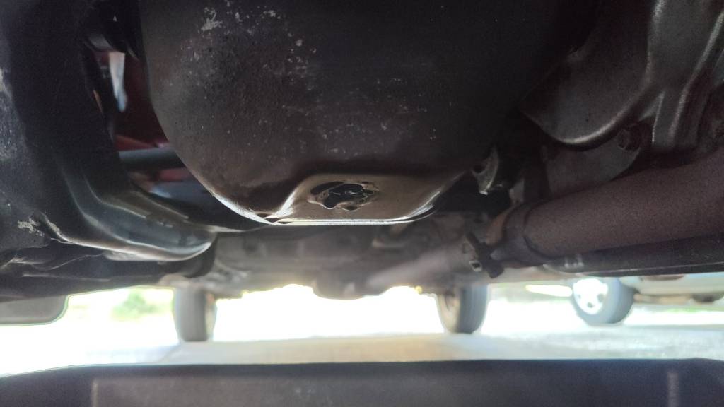

Photos of leaking would be greatly appreciated. I have fair knowledge of this platform

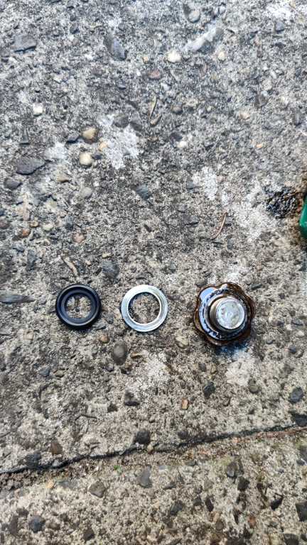

oil drain leaks.
The rubber gasket is so bad I didnt reuse it
I guess I need rubber one?
My preference is copper or aluminium washer, the crush and confirm the easiest. Fibre washers generally fall apart.
Honesty I never considered using a rubber gasket too.

Why does the aluminum or copper ring not seal properly?
I also have brake imbalance at the rear axle for the annual inspection
I find both materials to be more malleable and reliable that fibre washers.

How are the surfaces that the seal sit on?
