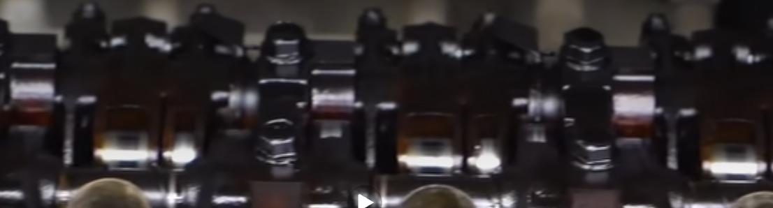

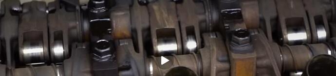

Here’s a before and after on the camshaft. The view obviously isn’t as accurate as when seen personally up close:
If it didn’t adversely affect the lobes, perhaps the best way to flush an engine would be to do it, without putting a load on it and running it at low enough r.p.m.s to keep the oil pressure light out
