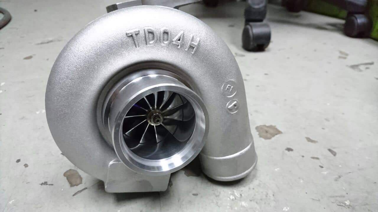

We are swapping a 3szve in the L701 atm. We go fo rthe turbo setup with a td04h turbo and aim for around 250-280 hp.
For this a lot will be bought:
New clutch super singlehyper race type
Td04h turbo and oil oines

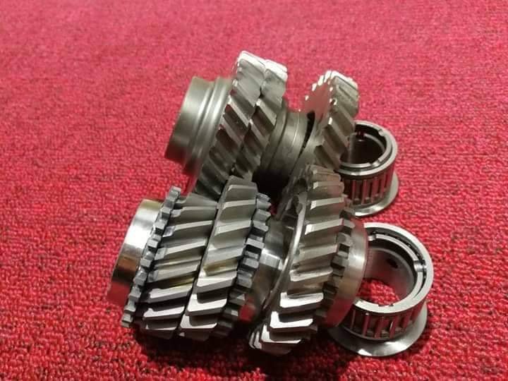

And the 3,4,5 gears i ordered, seemed better he said, we both use a bit simple english and hardened gears is what iv got mentioned, and bit shorter ratio.

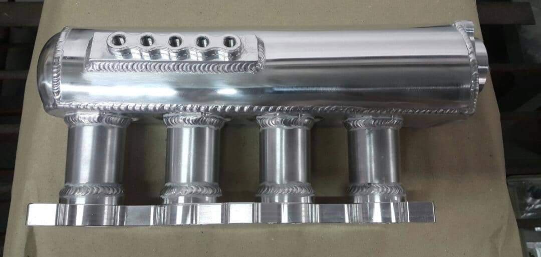

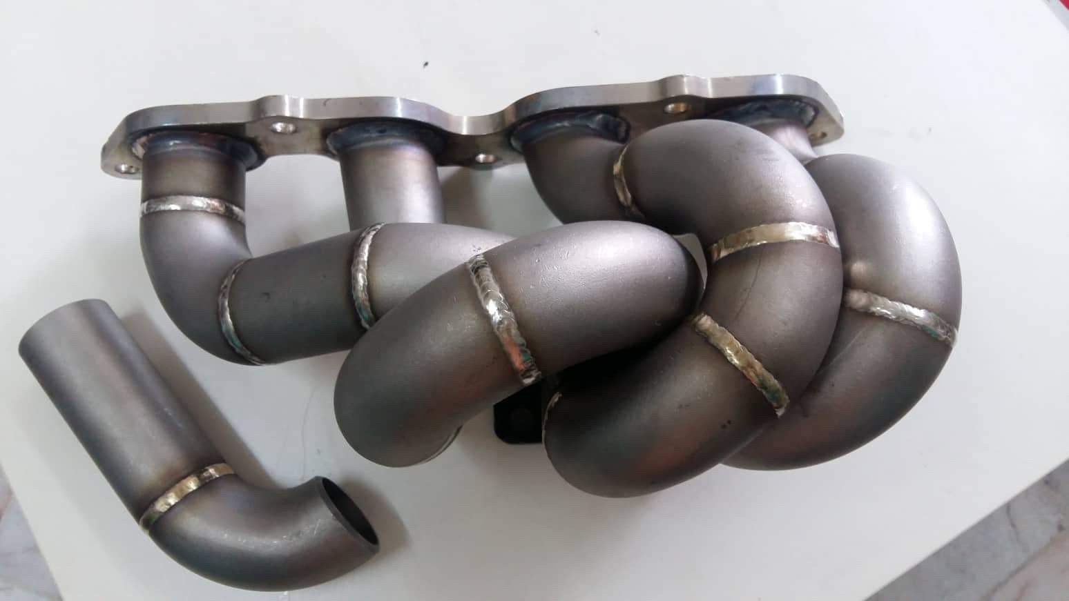

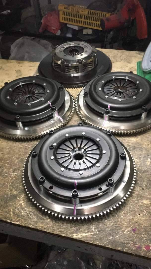

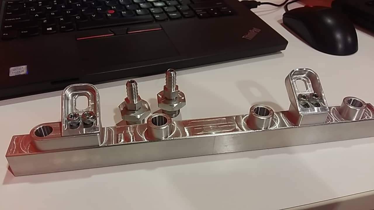

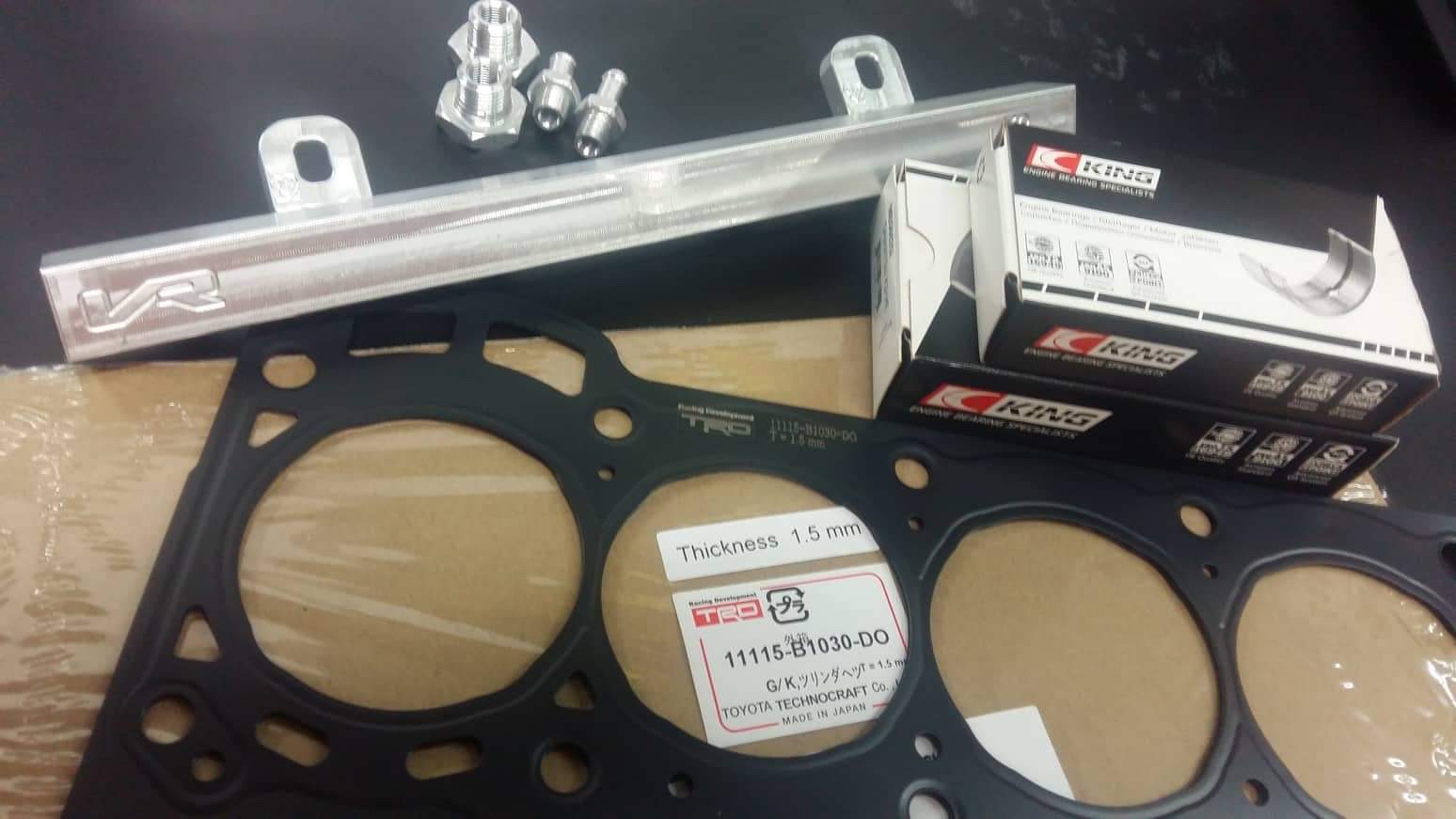

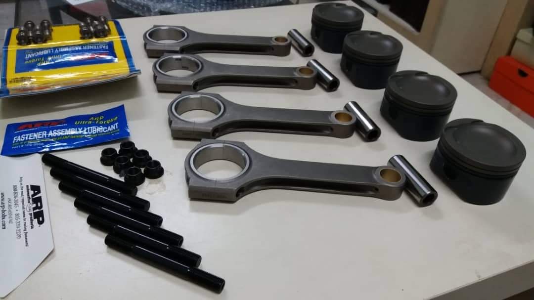

Some pictures of the ordered parts

I’ve seen “Custom clutches” made “special order” “specifically for k3 engine” that are totally wrong fitment
I’ve seen engine internals made for other cars with terrible machining marks
I’ve seen "carillo " conrods that ARRIVED rusty
I’ve seen piston kits supplied “specifically for k3” that then are told they have to rebore the engine massively because they’re civic pistons. wrong domes. then crack almost instantly
I’ve seen "ARP " headstuds arrive in wrong sizes then expect the head to be ground to fit them

but engine aside, i don’t believe “hardened” helical gears will hold up to much power increase

Hardened does not account for stronger. It will help with wear or heat issues. Have been there and while my materials engineering classes and such were so time ago the theory matches experience, hardening is about wear and surface damage.
Indeed. Which does help a little
Have done this with gears which are replacing broken models which only just let go, so perhaps helping fatigue and decreasing failure rates 5% or so…but when putting a gearbox in that is designed for 1/3 or less of the torque is going to require much more of a remake :laughing:
Or shares in the local repair shop so you can keep swapping boxes every other time you take it out :joy:

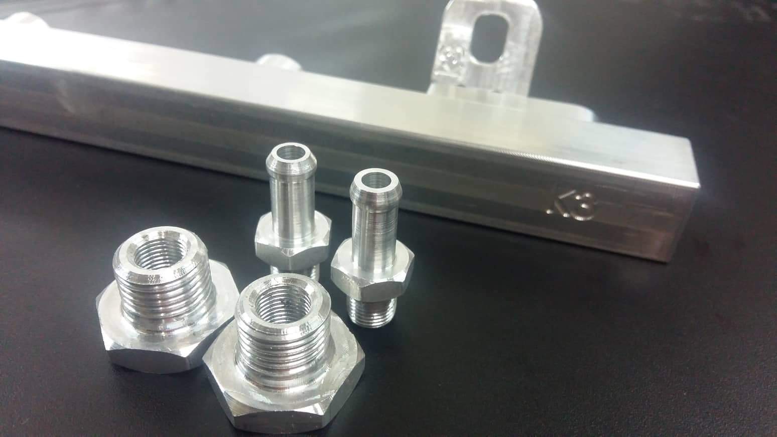

The k3 engine will come with better fuel rail, arospeed crank pully and manual so thats a plus, lower end of the block including crankshaft is completely new and unused so will go for 72mm pistons instead of oversize now. The head comes from other k3vet engine with just 40k km on it so good as well.

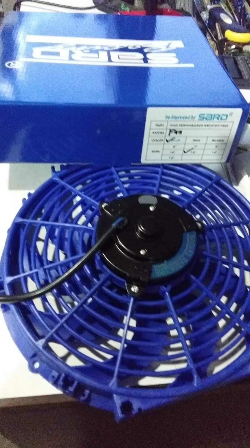

big cooling will always help

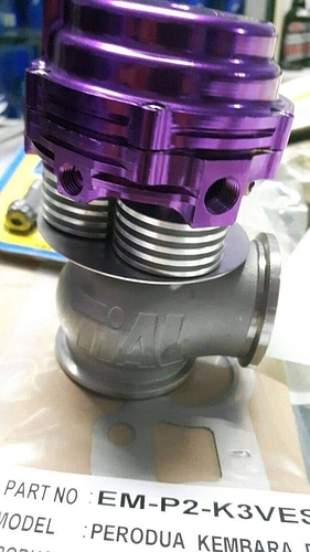

they will have a match in wastegate. otherwise tial seems good

All my clutches come from one person I trust who makes them custom for me while I stand around and help (mostly watch). Haven’t talked to him for a while but what Jim Berry from Race Clutches qld Aus does not know about clutches isn’t worth knowing. Such service is not cheap but is invaluable. My point is most stuff comes from places that don’t understand what they are selling and certainly care less about ascertaining your needs than grabbing your cash. When Jim is gone at least I have what he taught me and the lessons shared make me forget price.
