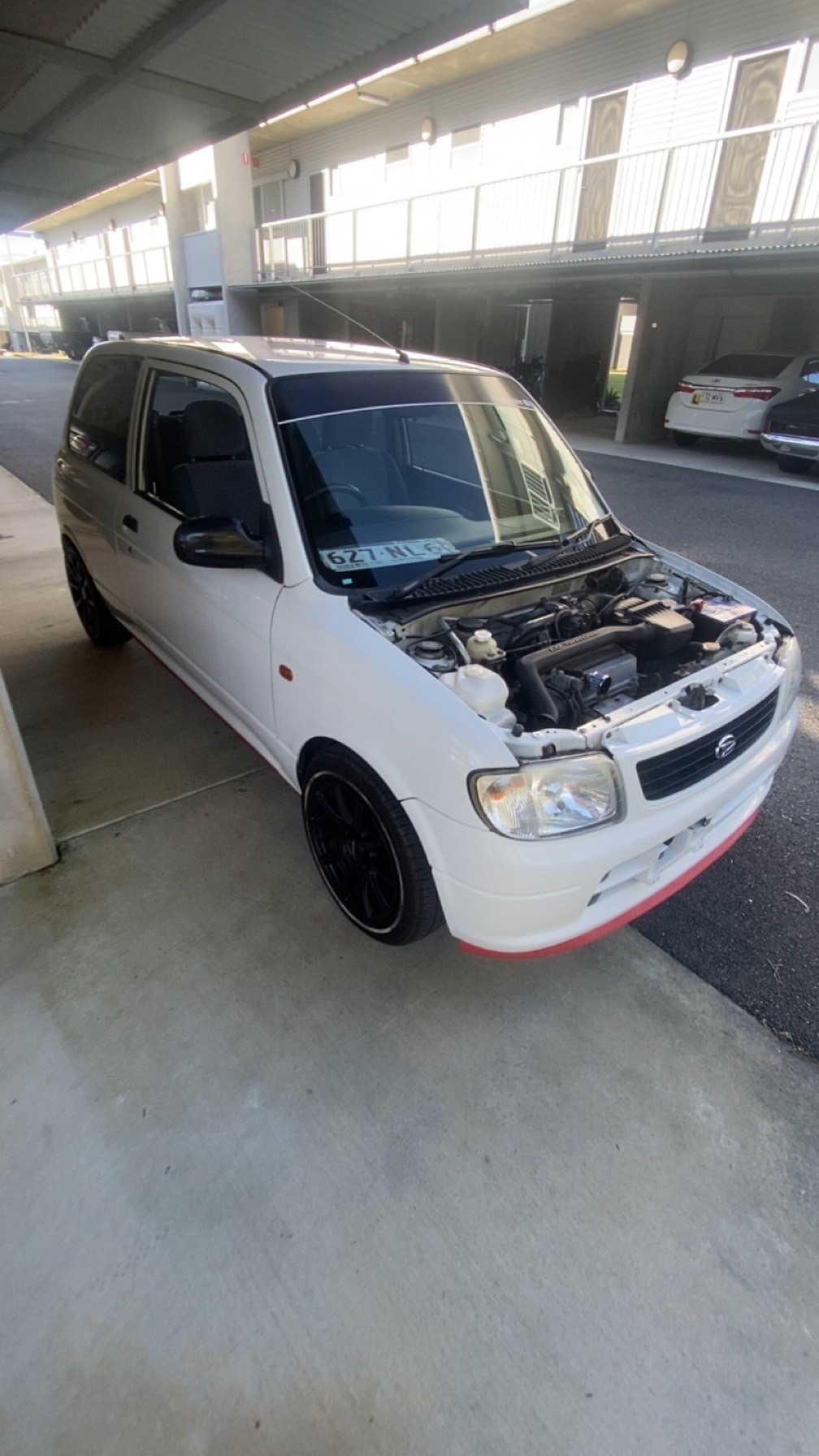

This is my 2001 Coure I just brought the car as in pretty decent condition considering its age and I’m planning on maybe doing a manual swap if it’s possible because the auto is pretty lame if any one has any info or experience with manual swapping these cars feel free to reply to my thread in the Q&A section

Your L7 looks good.

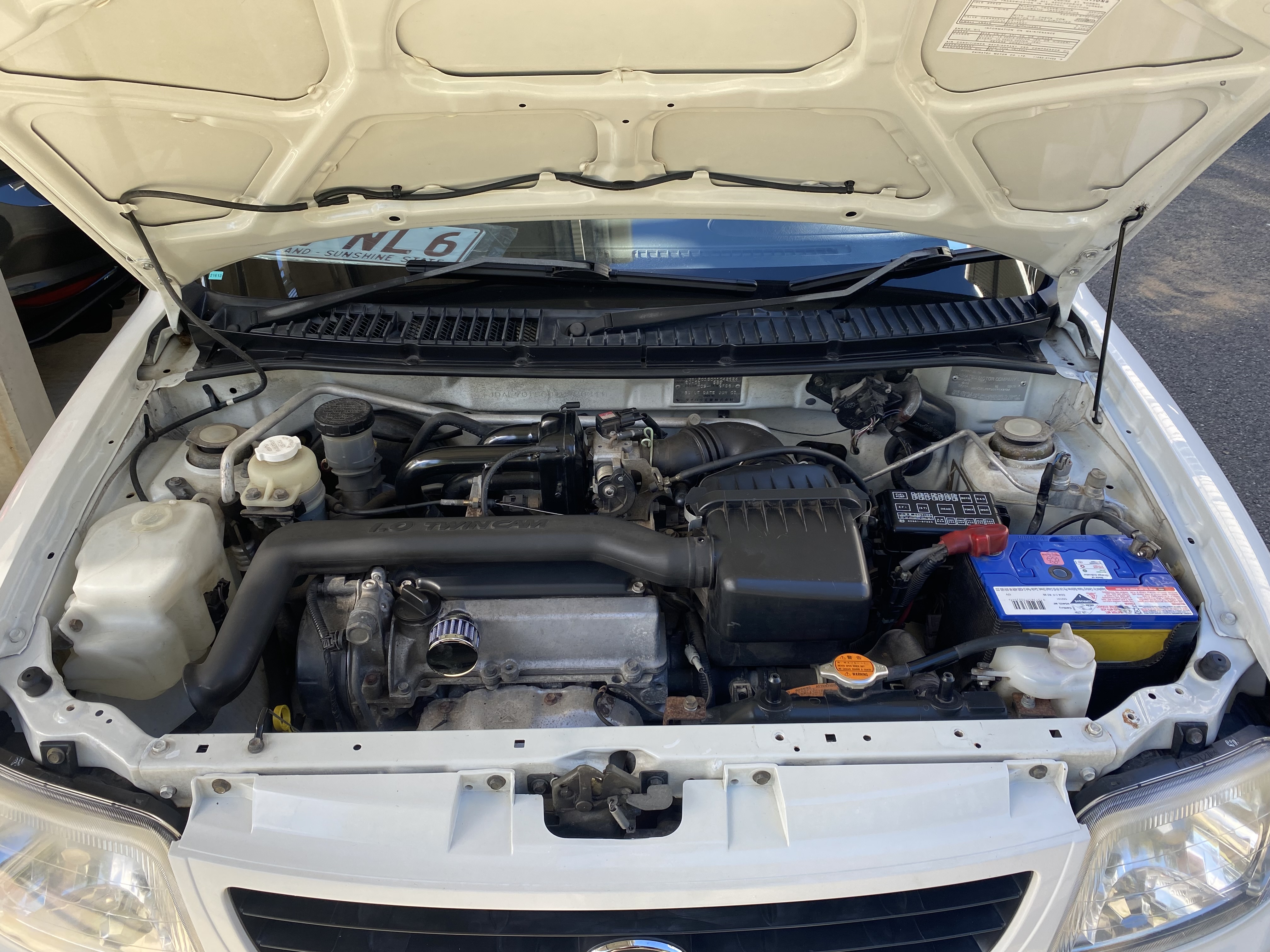

Was also curious if it’s possible to pull the motor and transmission out the top without having to drop the subframe as I don’t have a hoist I only have a engine crane
Yes absolutely, It is how I do it. I hate dropping the subframe. Just take off the bumper and the radiator and the radiator supports. It will give you heaps more room.
