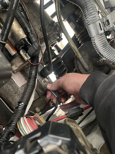

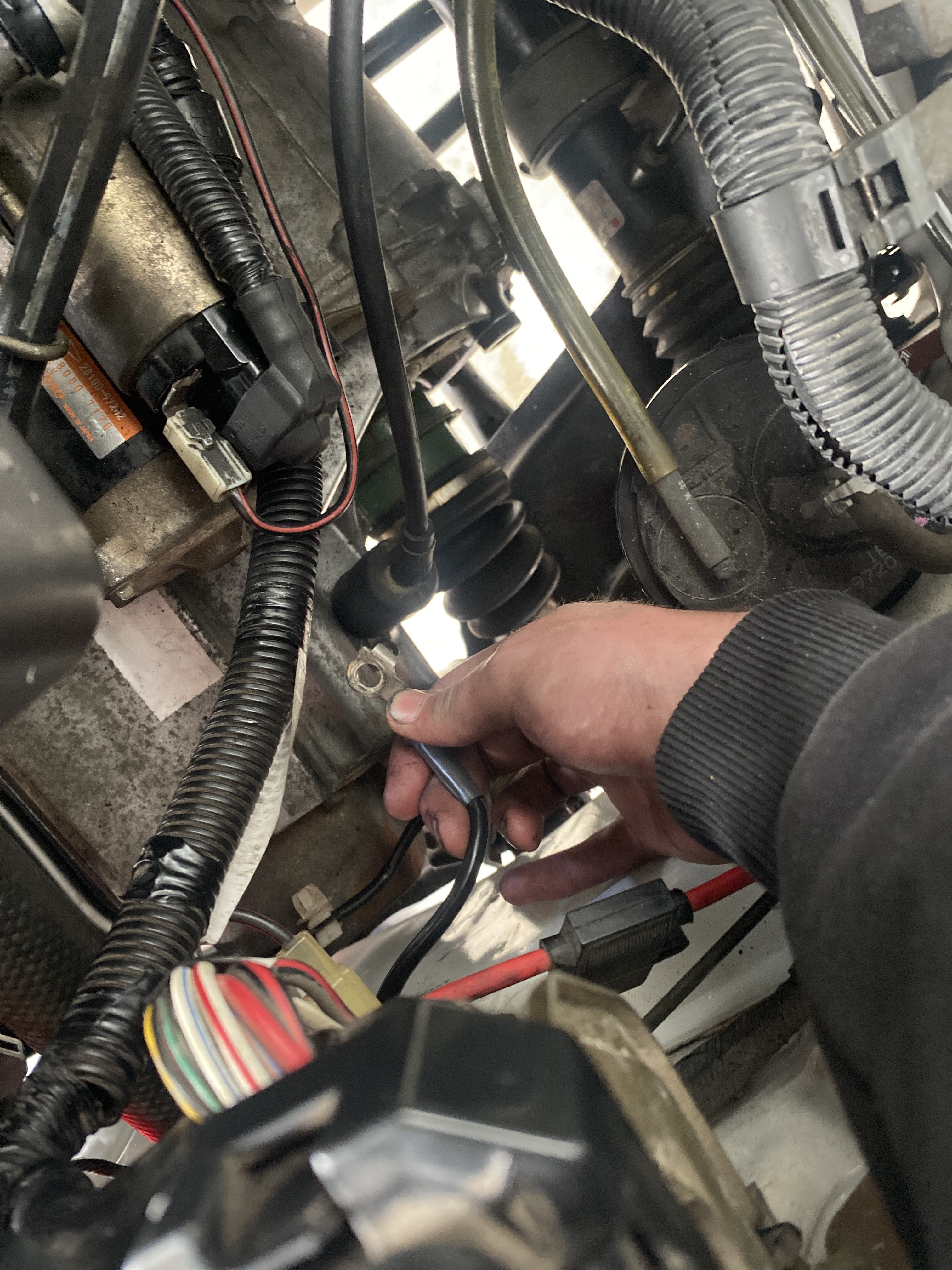

I’ve got the motor in and all wired up but I think I’ve wired the alternator or ground or starter wrong because it’s powering on but not cranking I’ve notice there’s 2 earths that come from the battery one of which is loose but idk what to mount it to I think it used be be mounted on the auto gearbox I’ve tried temporarily bolting it to the gearbox and seeing if it’s cranks but still nothing. I’m quiet confident that all the other wiring is correct just maybe not the start or alternator
From what I’m reading online, when you do a manual swap your car need to know it’s in park or neutral before it starts and since it was a auto car before I gotta somehow figure out what to bypass and how
Hey guys update turns out everything was wired correctly it was the gear sensor on the auto box being unplugged didn’t allow the car to start you could probably bypass it but what I did was take off the sensor and zip tie it hidden in the engine bay and left it at neutral
