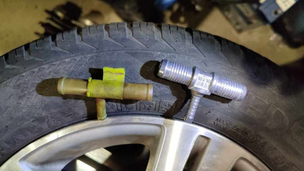

Here is a follow up for the T piece 16-8-16mm
So a lot of us who have a ED20 engine have the same problem.
T piece for ED20 coolant line going to throttle body is going brittle and creates a leak for the coolant.
The part size is
16mm 8mm 16mm
A discontinued part from Daihatsu
https://nl.aliexpress.com/item/32864704387.html?spm=a2g0o.order_list.order_list_main.23.576279d2cO3zmR&gatewayAdapt=glo2nld
It is for sale on Aliexpress.
Hopes this clears up the discontinued part from Daihatsu.
This is a brass part should last much longer than the oem plastic part.
In fact, it should last indefinitely. It’s easy enough to solder together one’s own T-fitting, using 15 mm and 8 mm pipes, if one chooses to spend no oney and has this tubing already available: Butchered replacement MOVEs diary - Projects builds and rides - Live To Dai
anyway its 16mm 8mm 16mm. I have it installed now and no leaks.
L701 also uses this
here in Australia, some later model Sirion’s ( Storia ) came with metal T pieces, I have about 4 spares myself :wink:
