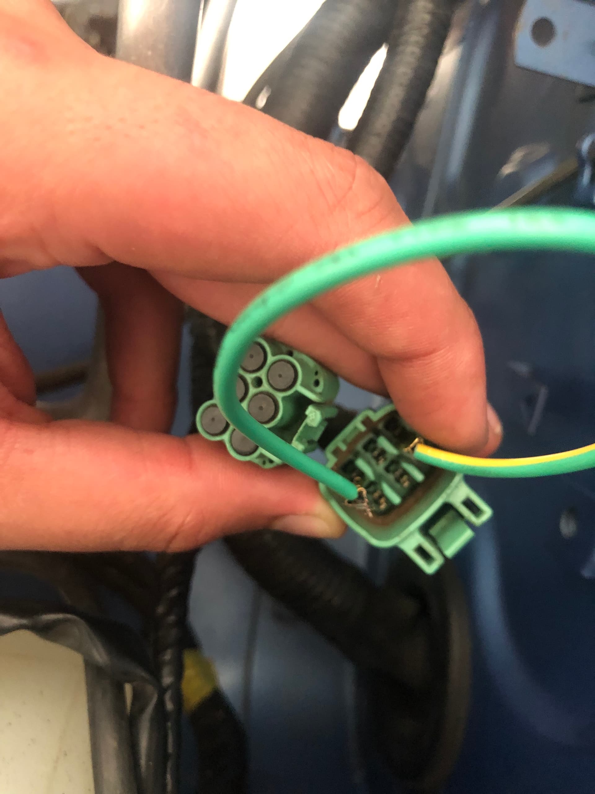

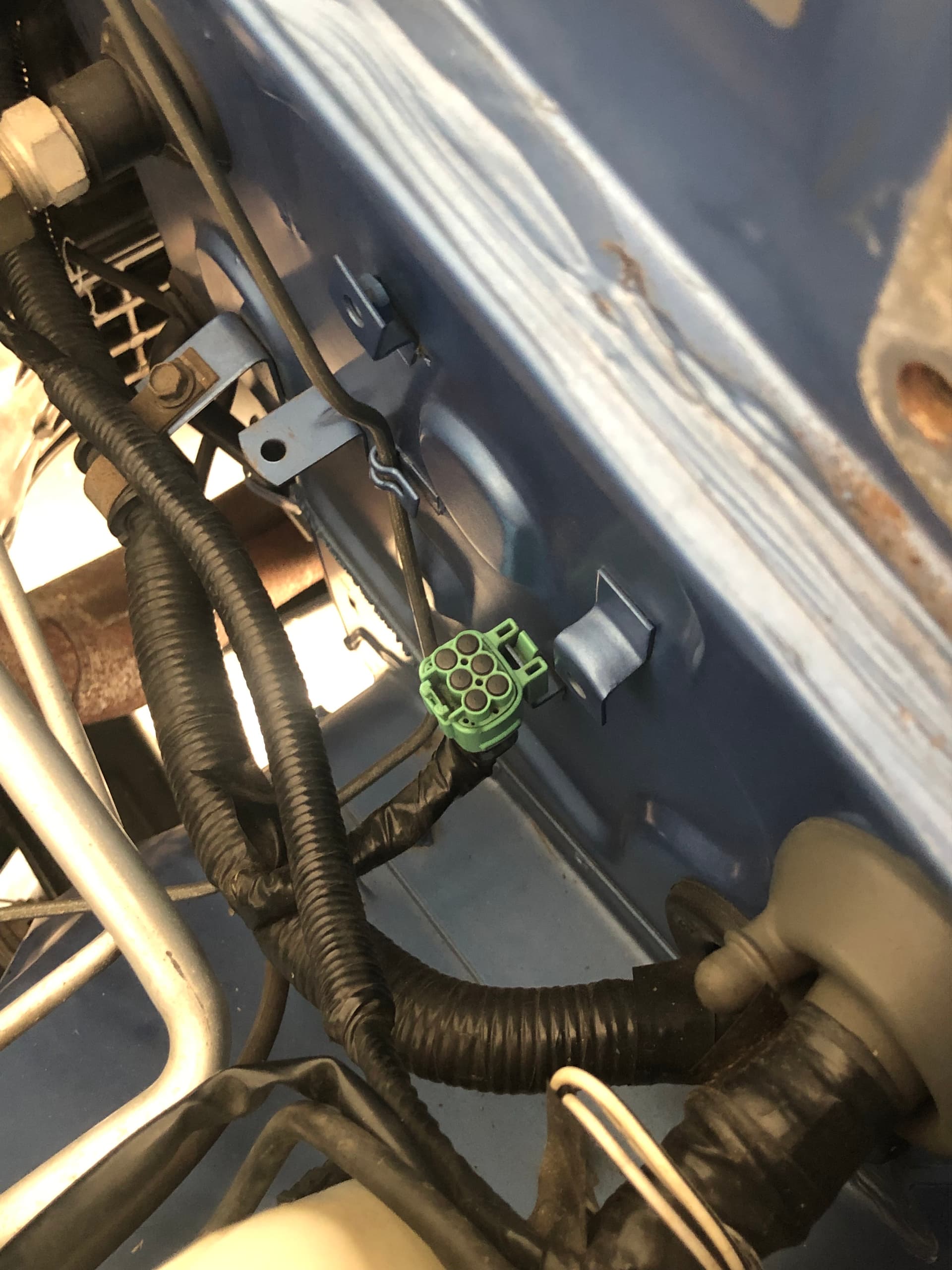

I found a port on the top right side of the engine bay, its green and has six pins. I’m going to try doing the flash check engine light test now, i just don’t know how to translate whatever code it may flash at me.

I’ve found translations for the codes and did the flash check engine test.
This is the only port i’ve been able to find. Again, in the first photo i did the check engine flash test and there was no issue.
I think i’ve strayed away from the original post so i’ll redirect it. I’m looking for the OBD port on this car and the corresponding scanner. As per photo 2, this is the only port i’ve found so i’m not sure if that is the diagnostic port.
