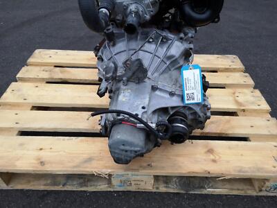

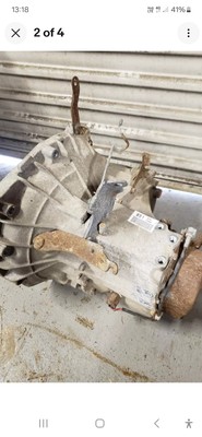

A couple of options:
either of those should work. If you are on the Daihatsu facebook groups its worth searching out a chap called Phillip Harris who has a massive stash of spares and likely can help - he’s down in Devon so depending on location it might be a courier job? if so, try Paisley Freight, who are happy to move grotty oily things like gearboxes.
