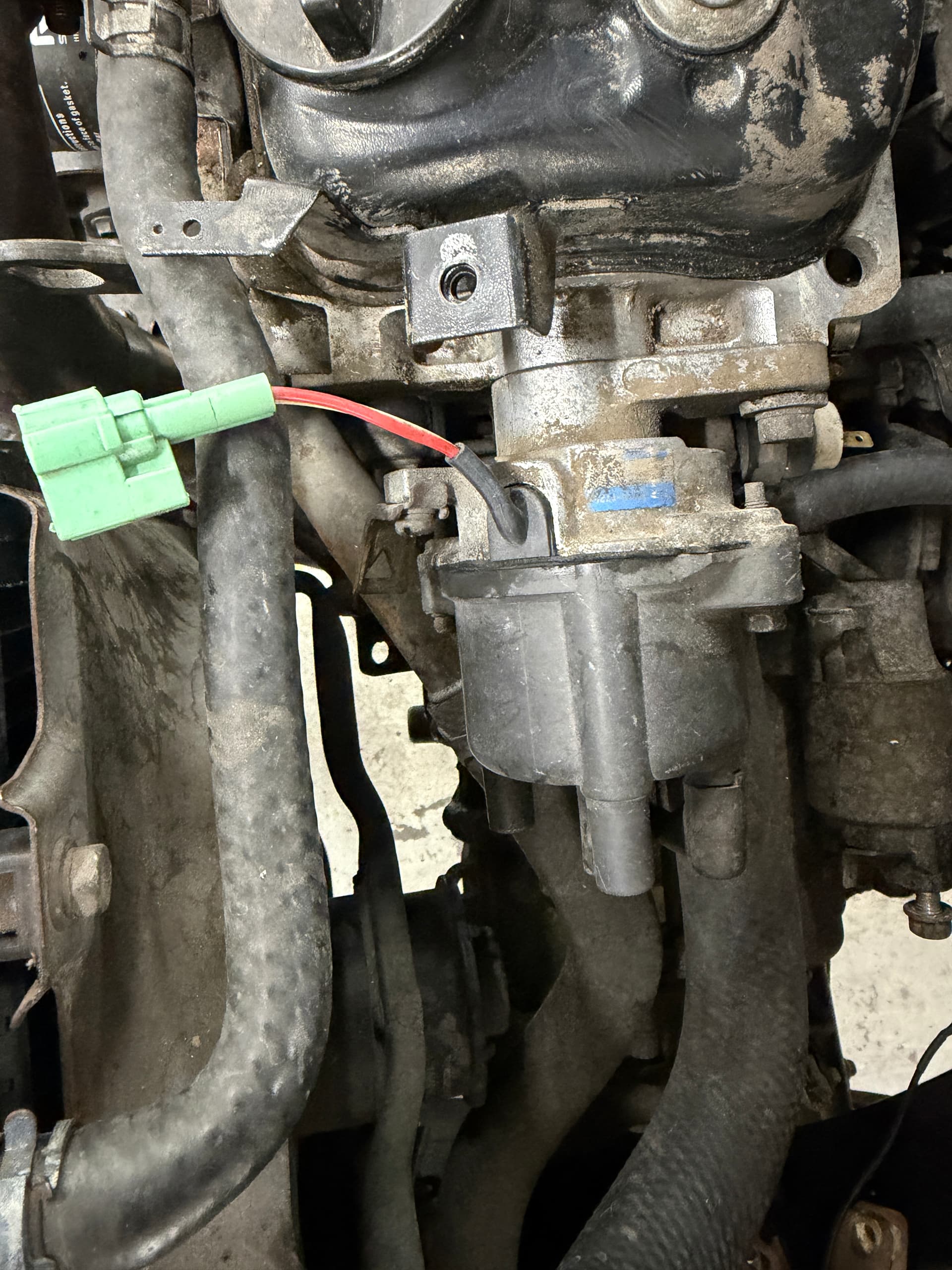

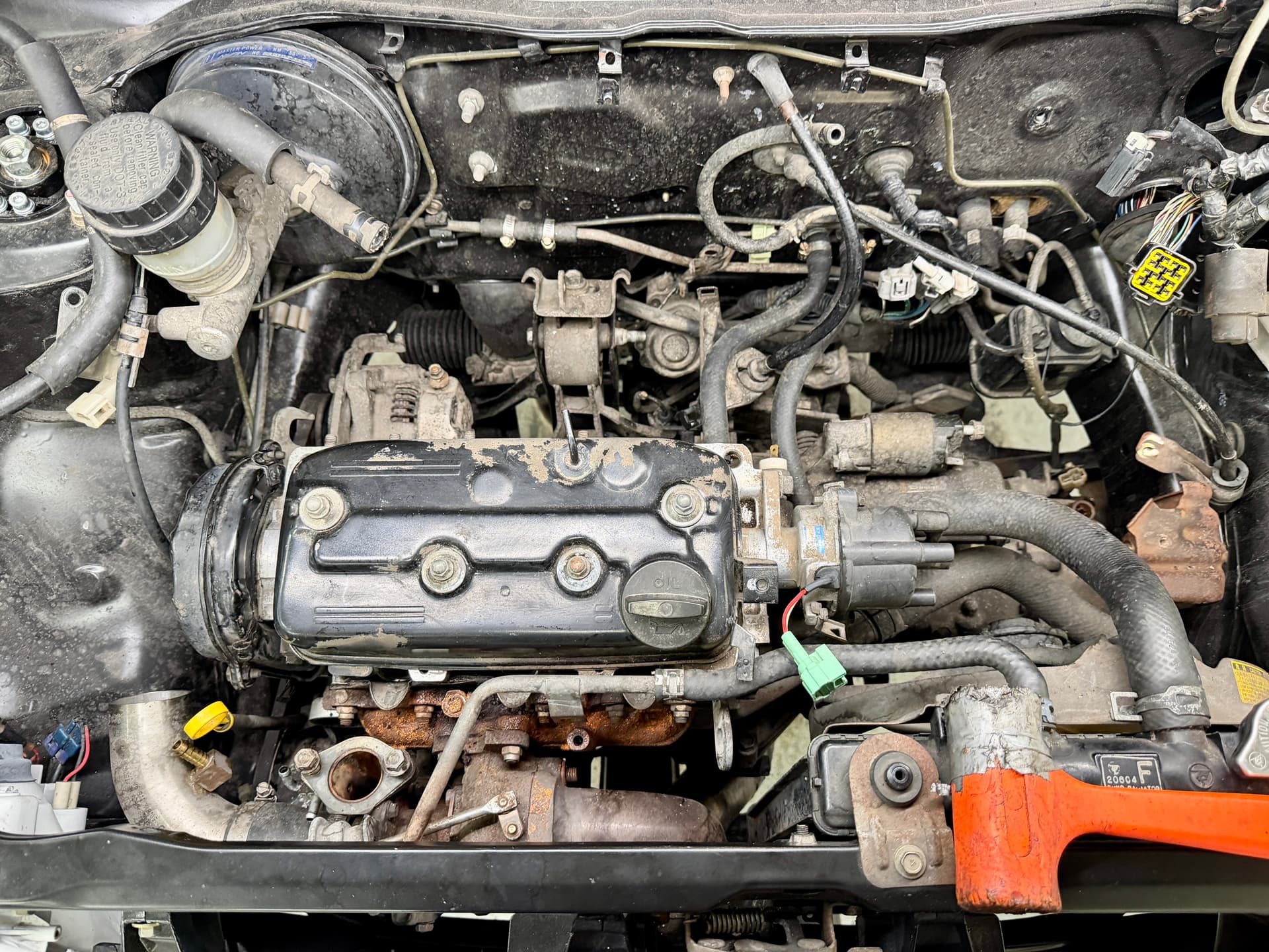

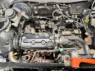

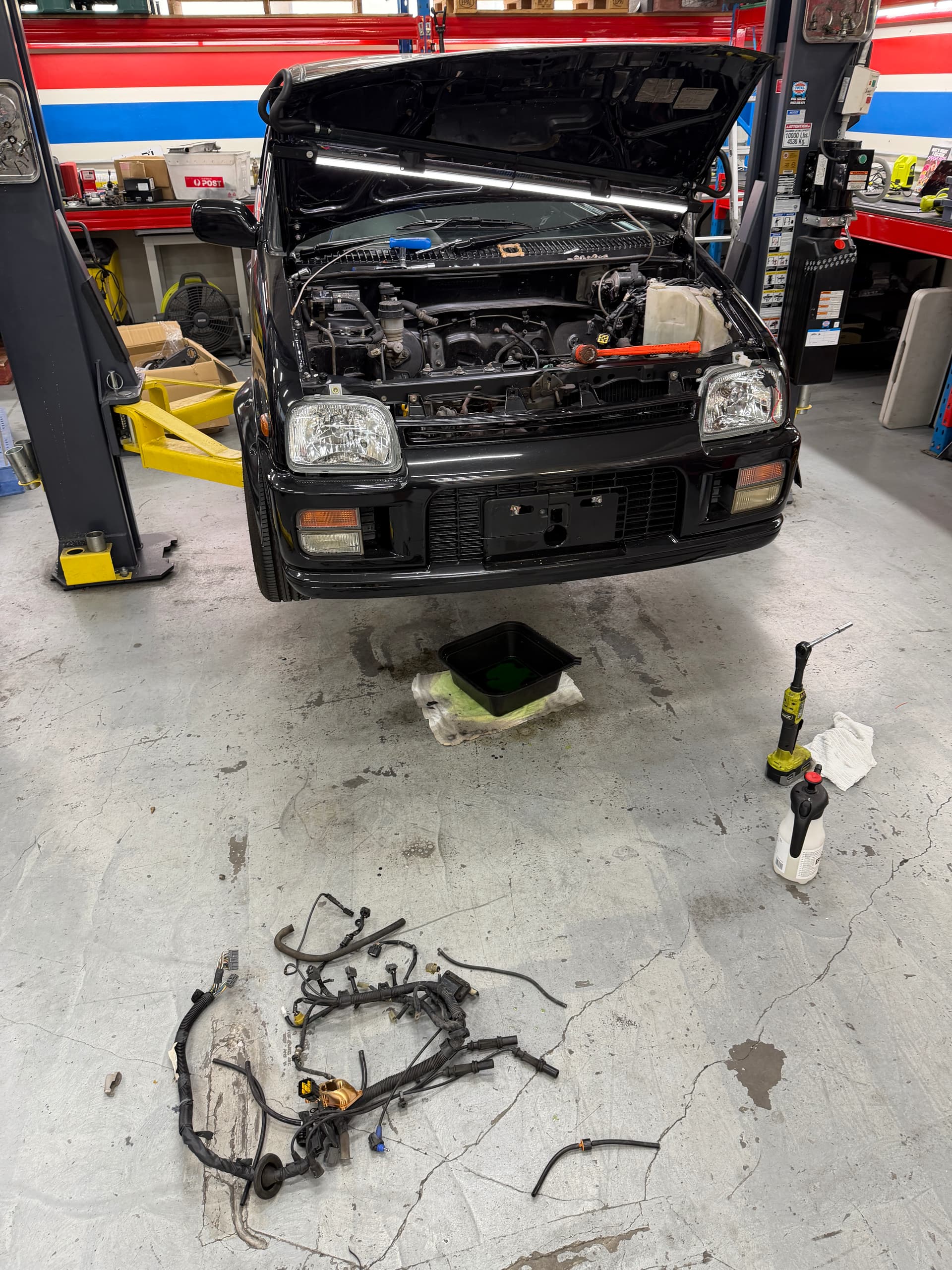

Drove this thing around a bit over the last few weeks and had a great time with it. I was having some annoying boost and idle issues so I went through some of the vacuum lines on top of the engine and they are all a bit crusty.
So I’ve decided that I will keep the engine that’s in there and give it a tidy up and new engine management which means I can also use an electronic throttle and delete 90% of the crap on top of the engine while still retaining its character. This means I can tune it and tweak it and get a smooth Idle.
Pretty sure that engine is an ef-jl But there is a few gaps in my knowledge in terms of what turbo is on there and if a manifold I have here to suit Subaru turbos would work.
Also I think the smallest Subaru turbo is the primary of a TT liberty but from memory that has a different flange and I think the manifold I have is for a TD04

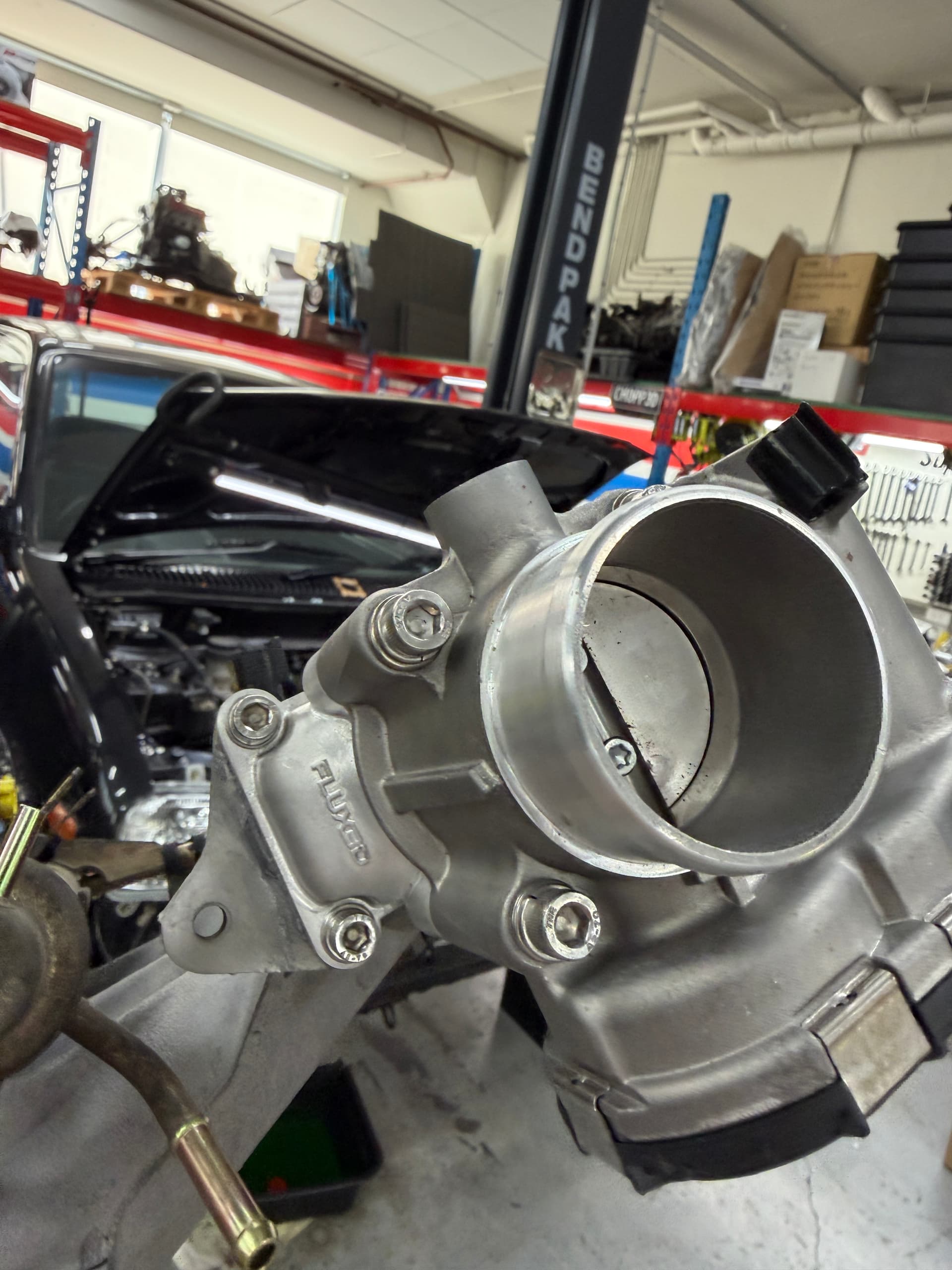

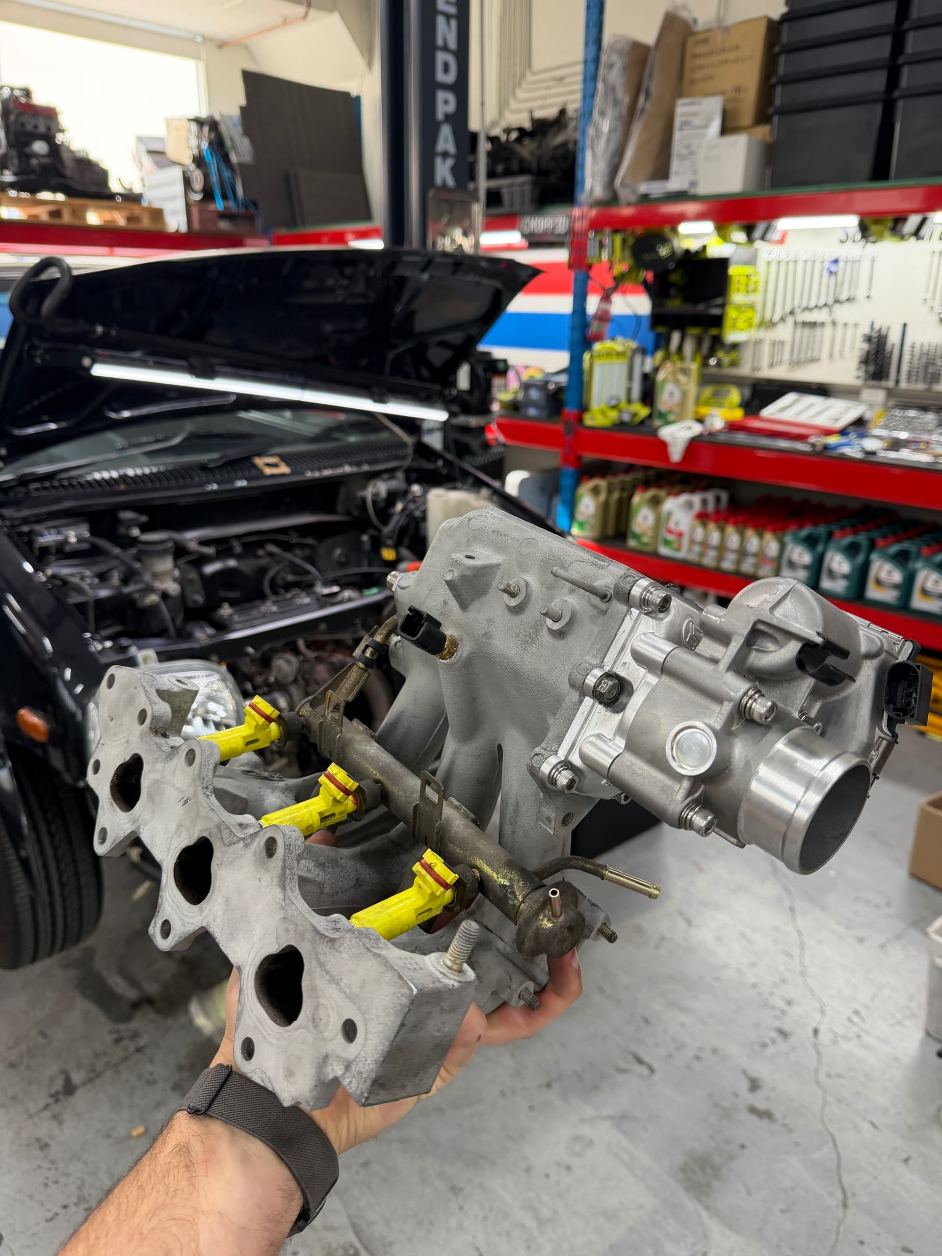

Anyway I’ll stick with all the stock turbo and intercooler set up for now as long as I can make it work with the throttle set up. Currently making a prototype on the 3D printer to adapt to the stock intake manifold

If youre messing with aftermarket throttle bodies it might be worth getting an EF-EL intake manifold from an L500. People use them to put EJ-DE throttle bodies on as it’s a conventional square 4 bolt mount rather than the big rectangle 6 bolt of the L200. Although I gave mine away to a mate for that reason so I can’t measure it for you. I assume it should be the same as the top 4 holes on an L200 manifold but yeah I’d take that with a pinch of salt.
he is going fly by wire so no use of the ejde TB. But yes they do fit on the L5 and also the ed20 manifold.
Yeah but it’s probably a much easier flange to convert from than the wonky 6 bolt L200 arrangement

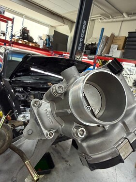

Thread grave dig… back onto this now.. got the bosch drive by wire throttle body mounted up with a custom 5 axis milled adaptor, next step is to hack the trigger system so I can full sequential injection with a Haltech.. I’ll update here as I get through it. I really should upgrade the turbo while I’m at it but they aren’t exactly common
Would a Garrett GBC14-200 be a worthy upgrade?
I reckon it might just be a little bit too big.. I compared the compressor maps and it will come on pretty late.. definitely wouldn’t count it out but I might just rebuild the RHB31 first and then tune it properly.. if its really left wanting then I’ll upgrade.
