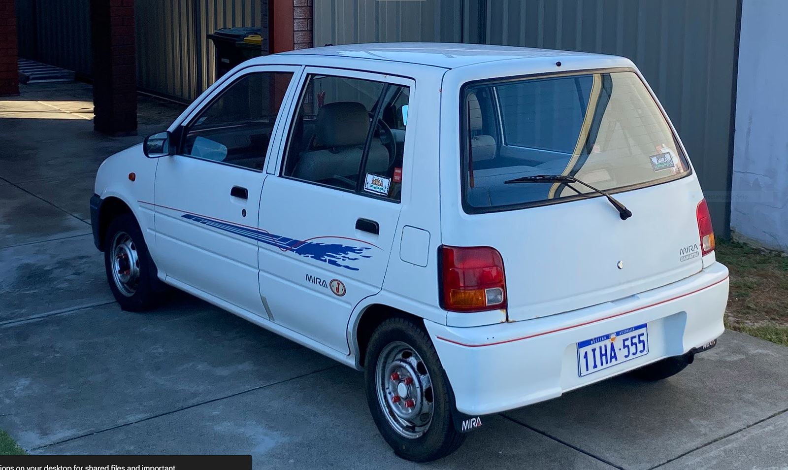

Hello all! this is my l200 mira! it has the EFI engine wondering if anyone know what kind/cc it is. love it so far, runs a little rough on cold start and shakes the whole dash! has some stickers that say mira mania anyone know the possible origin of them? cheers guys!

Welcome. Very cool L200.
Nice L200 as for your sticker no Idea. For you vibration issue check you engine mounts. They May be broken or warn or they have been sicka flexd.
Sicka flex is a great way to repair but increases the vibration at idle. Your engine will be an ef efl and would be 659cc.
