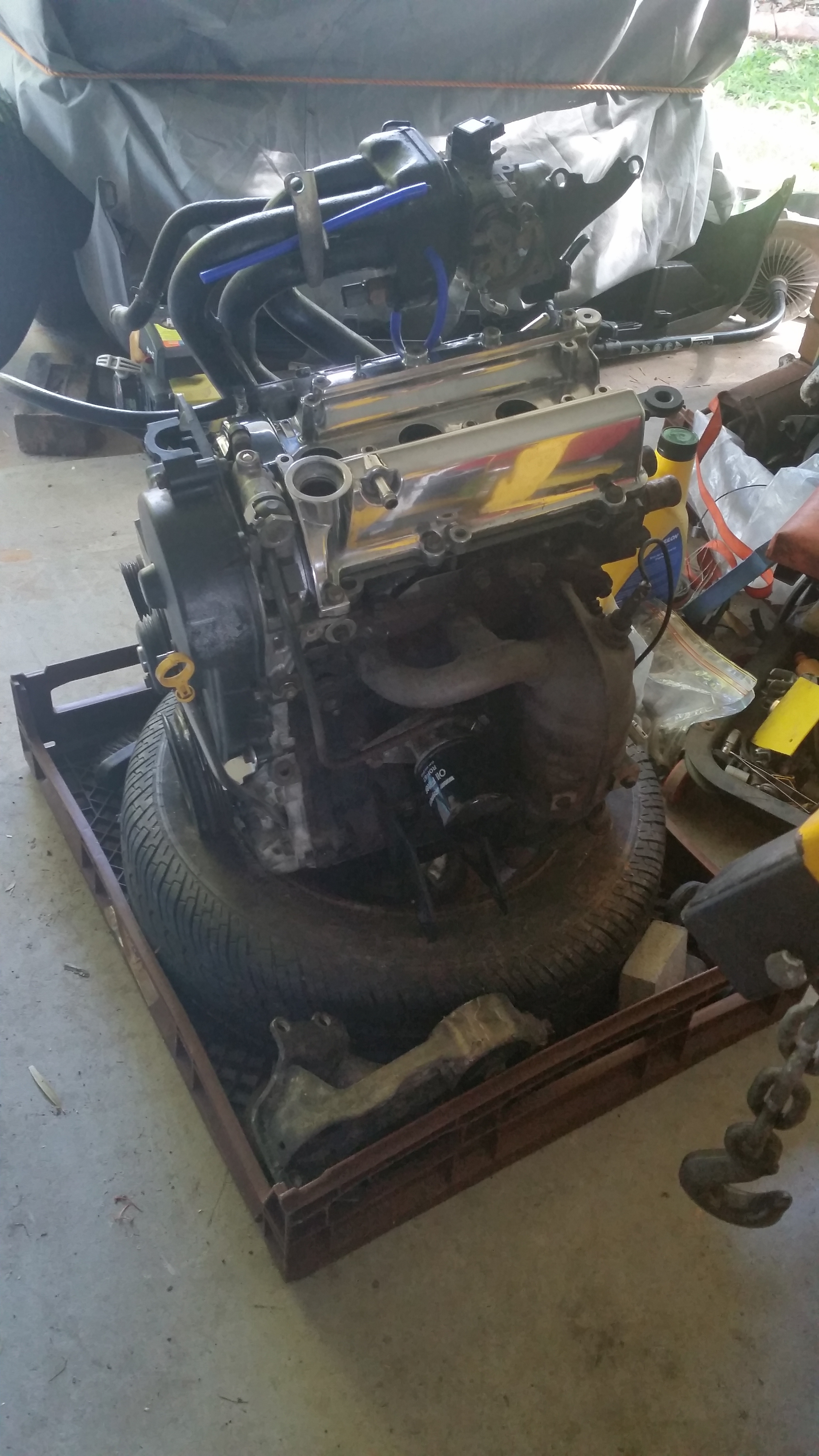

So i had to wait a bit for coin to buy the rest of what i needed, while waiting i decided to clean the corrosion from the rocker cover and tidy it up a bit, 44 hours of hand sanding with grade 120 down to 1500 wet n dry then 2 hours polishing and this is the result.
Water pump and timing kit have turned up and been replaced, Cams and timing have been done, Many Thanks to Jono Muir for the help he gave me in setting them up properly
Today the clutch turned up and picked up the flywheel from being machined so fun weekend planned putting it all back together and hopefully starting it by Monday.
Have a look into coating that tappet cover. Straight polished alu can corrode and end up chalky white.

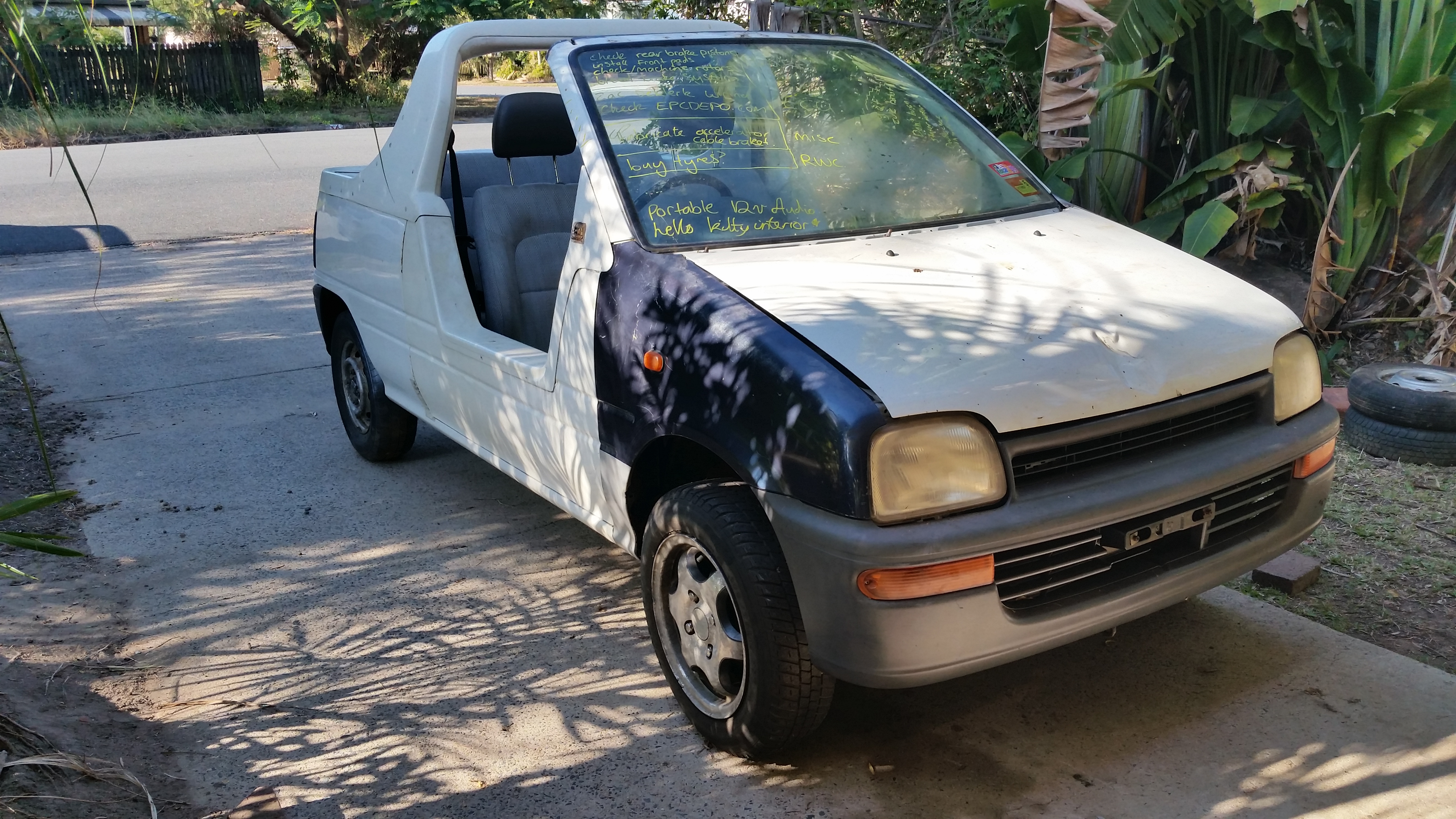

Update time, have finnaly gotten everything needed for RWC ( i hope) and am now am sanding everything back to give it a respray. Above the windscreen, i had a mate silver solder some pieces of metal in where the roof had been cut off (pretty dodgily too looking at it
) and spent the next two weeks bogging, sanding and shaping it so no sharpish corners as definitely lost the fibreglass roof cover part
. Not 100% perfect but i am not a panel beater and am getting annoyed after 2 500g tins of bog with putting it on only to sand 98% back off while trying to work at least 3 different curves. Next update after it’s painted
good stuff Dale I hate sanding off bog it just feels so long and tedious but can look really good after paint it on. Can’t wait to see it painted.
Looks good. There’s not a lot more you can do if you have lost that top cap. To be honest I think what your doing will end up looking better than that cover thing. There pretty crudely cut under that ay.

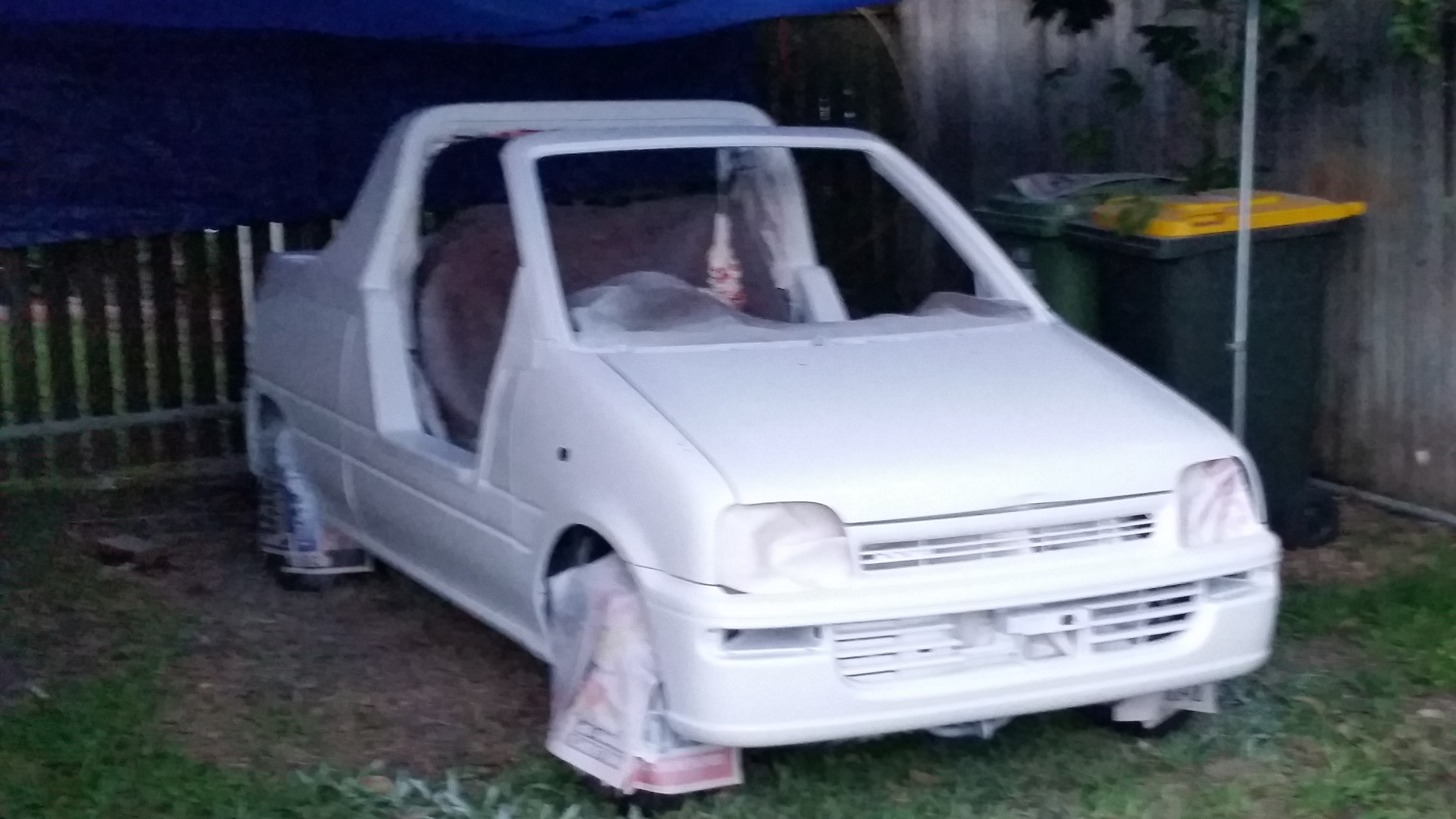

Finished painting for the moment, final finish is being planned, won’t be totally plain white as Mrs said I can try something totally new for me
now to put back together and do all the fiddly bits for rwc.
