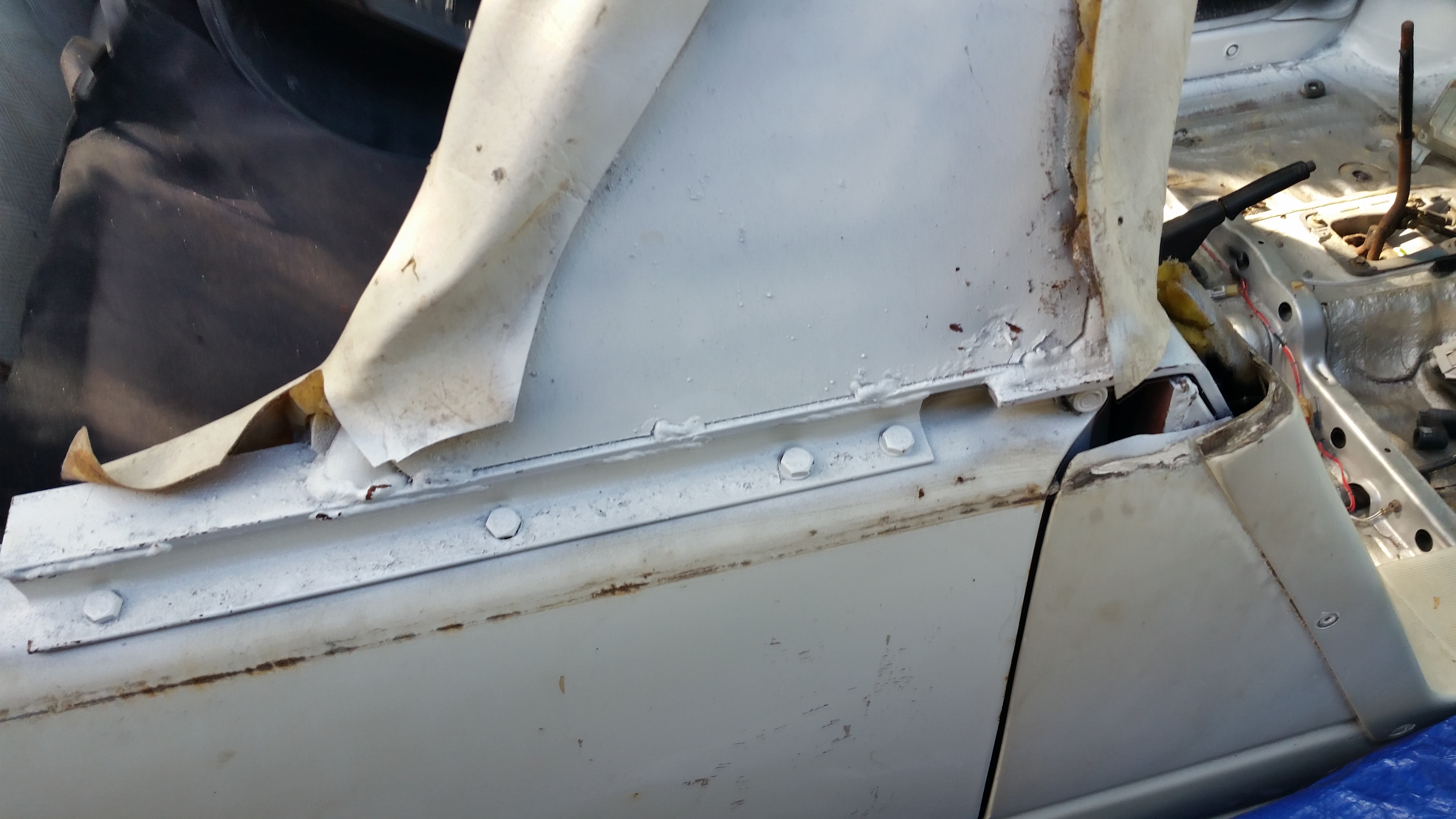

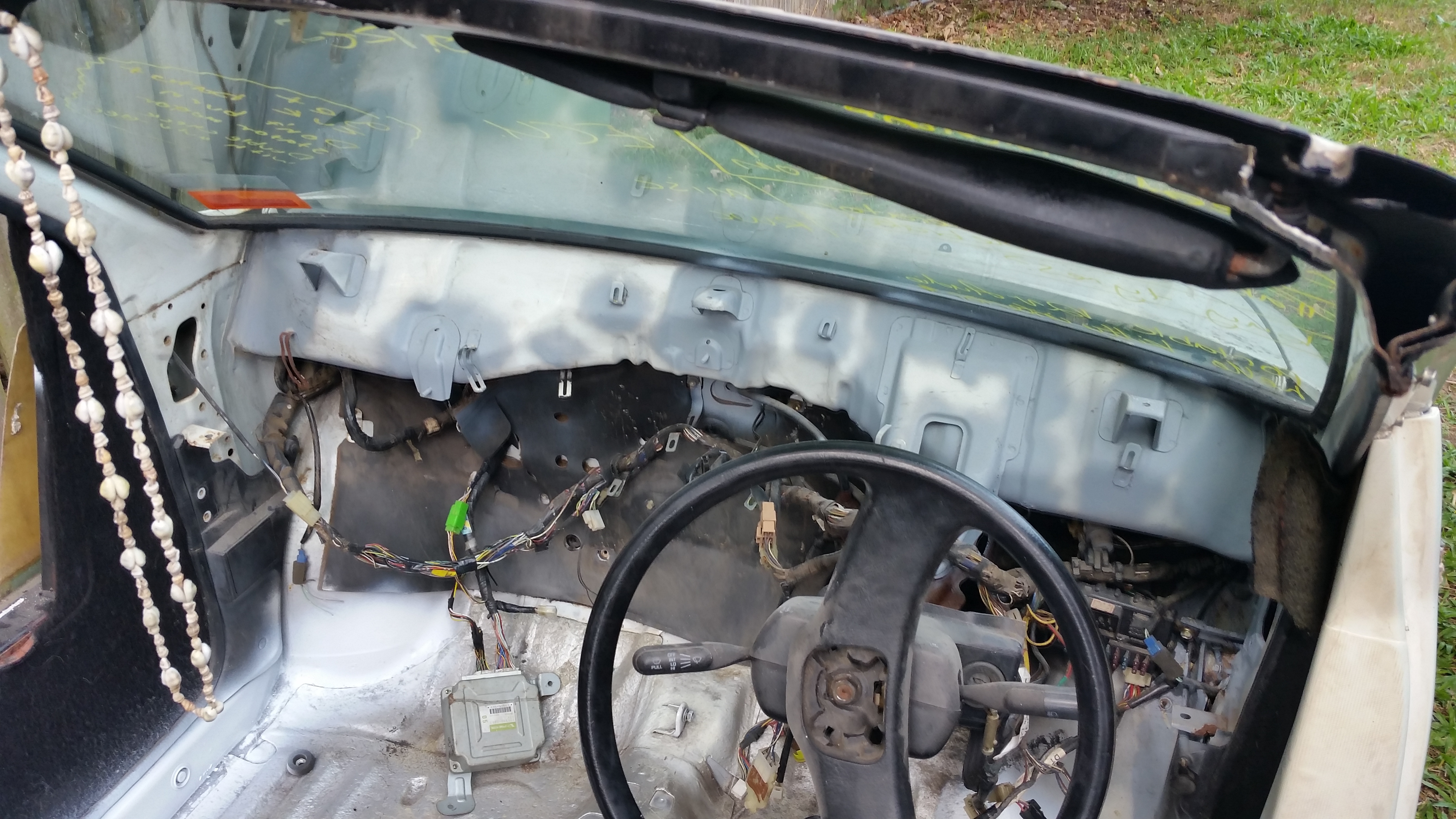

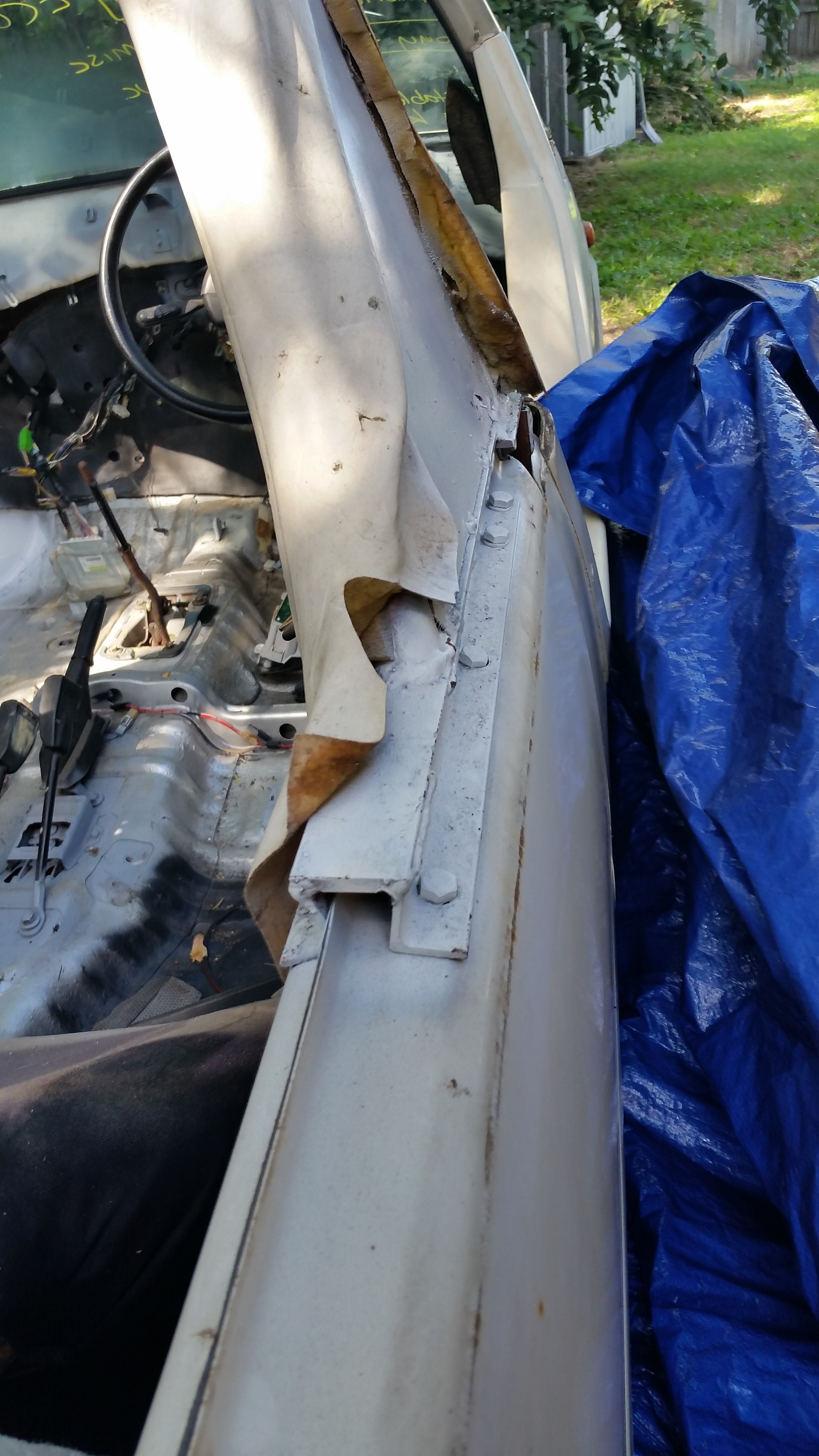

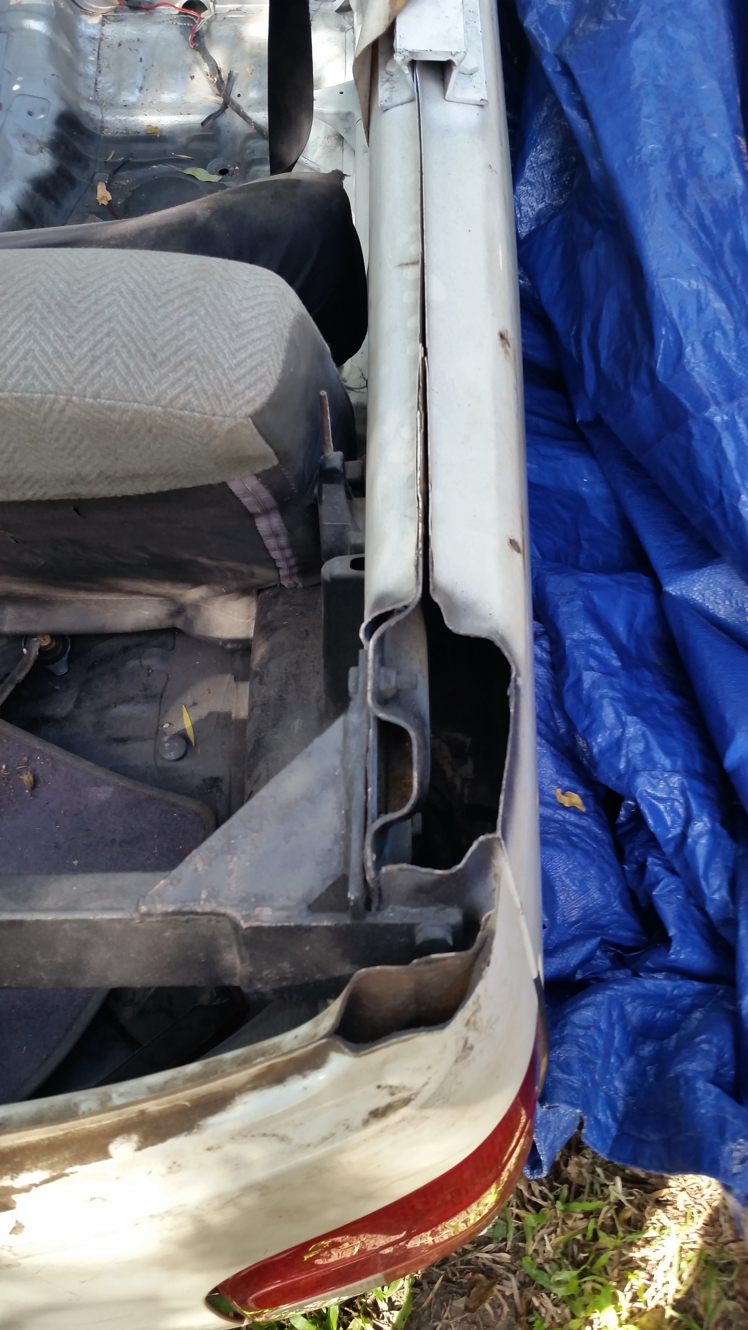

Just some pics while I have some of the fibreglass off to clean.
looks like the spot welds have broken apart
Serious Question, should I just spot weld or part weld or full weld of seams?
If you seem weld it it would be much stronger and wow seein one apart makes you a little more concerned lol

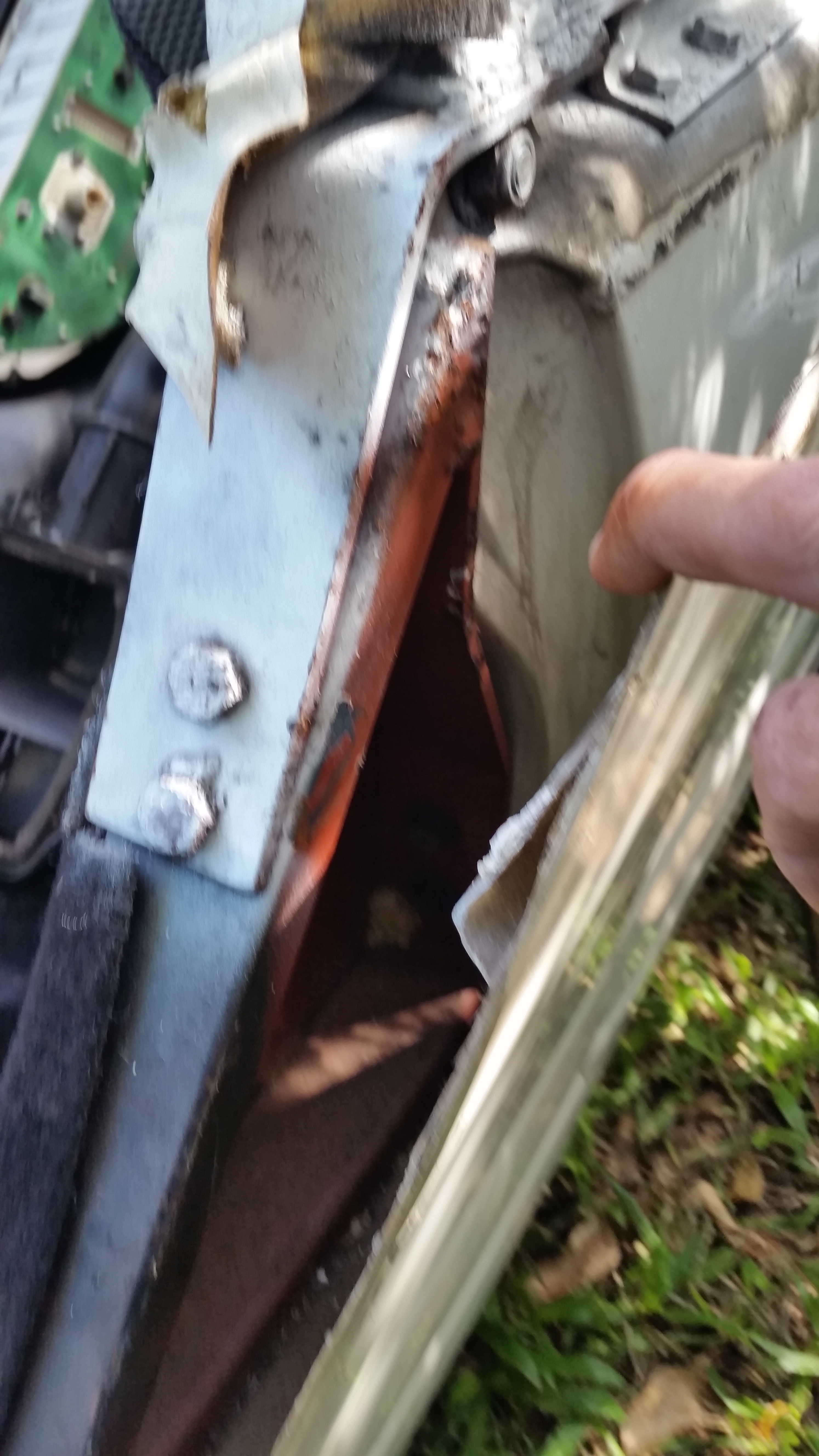

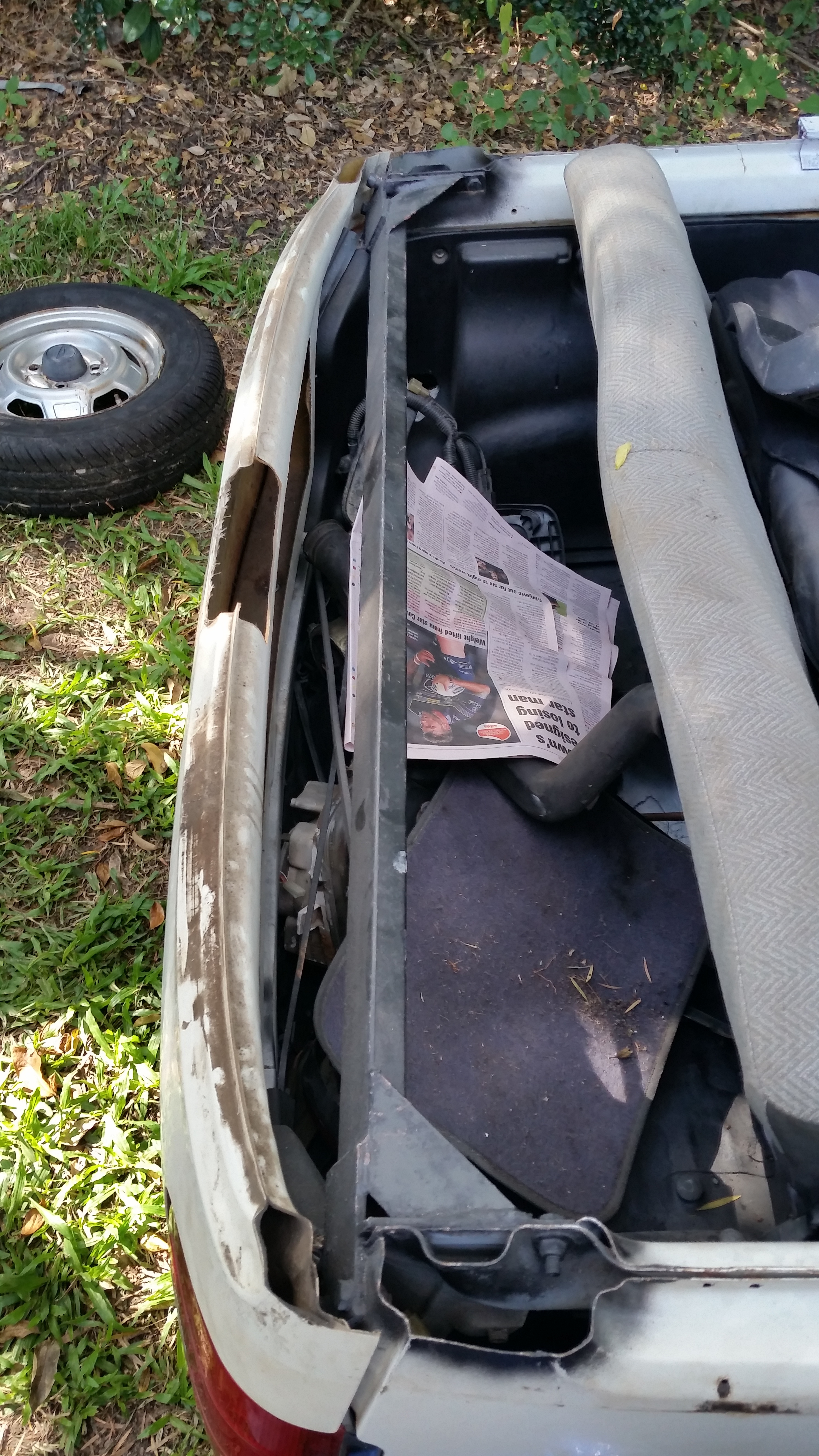

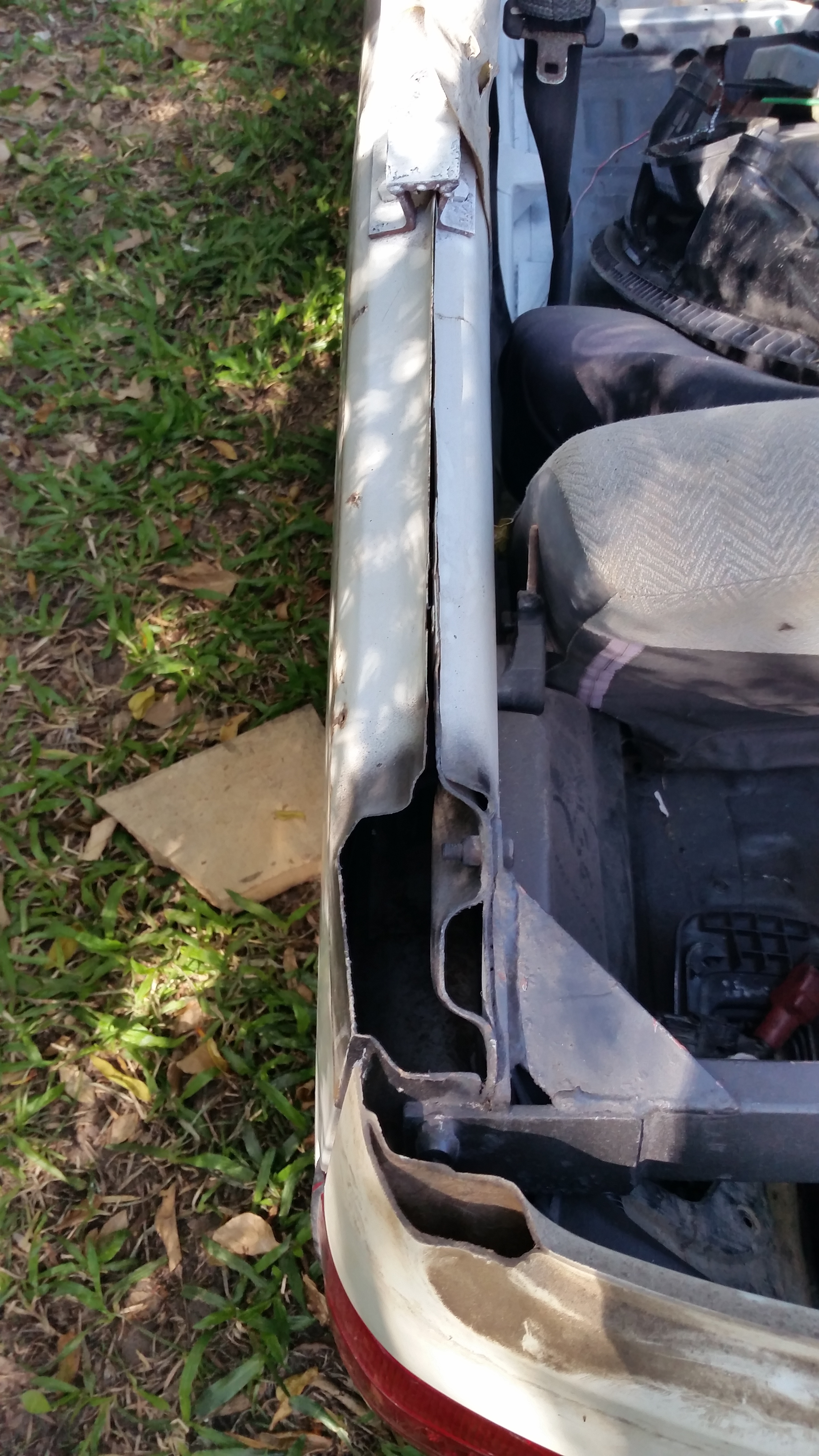

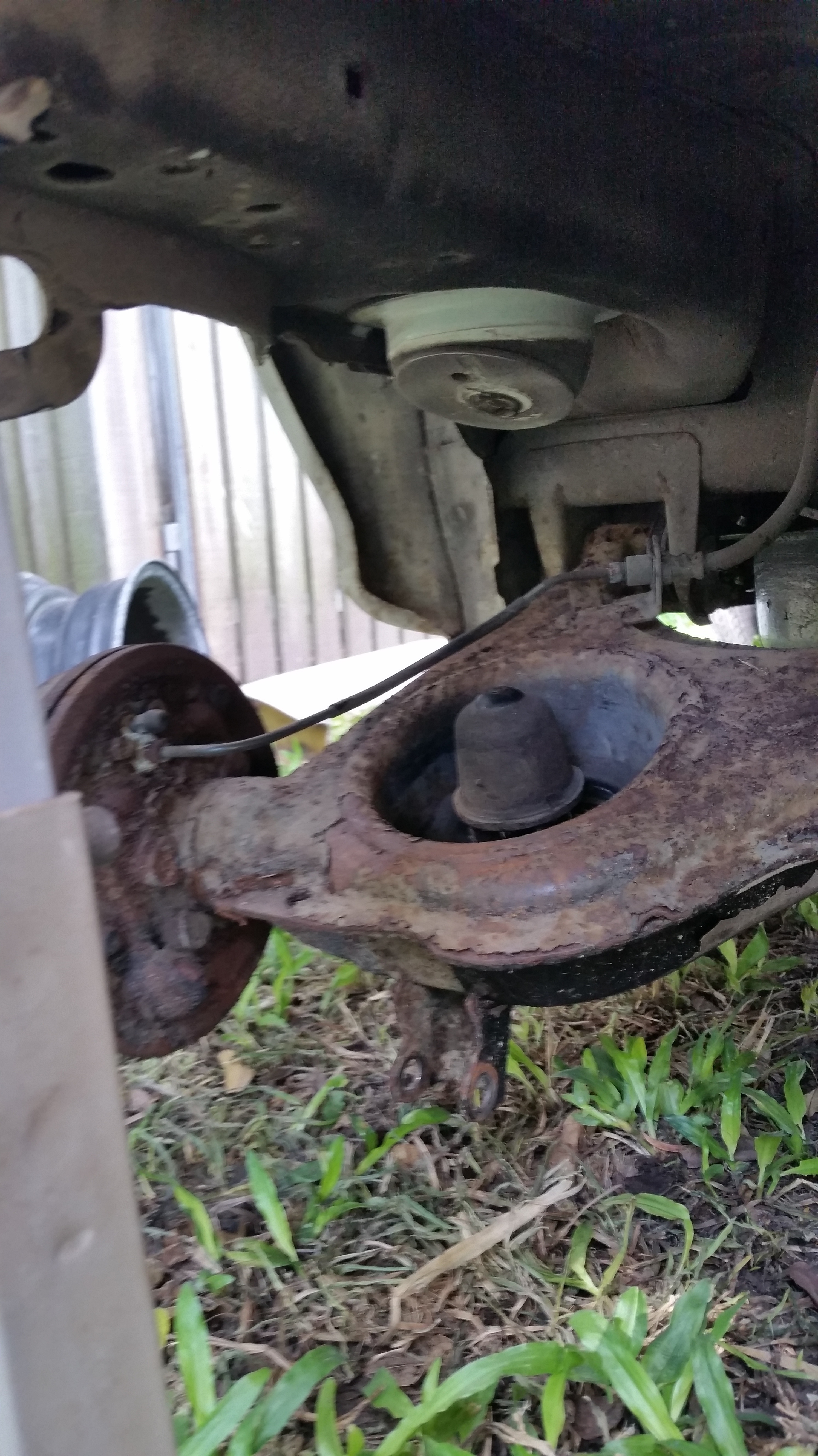

Seems better than the moke californian i owned, bracing is decent looking box steel both welded and bolted. Being more concerned so far with engine, wiring and cleaning bits, I had yet to look under the back end.
Oops something missing and also pretty rusty, could be why it was so low, I put it down to one flat tyre and one rim without tyre.

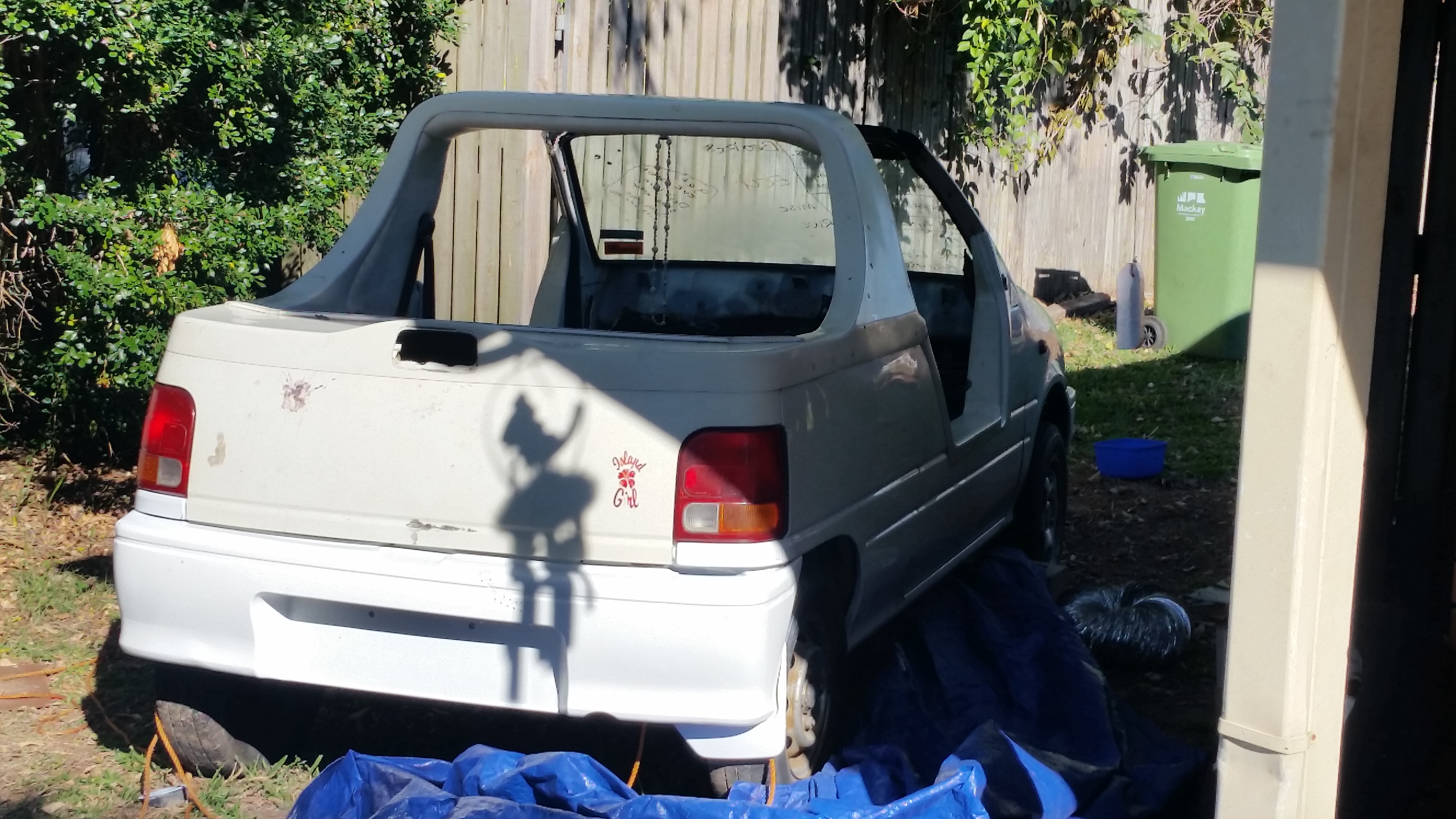

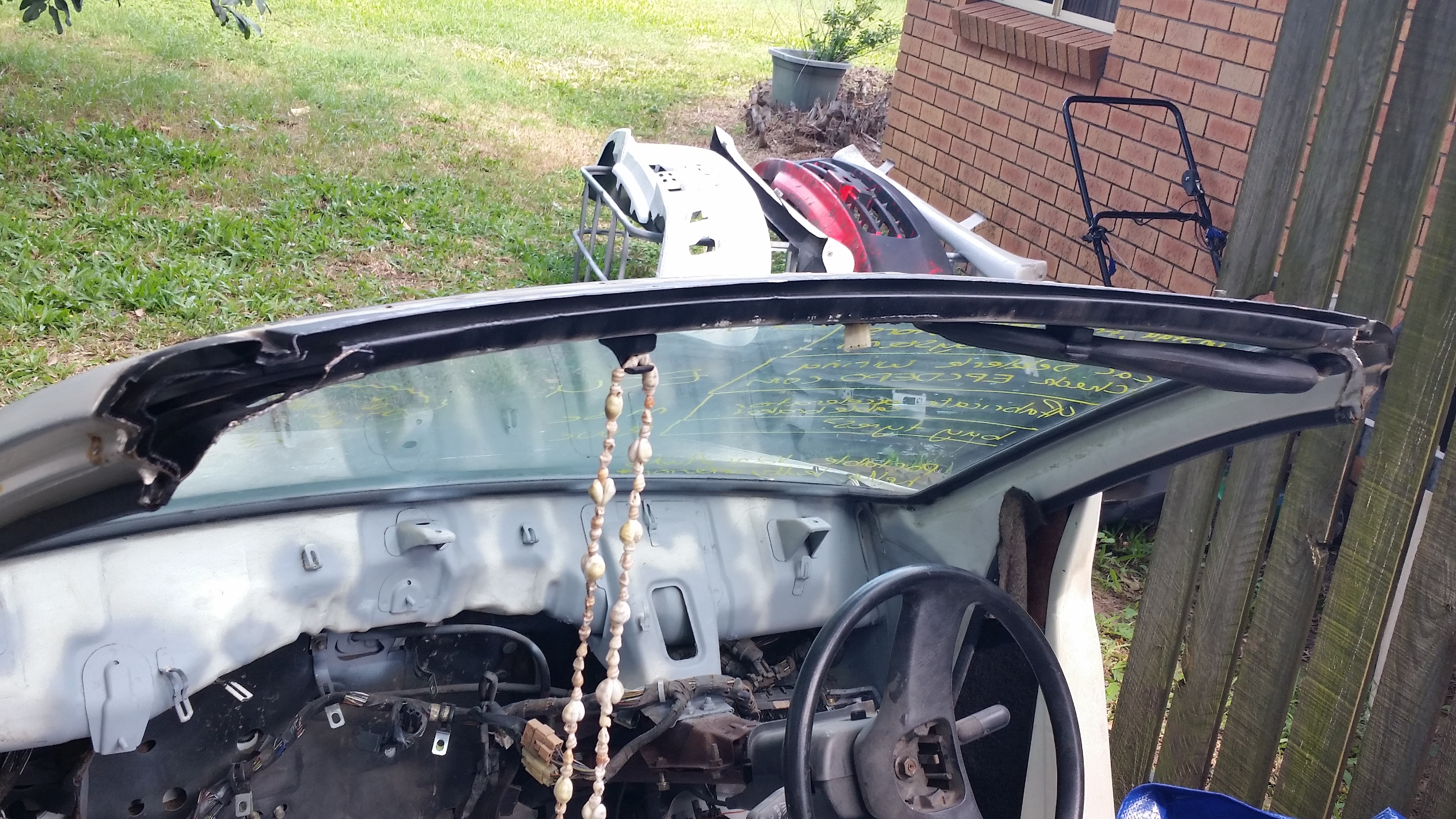

Also missing the fibreglass part on top of windscreen, this must have been lost on trip back

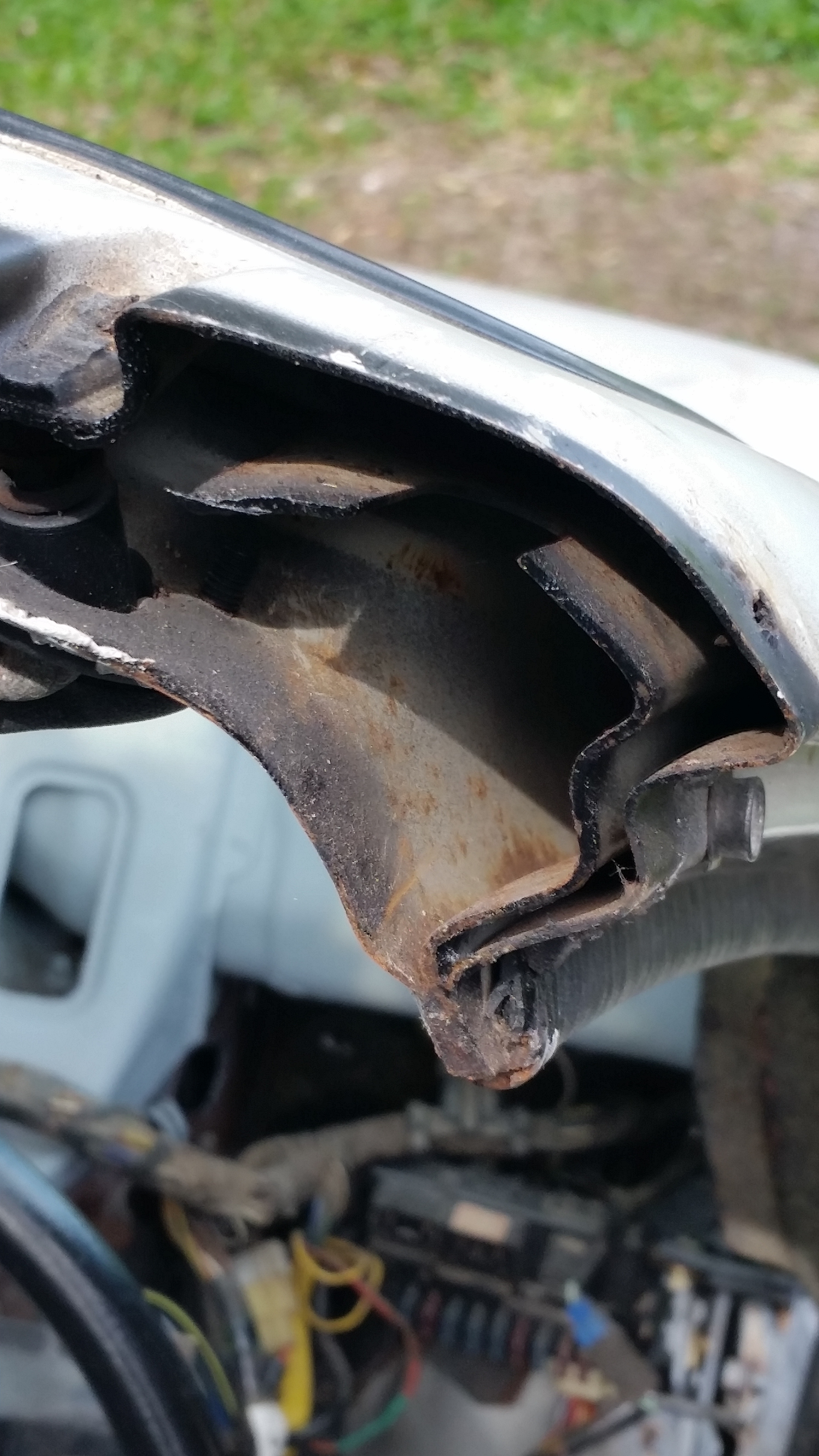

And a pic of pillar area.
Will be chasing a brace bar that goes under the dash soon also
You will need that brace the steering column etc bolts to it also

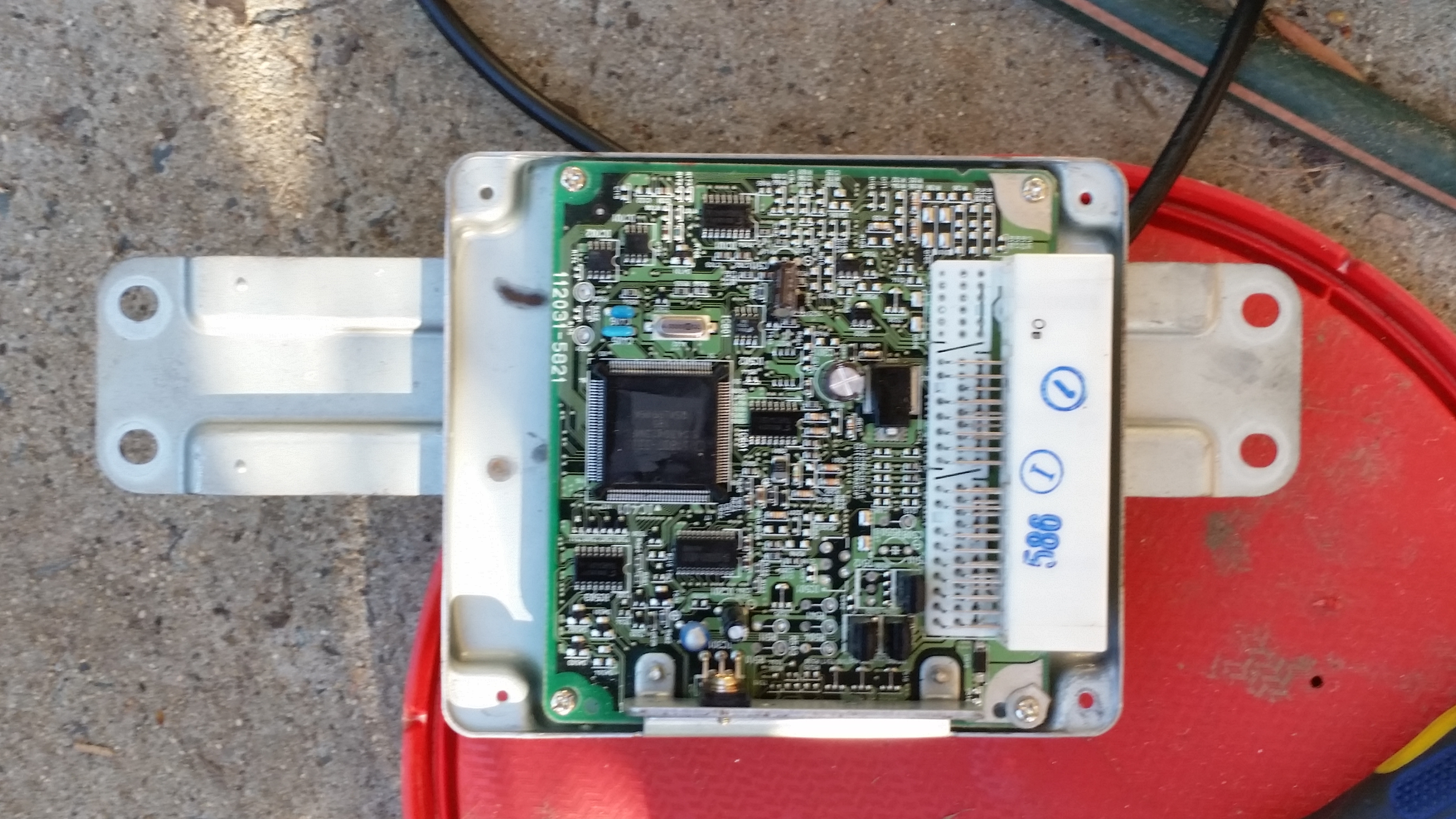

EJ ecu in EF case for ease of mounting back in

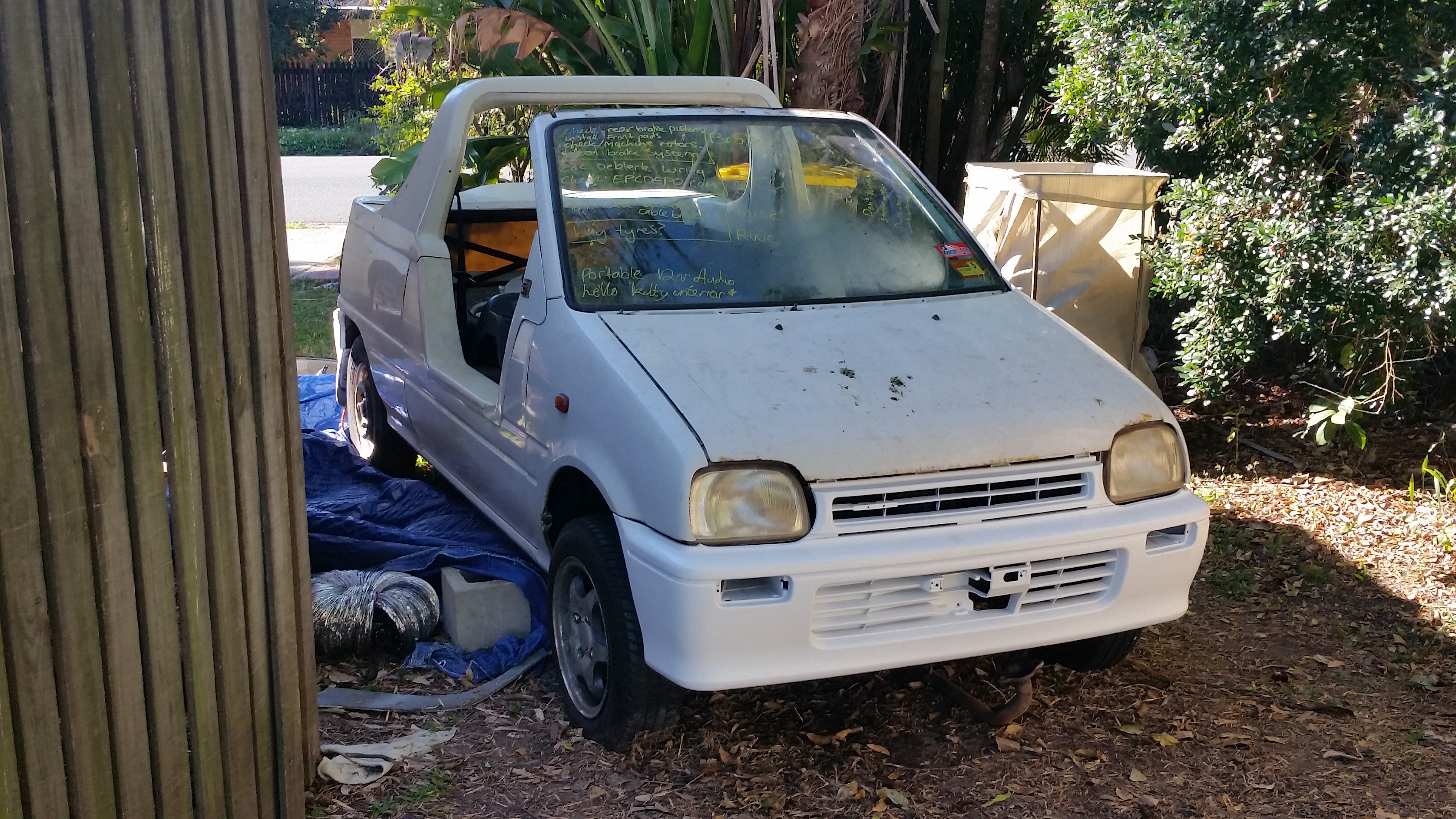

As i have found out, i have a series 1 front but series 2 headlights
the top of the grill doesnt quite reach to out the clips in
but still only a minor detail
Bumpers only painted with cans so not the best but will do til i try a full respray
