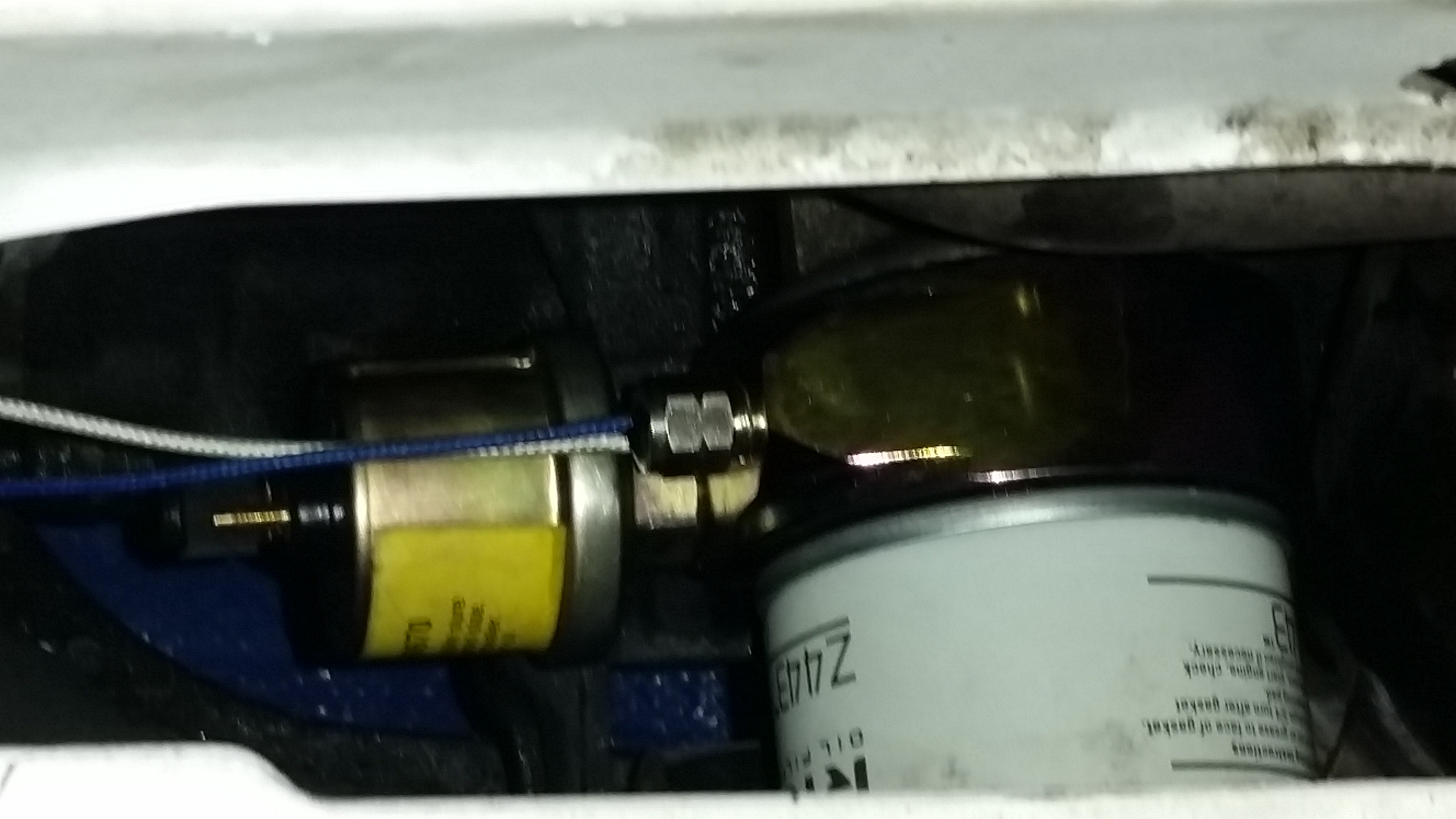

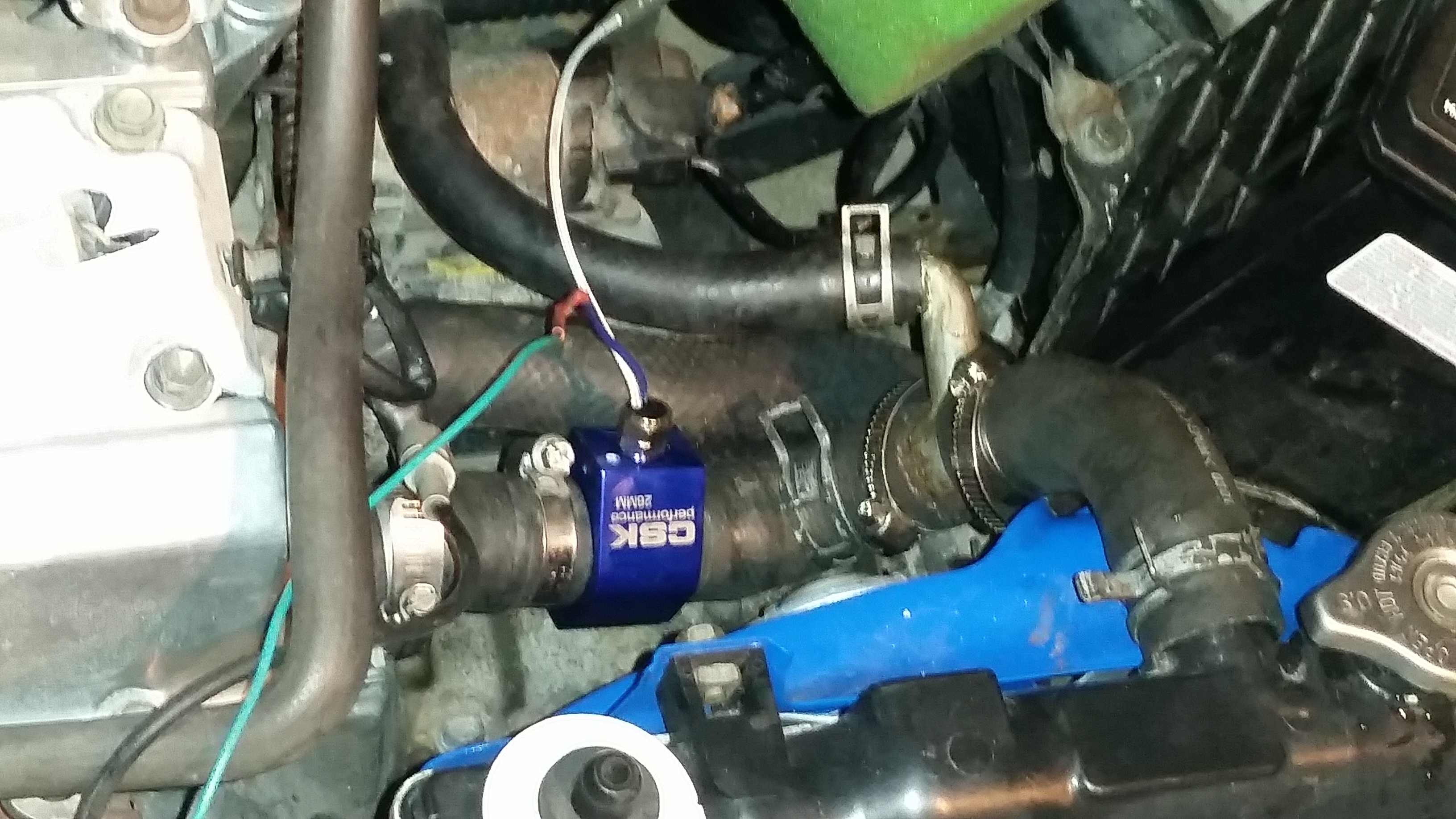

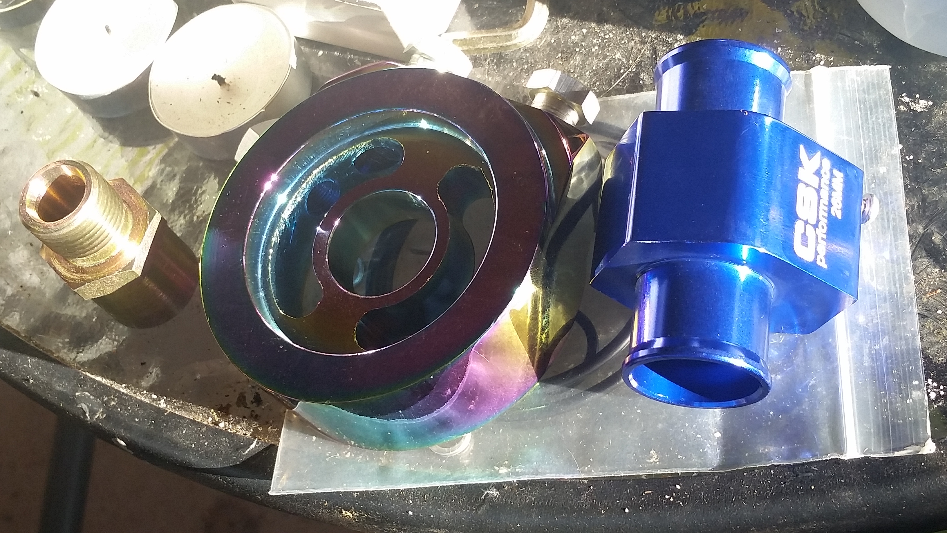

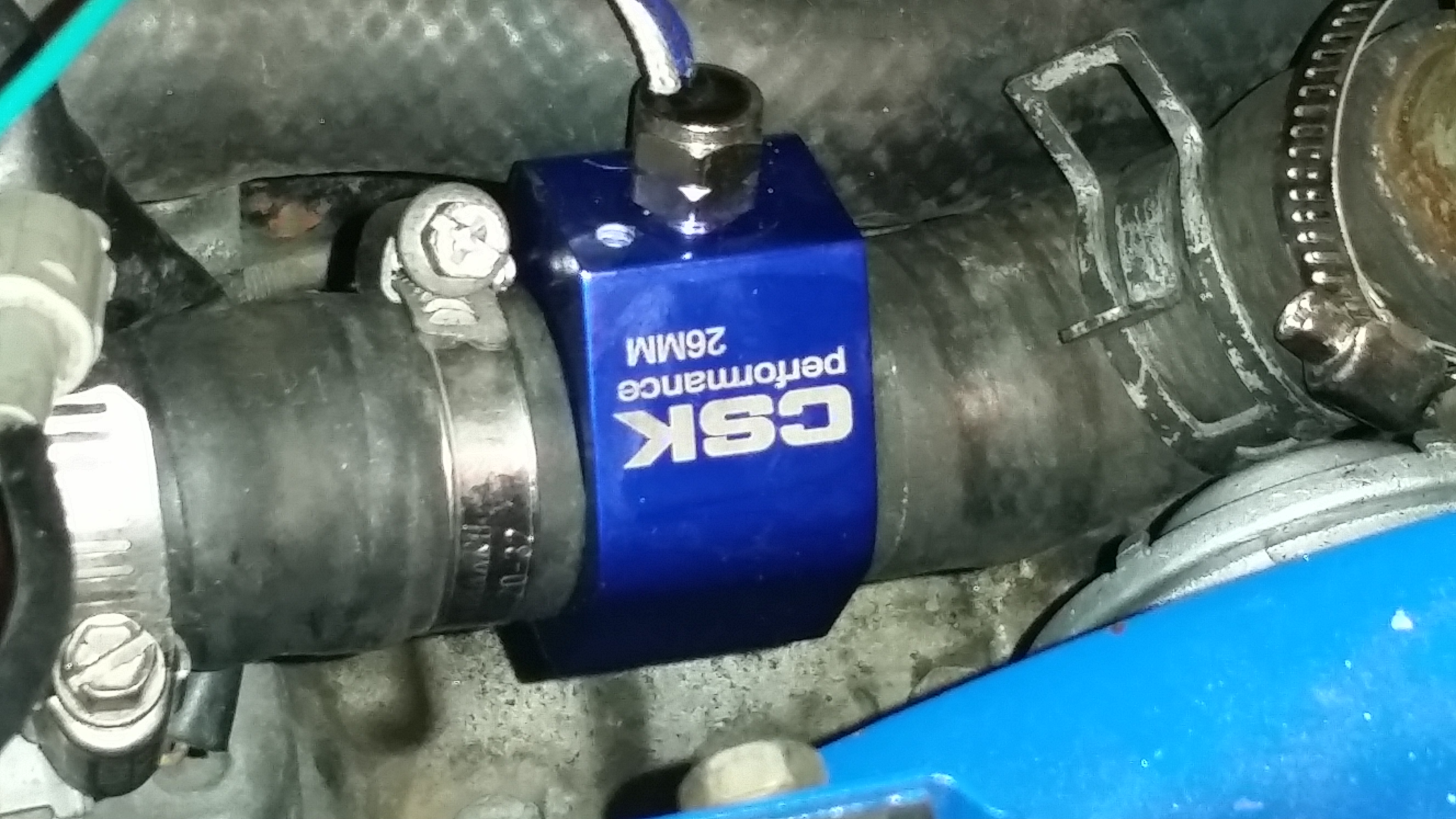

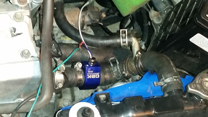

Bought some parts for the gauge setup, oil filter sandwich plate with extender for oil pressure and oil temp and water temp sender holder
not expecting it to be 100% accurate but gives me more of an idea than standard dash

Thats awesome @Mokeman I often wondered what size temp pipe thing to get. seems 26mm is the right one

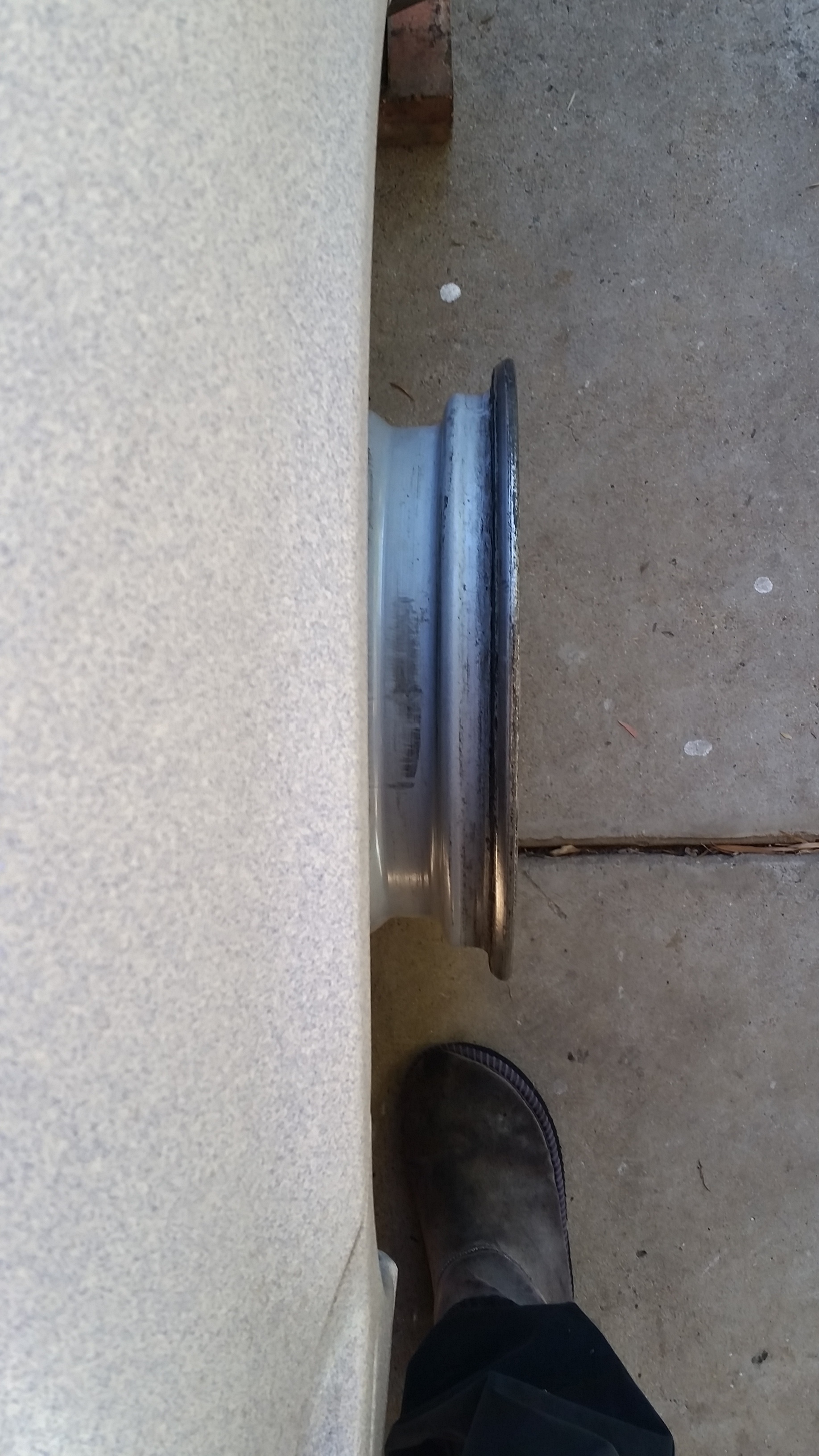

Interesting and that wheel sticks out a fair way.
I know, so upset at that, not

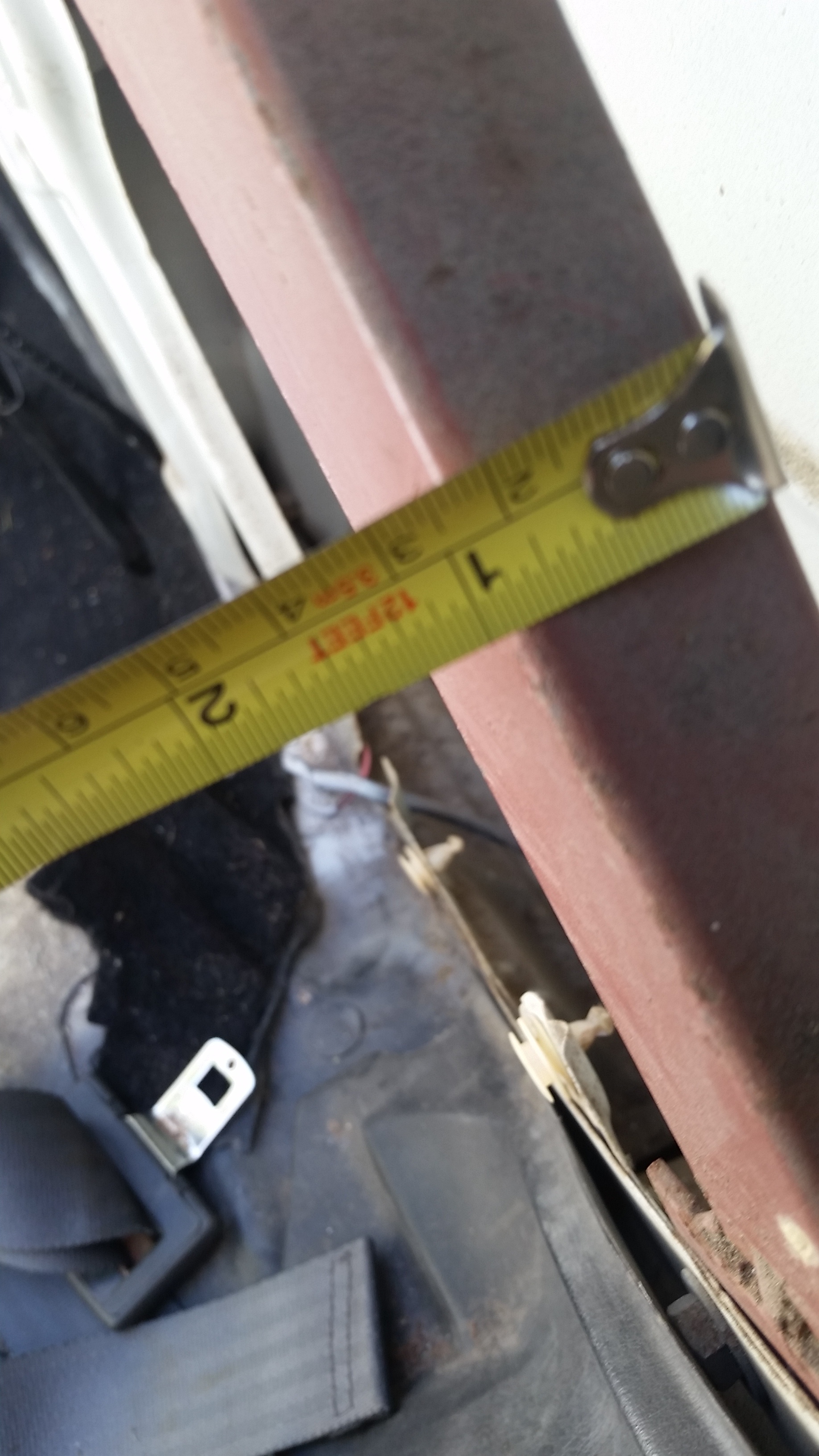

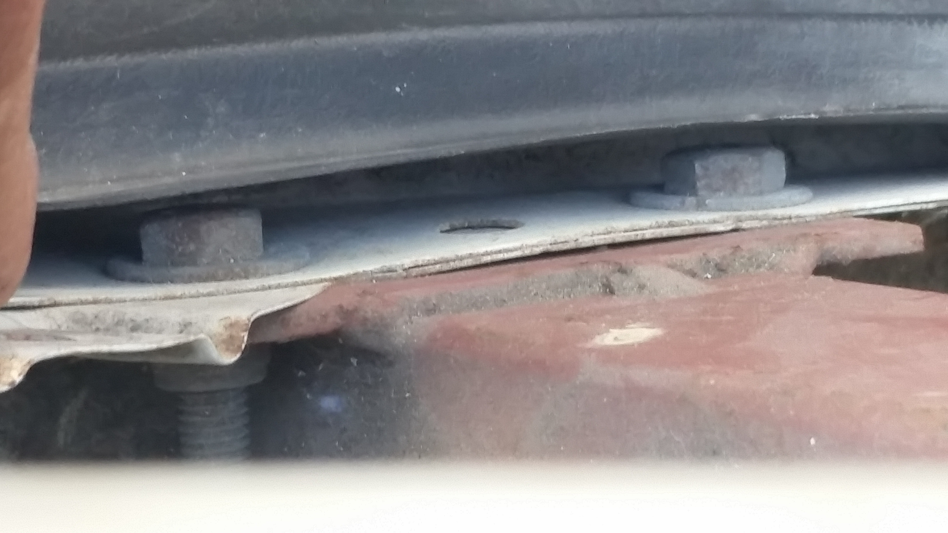

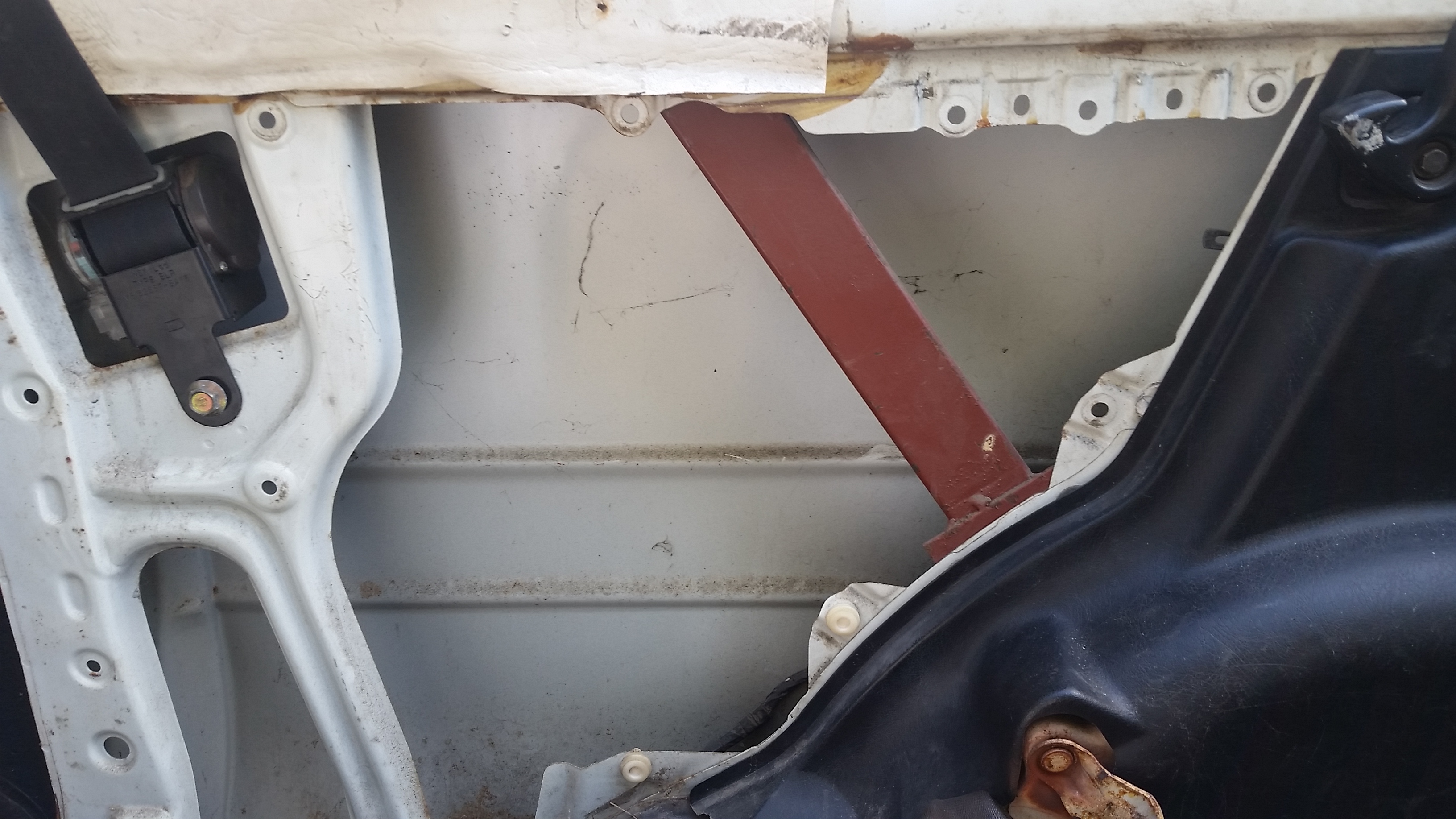

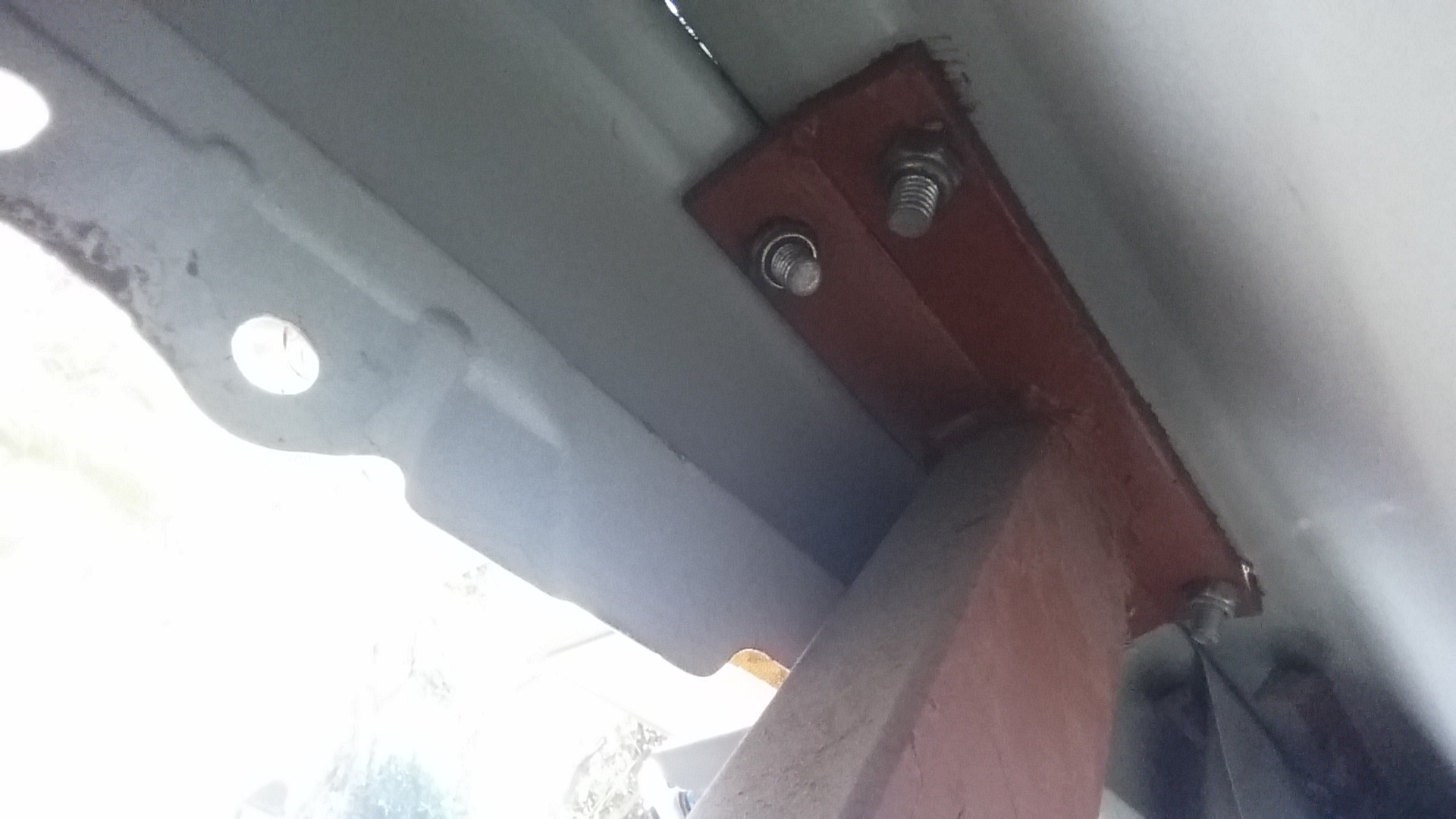

Few pics showing bracing in back for rollbar

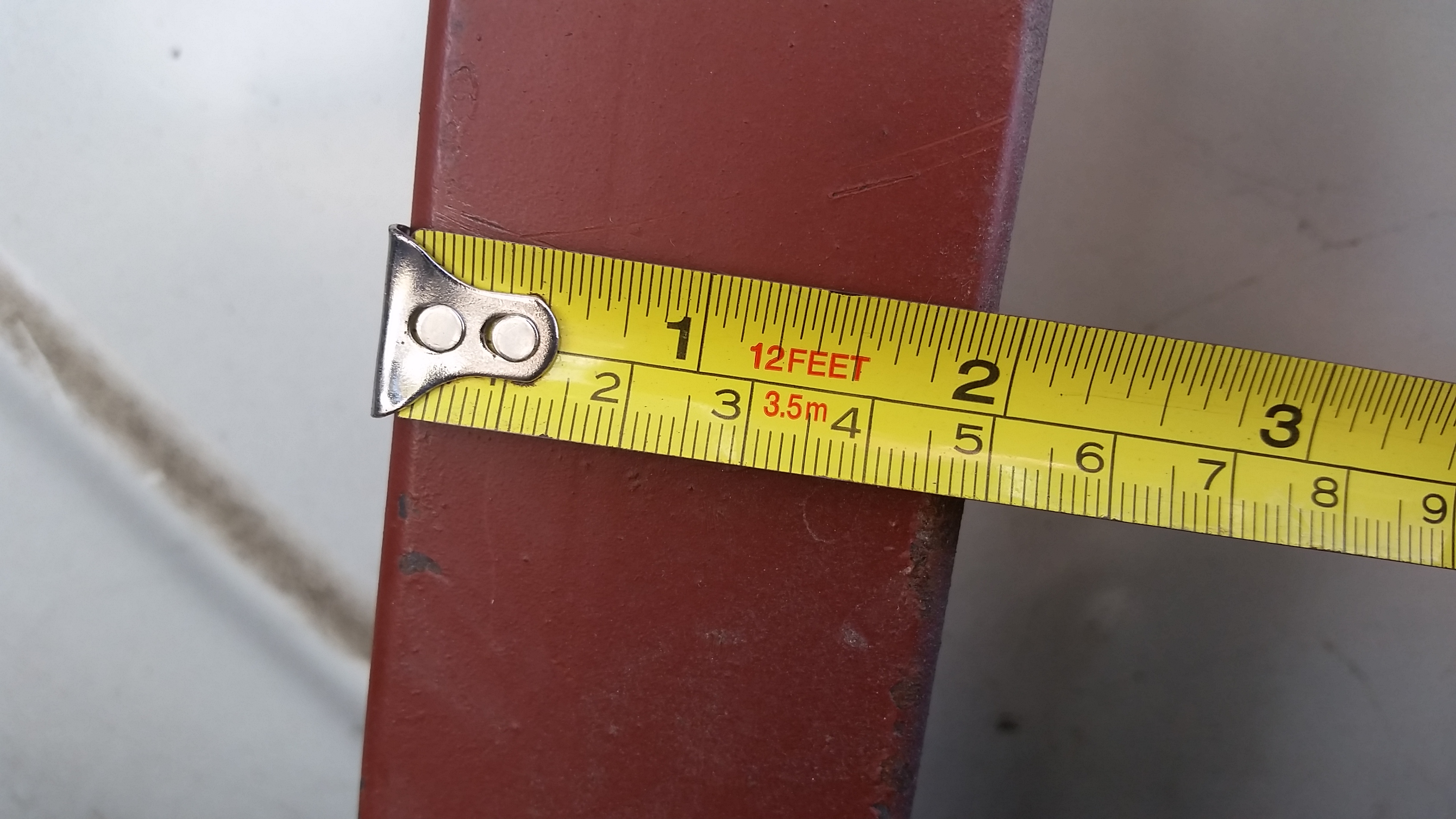

Interesting choice using square tubing.
May i ask why you square over round?
Was done by the original company, first time i have had them off since buying it
Wonder how i would go with the rear seat mounts:thinking:
@evilhighway it’s still just the two bolts at the front that holds the bottom in, standard four seat setup really. Undid the zipper on the back of the L500 seats, top part, and the metal pin that goes into side clips is just a 10mm thick piece of rod, wonder how i would go cutting it off and getting similar piece welded further down:thinking:
will stick out a bit but only coz l500 seats are skinnier. The other option was to weld said rod in and cut the middle bracket between the 2 top parts and add about 40mm piece of flat in between them but then couldn’t use original bolt holes, which it actually had by the way, middle bracket bolted straight in
