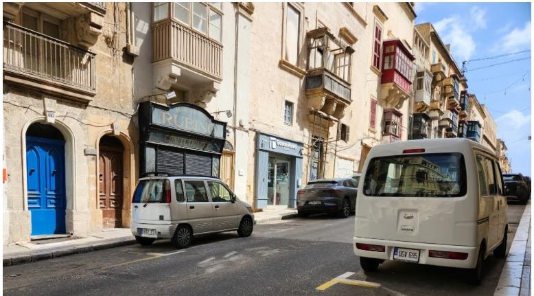

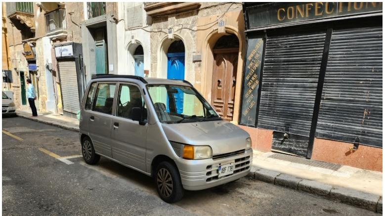

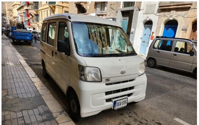

Might this one be one of them?:slight_smile:
https://www.curbsideclassic.com/blog/cc-outtake/classic-cars-of-malta-automotive-melting-pot-ford-morris-suzuki-skoda-etc/
