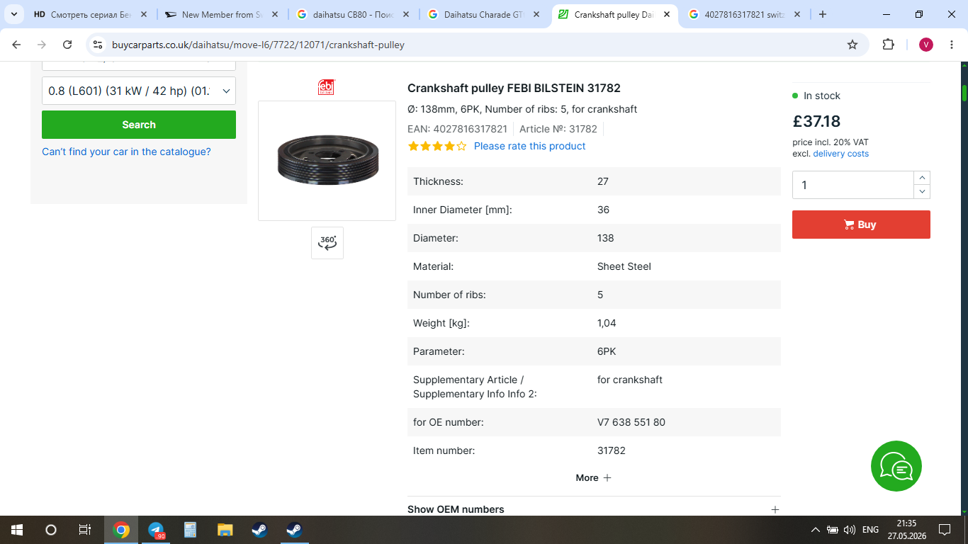

Hello! Is the engine ED20? Looks like this part number will fit 4027816317821
Try searching it and most likely you will find your local parts supplier to order all parts from

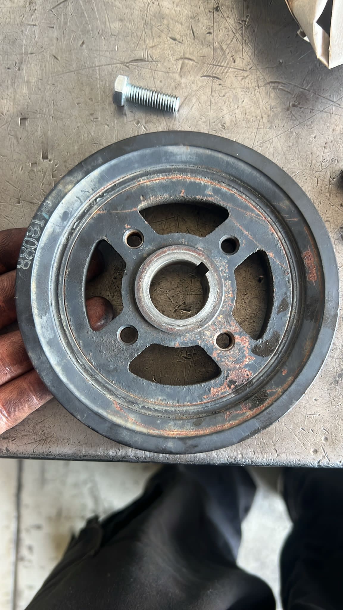

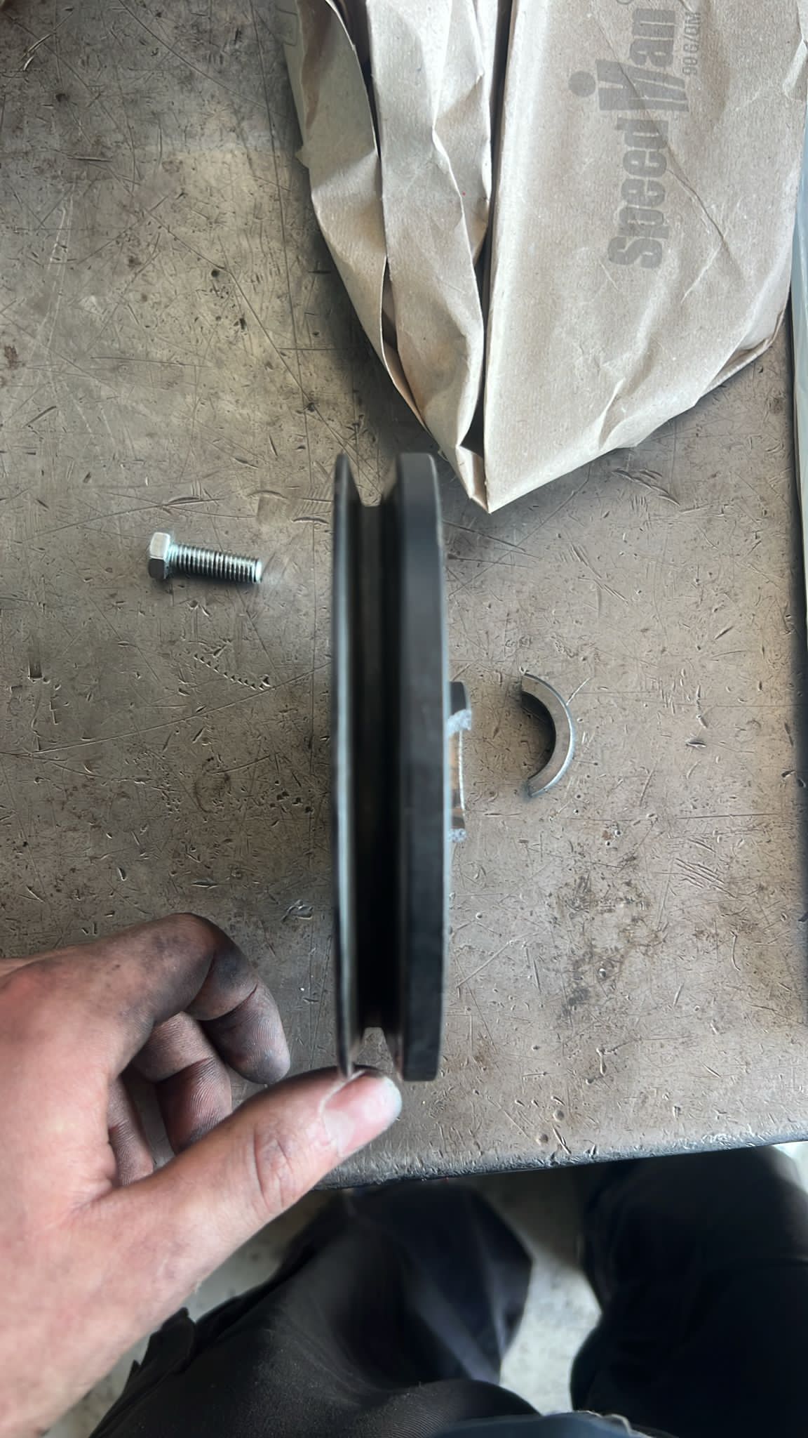

Yes it’s an ED-20 afaik but the part i’m looking for is this, with only one groove not multiple. If all else fails, i’m considering upgrading all the pulleys and the belt to one with more grooves. Thank you though!
Oh in this case you shoul consider other way, leave this belt and order machining this pulley solid. Lack of holes should be nie problem, quite easy task for machine shop
