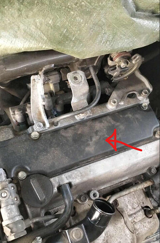

if you take off the intercooler then underneath that on the rocker cover is is a black plastic cover take that off and the coils and plugs are under there.. Actually before doing a compression test it may be worth testing the coils first. It will be the same as when you test leads but there is little plugs on the coils. When car is running just unplug one if it runs worse great, if not there may be an issue with that coil or sparkplug. Then do the same with the others but always have the other 2 connected when doing so.
Do this before doing a compression test. as far as the turbo actuator. I am guessing you mean the one that is close to the timing cover?

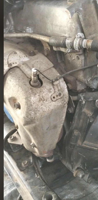

Another weird condition: in taking off my turbo I had to unbolt the catalytic converter from the back side- it is quite rusty and rough looking- it has 1 (single) O2 sensor (shouldnt there be 2?) and the exhaust pipe was attached to the bottom of the catalytic with just one bolt -leaving a gaping leak there. Then the tail pipe was chopped off roughly around the drivers door??? I’m curious if all of that nonsense could have a part to play. I added a bolt to the Cat/Exhaust pipe connector to tighen it up and it honestly ran worse after I did that! Got me thinking the Cat could be plugged or something? Maybe I should try a straight pipe? And shouldnt there be an upstream AND a downstream O2 sensor? That could be a major issue perhaps?

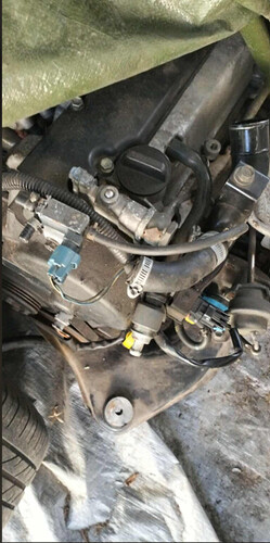

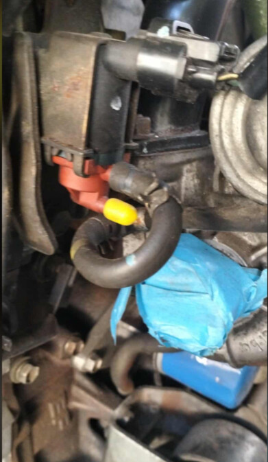

Above is my vacc lines for the sensors etc at the front of the engine. Remember my efdet is a fwd model. I presume yours maybe rwd?
the next pic it shows the black cover that hides where the coils are,
The one below shows I only have one O2 sensor

Thanks for the help and the pictures @evilhighway my routing is the same as yours for the little waste gate control lines (I assume the yellow capped one will go back to your intake when its put back on?)

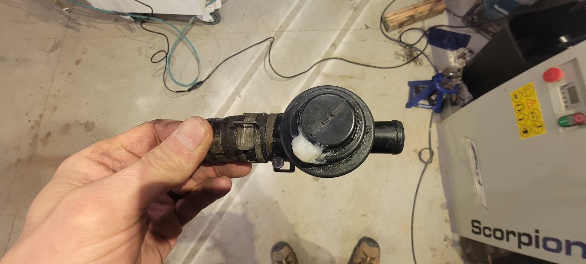

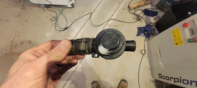

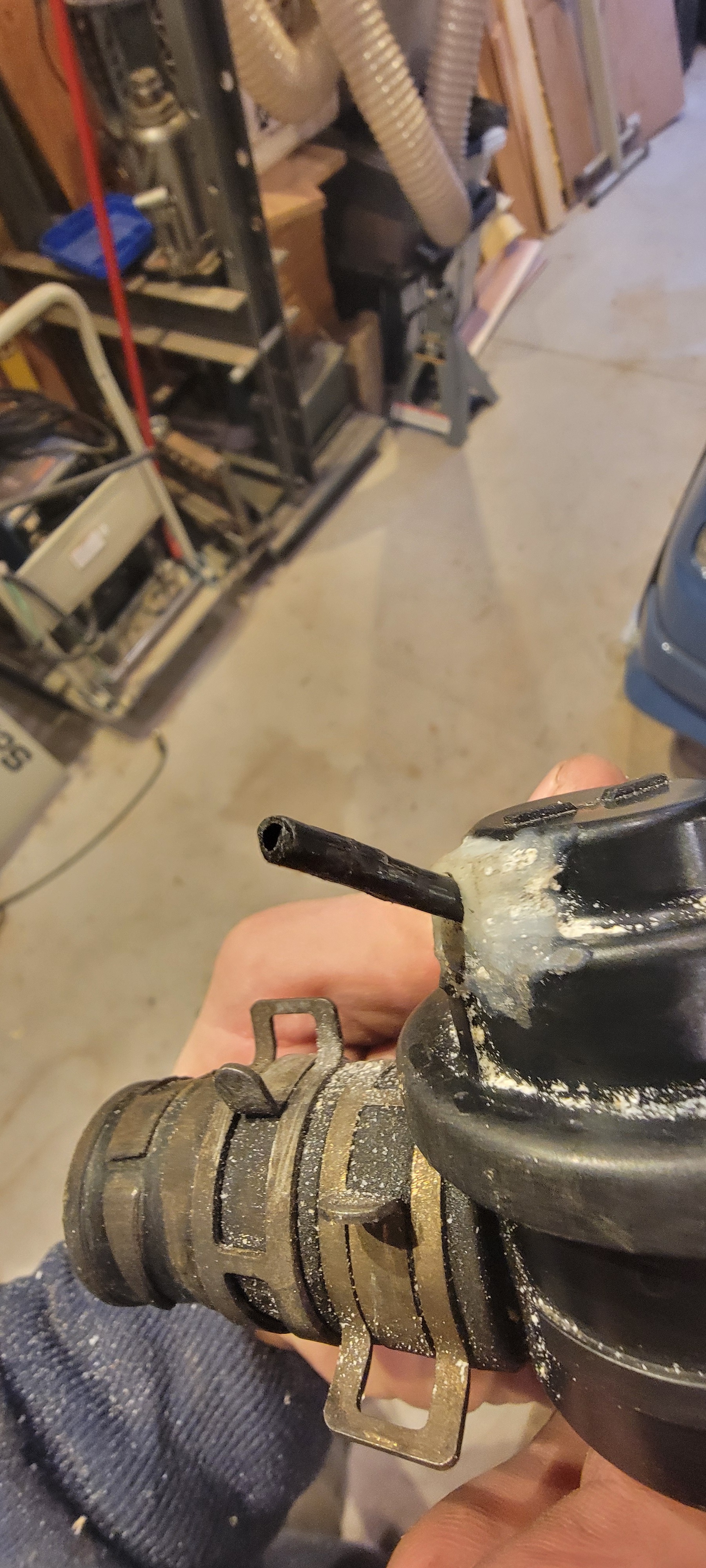

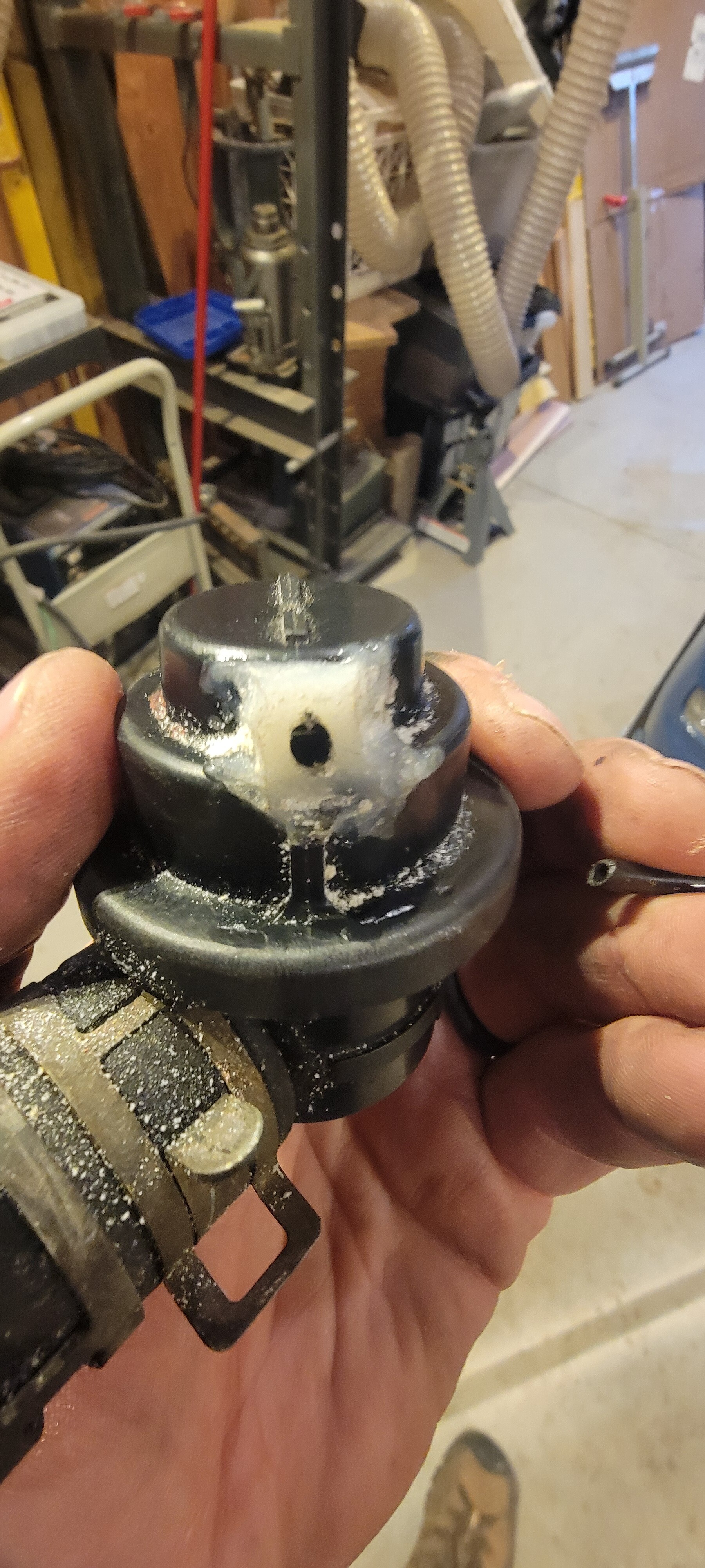

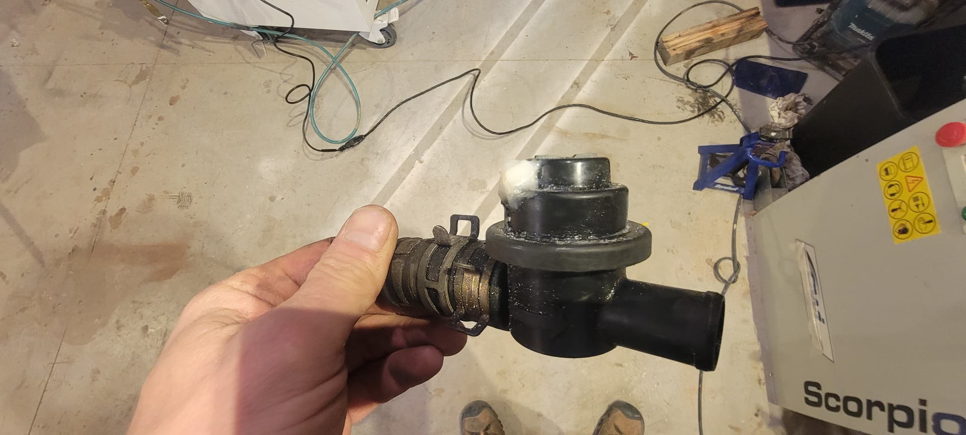

Also I broke my blow off valve vacuum line nipple! May try to epoxy a fix on it.

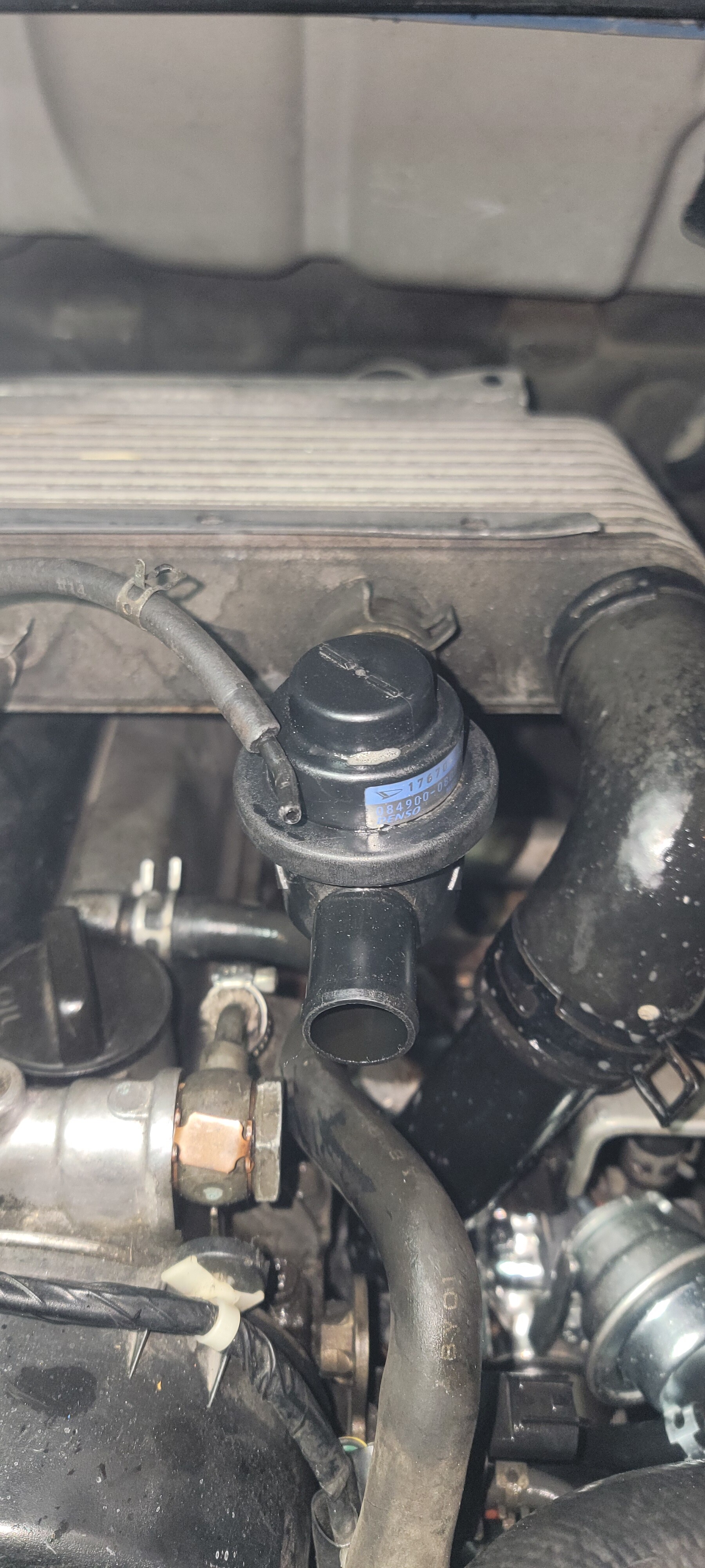

Diverter valve (DV)
Blow off vents to atmosphere
Looks similar to other japanese cars of turbo era. I have identical from Probe GT (mazda 2.2l)
Anyway this is not necessary to idle/running. You can shut it completly till you’ll find new one, but surge will occur. Dont push too hard while deactivated
Epoxied a fix
