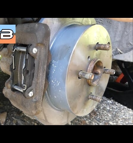

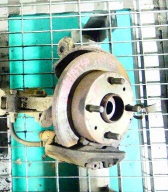

Dunno how is it at other markets, but as a Yaris TS owner I instantly noticed that front cuore brakes seems to be yaris/vitz/echo rears:
Dai
Koyota
Also due the diferent shape (like non slider, oposite piston caliper lookalike)
It is mounted via adapter from factory:

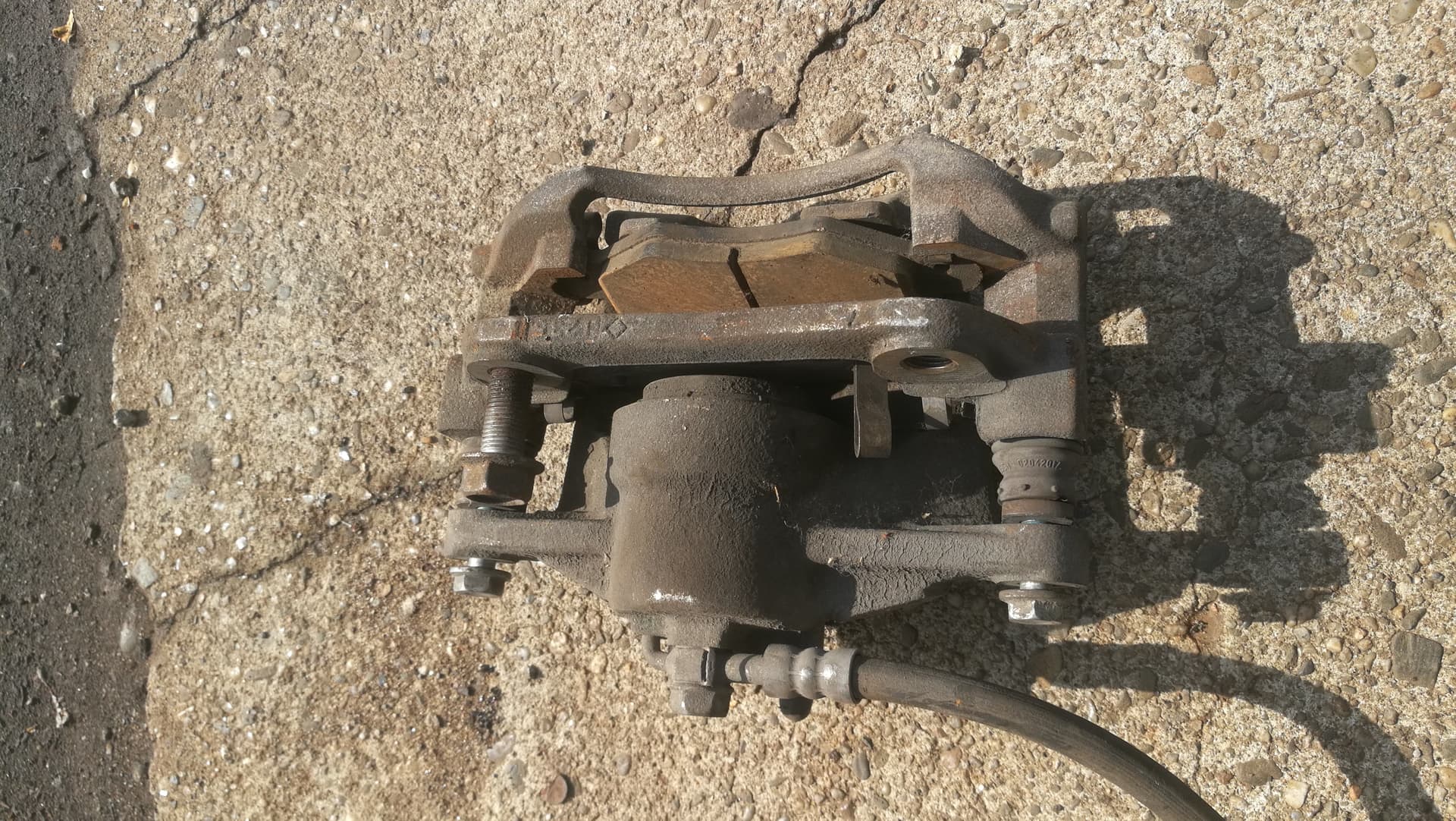

Hello there, okay:
Yaris brakes dont fit to L700 cuore
Different mounting holes spacing. Also, bracket dont have “cutout” and cv joint/ hub bearing “bulk” is on the way
Thats funny, dais was hugely unified with toyota at that time, I’m kinda conviced that M300 sirion uses front yaris subframe…
Okay, case closed, will post measurements during upcoming brake swap.
Phot of 1gen yaris front brake by Bosch
