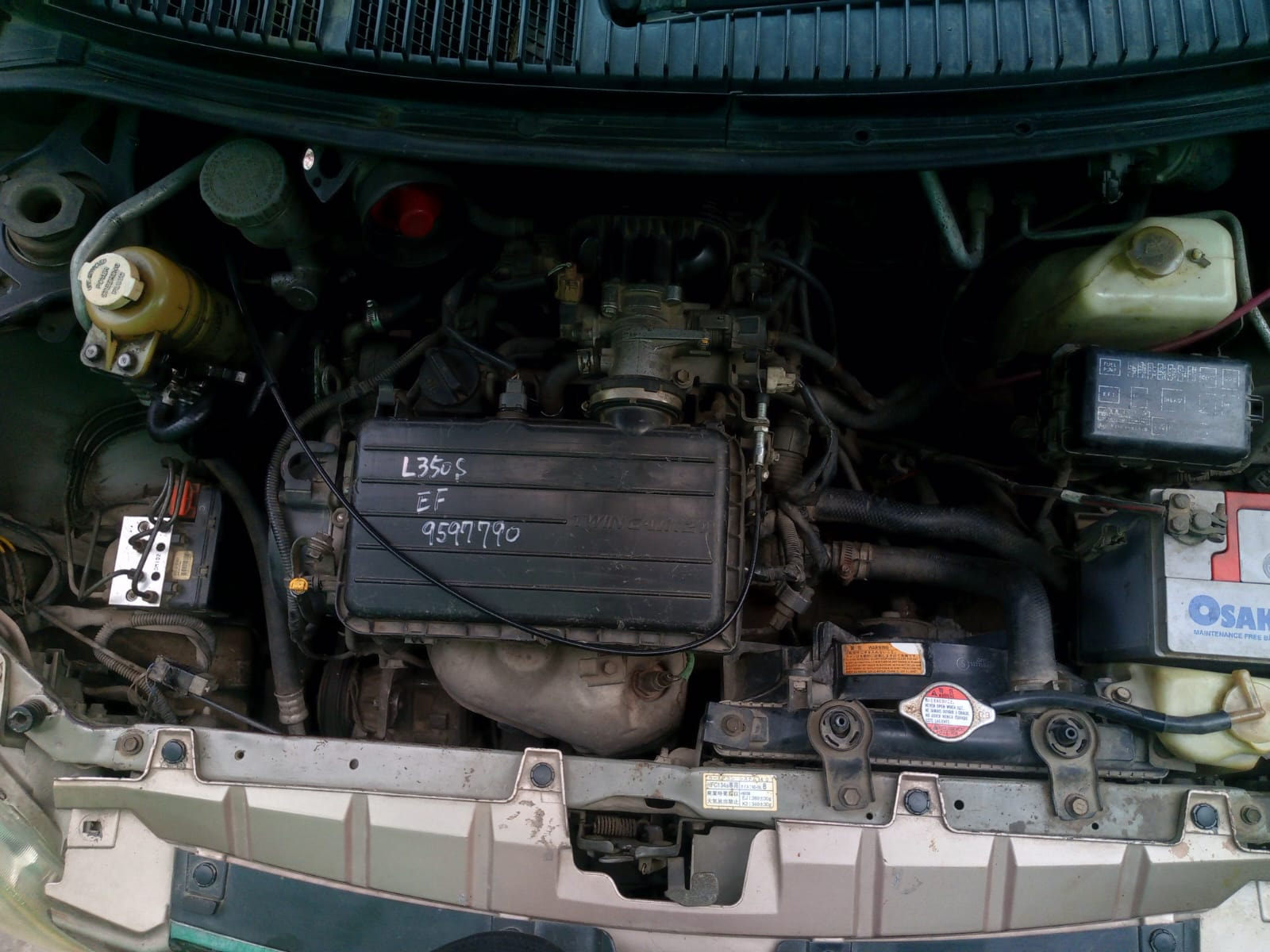

Hi, I looking to find PCV Valve in Daihatsu EF-VE Engine. Does it have it or not.
Not just a tube only KF and KR has it
Is there any way to check whether its PCV system is working correctly or not
remove the tube at valve cover and feels if there is air coming out
