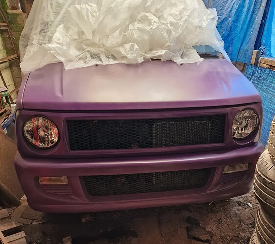

Next i carried on with front end changes, along with paint. Again on a strict budget.
Removed front fog lights (strange fog lights considering they are level with headlights)
I then cut a big hole in front grill panel.
Then i made my own modified grill.
I also modified the bumper, cutting out the centre section.
That gives away the colour.
This is finished front end.
Front indicators/turn signals cleaned up very well.
Left hand or right drive vehicles in Netherlands needs fog light the middle or left.
Not mandatory to be mounted on the left.
Only after 1998 it is mandatory here
Only mandatory in uk on rear from year 1980,

A couple weeks ago it actually made it outside, more paint needs to be done, but it runs ok (apart from eml)

Did this, to busy my head with something else for 5 mins. Yes the paints crap, but it’s MY crap paint.
