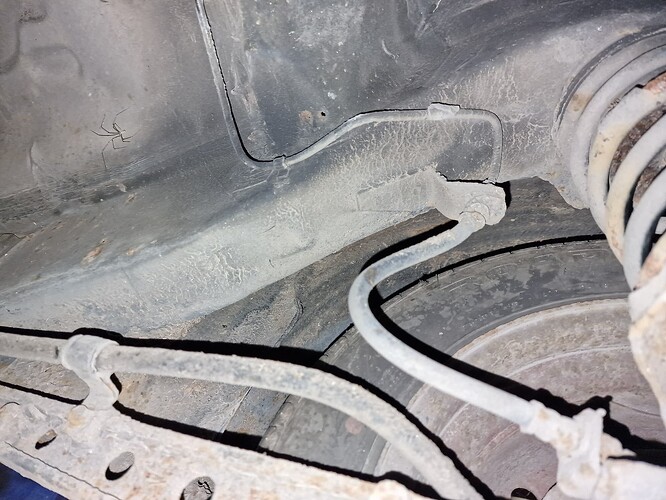

Once i got erv home, took the obligatory photos, (previous pics on sale ad) she’s pretty solid underneath for a uk kenari, especially for nearly 100k miles.
![20231007_135541|375x500]
(upload://rLlqwxtDif8tgq9NkMxyxSbGjDP.jpeg)
As can be seen, 1/2 the exhaust is missing,
Investigation into overheating was priority.
[quote=“OlddorgWorkshop, post:7, topic:6818”]…she’s pretty solid underneath for a uk kenari, especially for nearly 100k miles…[/quote]The previous owner more than likely avoided driving on salted roads, during winter. If you do likewise, it should stay solid. However, the body construction itself is prone to hiding pockets of condense water of which can rust through places not affected by external weather conditions.

I can guarantee its been driven on salted roads, you could not do them miles in uk without.

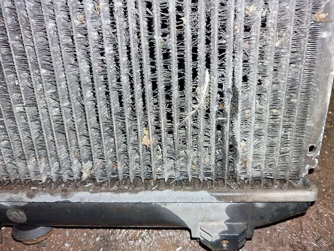

First job was to replace radiator, original was absolutely knackered.
New one sourced for i believe £35.
Fan was refitted.

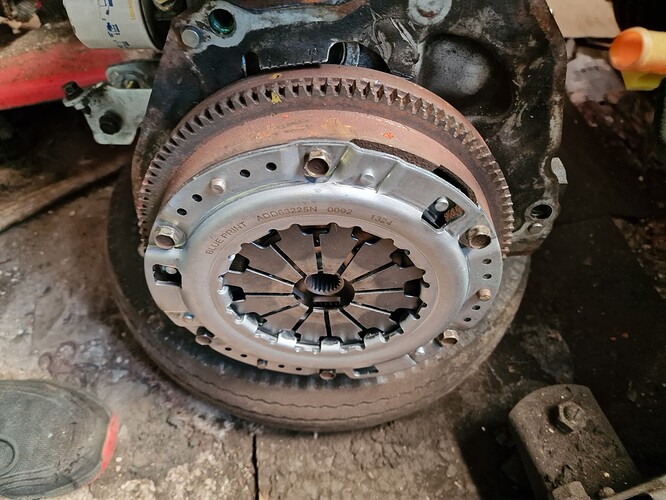

Autobox removed, flywheel from old engine fitted, along with a new clutch.
Then thanks to advice i think came from fb livetodai page i managed to fit release bearing and spring.

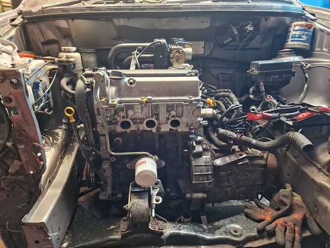

Then finally fitted replacement engine.
