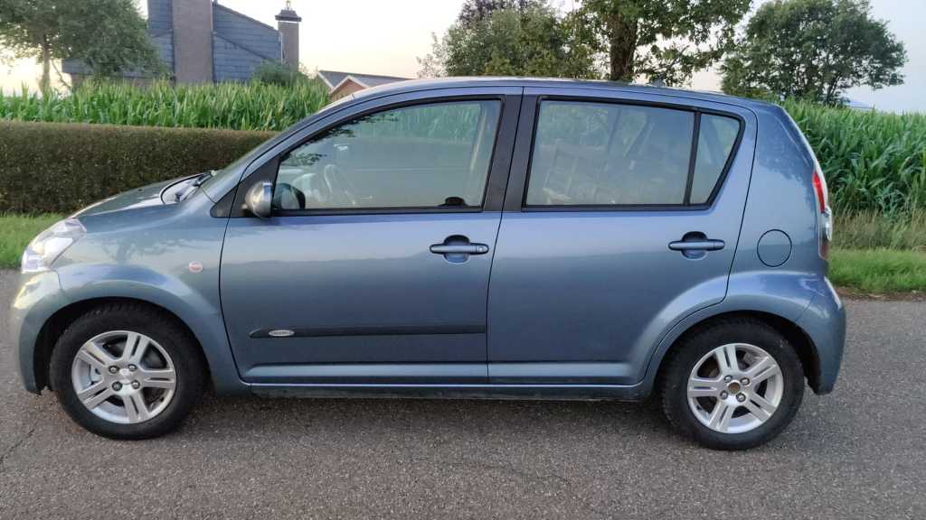

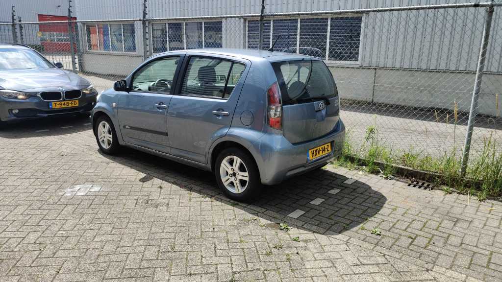

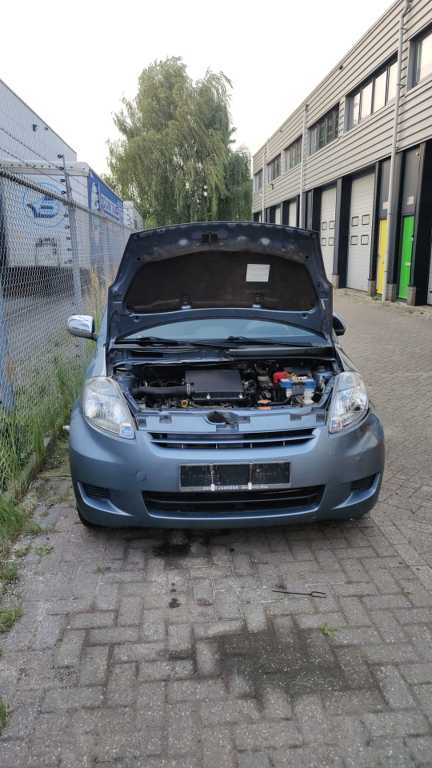

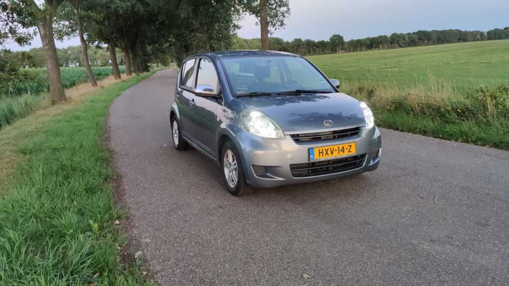

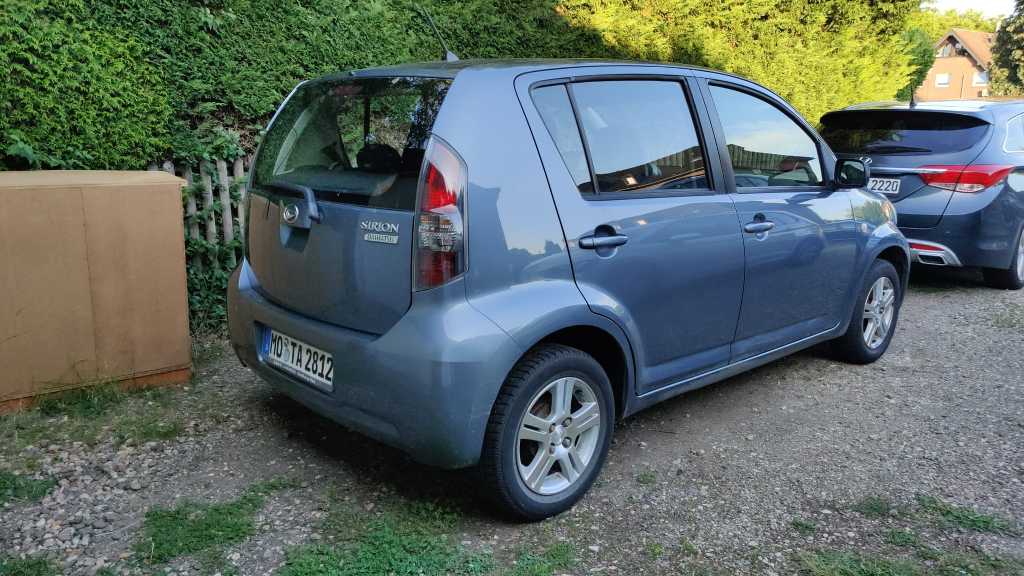

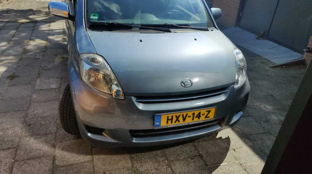

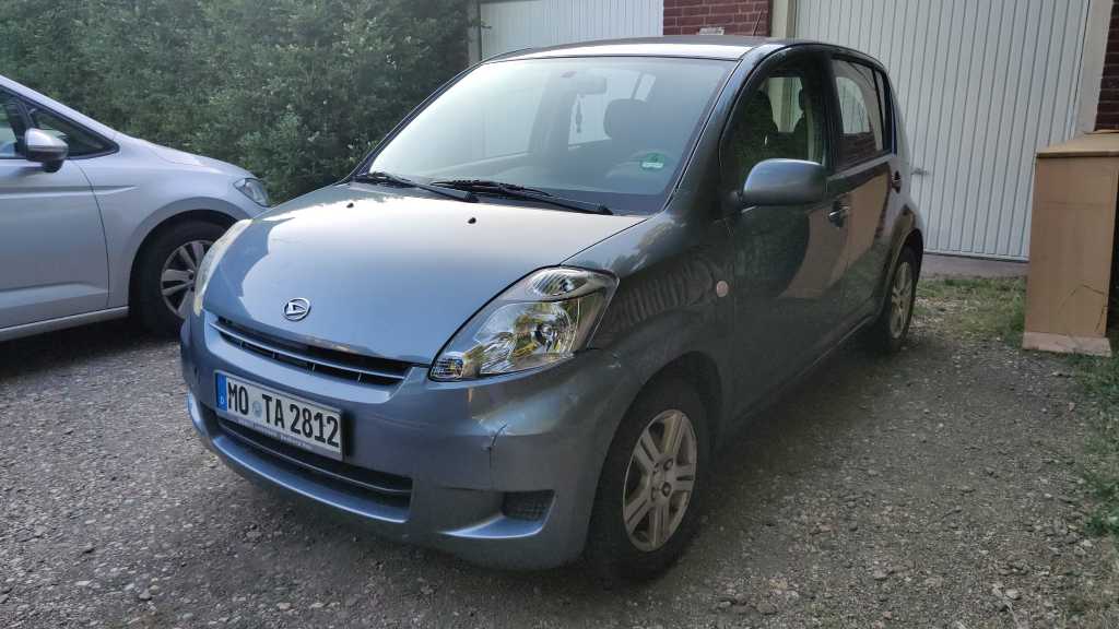

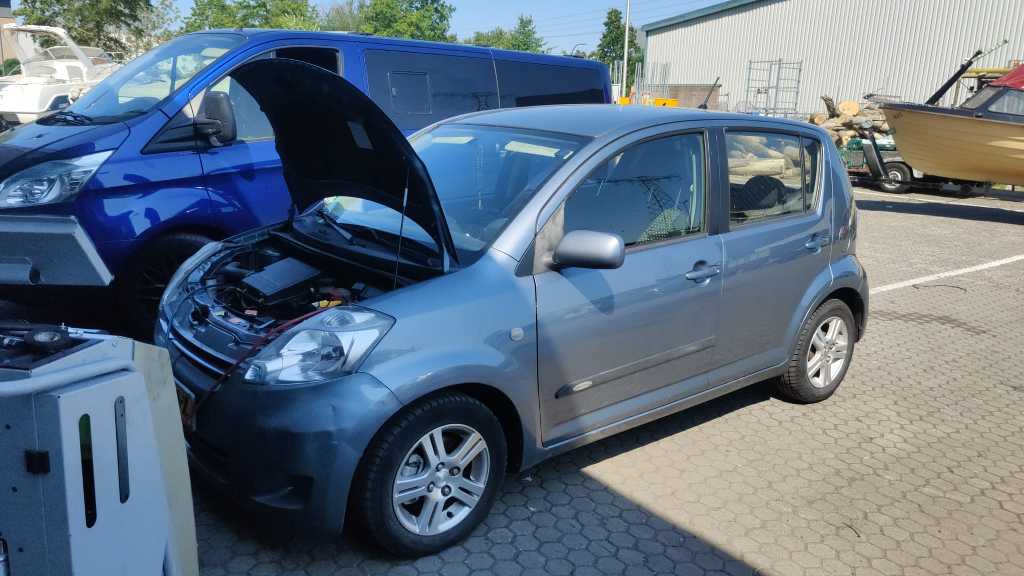

Project Kamp-Lintfort 2008 Daihatsu Sirion 2 M301 1.3

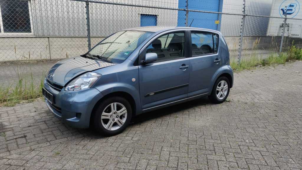

So I towed this Daihatsu Sirion 2 back to sell it.
It was a bargain as it was for sale since March 2025 and didnt sell
Well good news my GF wants it so its kept inside the family

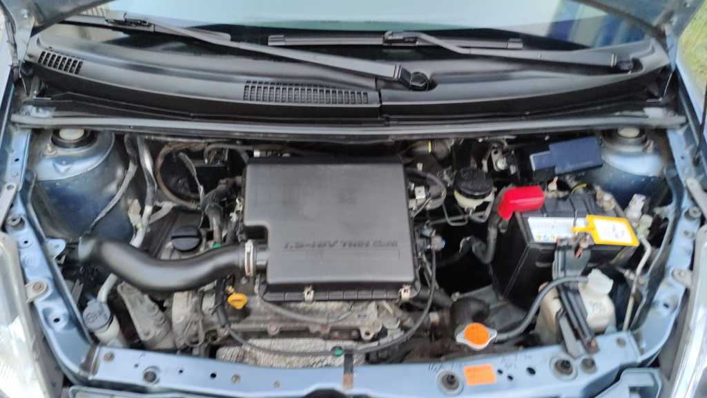

A lot to do:

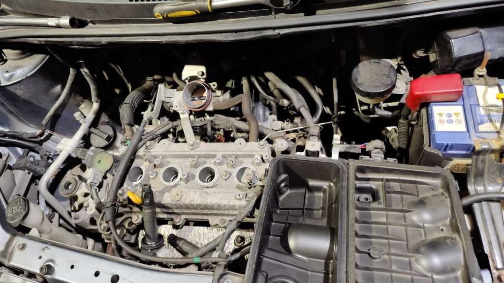

All fluids,filter and spark plug change

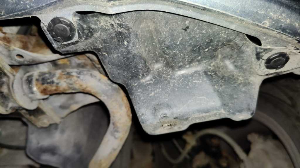

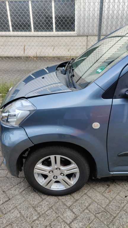

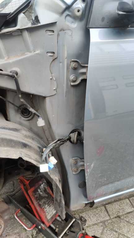

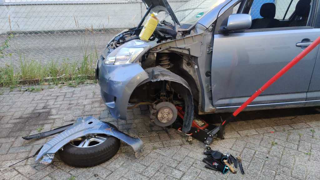

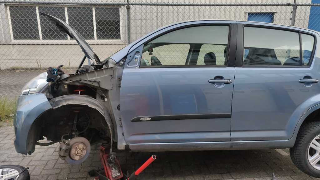

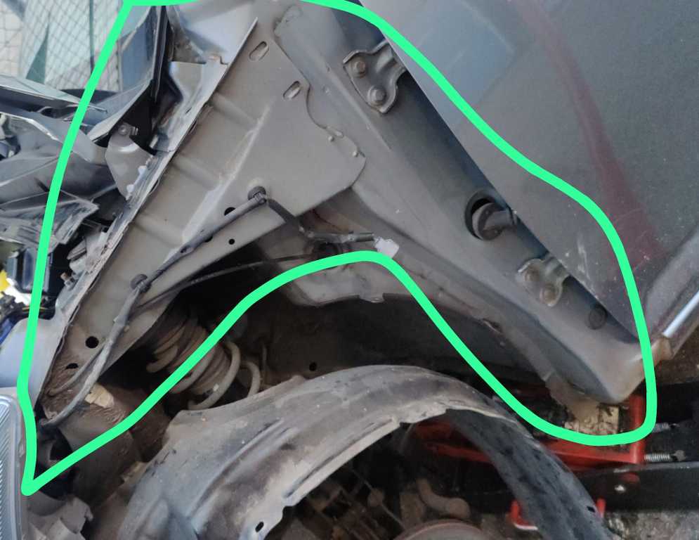

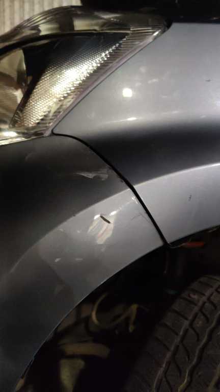

Left side damage
Wheel bearing left front?
Left door hinges
Left wish bone
left sway bar end link
A/C leak

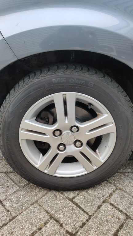

Wheel centre caps

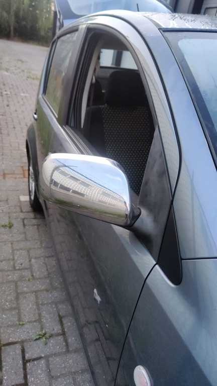

Right mirror trim missing

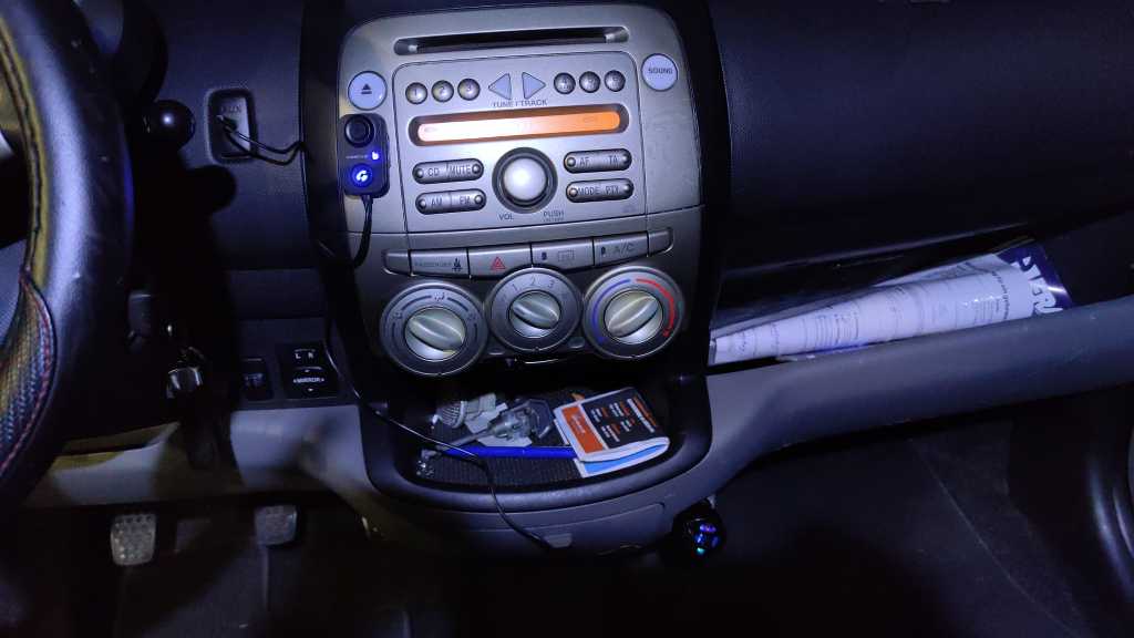

Radio upgrade?
Or aux to Bluetooth

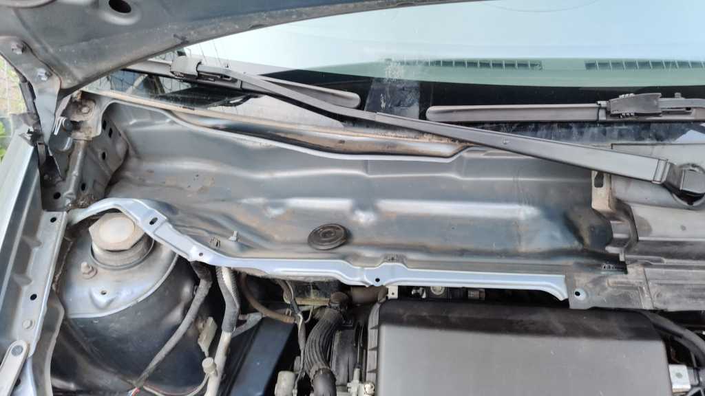

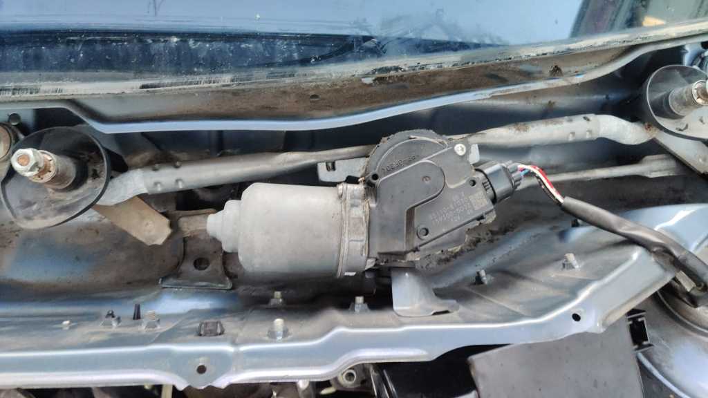

Wipers upgrade and rear wiper
So far done:

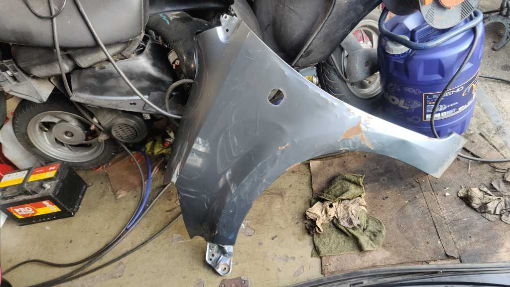

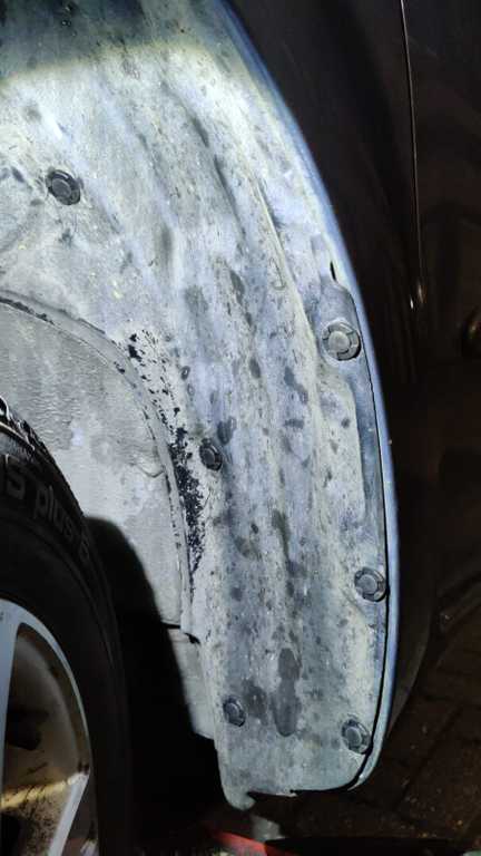

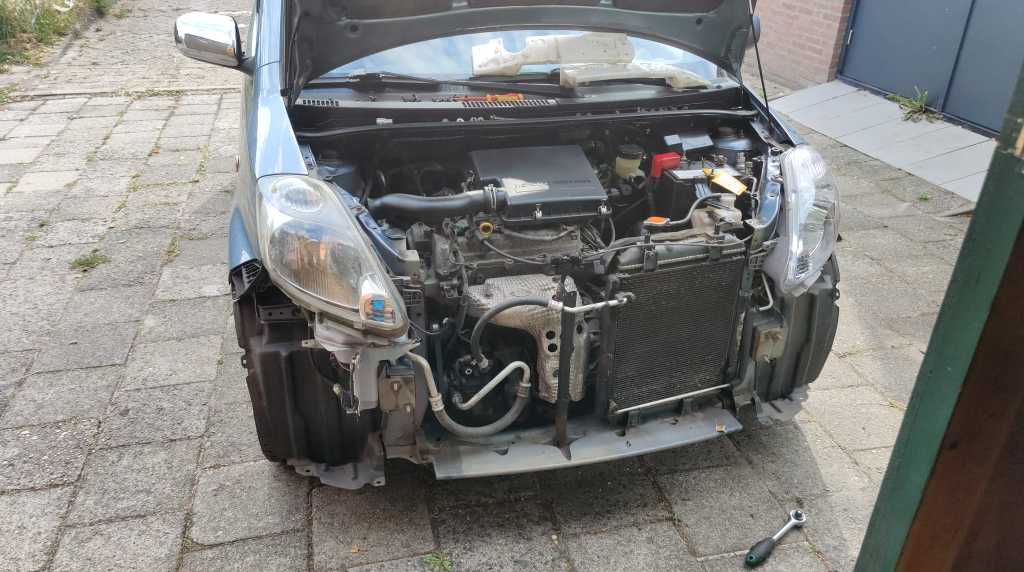

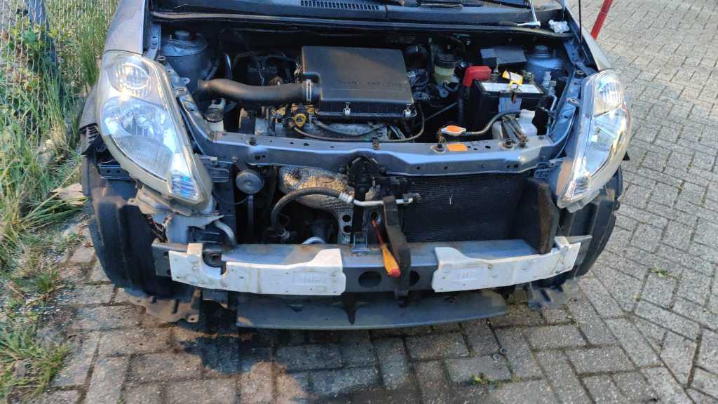

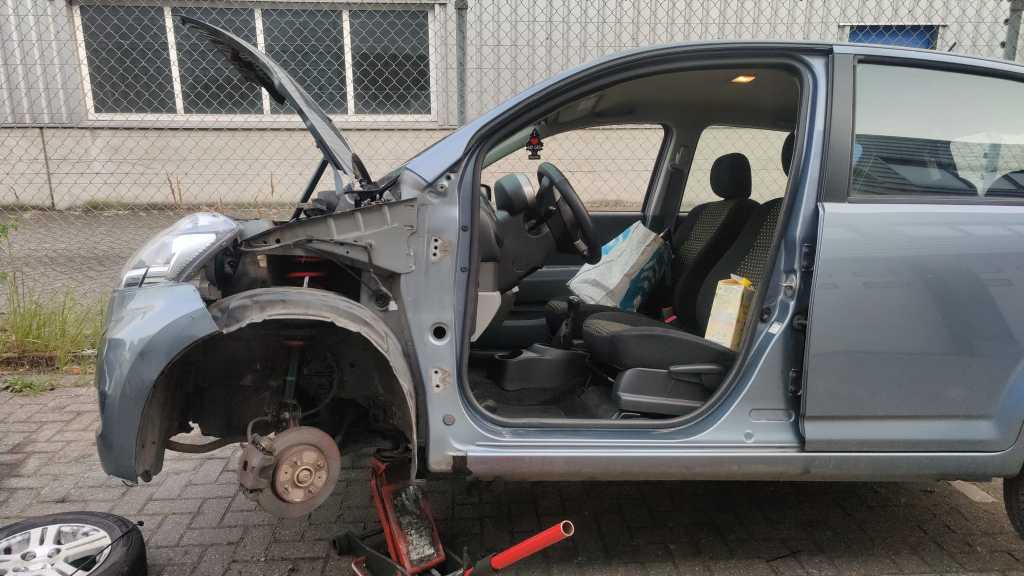

Damage left side done
Oil+filter changed

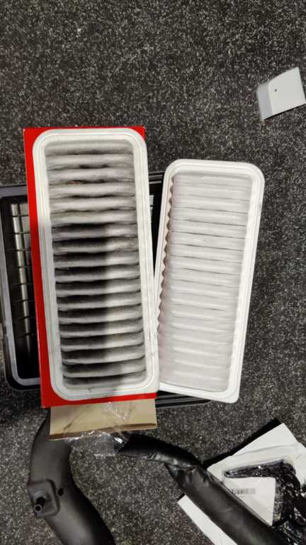

air filter changed

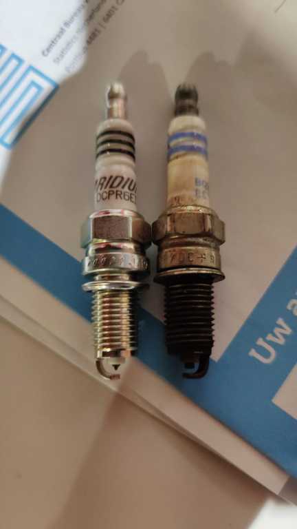

Spark plug changed
Front stiffer Eibach Lowering springs M400
Shocks from a M400 Materia
So far some pictures of the progress:

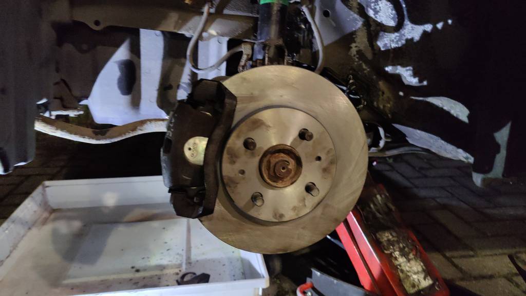

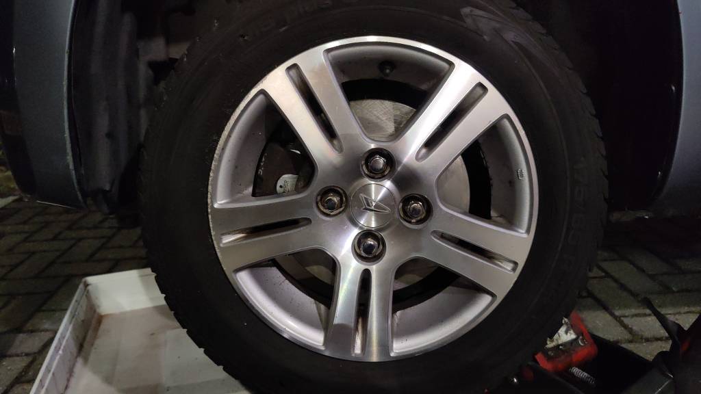

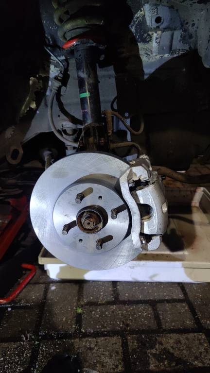

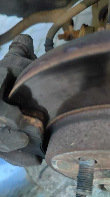

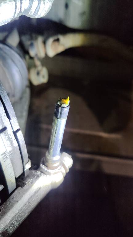

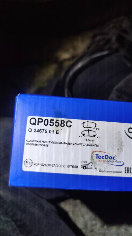

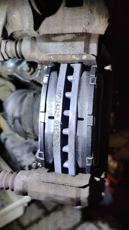

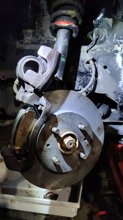

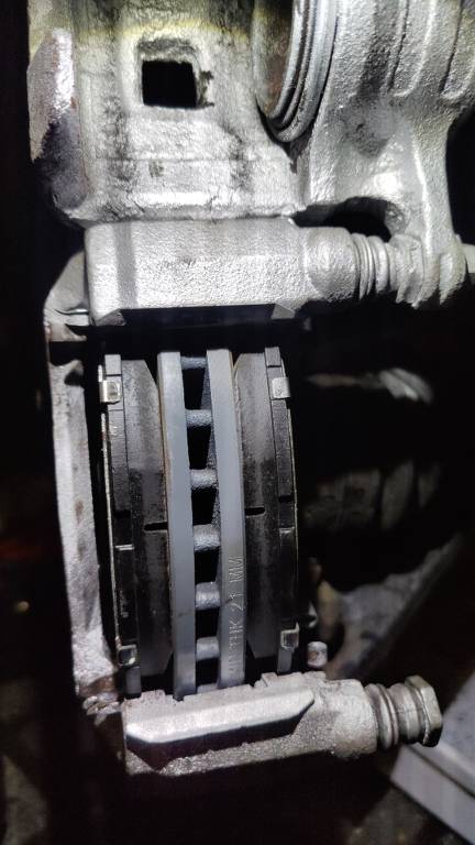

As usual the brake upgrade to 254mm

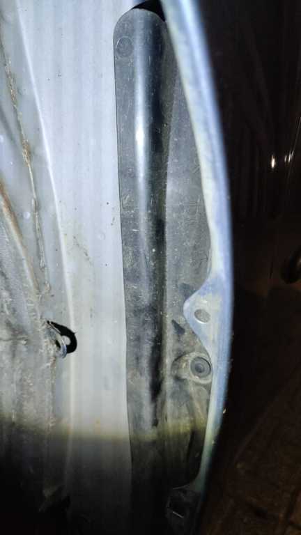

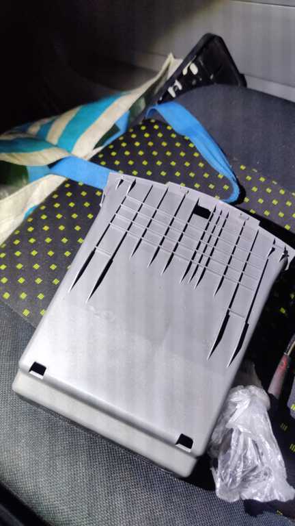

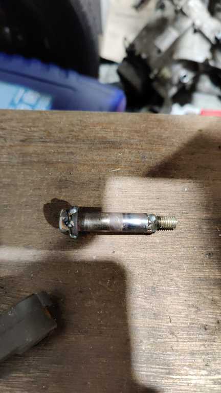

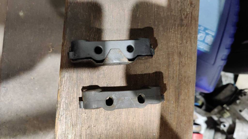

Also removed the rubber part on the glider part as usual

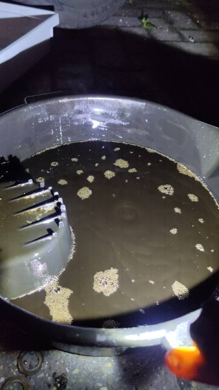

New brake fluid dot 4

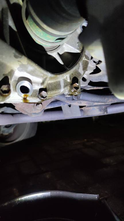

New thermostat oem Toyota and coolant G12 (correct one)
Gearbox oil also done with MTF3 75W shifts almost new

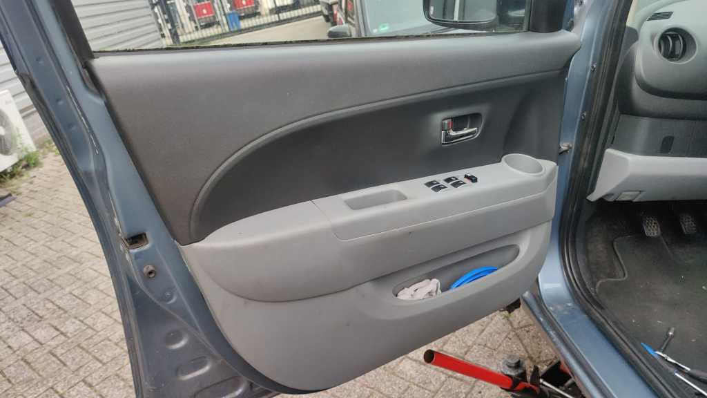

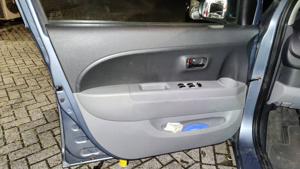

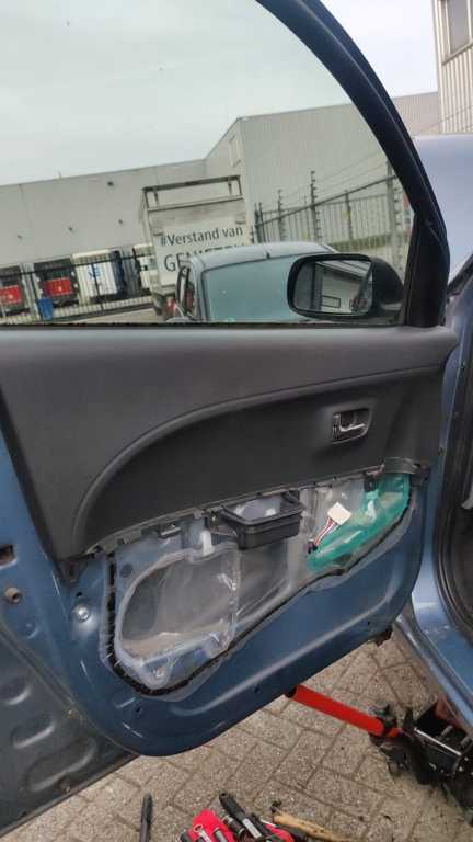

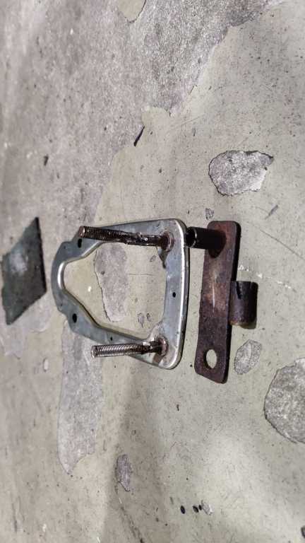

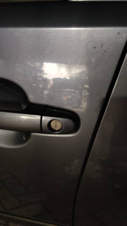

Changed over the door lock mechanism
Window mechanism greased
Door panel inside cleaned

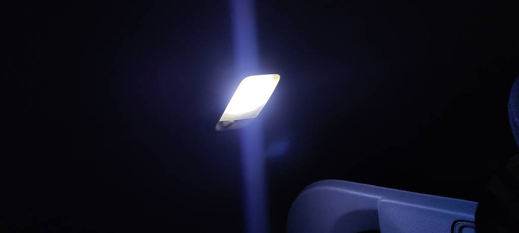

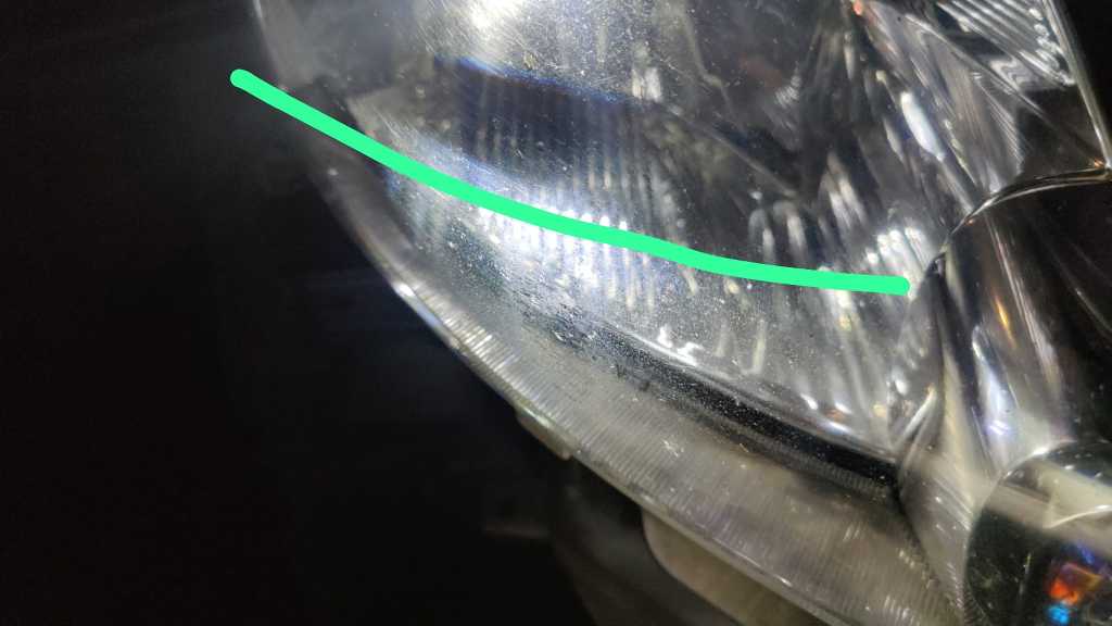

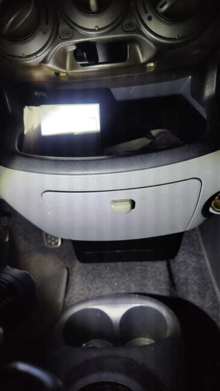

Interior lamp upgraded to LED.

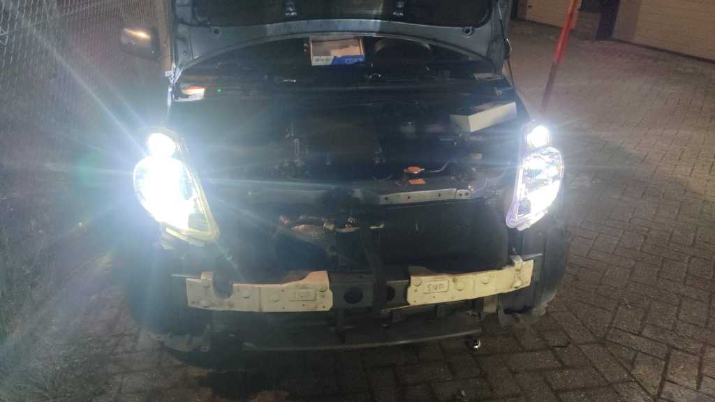

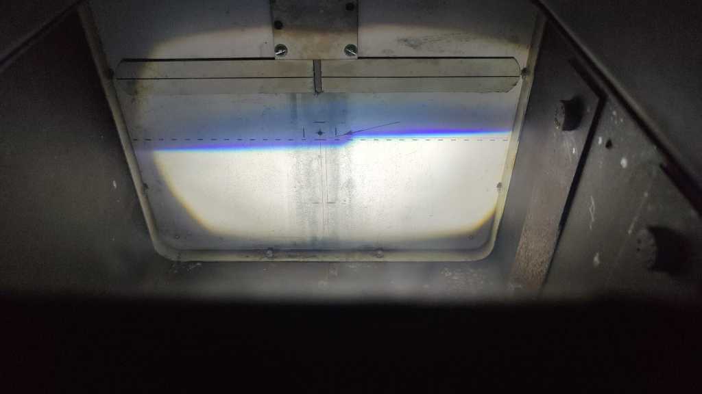

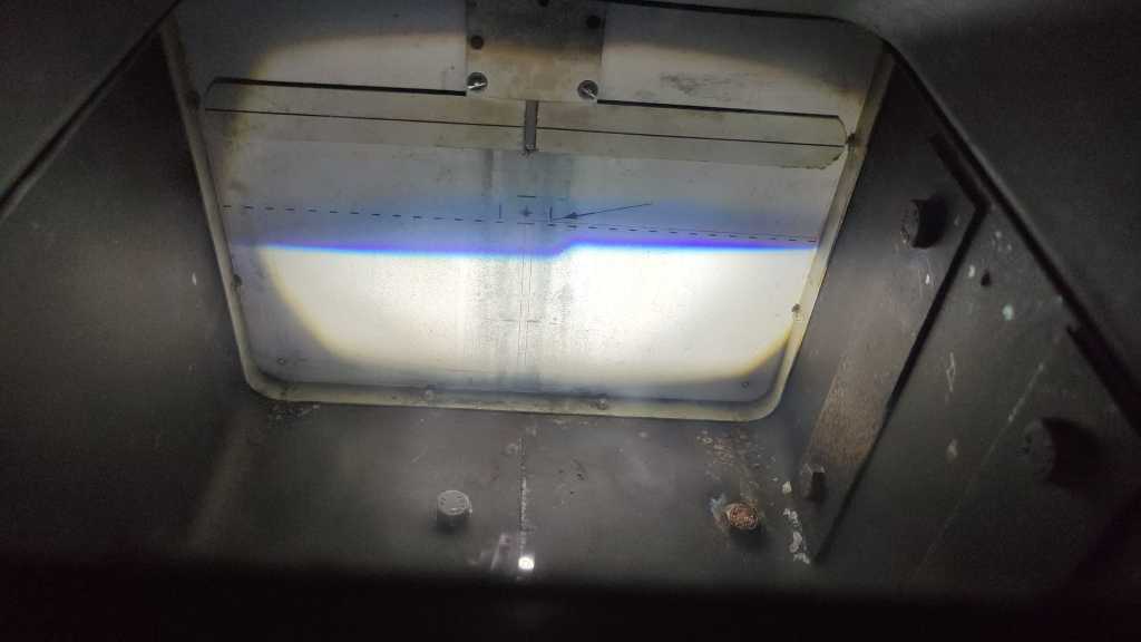

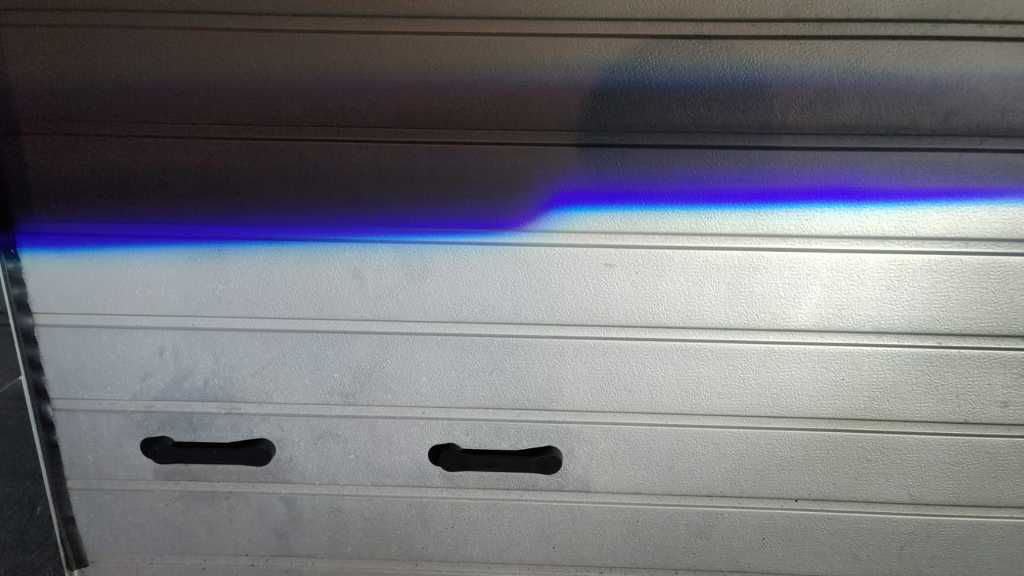

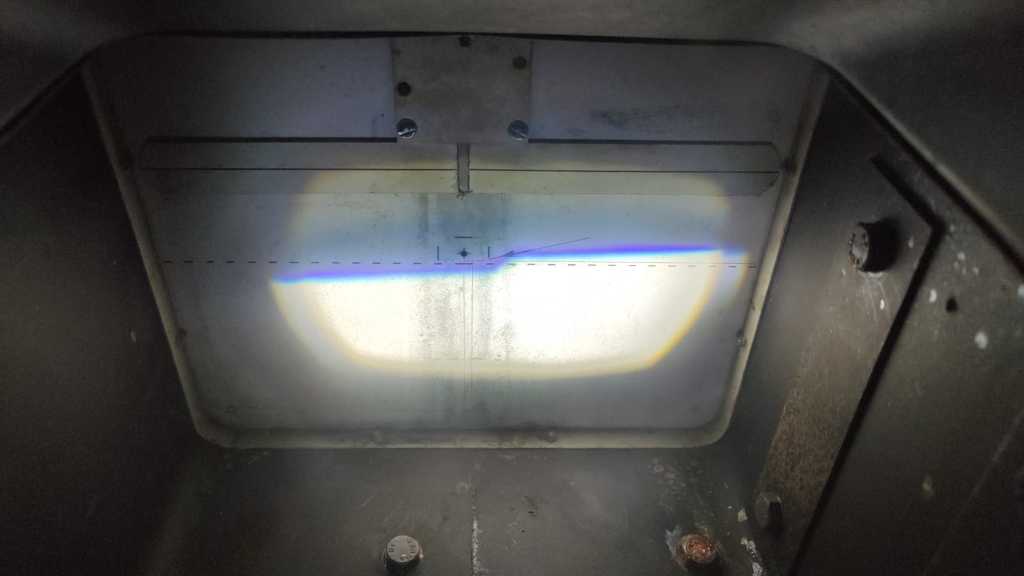

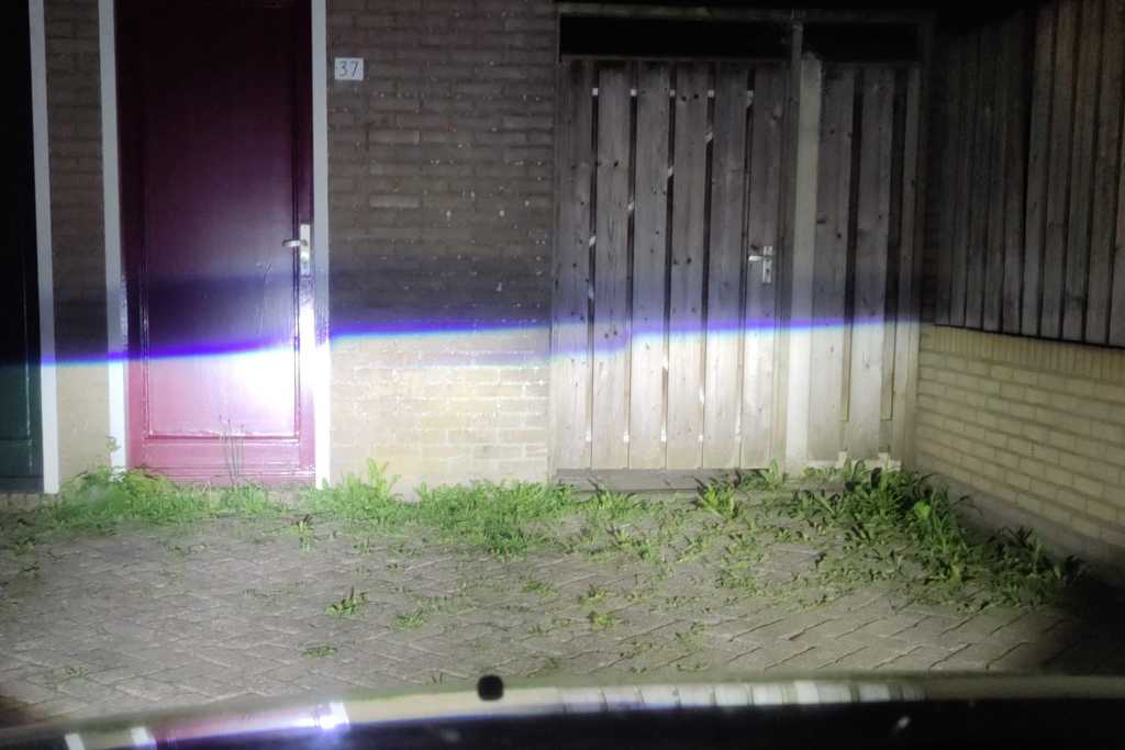

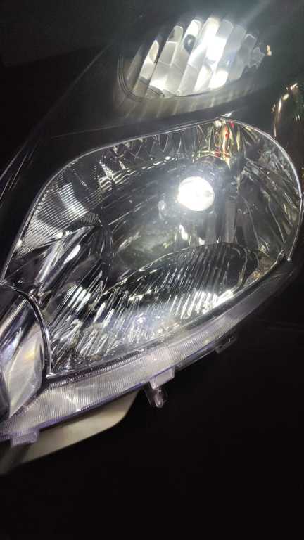

Installed LED projectors also on the Sirion2
These pass inspection easy and
no dazzle like the normal ones

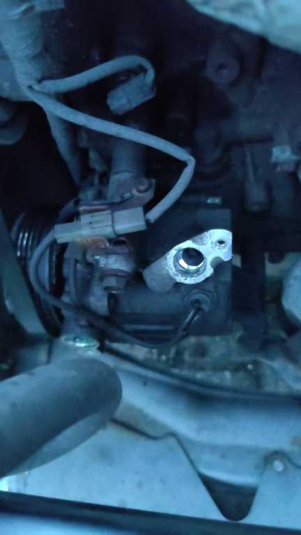

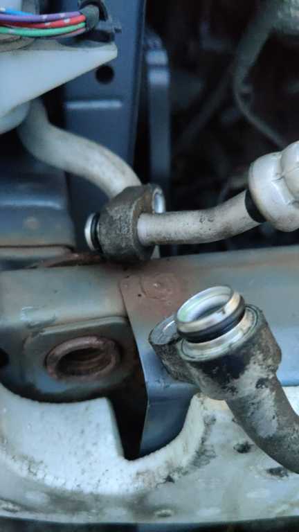

Fixed the A/C leak

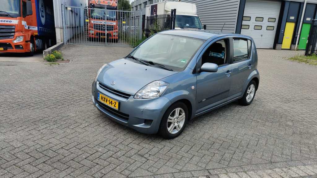

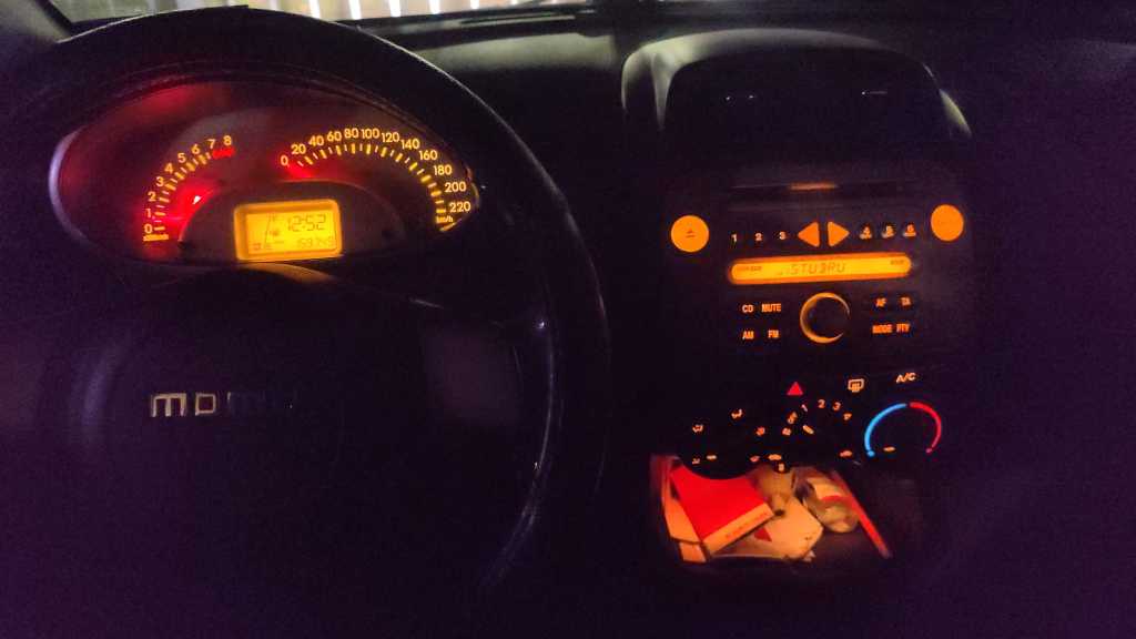

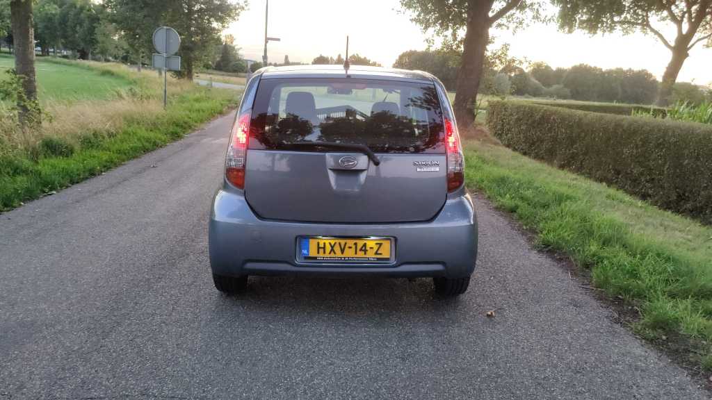

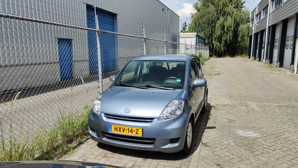

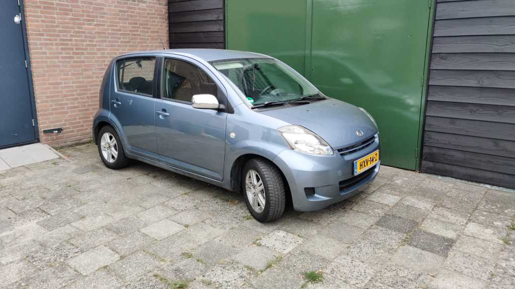

Got registration and passed inspection:

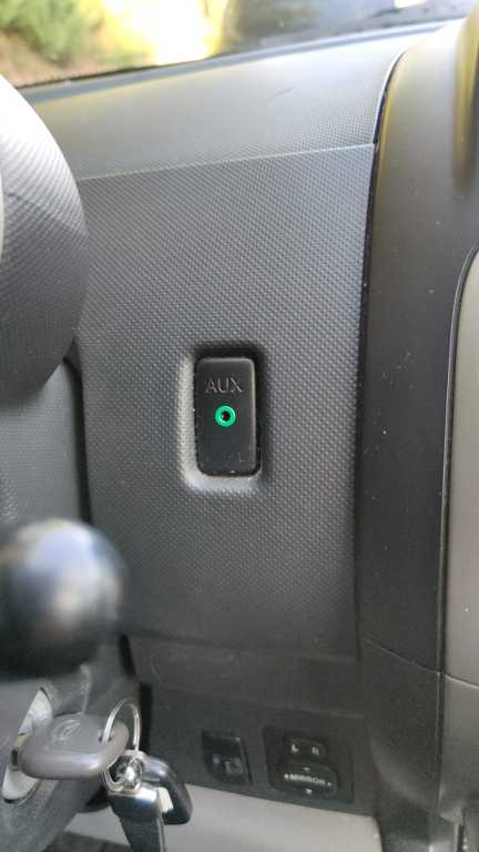

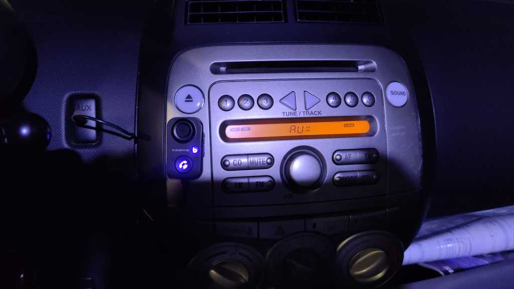

Installed AUX to Bluetooth:

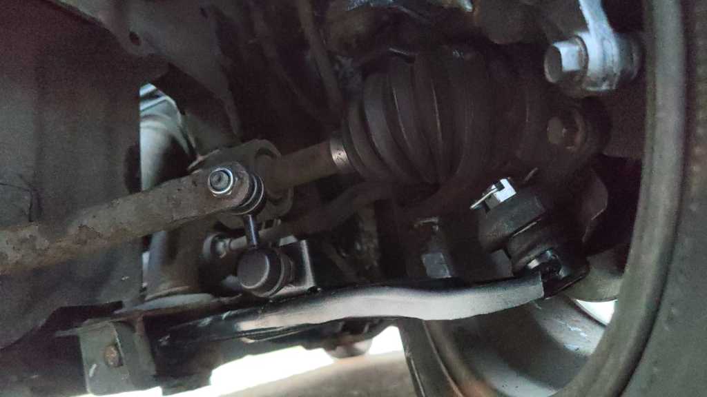

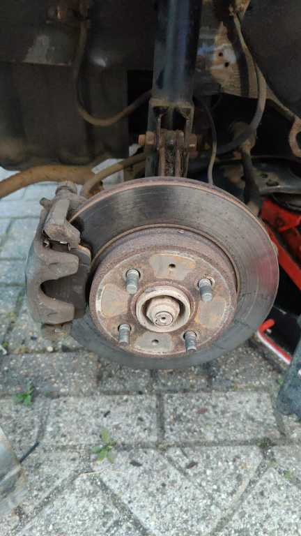

Left front wishbone needs to be changed:

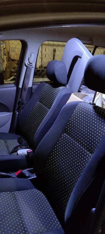

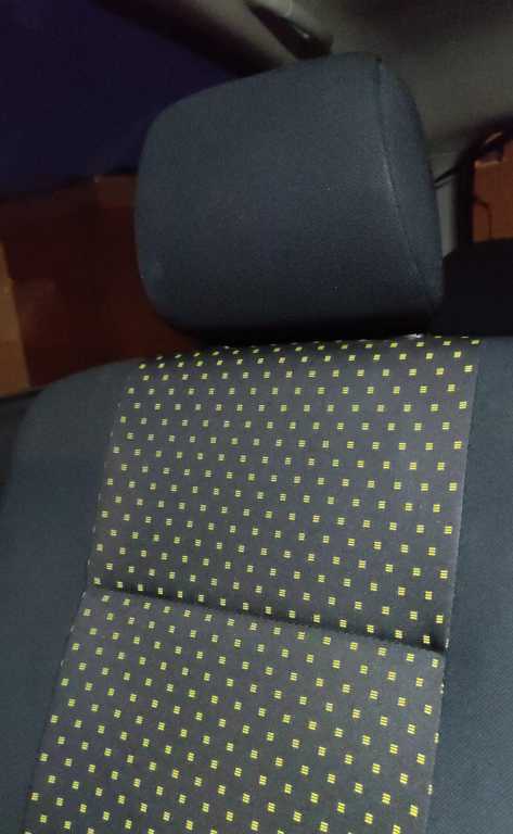

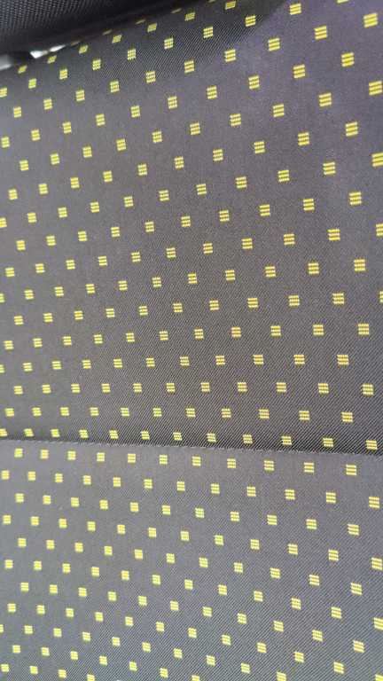

Seats are awesome nice colour combination

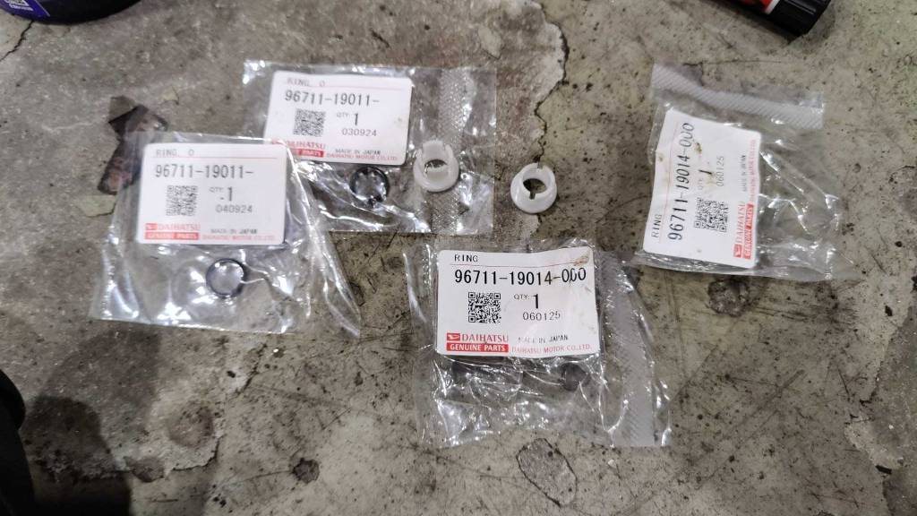

A/C has been re-gassed ( O-rings issue)
replaced with the 276 spare new o rings oem
and no leaks anymore

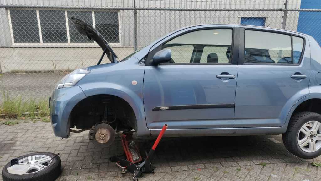

changed front left wheel hub and bearing (accident before I bought)
Changed front left wishbone. (same as wheel bearing)

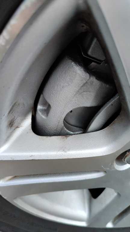

Painted left caliper to silver

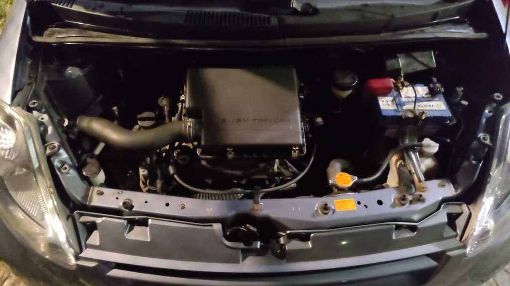

Tidied up engine bay with Silicon grease

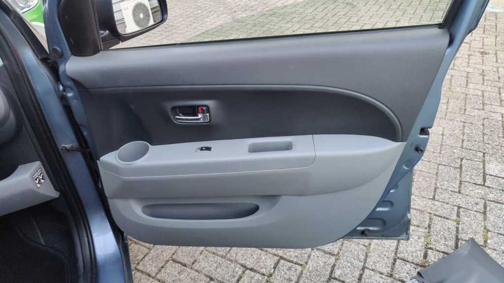

Replaced door panel right that has almost no scratches

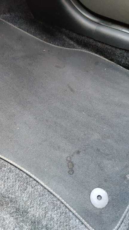

My gf was using last few days A/C full speed due heat

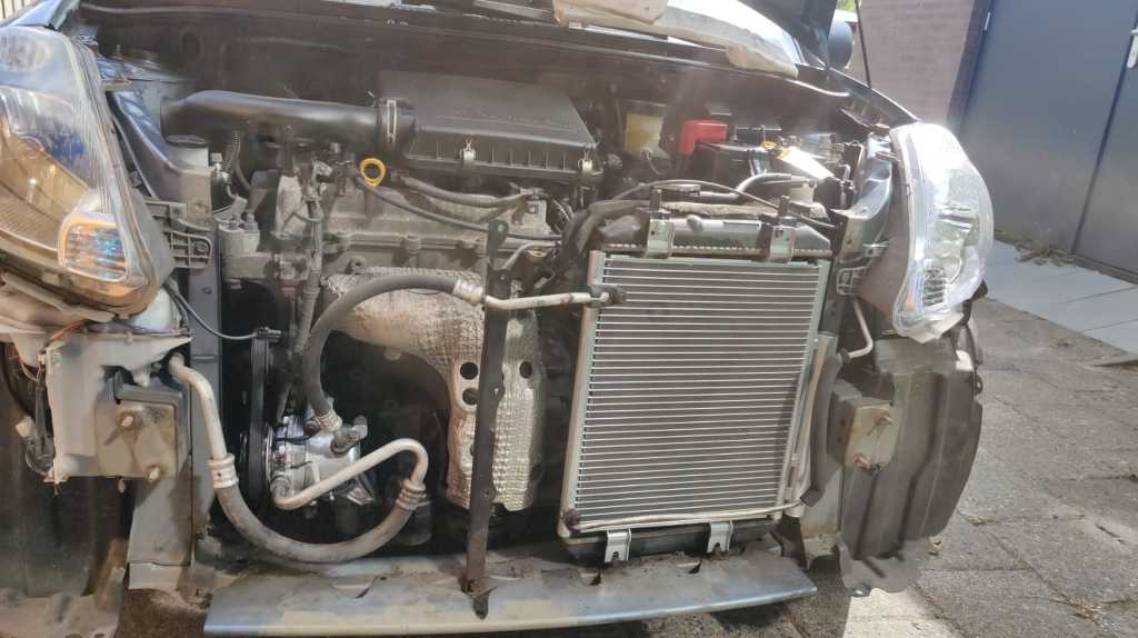

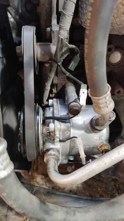

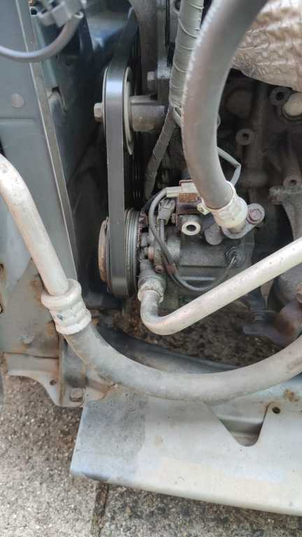

Suddenly yesterday a huge hiss coming from engine bay
I looked and my A/C pump is full of UV
I guess I need a A/C pump now
Its not the O rings I renewed those already

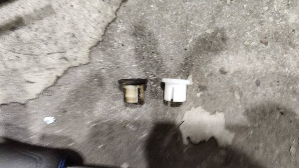

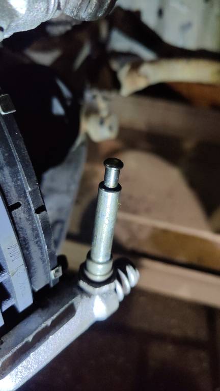

Changed shift bushings now and rubber holder.

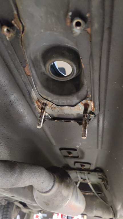

A lot fabrication because the parts are pressed shut

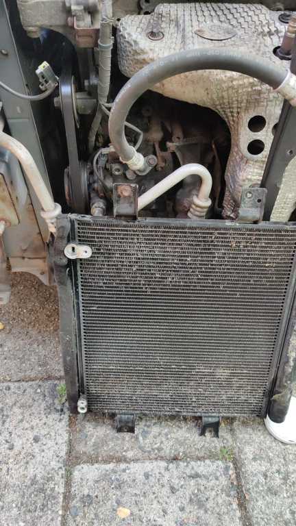

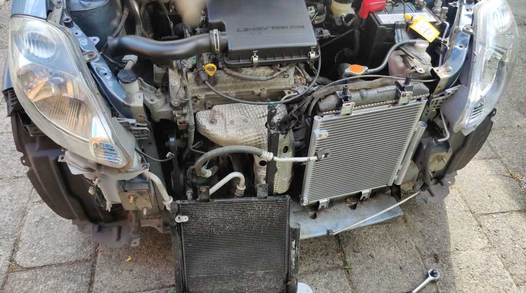

Fixed the A/C now:
As per workshop manual:

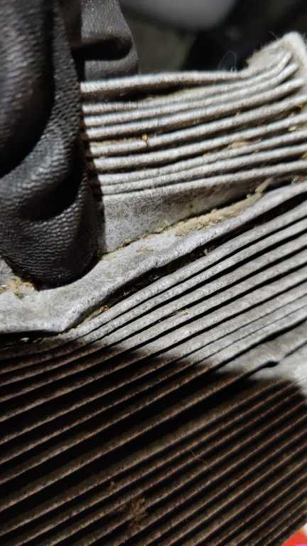

Replace A/C system filter
This filter is not separate for sale
So complete condenser replaced with filter
Also new OEM o rings from Daihatsu
Pump is not OEM. Price is very affordable compared to OEM.
Will keep the OEM and I see I can find a repair kit for it.

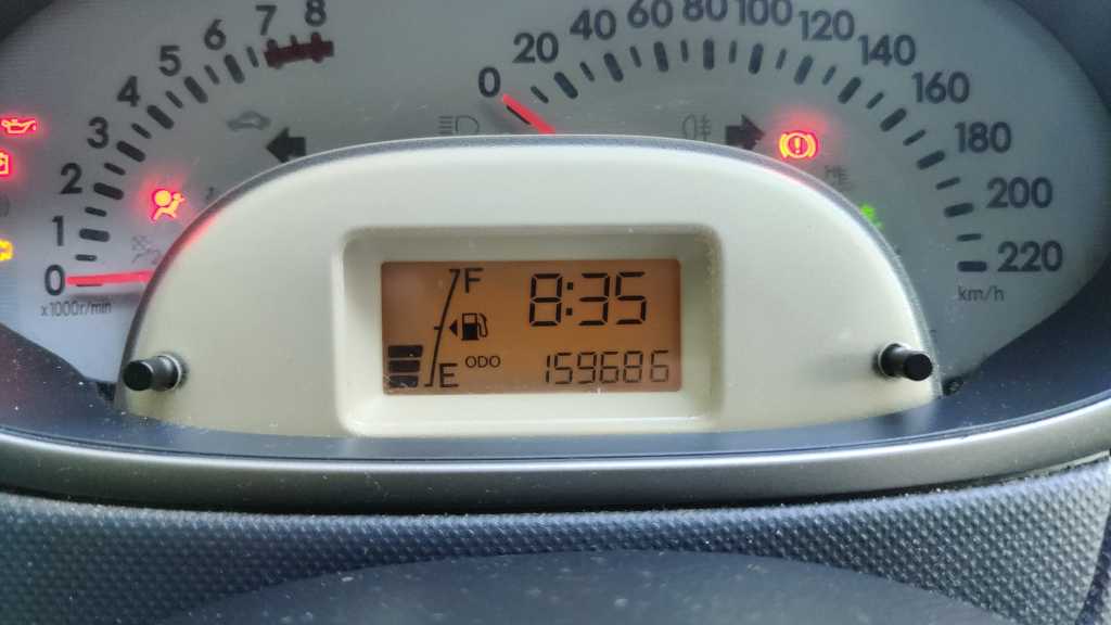

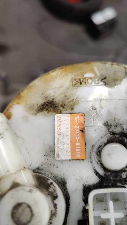

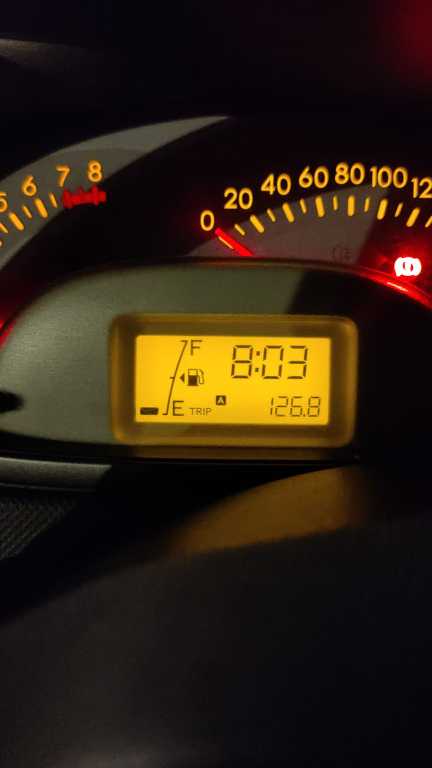

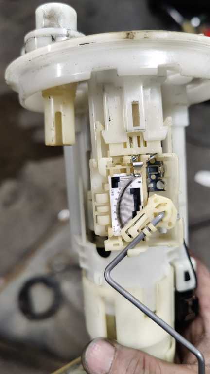

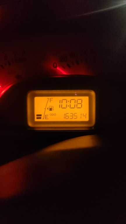

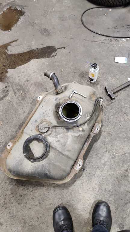

fuel sender got stuck at 2 bars (replaced with l701)
changed oil again at 4000km

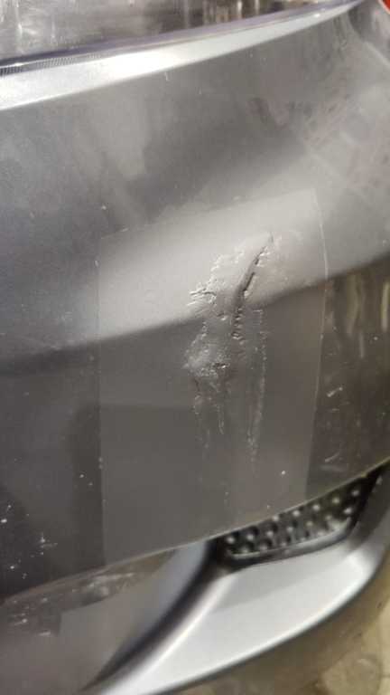

bumper provisionally repaired

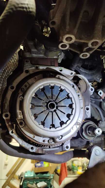

clutch replaced

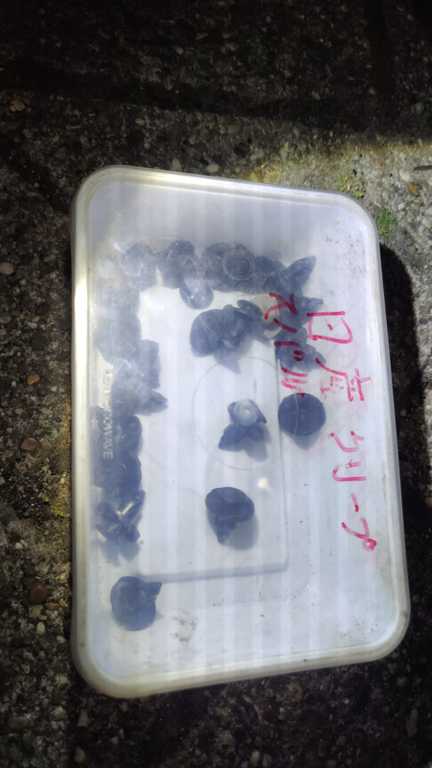

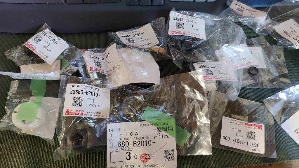

Rear caps ordered used have now over 100 sets from Suzuki,Mitsubishi, Autech Nissan, Toyota,Daihatsus etc.
