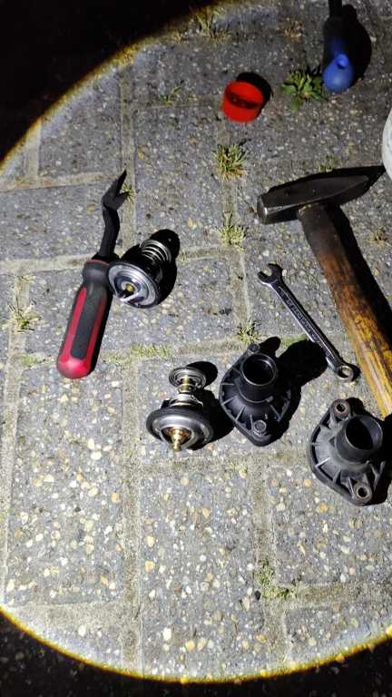

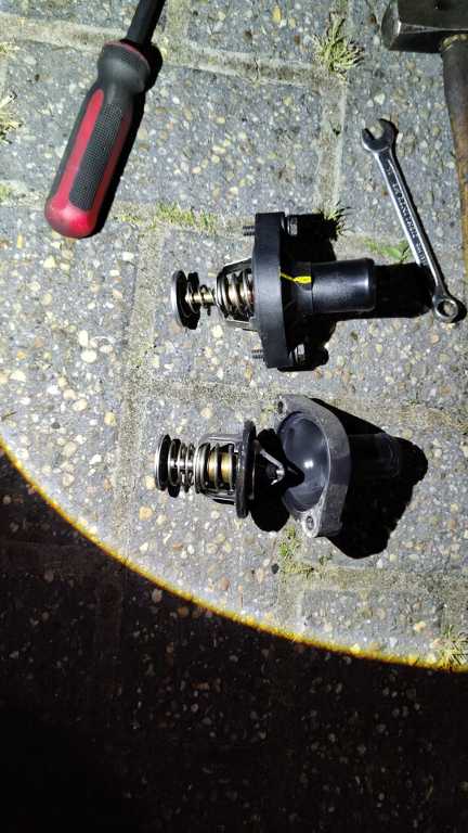

Thermostat or Catalyic converter
Seems the thermostat is not working properly.

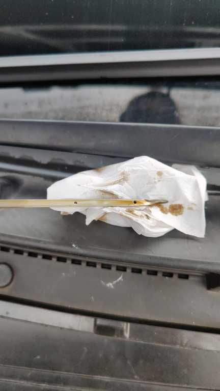

Engine oil consumption is now down to 0.3L on 8800km
Good ATF-5 old school trick works

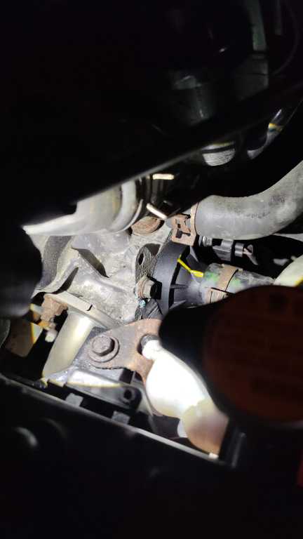

OBD Only reads 77C and when quicker drive only 75C

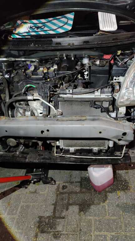

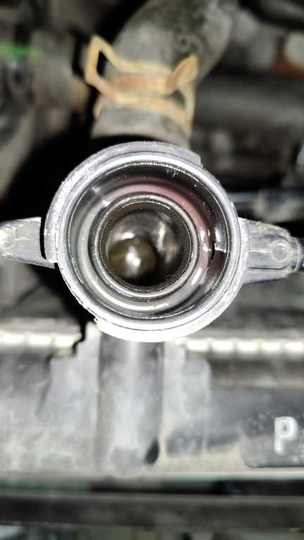

I wanted to tackle the radiator as preventative maintenance so will do it together again with thermostat
sometimes I did in 2 weeks 2000km so its almost a commercial vehicle drive
At one point did in one day a 850km to move a workshop stuff around.
Was a New OEM Toyota one.
Will use this time a Calorstat 82C have good experience with it
OEM 82C is discontinued for the 1KR only 80C is left

Oil changed, filter changed
Oil is really clean now dark caramel clear to look

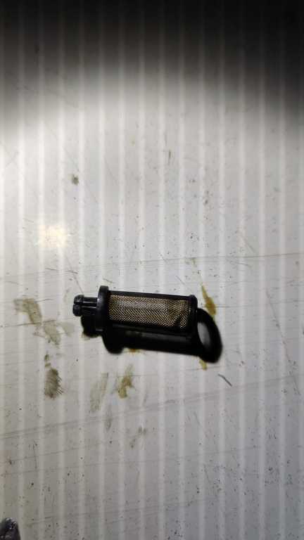

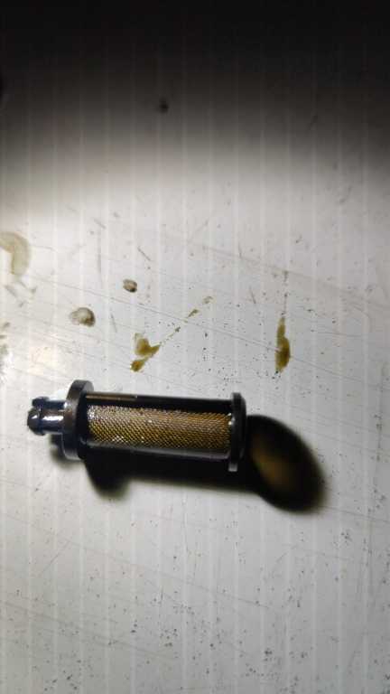

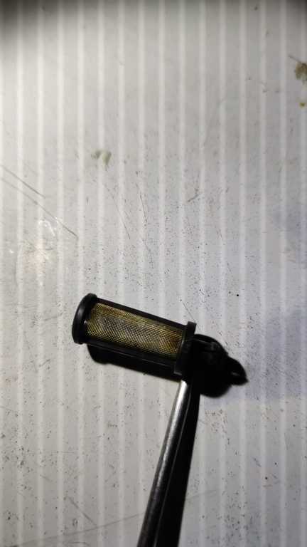

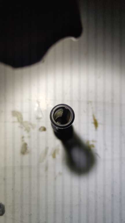

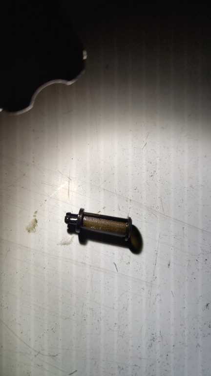

DVVT screen mesh cleaned

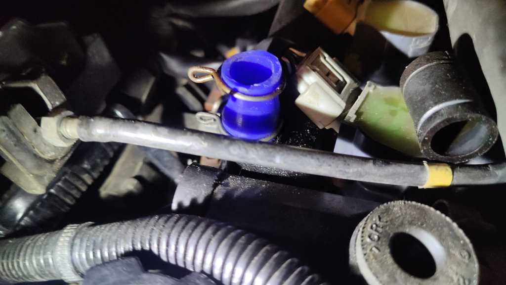

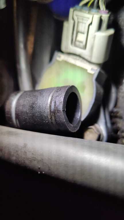

Breather hose broke replaced temporarily with a vacuum one

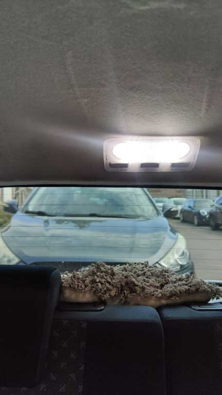

Fixed 3rd interior light wiring seems double shrink didnt work
Still corroded the soldering

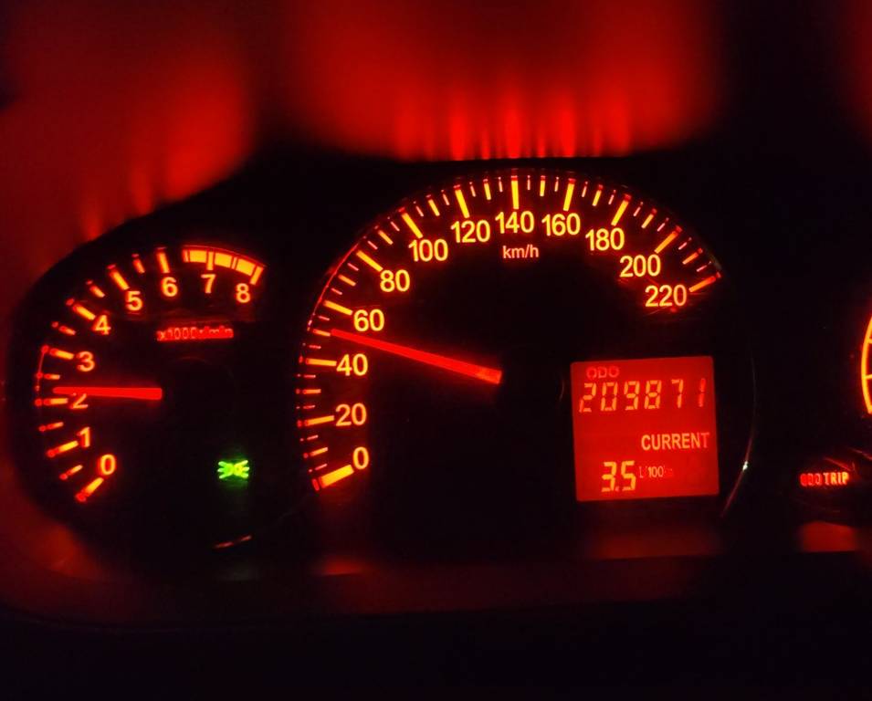

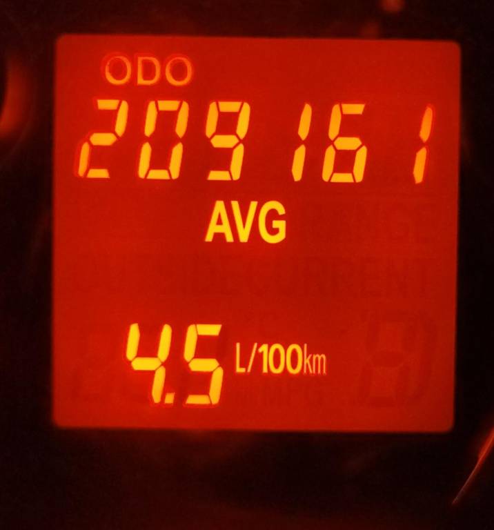

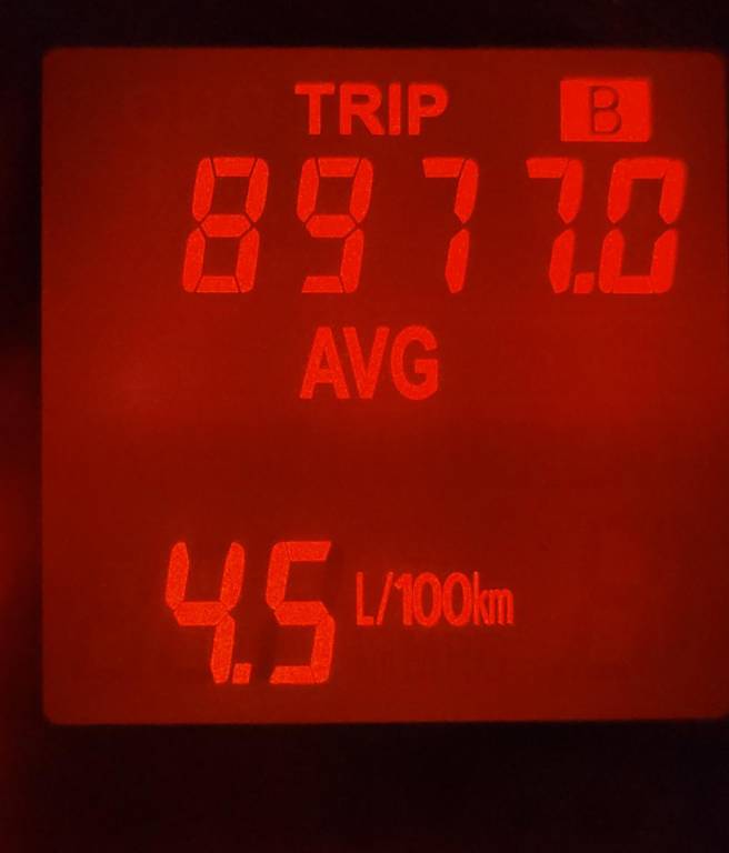

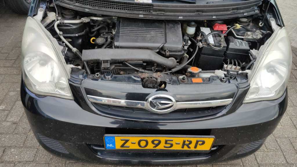

1KR-FE Ecu is really picky on Temperature

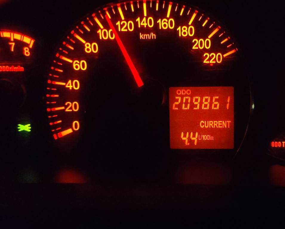

I changed to 82C back in for a Calorstat one and fuel consumption decreases after it immediately.
oem is discountinued only 80C degrees was available
I installed that and was running a little rich using more fuel

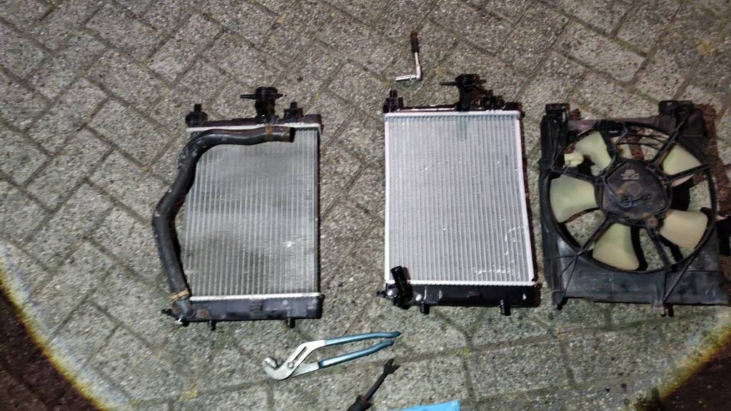

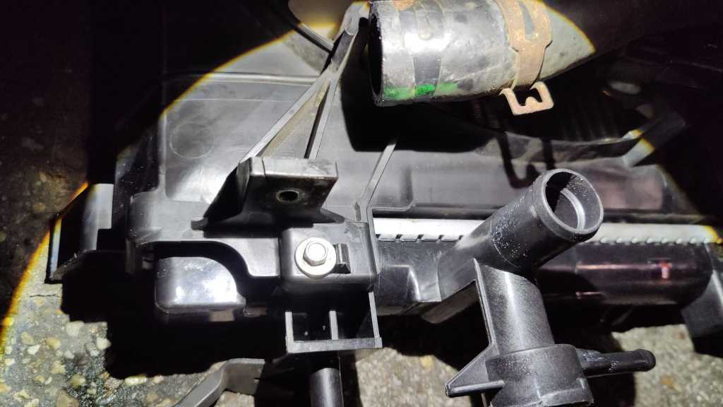

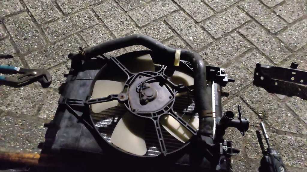

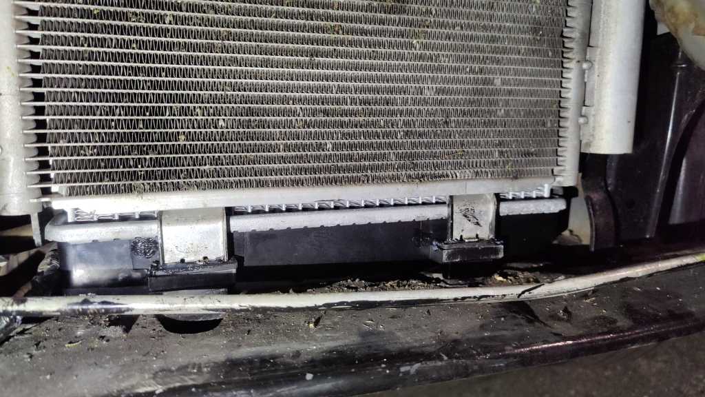

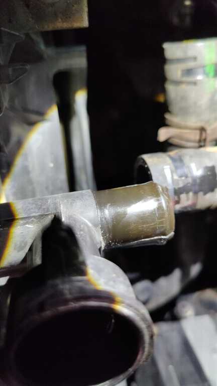

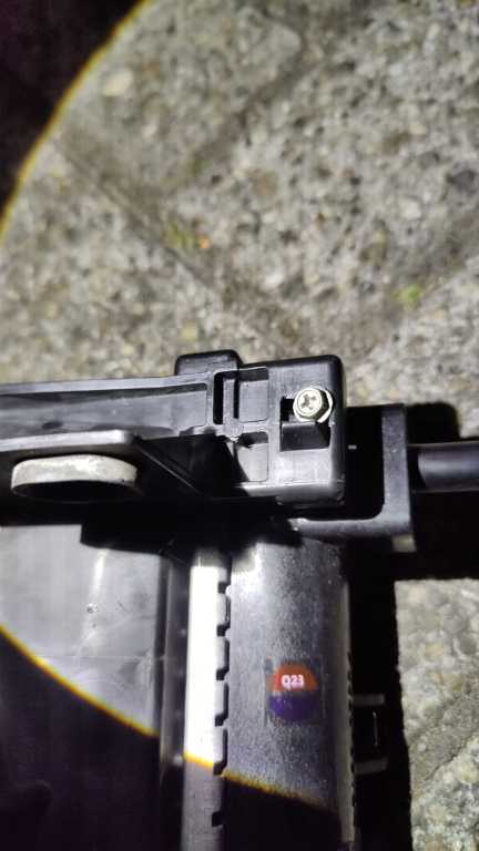

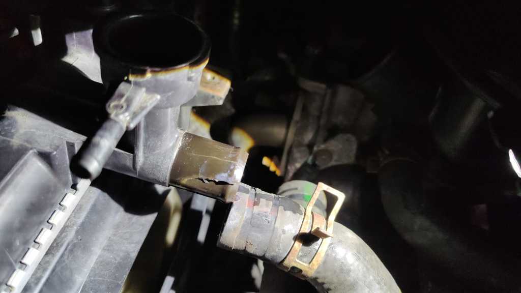

Replaced radiator also plastic cracked also while uninstalling
Replaced thermostat housing also as it is plastic

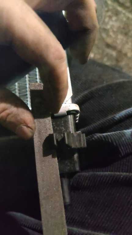

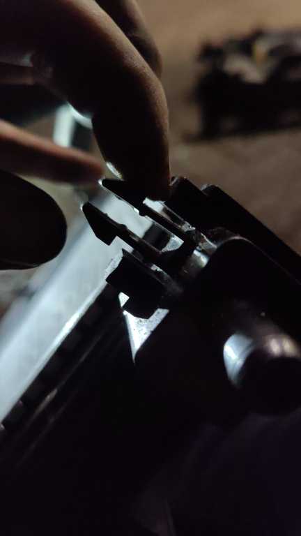

Fan holder tabs wont fit because of aftermarket
I have Put 2 screws inside will sort out later
So annoying its a Nissens
Will later make an adaptor for the tabs

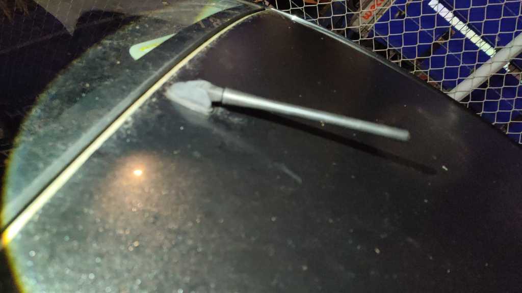

Replaced antenna for a Materia one

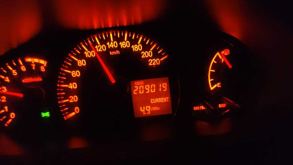

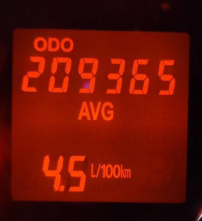

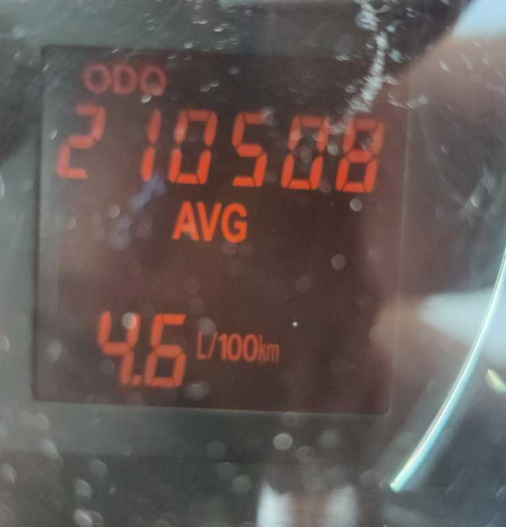

See before and after exact same road flat no in or declins
Before:
After:

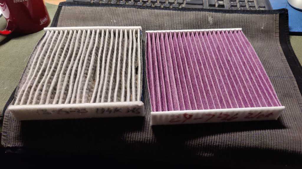

Changed Cabin filter old one is dirty.

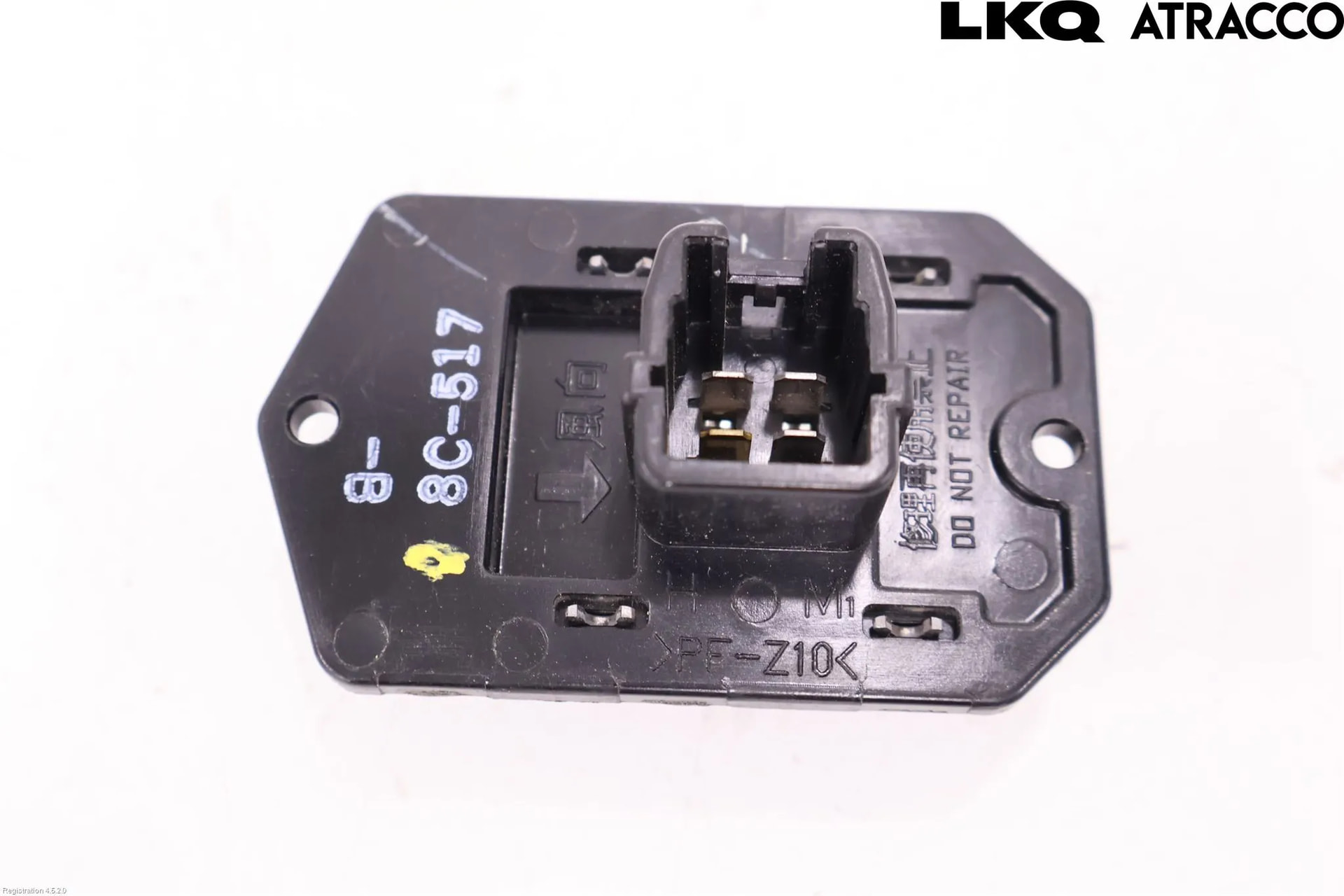

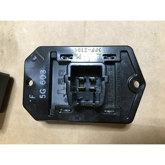

87138-0K090 > LHD blower resistor
87138-0K110 > RHD blower resistor
LHD
RHD
Since Daihatsu decided to use a RHD blower resistor have to buy this one
Otherwise Its possible need to rewire the plug by repinning

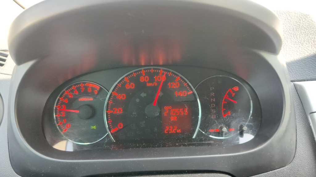

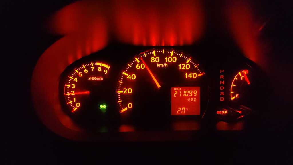

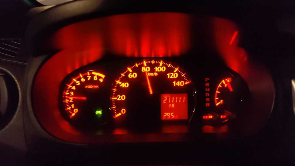

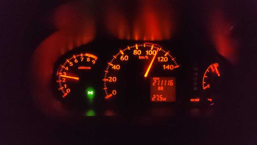

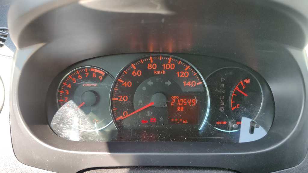

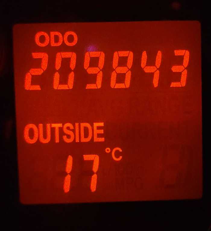

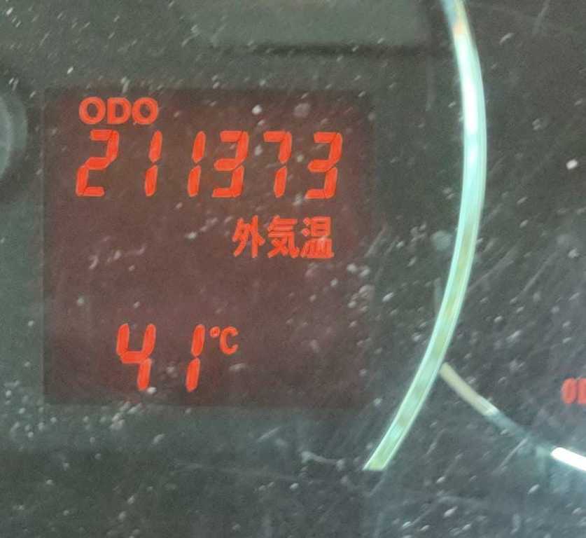

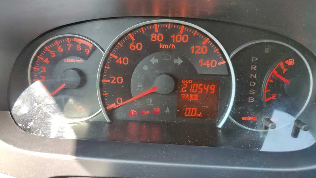

Mileage corrected Mira speedometer and using it now
Move L150S corrected also 30000km more
Need to finish adapter loom

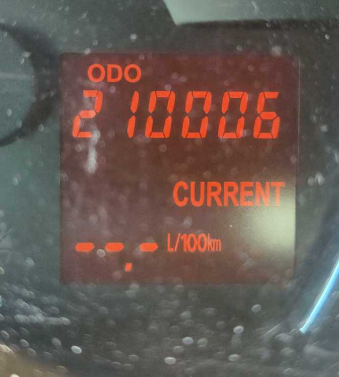

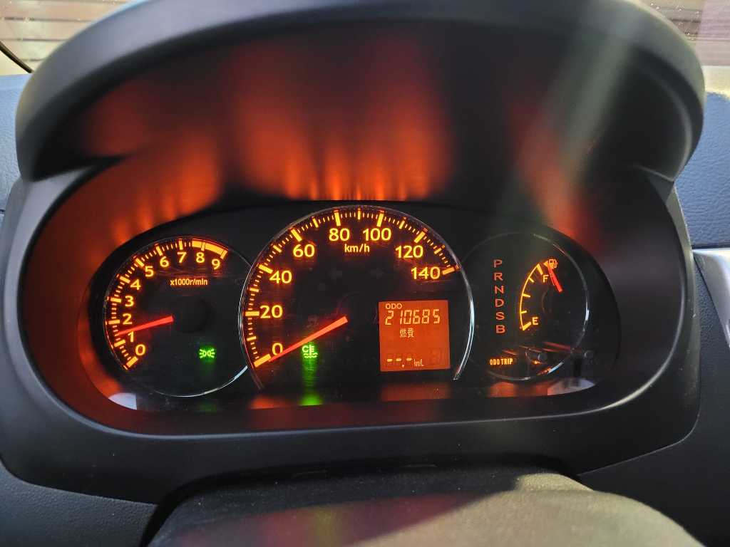

Mira speedo L275 used unit was at 149580km now its 210549km
Correcting up 61000km +/-
Working good this cluster will blank the Automatic display off
How did you manage to do that? This is why I trust only analog speedometers. At least, those of which have been tampered with leave visual signs of such.
I might end up buying a new digital VDO speedometer for my Suzuki. But at least then, I’ll know the correct milage that will get programmed into it
I bought an used speedo and matched the old speedo mileage so its correct.
Its digital eep rom so not secured
Its not illegal to correct mileage to replace a broken speedometer or swap a different in
As long its the same mileage or higher
