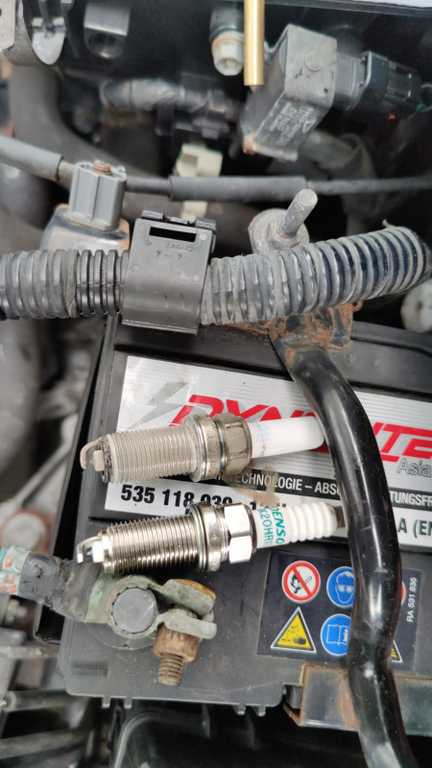

Spark plugs replacement with OEM 31-05-2024

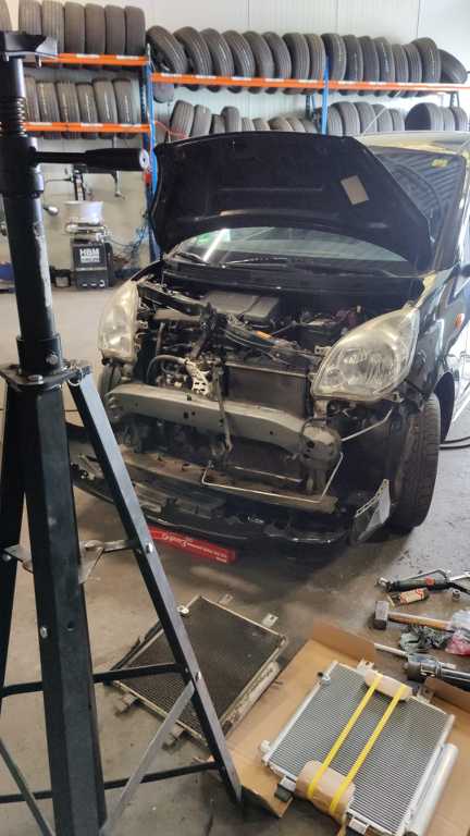

A/C Condensor replacement due stone chips 01-06-2024

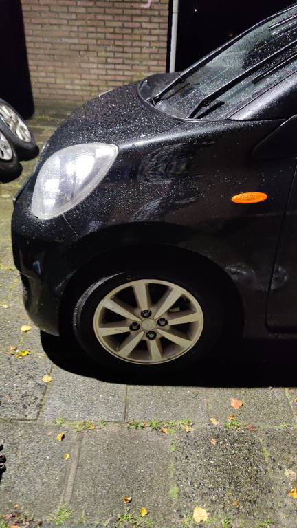

Wheels replaced with new tyres and 14inch alu wheels: 15-06-2024

Today I got my registration and done the condenser of my A/C as preventative maintenance
I also have replaced my spark plugs to OEM.

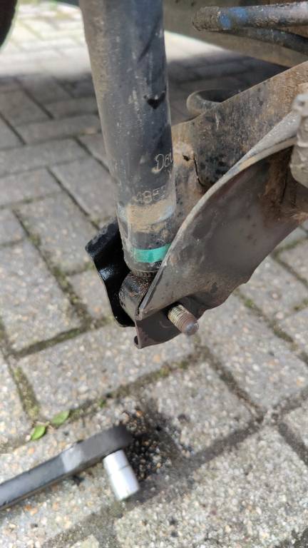

Redone rear shocks with Aygo ones (thicker) and had to grind the lower bolts off due rust.
Reinstalled with M12 bolts instead of M14 bolts as oem.

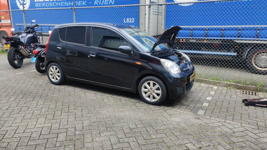

I lowered mine Daihatsu and replaced front shocks, shock bearing aswell:

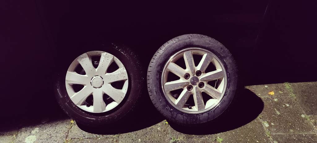

So I got finally my tyres in and got it installed on the wheels:
These are OEM wheels option for the Cuore or Sirion 2:

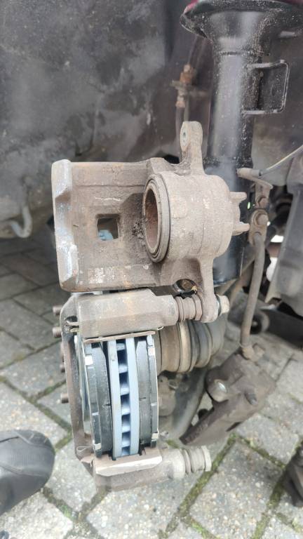

I got my front brakes converted to 254mm Materia:
There is an annoying thing on the slider pen, I always remove it so it wont bind if this rubber fails:
