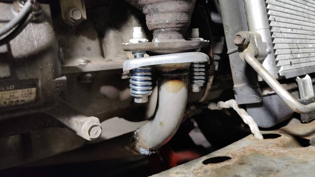

  • replacing my catalyst, as the old one is empty and no flex piece
  • replacing the wrong repaired exhaust flex flange

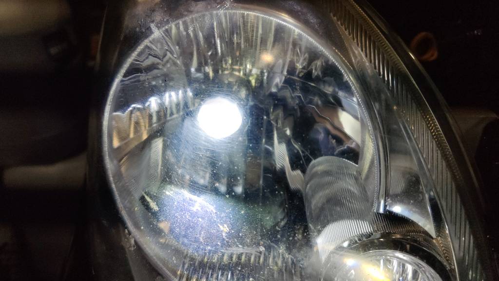

  • Installing headlights LHD beam instead of the RHD ones which they sent wrong

  • installing new flex connection bolts and springs
  • installing new exhaust manifold gasket
  • installing flex piece donut gasket

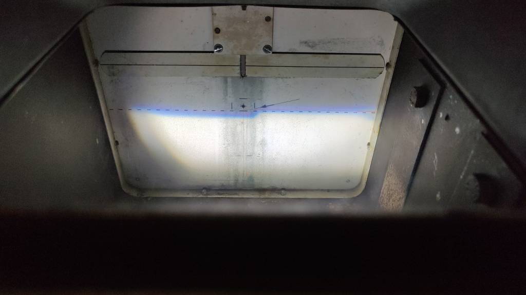

  • adjusted my headlight height

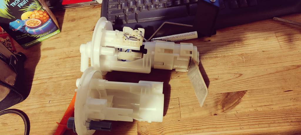

I managed to buy a Daihatsu Materia fuel tank (40L) incl. pump and a fuel filter for my cuore.
Toyota Passo recommends to change the lifetime filter at 180000km

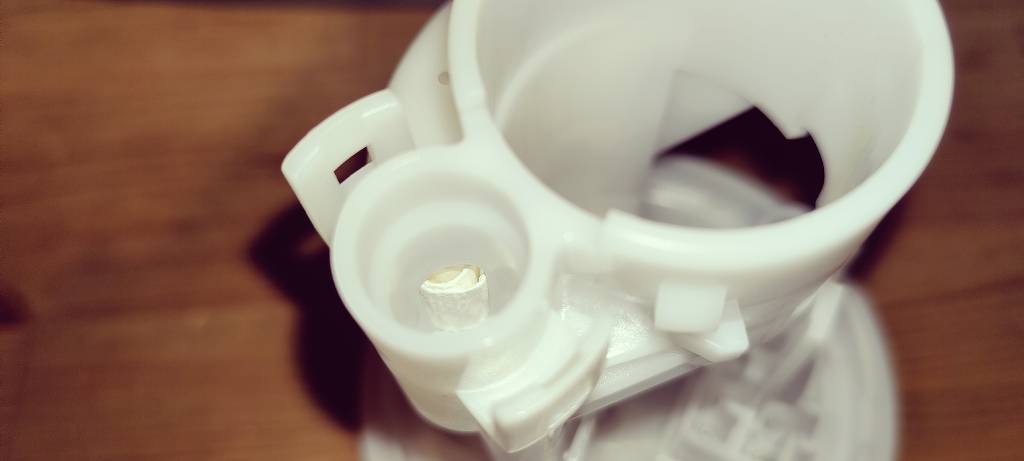

I need to swap over the fuel leveller inside as the resistance on the gauge is not the same.
I have also changed my spare fuel pump the main fuel filter.
I need to order the strainer and clip holding it

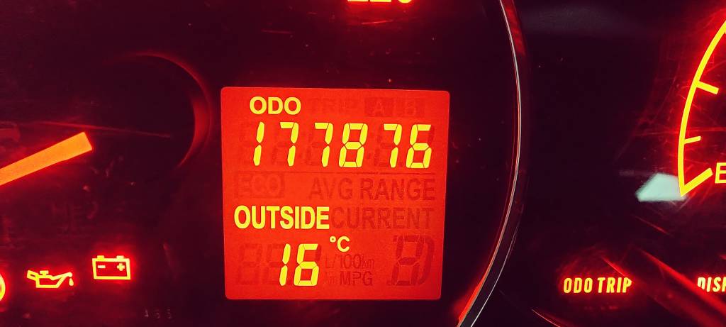

Lets see what it can do with 40L fuel with an average of 4.6L/100km
I drove today 100km/h with new fuel filter I see 3.5L/100km avg, maybe this full tank of E5 will go 1100km +/-

Really low fuel consumption even with all the options installed
(471km on 19l ) 1:24.78km / 4.03L/100km

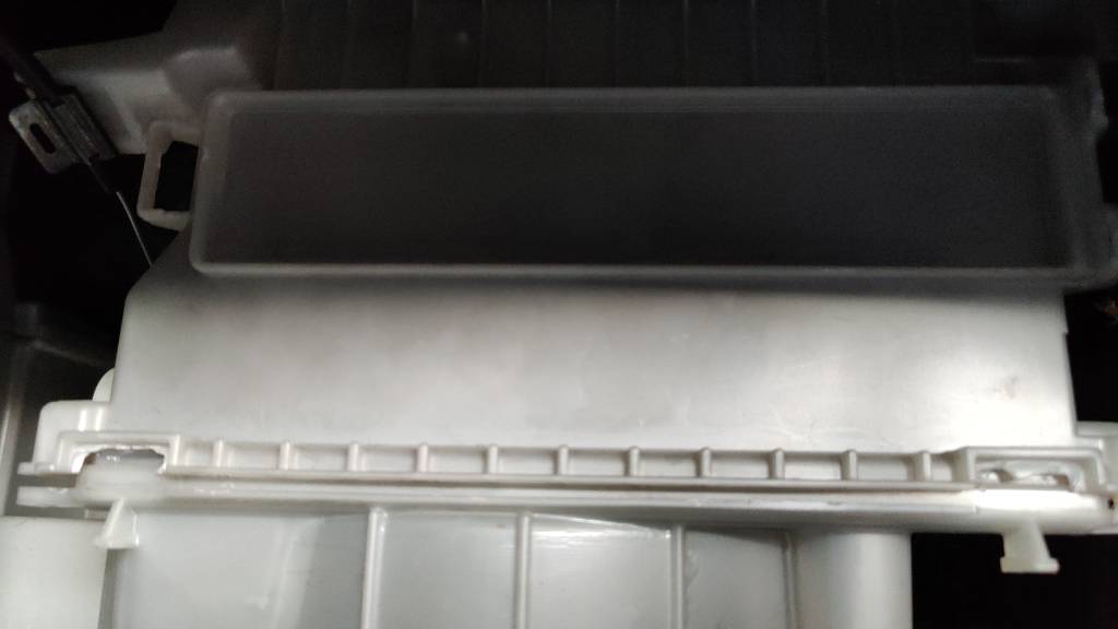

Installed interior filter by cutting the blanking plate and installing the closing lid

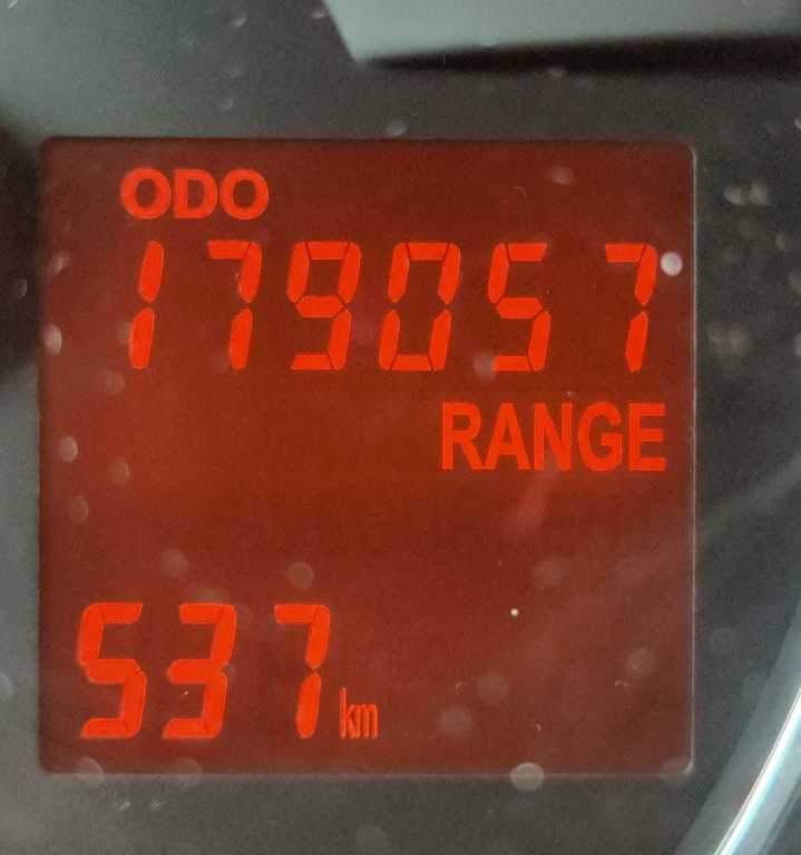

Also my fuel range meter wont go over 600km with the new fuel tank.
