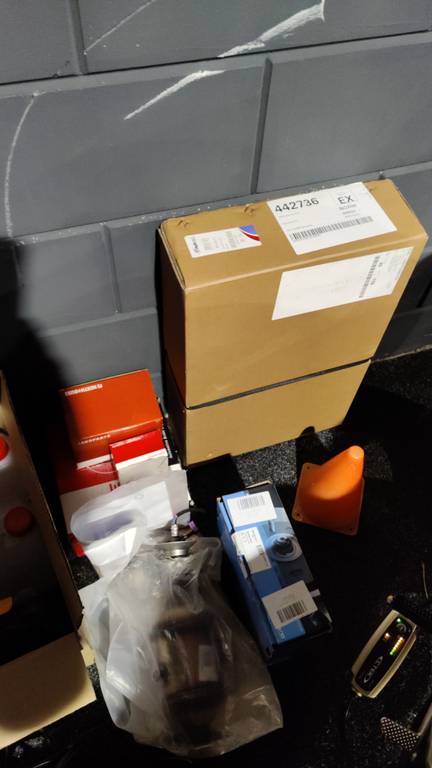

I got my bolts and nuts in for rear shock absorbe upgrade:
I also bought some spare wheels 15inch oem

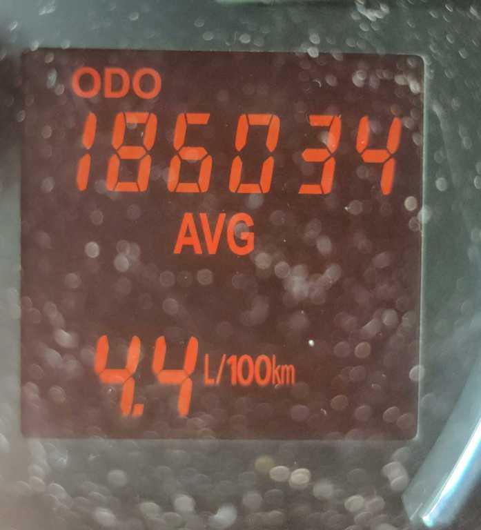

after 11500km +/- my MAP sensor is dirty again.
185630km is the total odometer
My fuel consumption was steady 4.1L/100km average
this week it went to 4.6L/100km average
So I exchanged my spare one for the clean one.
Also cleaned the intake manifold with carb cleaner
I changed my oil again after 8158km.
Its getting dark and a lot steam after opening the oil cap
fuel average is not correctly shown due bigger fuel tank. I am using 4.1-4.2l/100km
