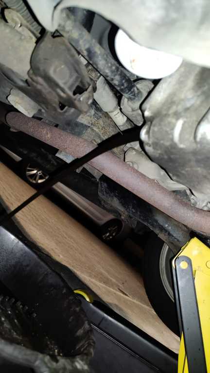

I came across this project and saw you installed a sway bar in the front.
The l276 has some awful body roll but i cant seem to find a sway bar and end links.
Do you maybe have part numbers?
Love how the car looks btw
The swaybar is from an automatic cuore 276. They do sell it with the subframe combined here. Swaybar links can be found on the internet.

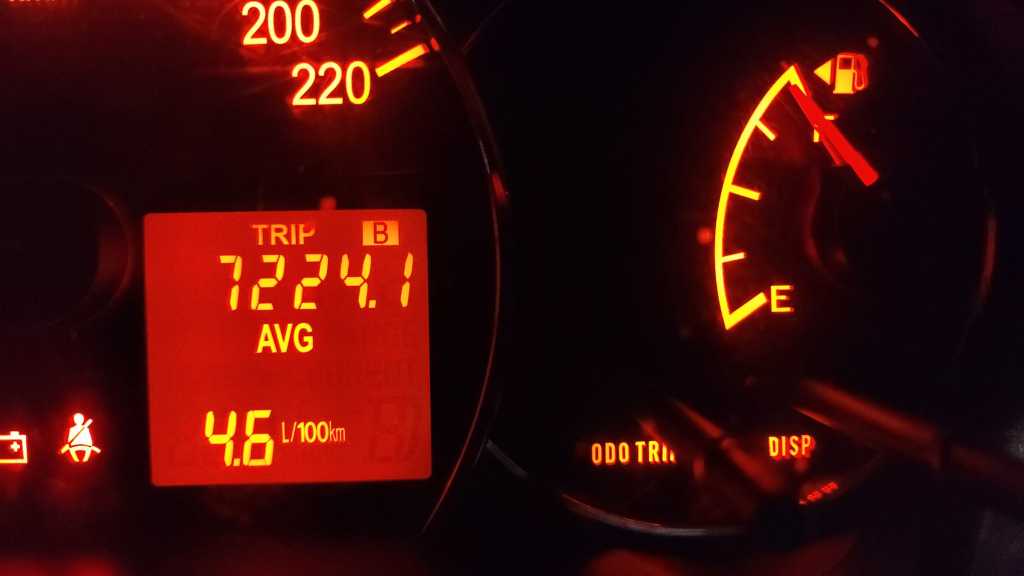

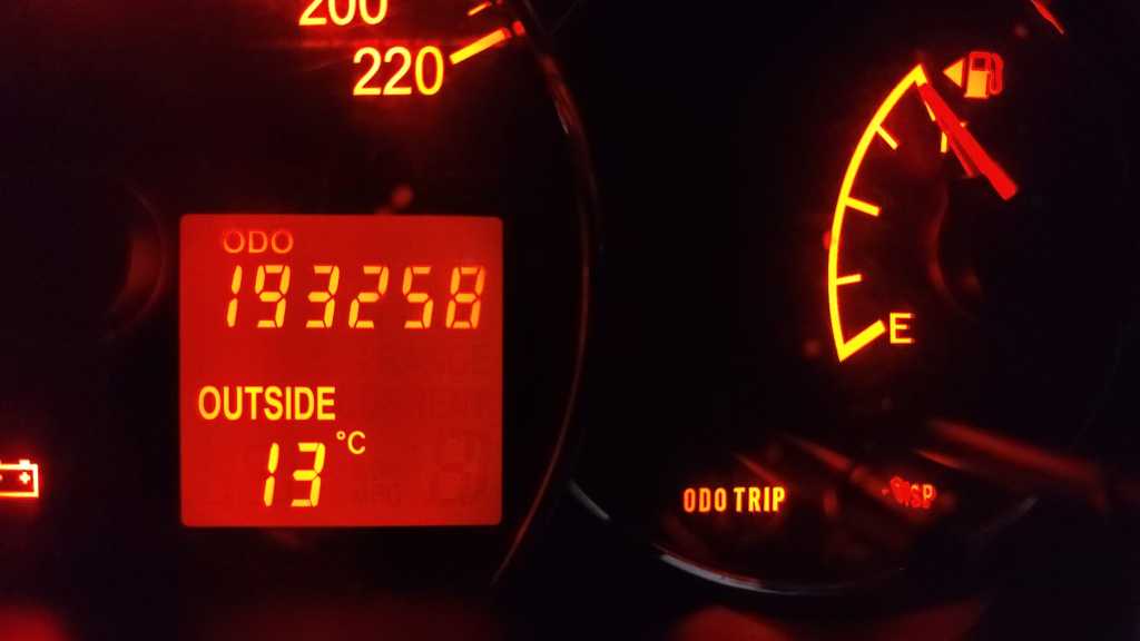

I did with my cuore 887km on a fuel tank. Still not empty. See my average. This is a Materia Tank (40L)

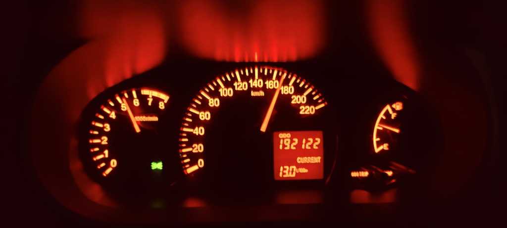

Did also a short top speed run on the Autobahn still the same top speed:
With the decat it did run faster…
