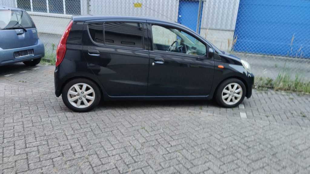

Project Müllheim, L276 Resurrection (semi track?)

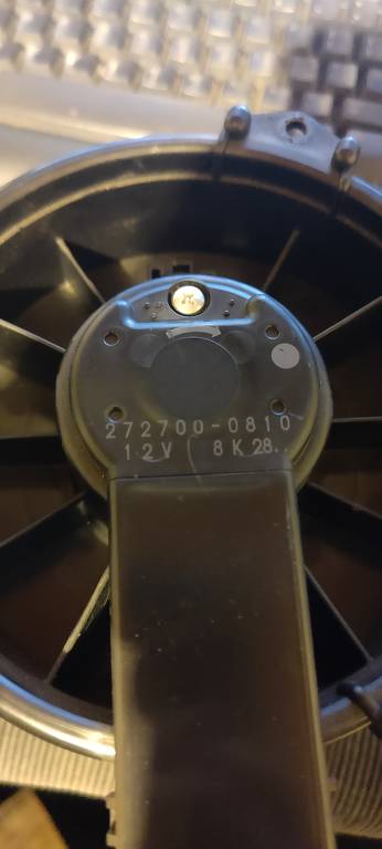

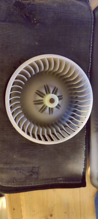

Blower also makes a screeching noise so used one.
Fixed the blower,

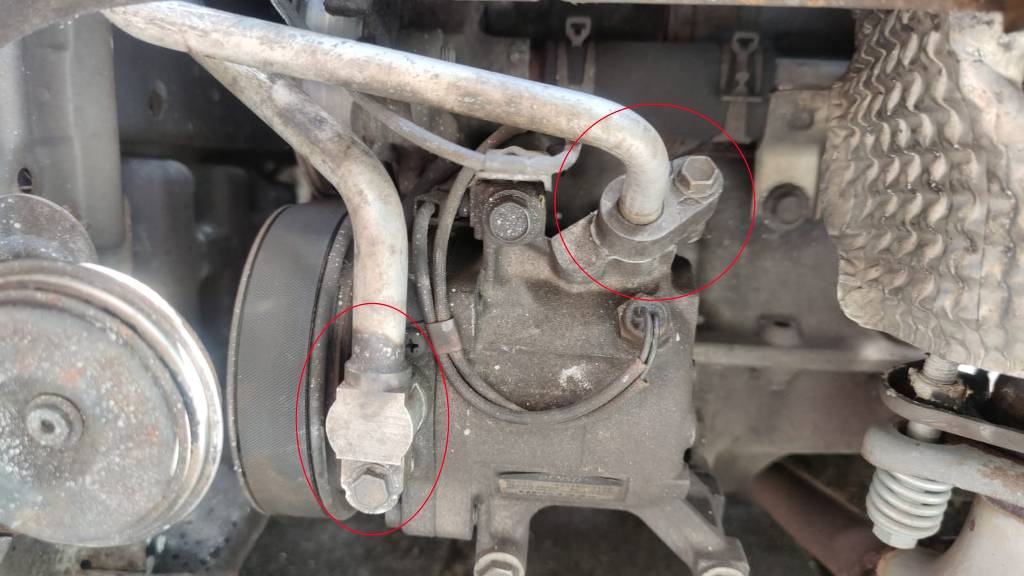

Fixed AC leak now permanently.

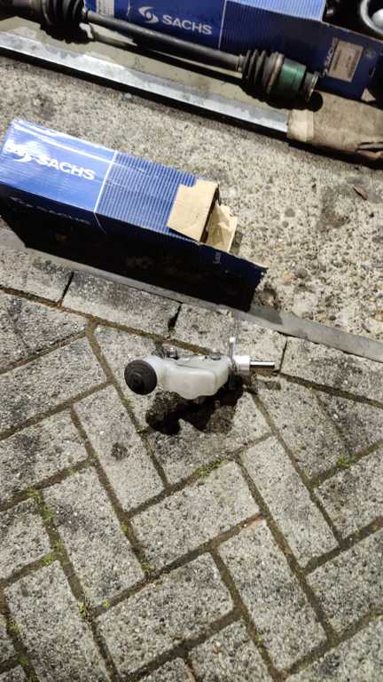

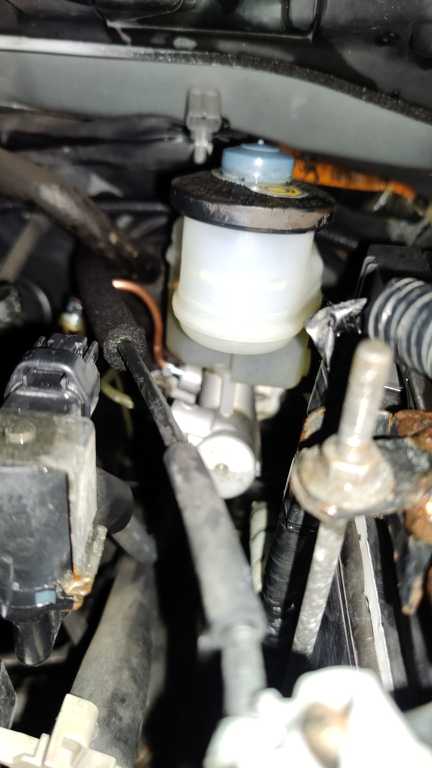

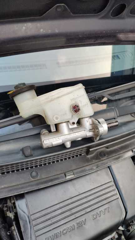

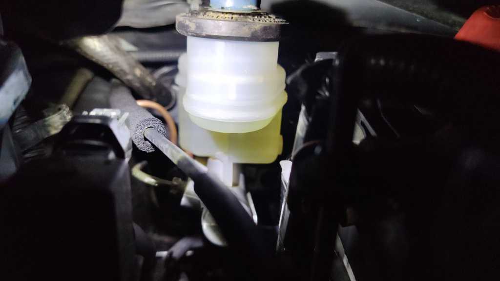

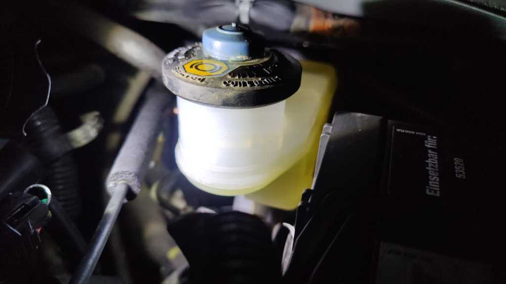

Replaced also master cylinder to 22mm (7/8inch)
Brake pedal spongyness is almost gone.
It was 19mm (3/4inch)

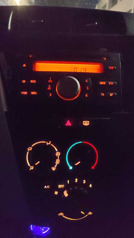

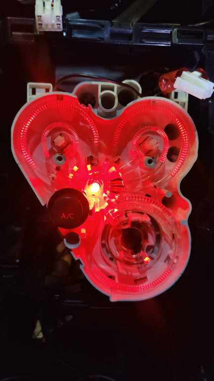

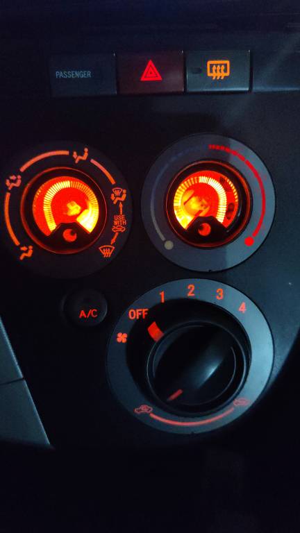

Fixed midconsole lightening,
will later get the correct colour ones

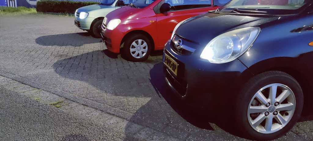

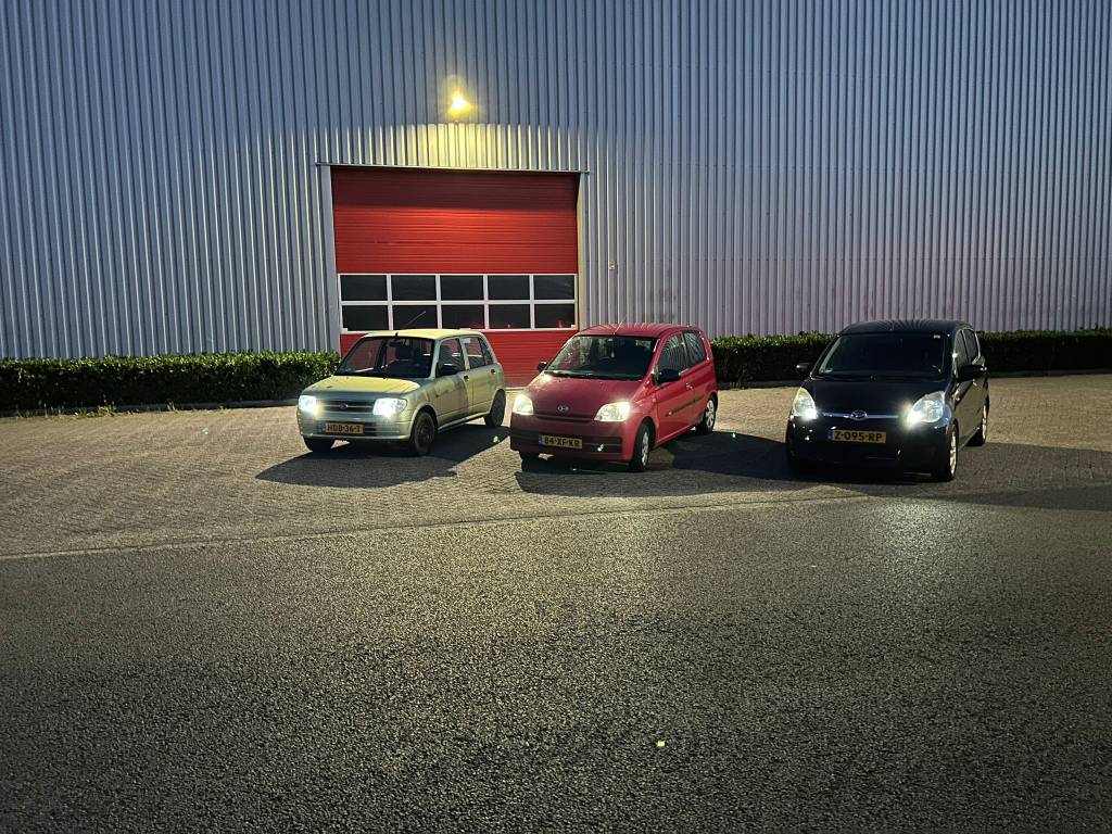

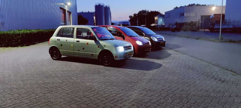

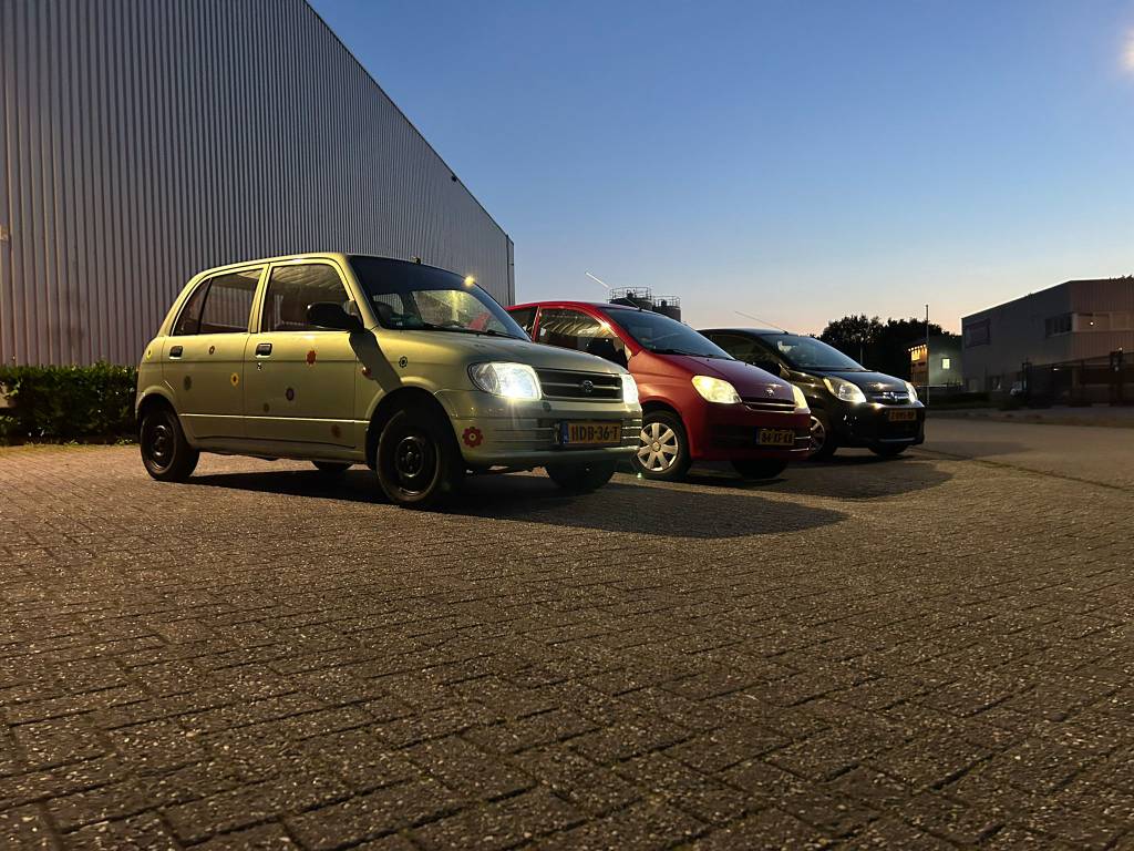

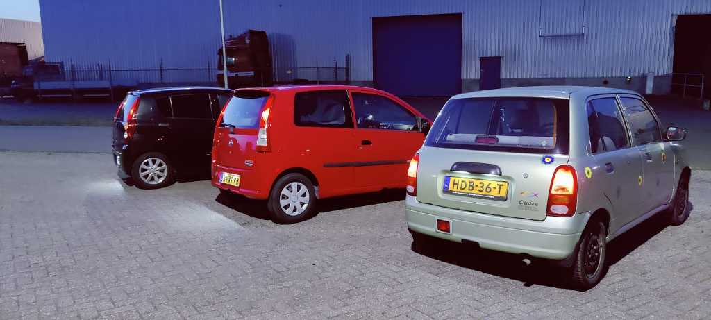

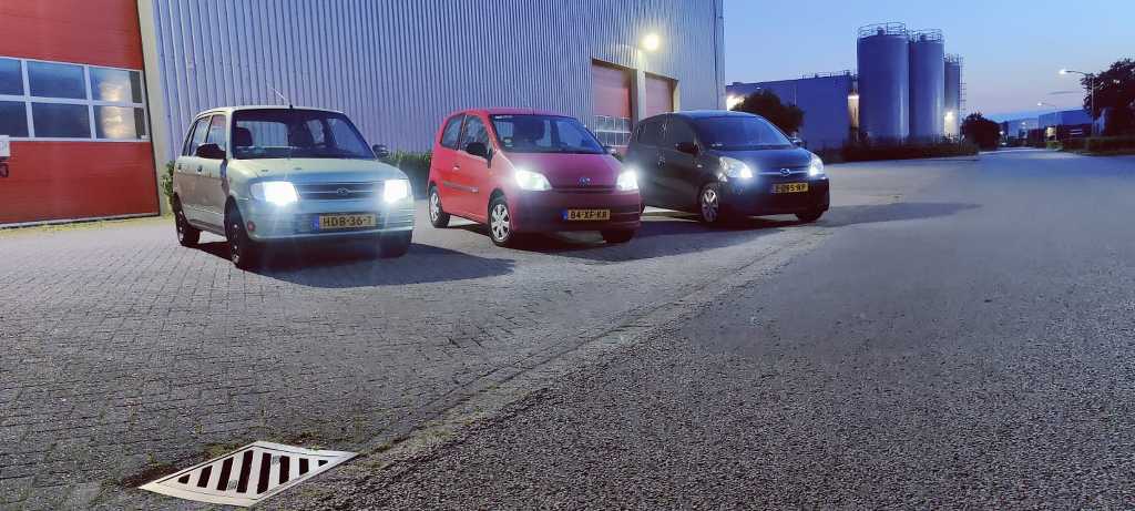

Did a small meeting yesterday with L251,L701 and L276.

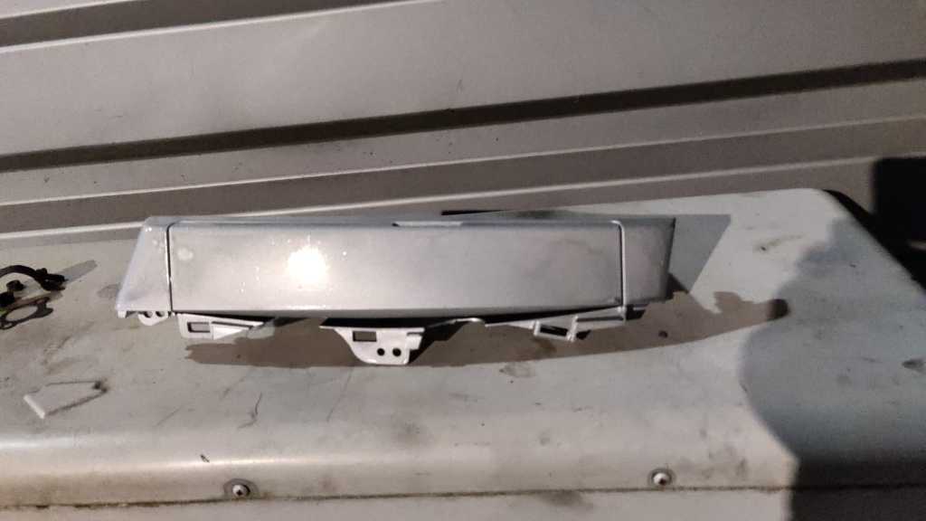

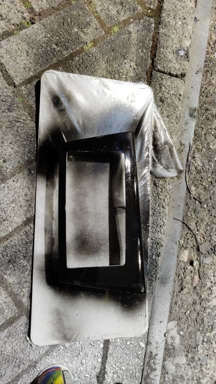

I also painted the side storage to silver as this was an option on mine.
I will redo it with the correct paint.
It is better than the scratches on the panels
and restored all the bulbs working
[quote=“enshiu, post:82, topic:6724”]Replaced also master cylinder to 22mm (7/8inch)…Brake pedal spongyness is almost gone.
It was 19mm (3/4inch)…
[/quote]
Somebody must have replaced the original master cylinder with a wrong one, then. Did you order the new cylinder exactly according to your vehicle’s identification number or is it a cylinder determined for a different vehicle type or brand?
No its because the calipers I have are bigger now than before.
Also it was already spongy when I bought the car.
Daihatsu Terios master cylinder is much better now. Its the same size as the Materia as I have the brakes of the Materia
Its very easy with a small master cylinder and big calipers you get spongyness on the brake pedal.
Thats why most Japanese cars come with big master cylinder and small calipers

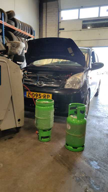

A/C testing, works flawlessly except the blower is not going quick enough on pos. 4.
Will order a resistor new see what happens.

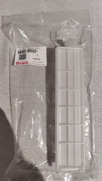

Installed new cabin filter trim/flap.

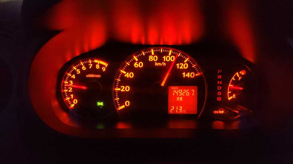

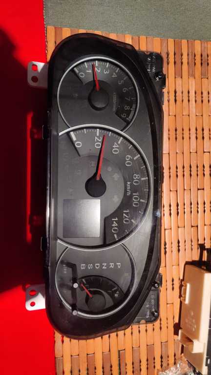

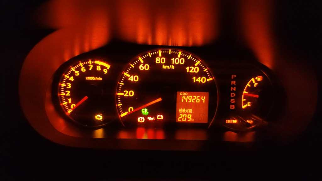

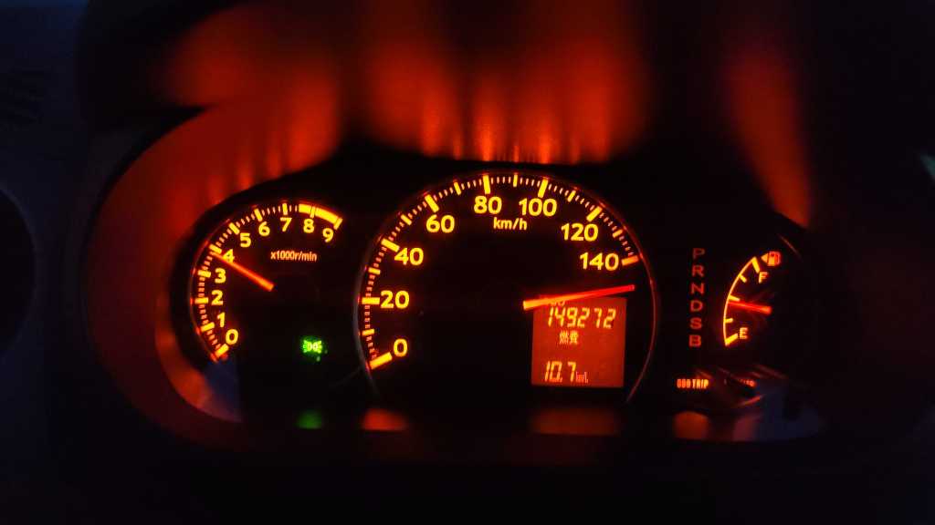

Also installed JDM instrument cluster.
Everything works plug and play no mods needed
Need to adjust the mileage to the correct one.

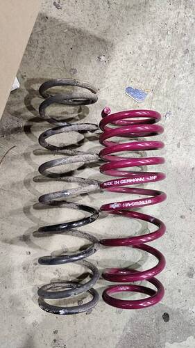

[/quote]I didn’t know Germany still makes springs. Even if these didn’t lower your car, they certainly are an improvement over stock springs, given that they’re progressive. Did you deliberately order these from a German manufacturer or did they arrive as a surprise package? [quote=“enshiu, post:22, topic:6724”]…They took over the TUV report…[/quote]But T.Ü.V. doesen’t take RFW reports. If they did, I would have saved plenty of money, simultaneously driving a dangerous car

I know the 276 should be the best one but NO…
Its my dream Daihatsu when it was new in the showroom
I had my driving licence for like a few months back in those days (2008)

Terios 2006-2016 master cylinder is still available (7/8", 22,66mm)
No need to relocate filling house as this is same as the Cuore 276 one.
Almost a 1:1 swap if factory
didnt crossthread the rear thread
new and used (check autodoc)
The Aygo rear shocks didnt make the car feel better just same as stock.
A/C was working, it didnt had a leak on the condensor.
Just a peace of mind replaced it.

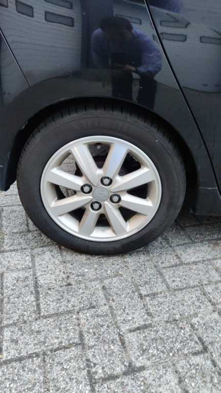

Vogtland still makes the lowering springs for Daihatsu
Lowered 40mm rides a lot better with lowered and new shocks

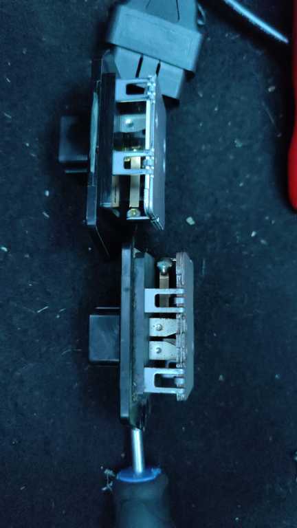

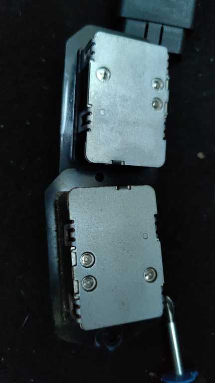

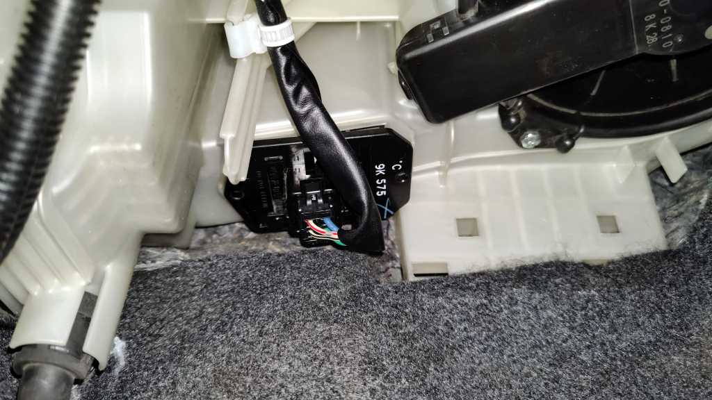

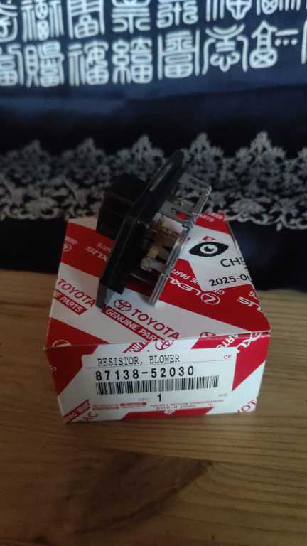

I got my blower resistor in finally after 1 week:
Working on the HDB today.
Nice try Toyota…
The Cuore 276 has a weird resistor compared to the rest of Toyotas I worked on.
They reversed the wiring of the resistor for nothing…
or does the LHD differ from the RHD models?
It appears that the socket is turned upside down. This doesen’t mean that it shouldn’t work. To be sure, you may wish to measure the resistance between poles on both devices, using the socket’s one way casting as reference, placing each one side by side next to one another. In other words, turning one of these devices upside down, to match the device’s plug direction
plug fits, wiring is upside down, will make an wiring adapter to let it work

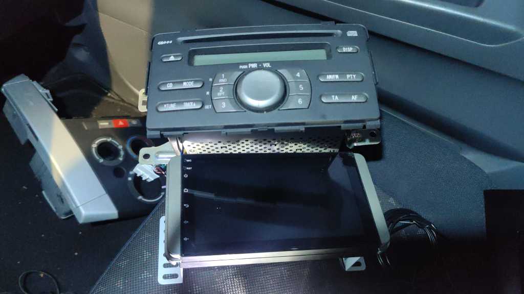

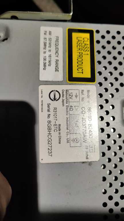

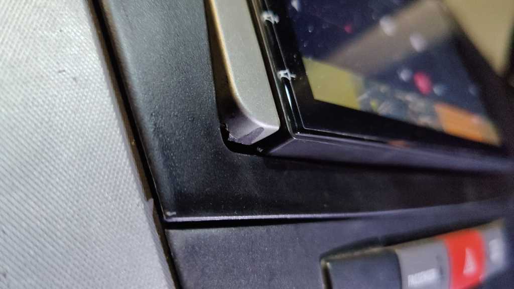

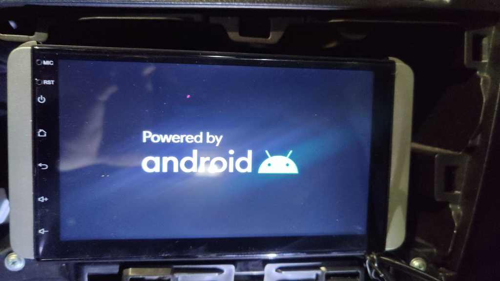

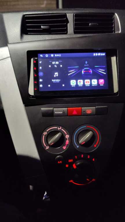

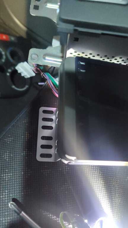

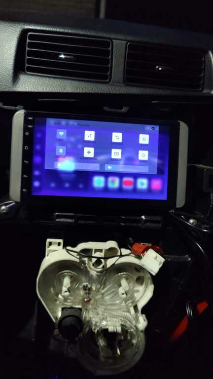

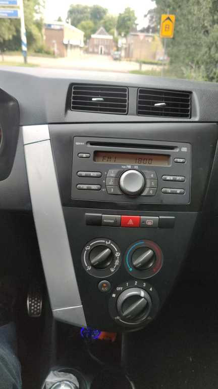

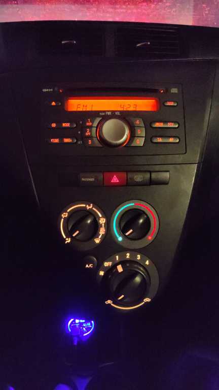

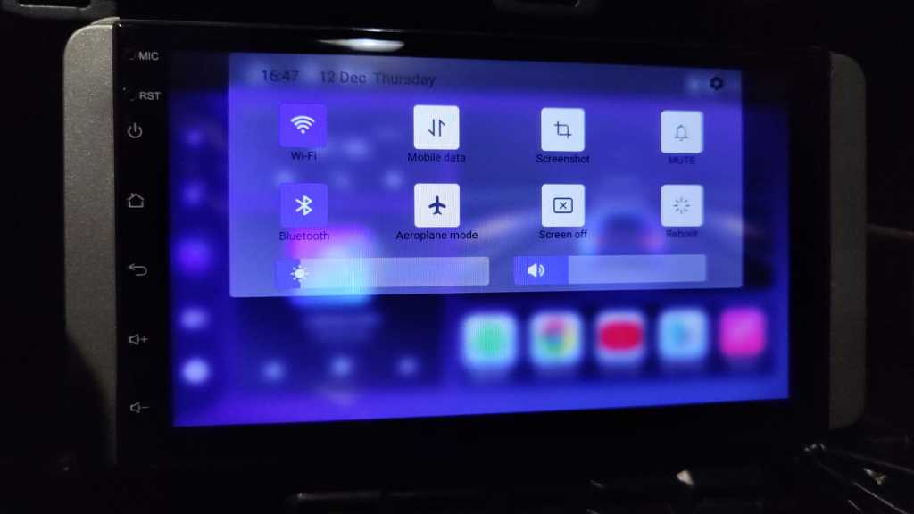

Radio replaced now:
Need to receive the correct bracket for installing:
[quote=“enshiu, post:92, topic:6724”]…plug fits, wiring is upside down…[/quote]How do you know, the wiring is upside down, just because the plug is? I’m betting, the wiring coincides perfectly, despite the plug installed upside down
Wiring scheme is on the resistor…
Completely reversed.
Speed of the blower is like this
OEM resistor vs toyota resistor
0 - 0
1 - 4
2 - 3
3 - 2
4 - 1
Sounds close enough to me.
so If I connect this resistor pos. 1 is full speed etc

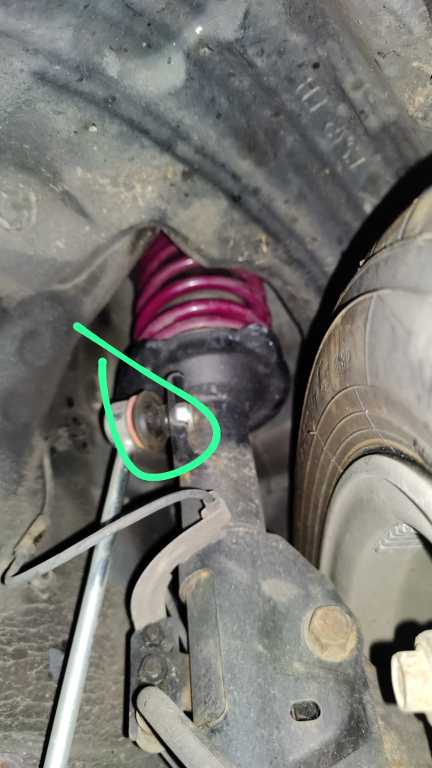

Tightened the Sway bar links
Left came loose after so many abuse

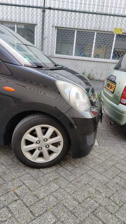

roundabout maximum cornering

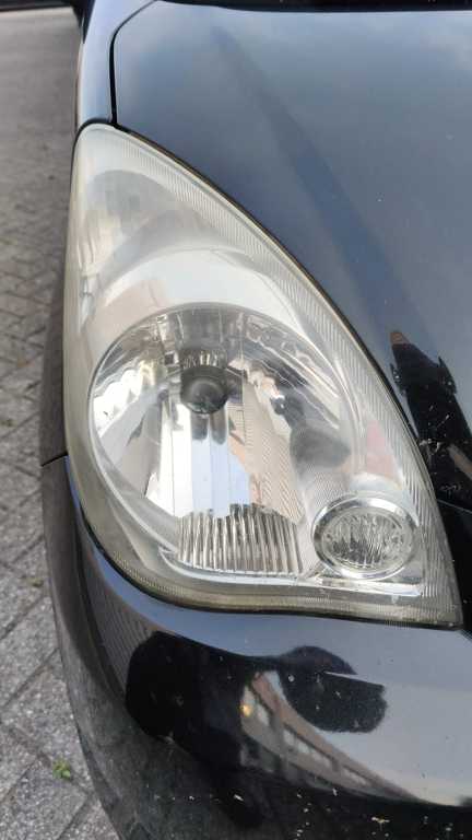

Polished the Headlight again

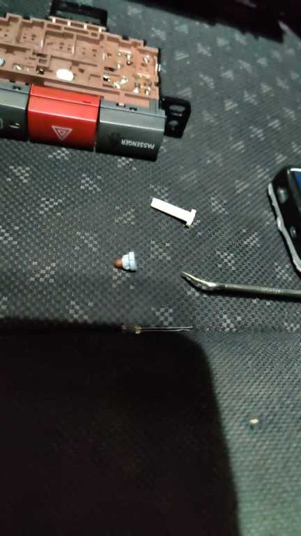

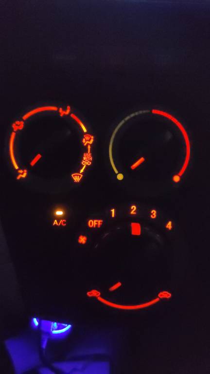

Fixed the Midconsole lamp finally with an Orange silicon

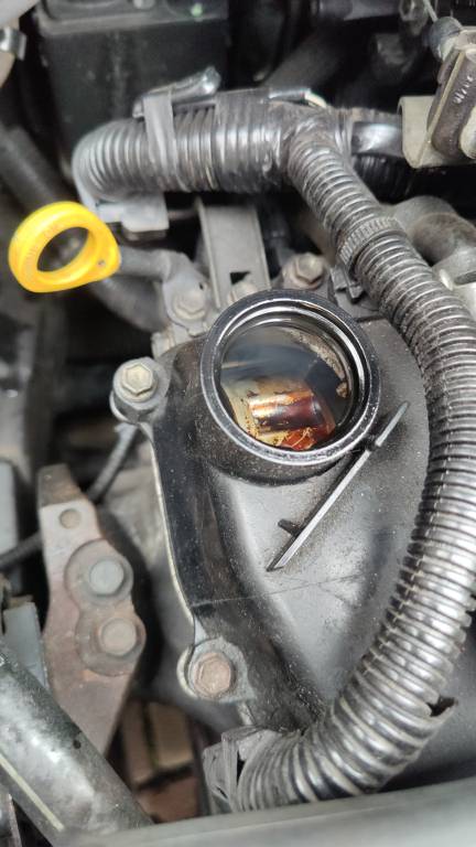

Filled engine oil 0.5L 0W20 again (3300km)
