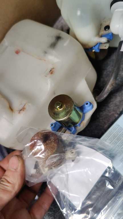

So the oem washerpump pre L701 are still in production just need to find it
Asmo oem number: 860310-0940
Mazda FC/FD RX-7 : 8532-76-672
Maxgear: 45-0057
At 10euros no modding just plug and play fit

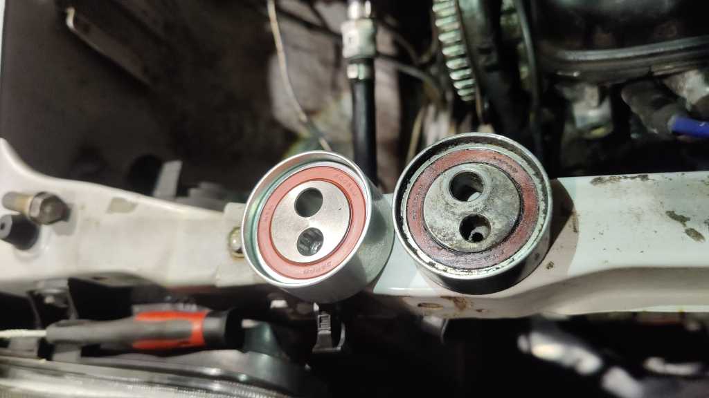

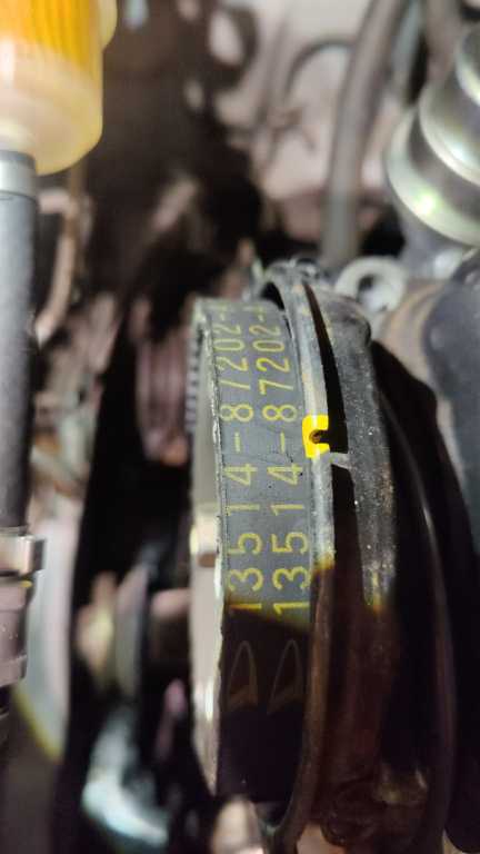

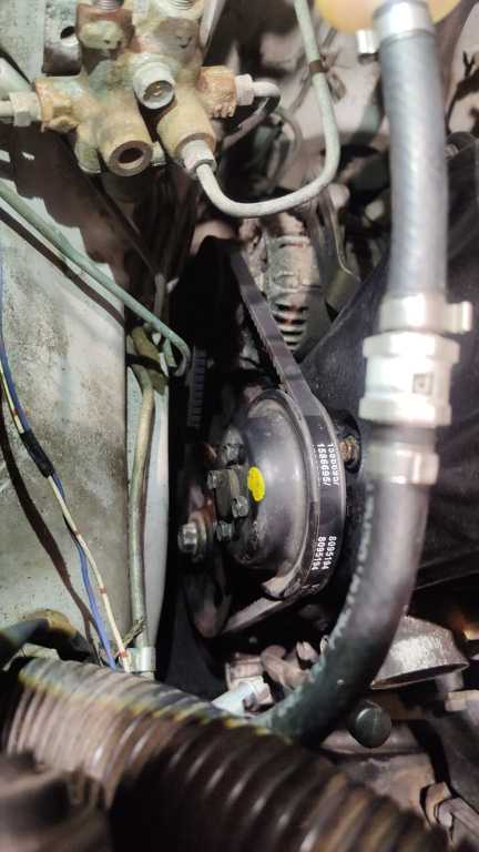

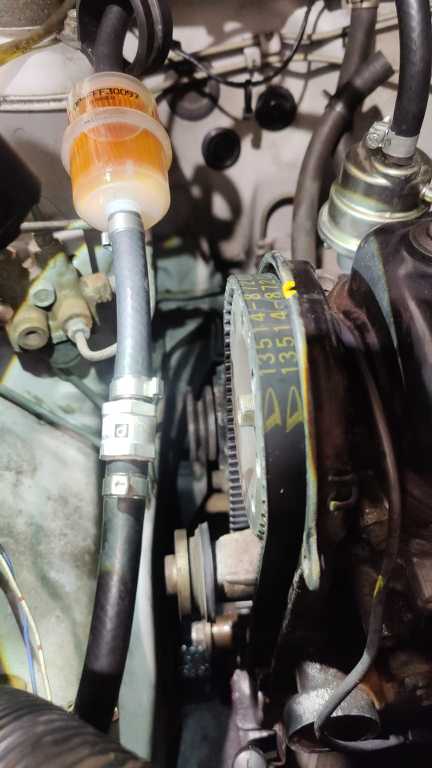

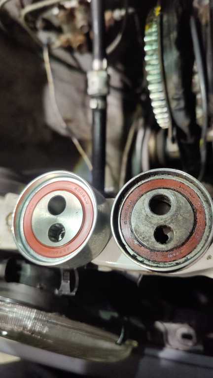

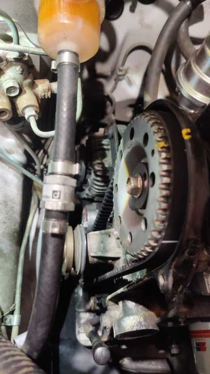

Changed timing belt and tensioner on the L80
Changed also aux. belt
Appears to be never changed before

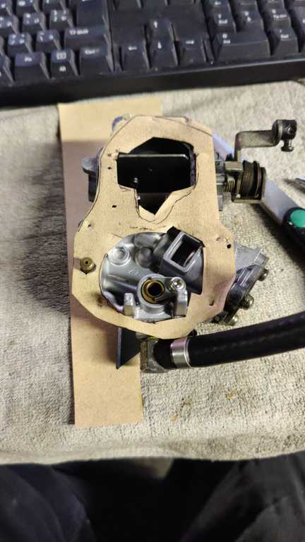

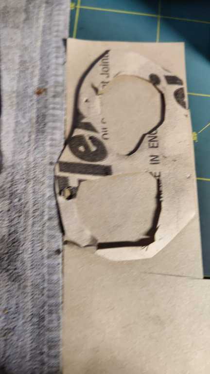

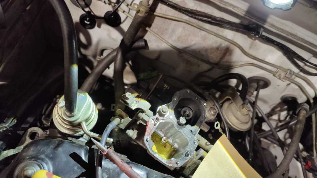

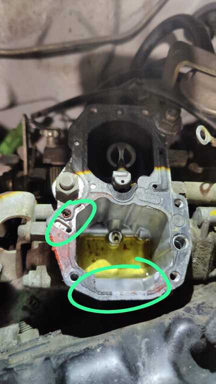

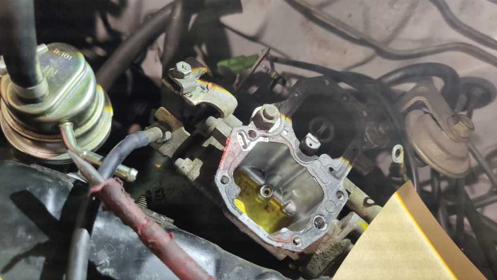

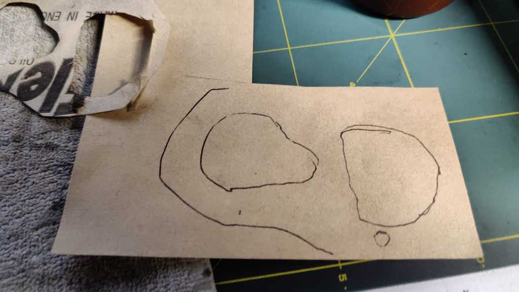

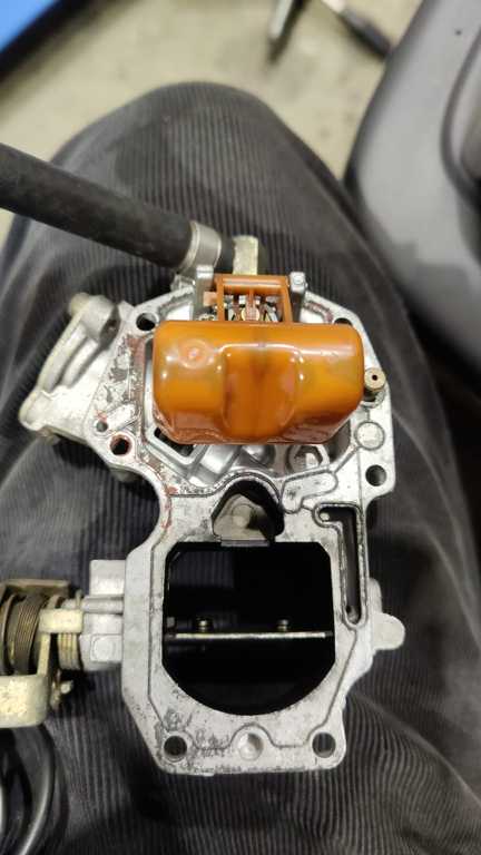

opened the carb some liquid gasket (red) fell into the floating chamber and put it stuck
Removed and now need a new gasket

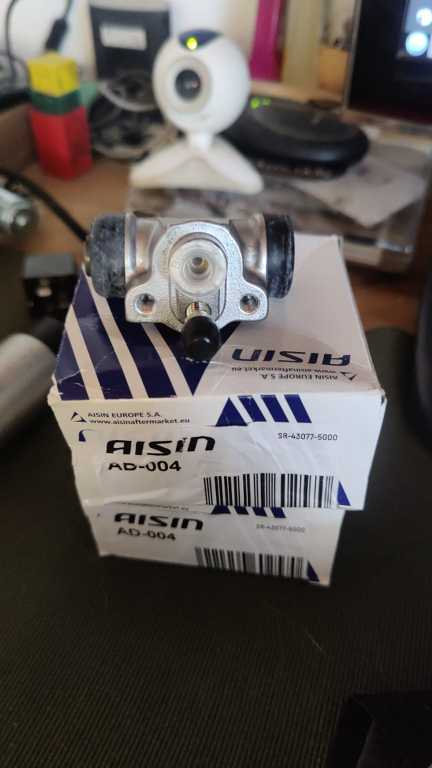

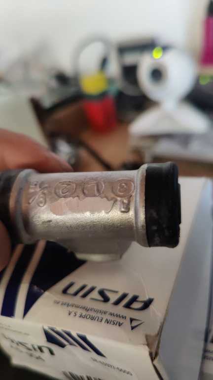

Got my rear wheel brake cylinders in

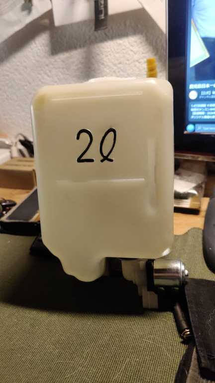

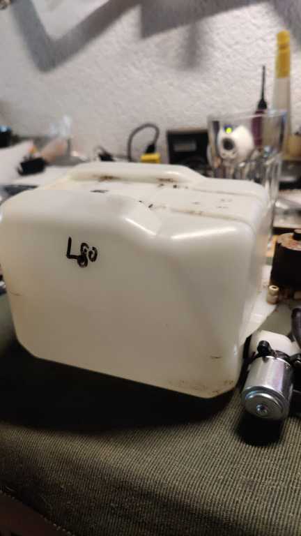

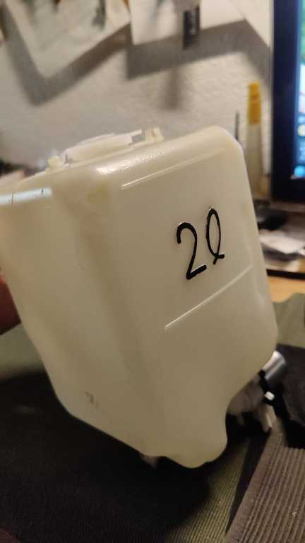

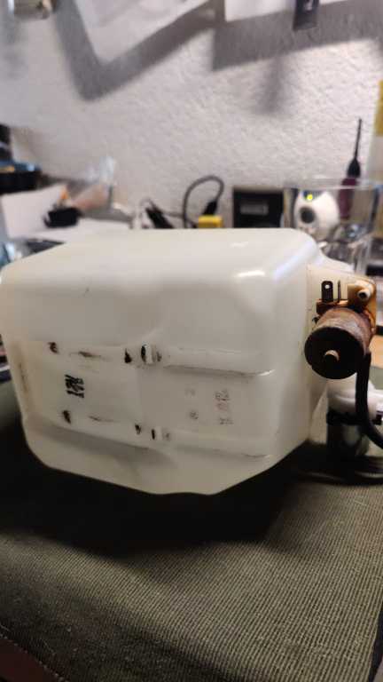

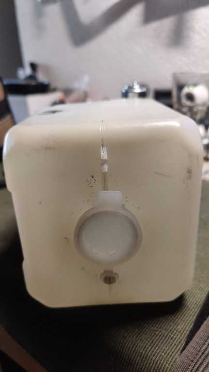

Washed washer tank clean
painted letters to black
waiting on oem style pump
Those look cast in aluminium alloy. If so, the best I could do was to find TRW aluminium cylinders, years ago. You seem to have unusual luck in finding high-quality parts
these are OEM with the logo scraped off.
the rest is NLA these were hard to find already
Dont want ABS this time

NTN snr is the oem supplier of the timing belt
Just need to know what to search for
Washer pump installed 45-0057
Redoing the carb gasket its NLA I think unless someone knows to get a new set somewhere.

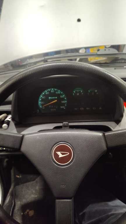

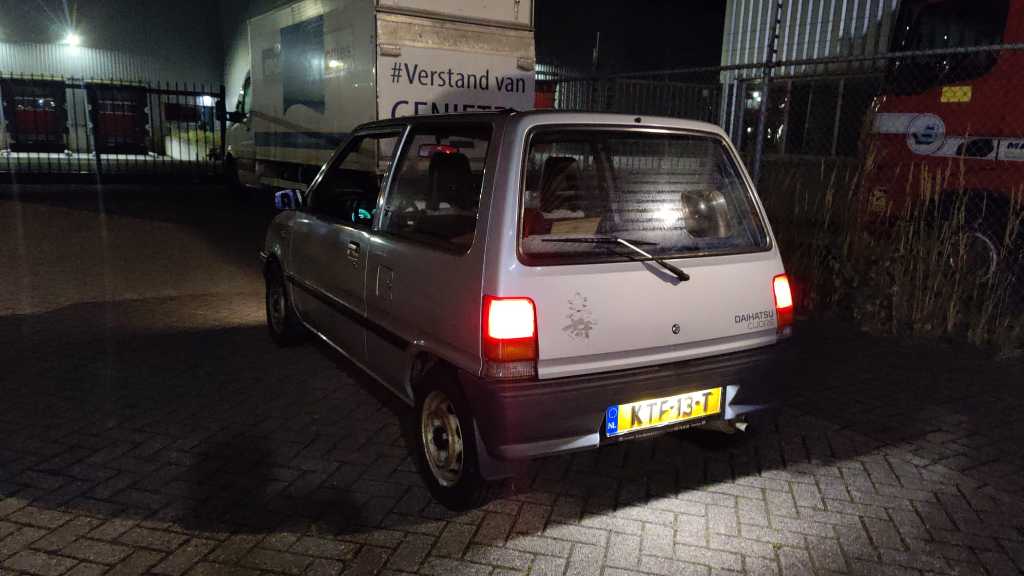

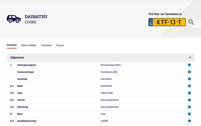

Won the L70V TR-XX instrument cluster as he relisted it the last bidder didnt pay it

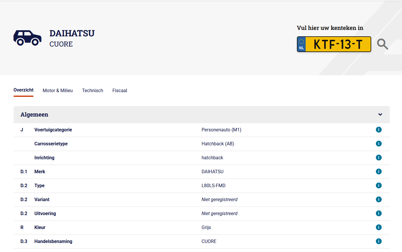

Seems RDW is on Holiday
yesterday they approved the import process
Paid BPM (import fee for cars) 0 Euros and filled in form online

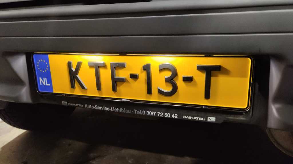

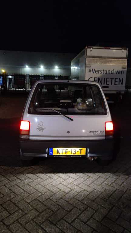

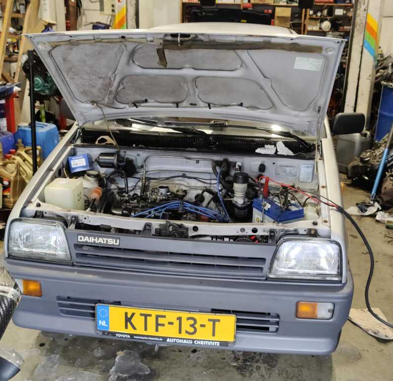

Import took place 23-7-2026
Its finished on 15-08-2026
so it has become KTF-13-T
Its got licence plates and registration

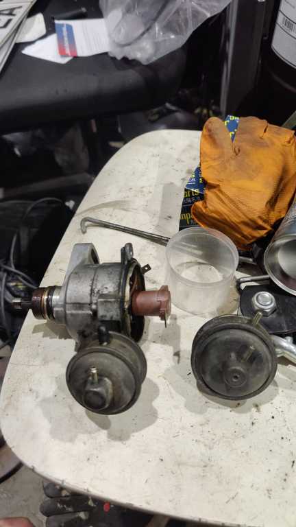

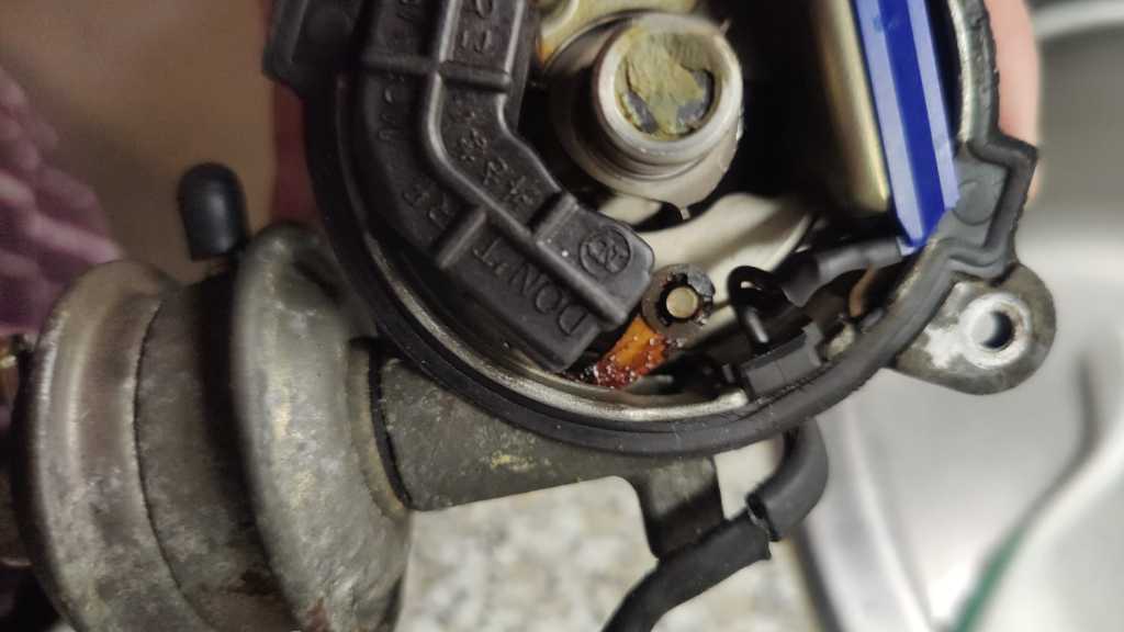

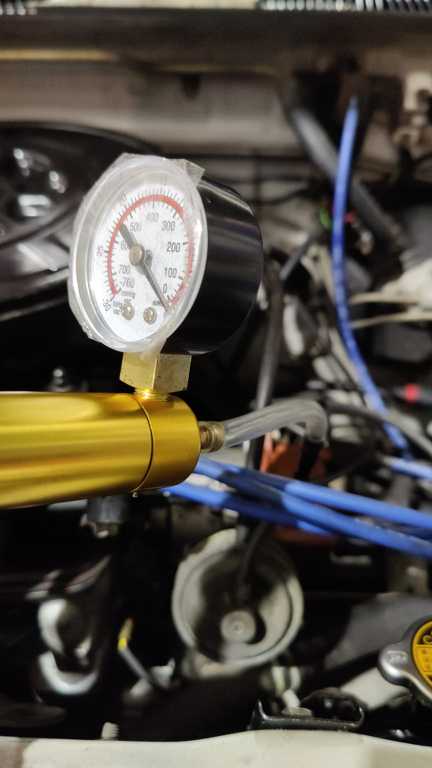

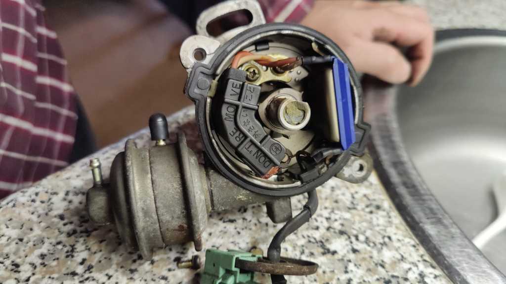

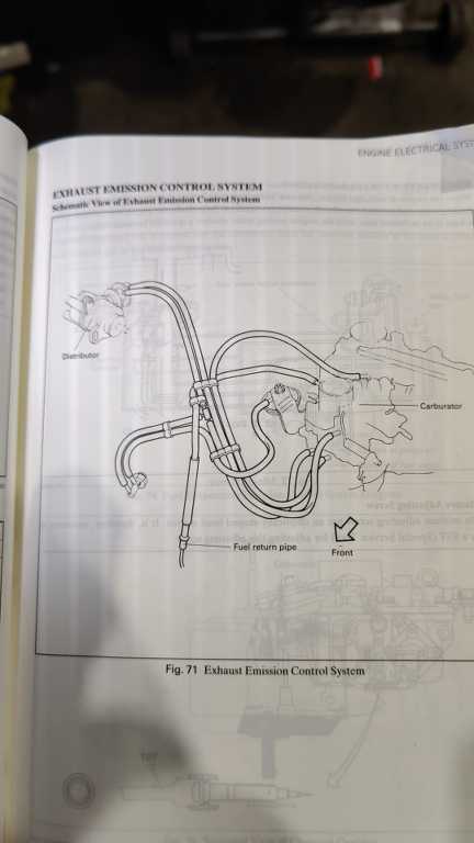

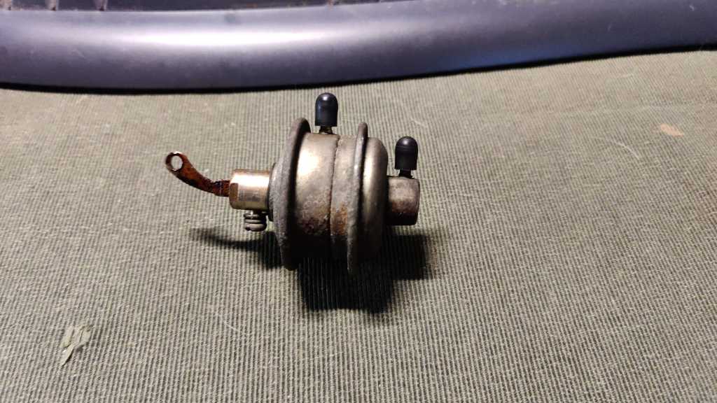

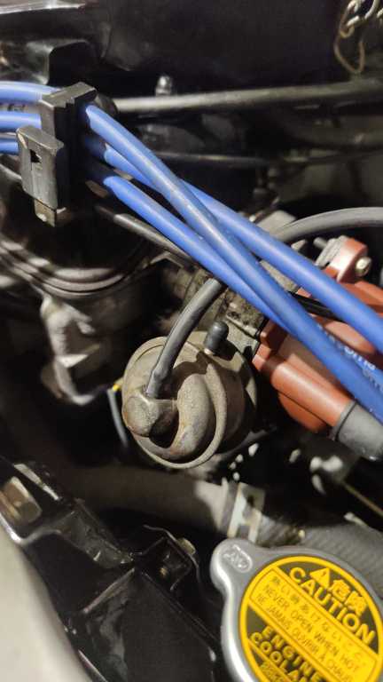

So after 3h searching found the problem

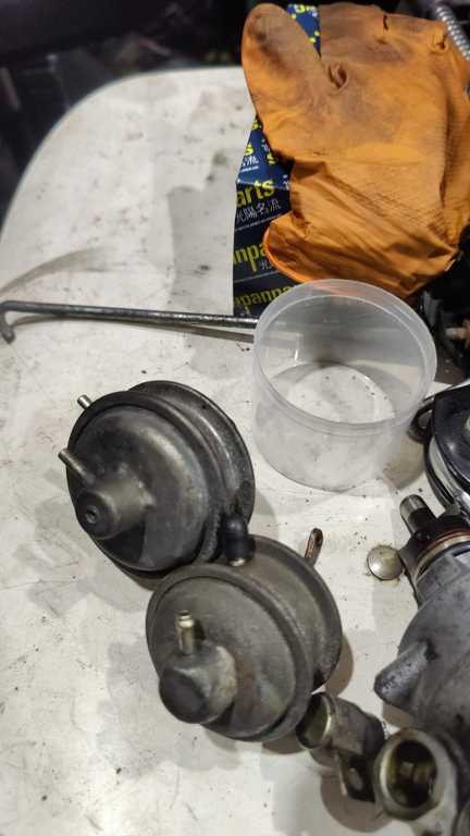

My Vacuum timing assist died
Thats why its idling rough, backfires, hesitates, CO to high
Last owner just deplugged whole system thats why it did run
I re-routed all according system

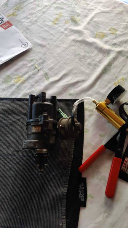

Vacuum tested the timing advancer part and no vacuum holding

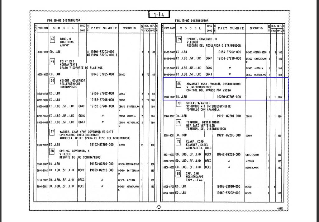

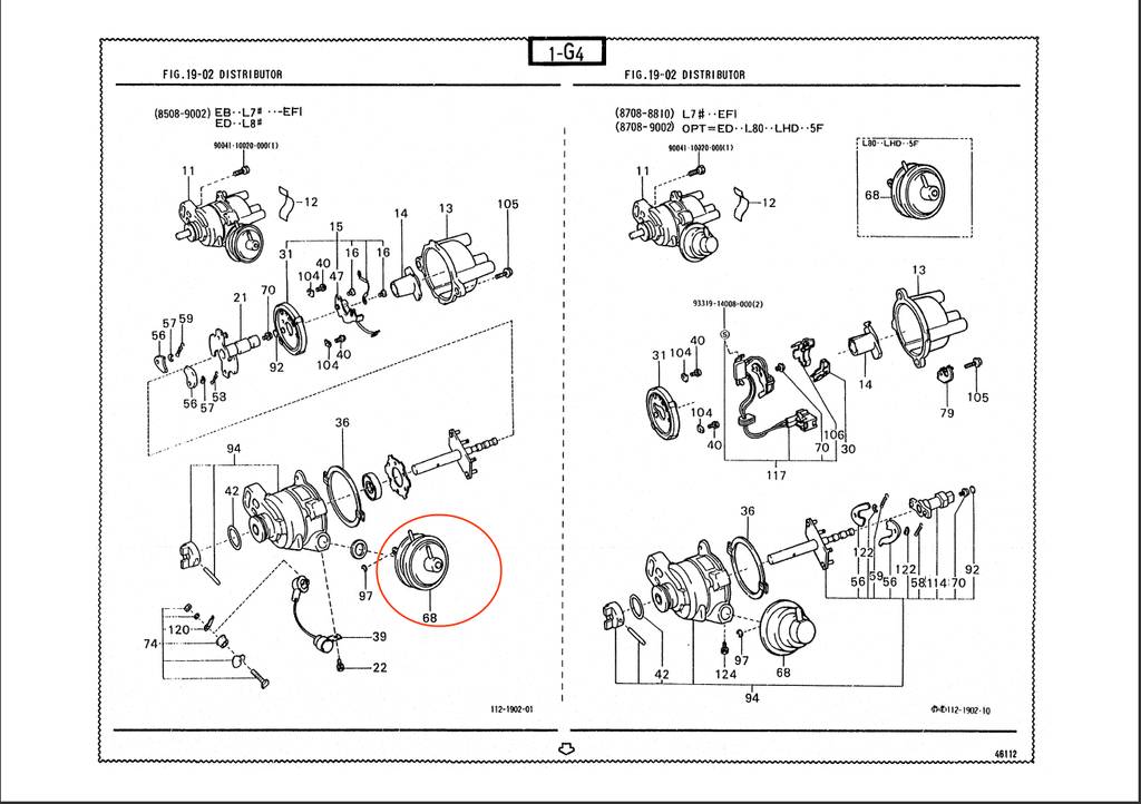

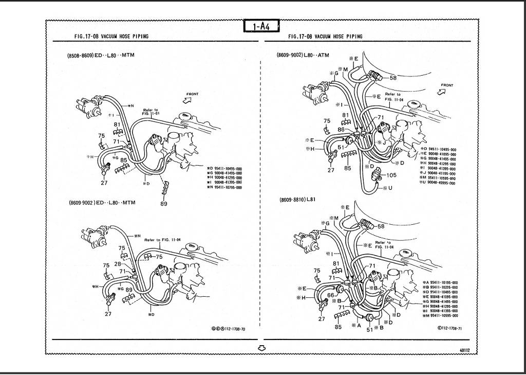

Used the Parts Catalogue to find the parts and routing
Also used oem WM book to compare

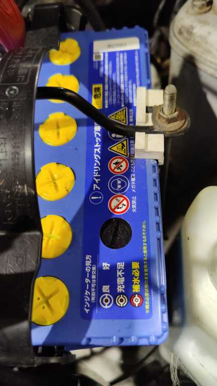

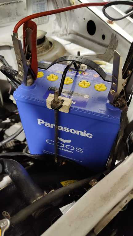

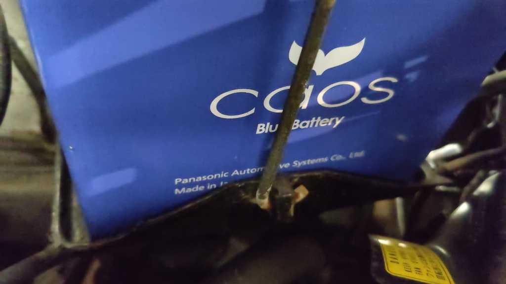

Installed also another battery its a new start stop battery
Old one needed for another project

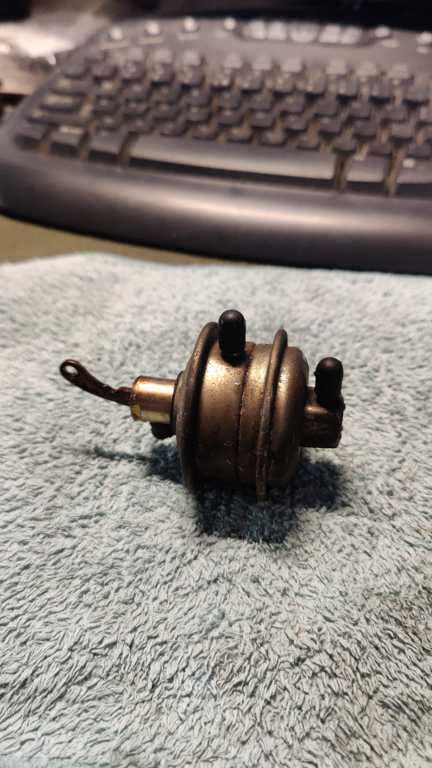

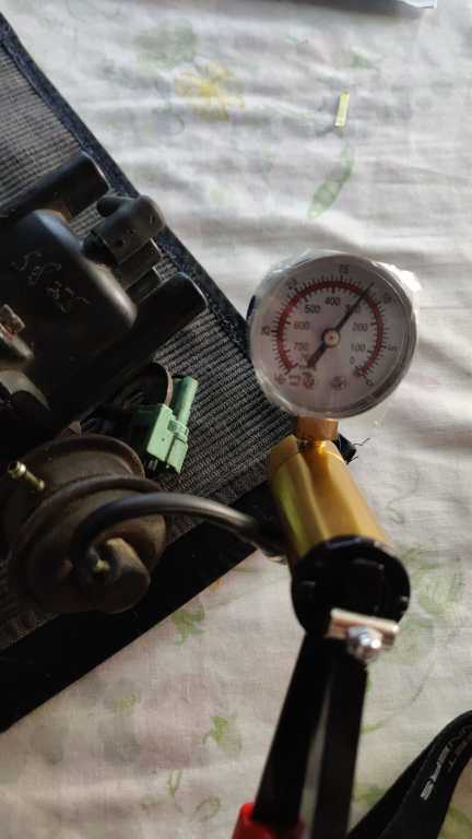

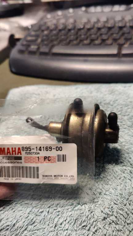

Got the vacuum part in:
Retard is leaking
Advance is holding steady
So will blank retard as per TSB
and only fit advance hose
Also got Yamaha OEM blanks
Better against heat
That’s an interesting battery. Being made in Japan, one can’t go wrong. Neither Amazon, ebay nor Idealo carry it, though.
Your distributor’s retard diaphragm must be leaking at the seam. Did you try using silicone to seal it for testing? Even though the Yamaha vaccuum advance and retard unit looks identical to the Daihatsu’s, that doesn’t guarantee that both are identically calibrated
no the blank plugs are from Yamaha
Battery came from imported car I recently helped importing from Japan they wanted bigger battery so this is left
This unit is from a L2

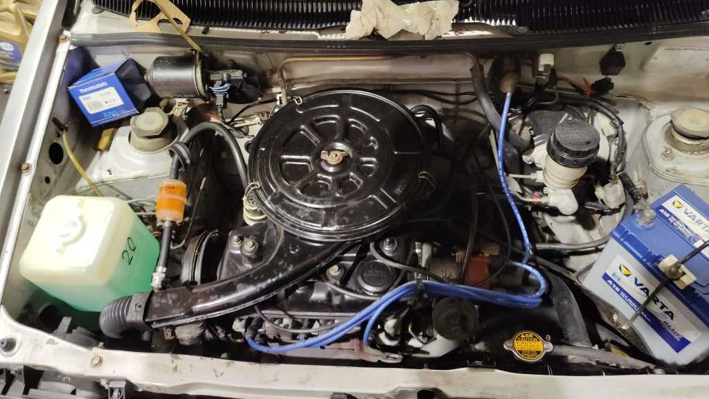

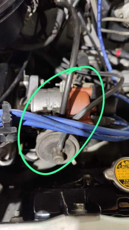

Installed:
Its a lot better need finetuning

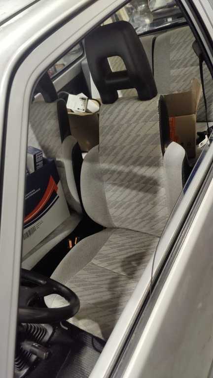

Those are some pretty nice seats, almost reminding me of Recaros
We may end up going to Japan for shopping
it is already got parts all over the world
Like my L276

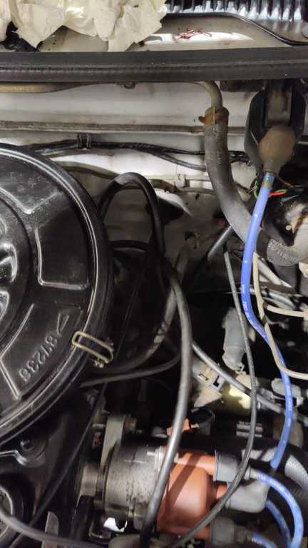

Stil has backfires hmm
found a too big vacuum hose last owner made
