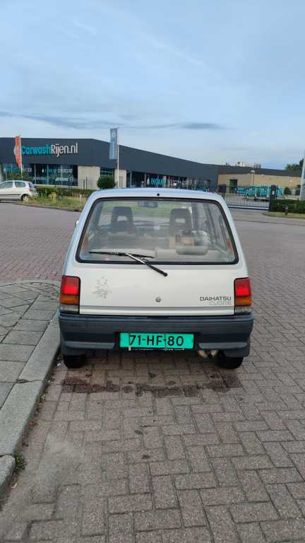

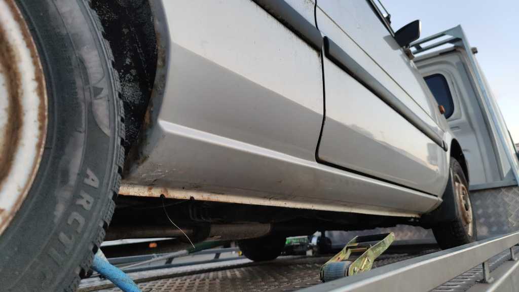

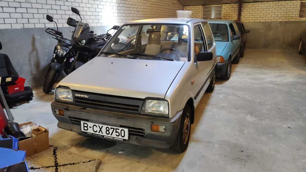

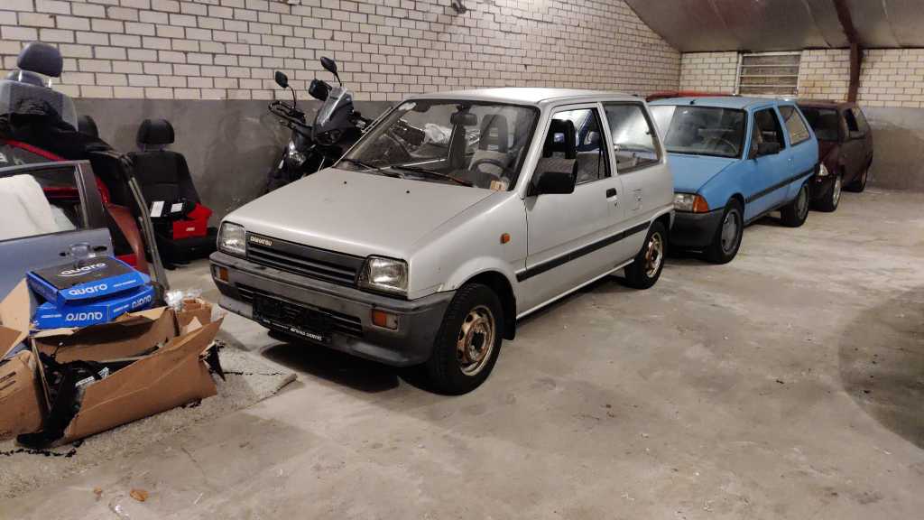

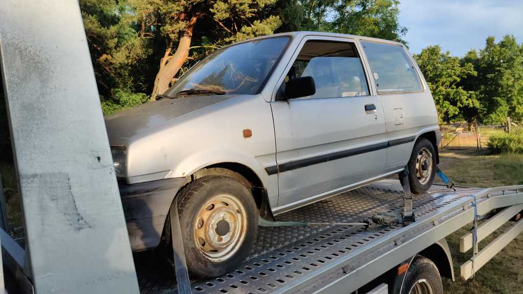

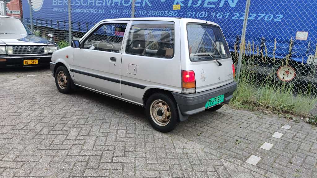

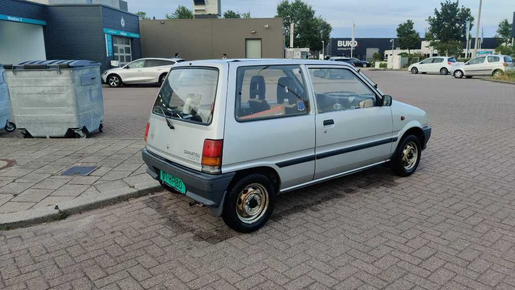

And was most likely never driven on salty roadways. Even when not, I’ve seen rust poke through where owners would neglect cleansing wheelwells from debris. This first owner has presented an outstanding example of discipline.
Just out of curiosity, what did you end up paying for it and did it have a valid T.Ü.V. upon purchase?

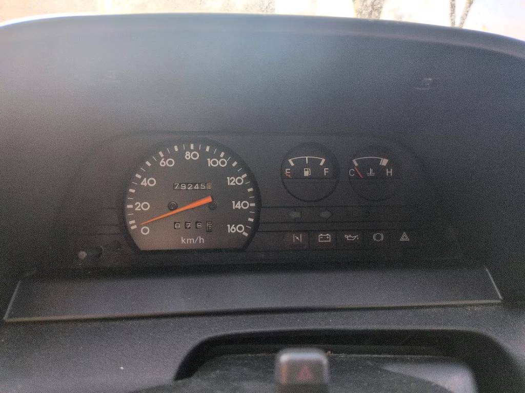

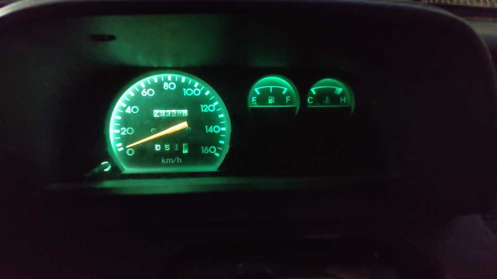

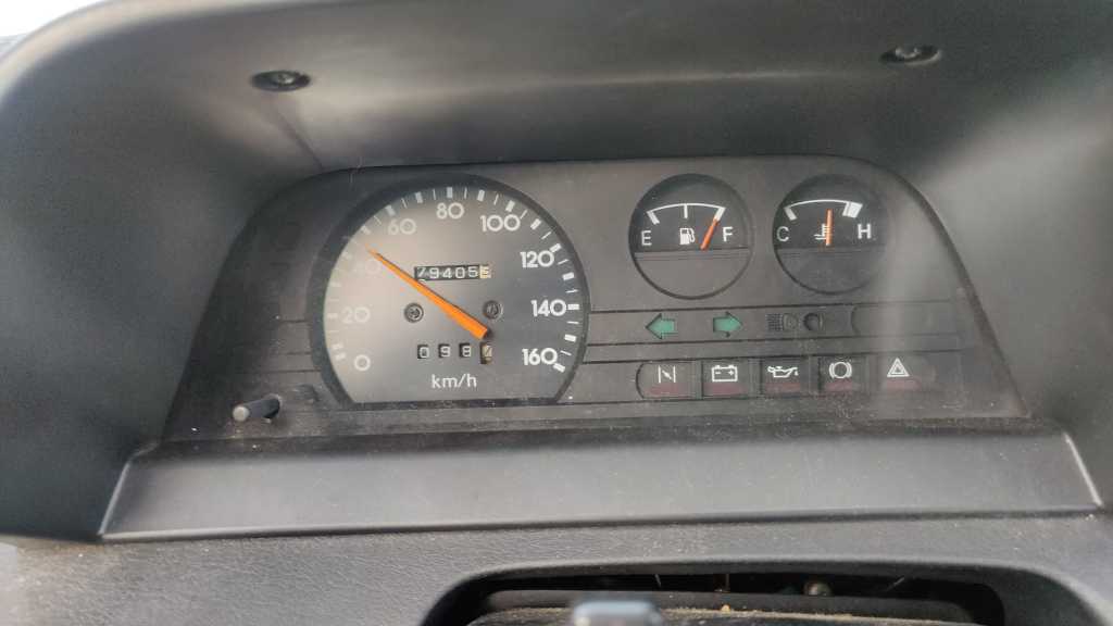

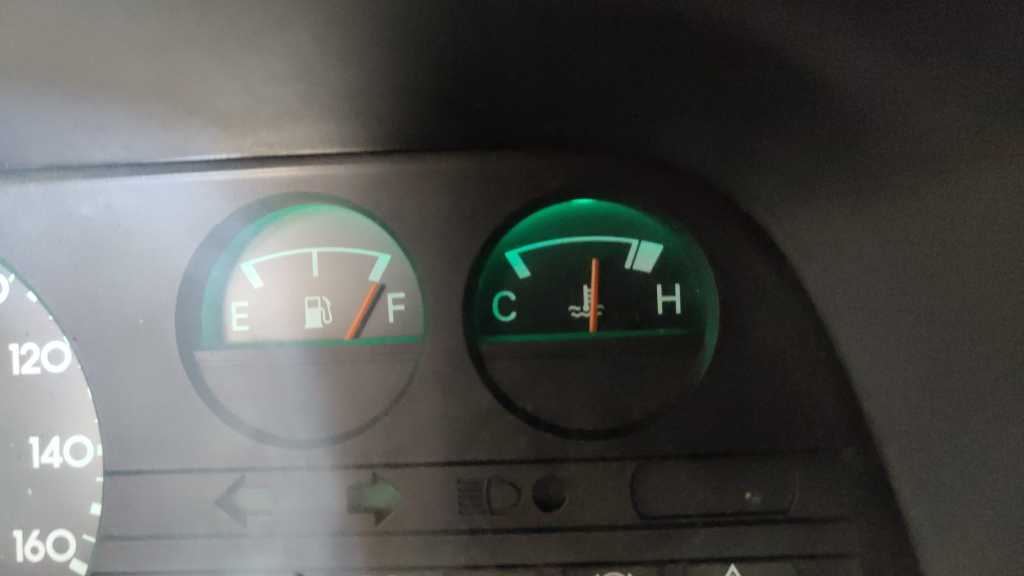

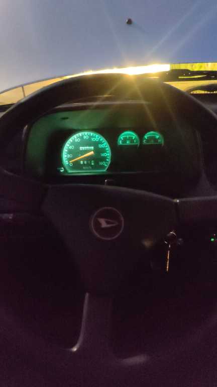

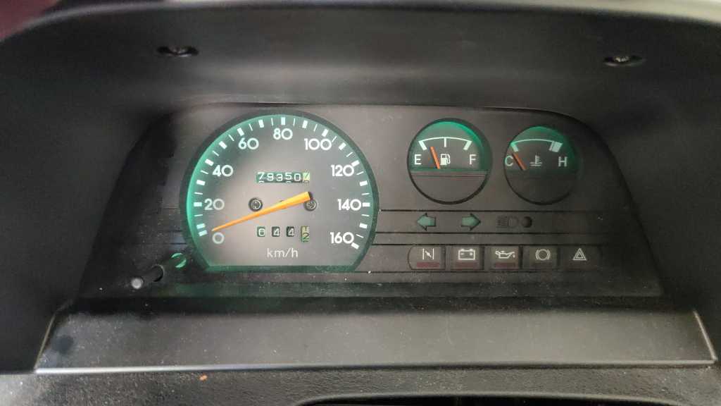

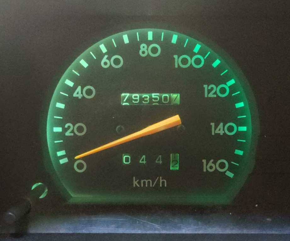

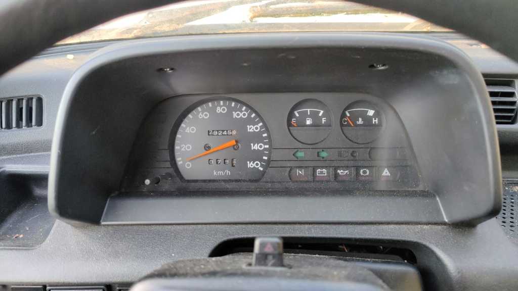

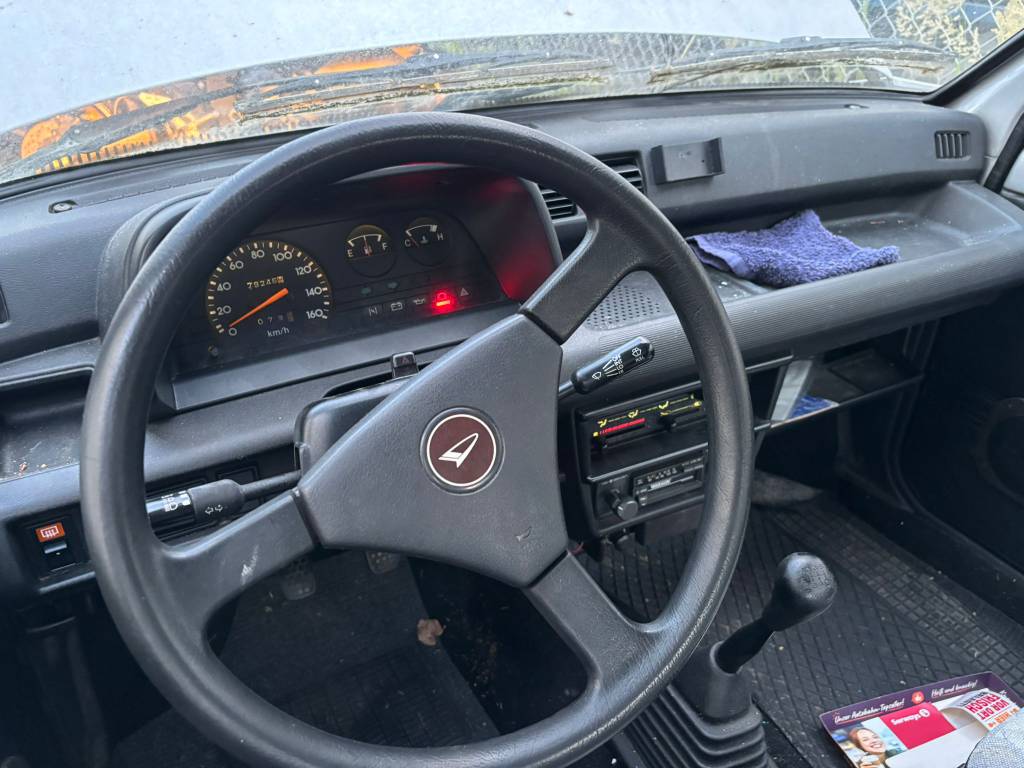

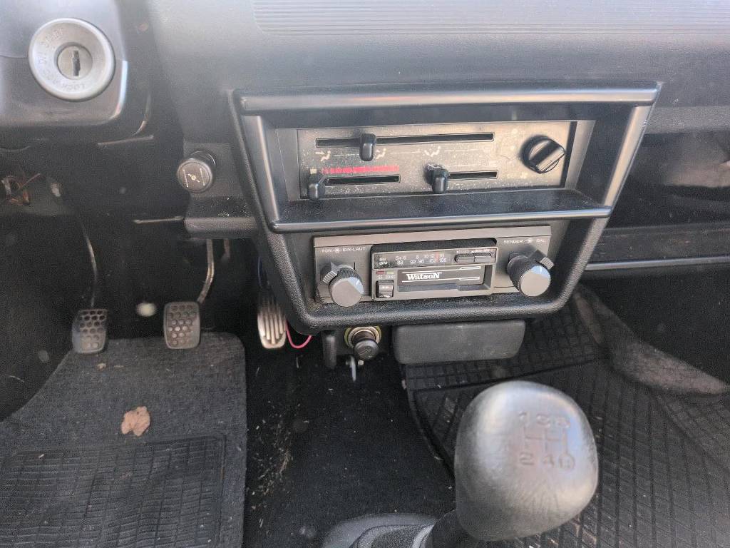

It’s good to know that LED bulbs fit in these instrument clusters. Is the cluster’s lighting now brighter? This is one reason as to why I would like to convert mine to LEDs, given that there is no way to adjust brightness

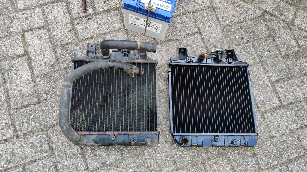

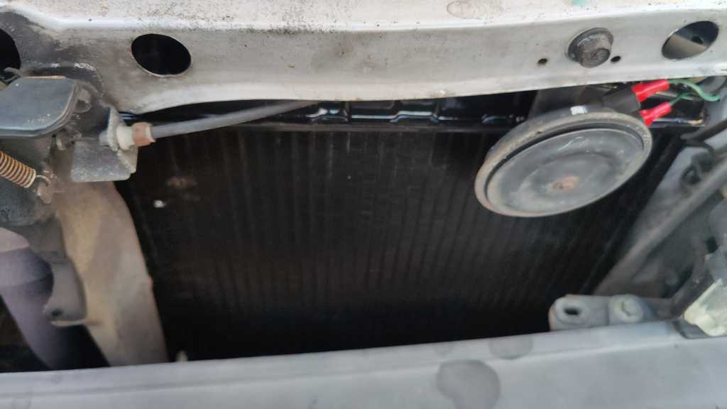

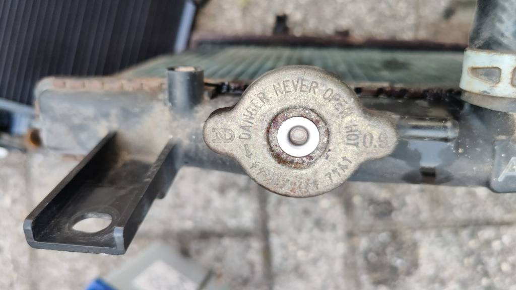

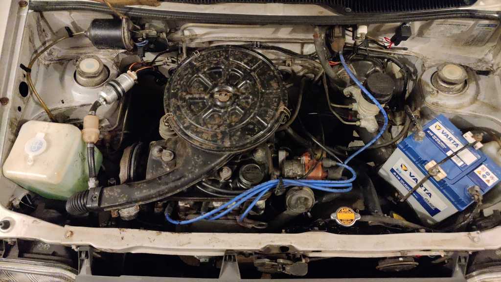

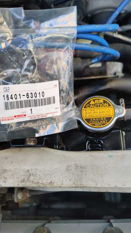

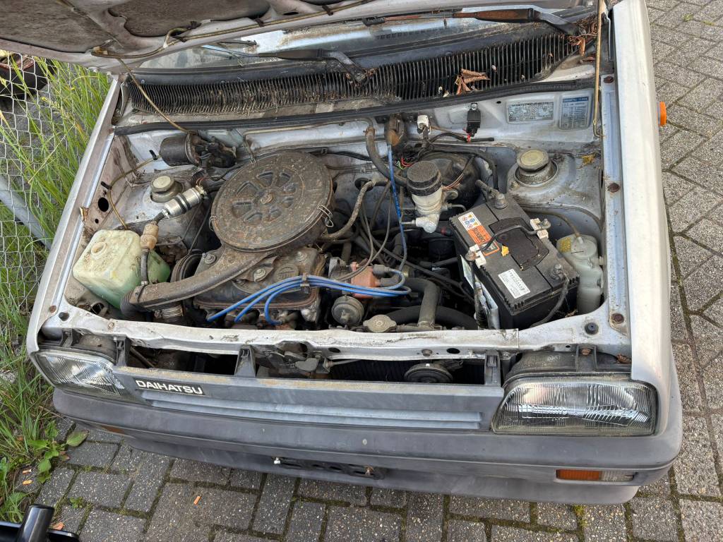

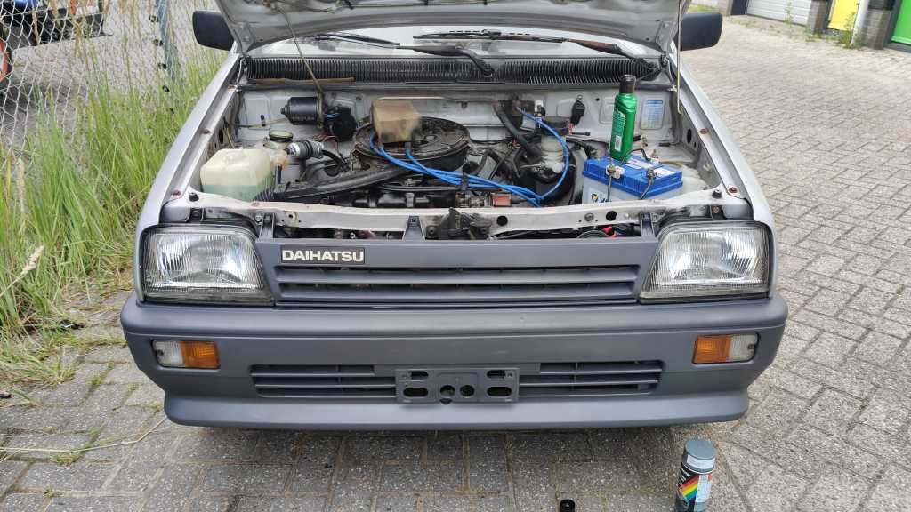

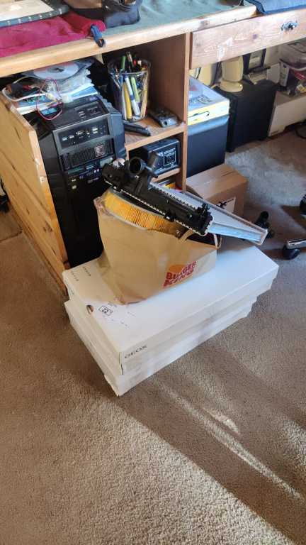

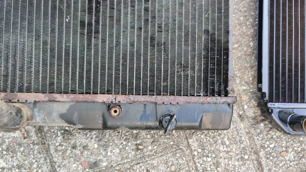

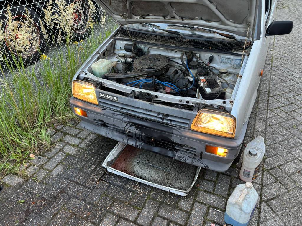

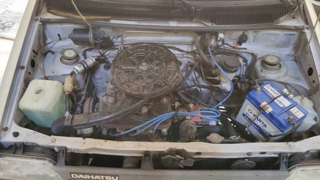

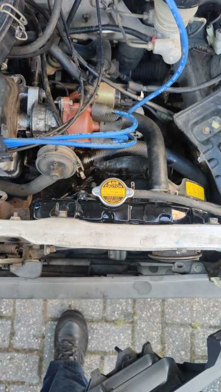

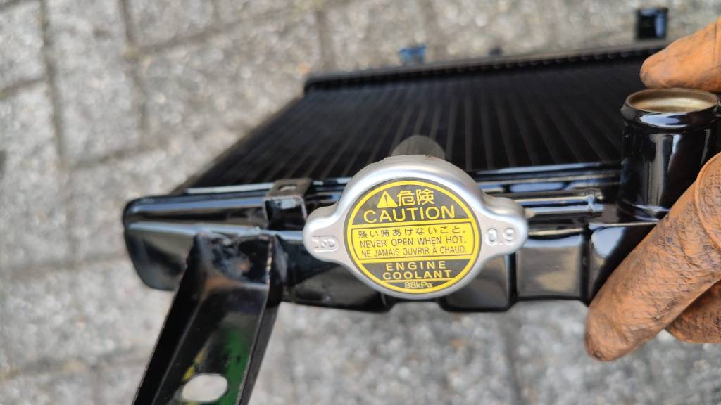

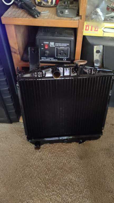

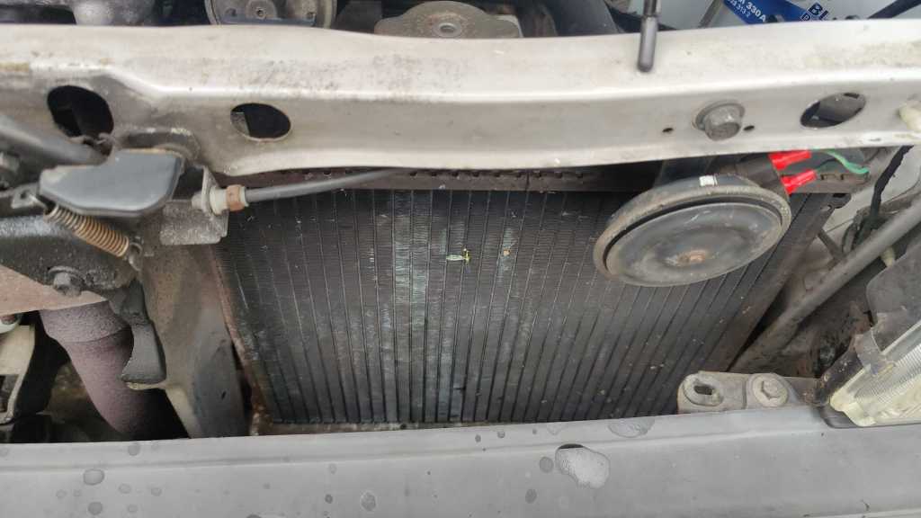

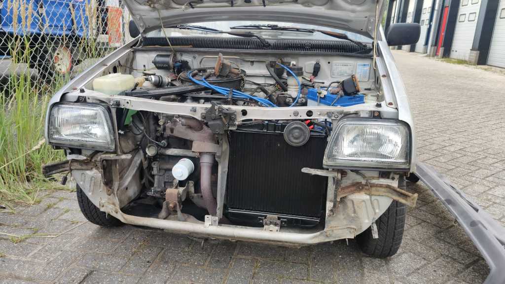

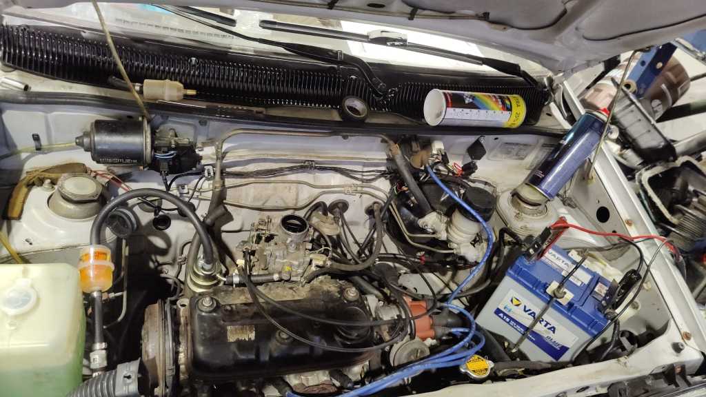

Replaced radiator with a Nos OEM unit DA002-87217

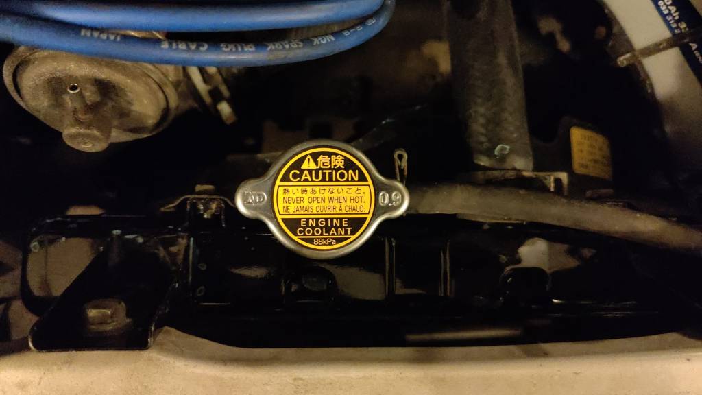

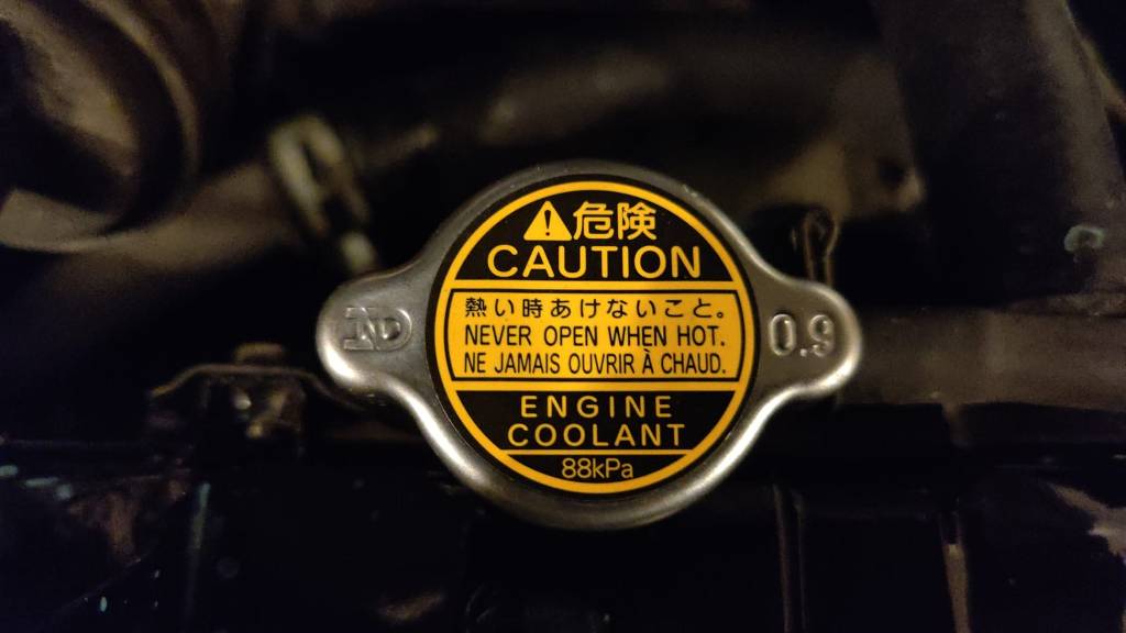

Replaced also radiator cap with new one from Toyota 16401-63010
New Coolant again with BS6580 blue one as for the copper core radiator protection

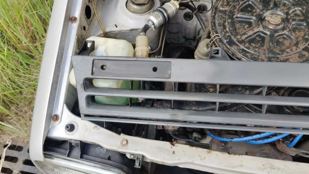

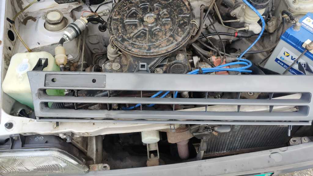

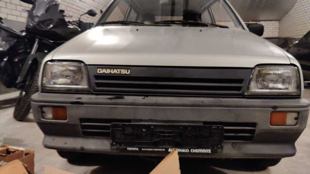

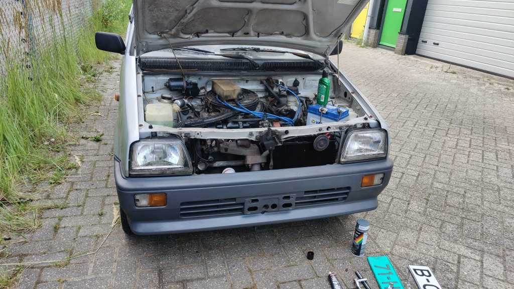

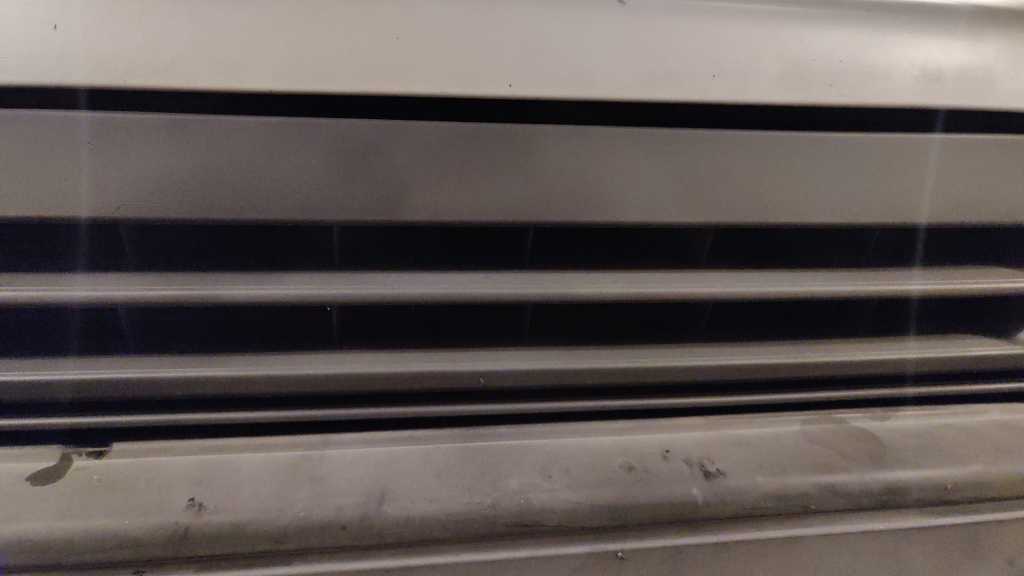

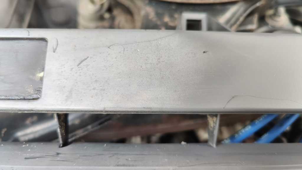

Painted grill to 04075 Motip grey colour

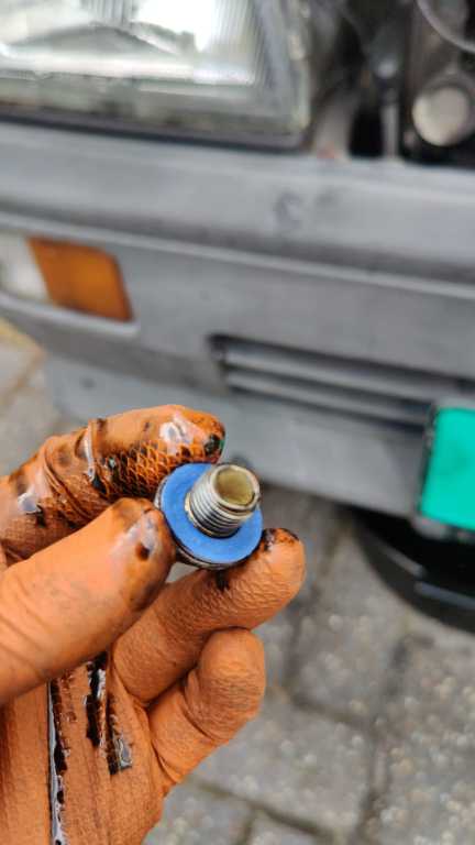

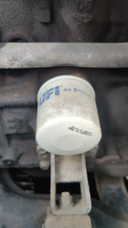

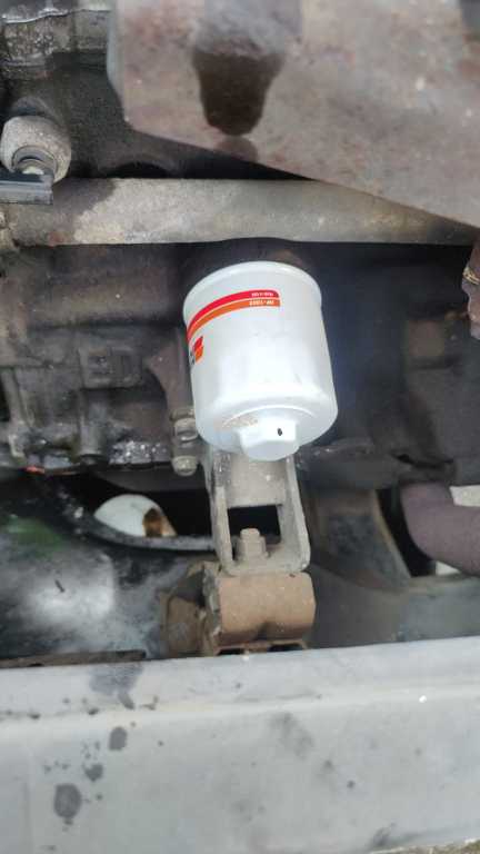

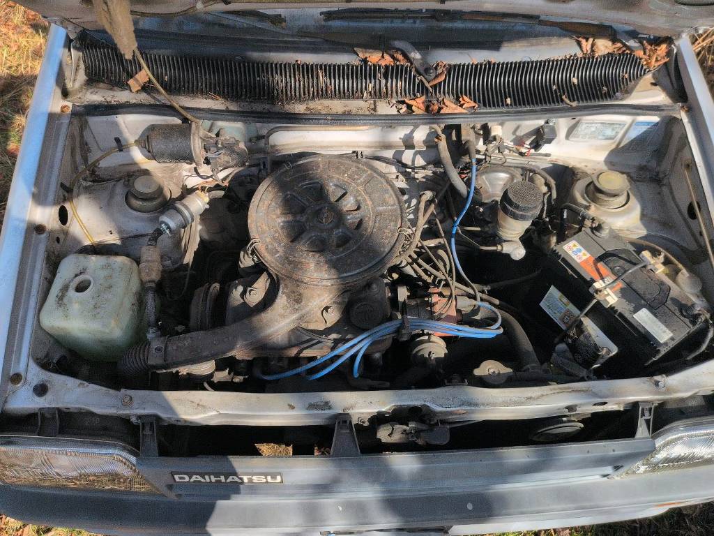

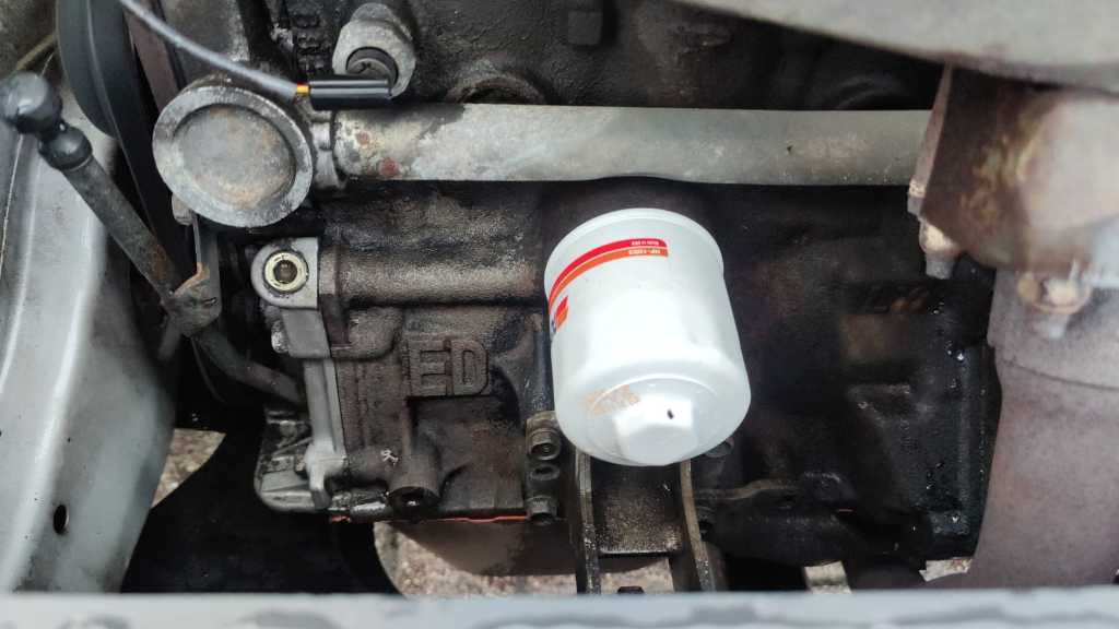

Changed oil and filter with Wolff 10w30 semi syn and K&N HP-1003

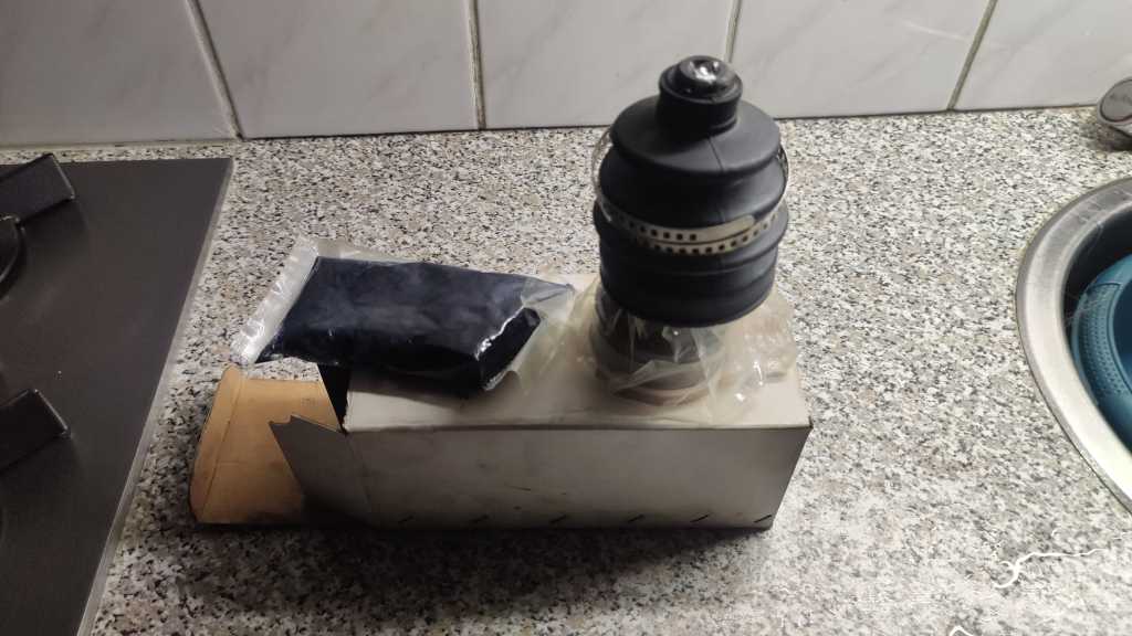

New oil drain plug ring 90430-12031

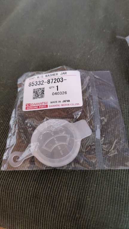

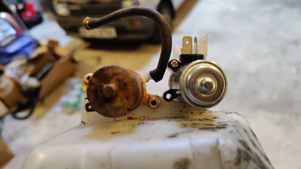

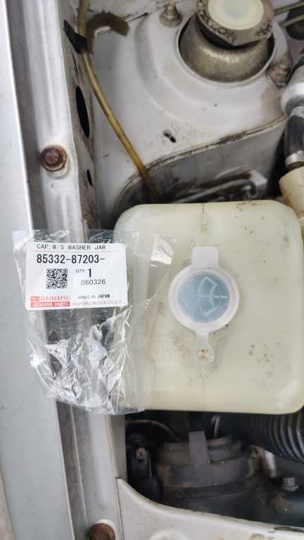

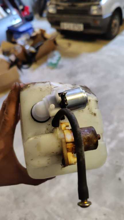

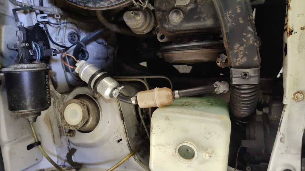

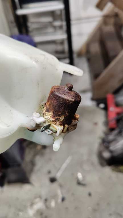

Installed washer cap 85332-87203

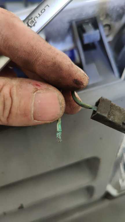

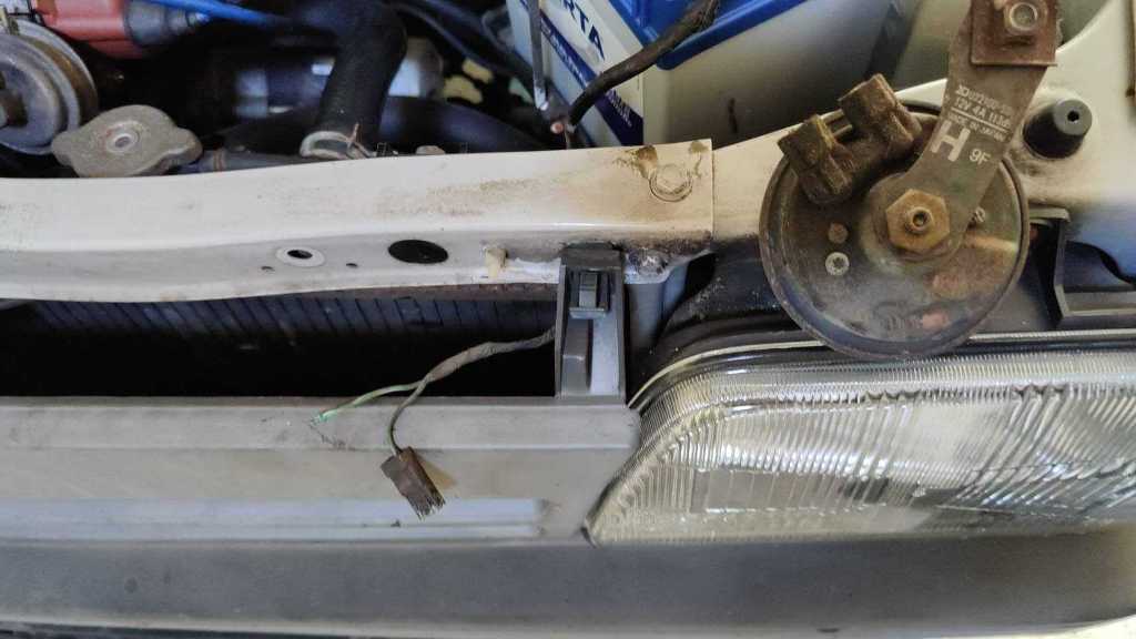

Repaired horn wiring (Elparts)

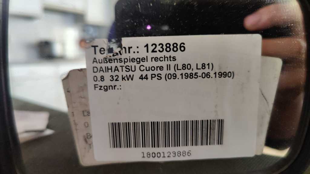

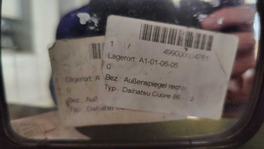

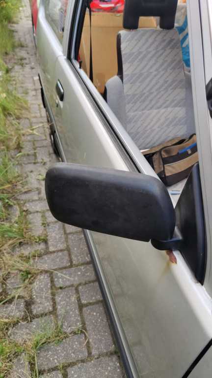

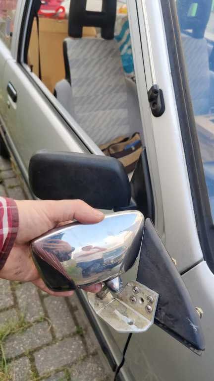

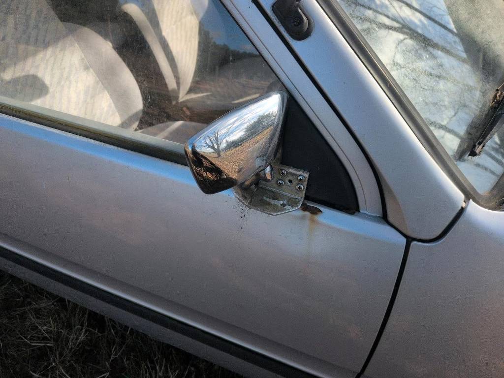

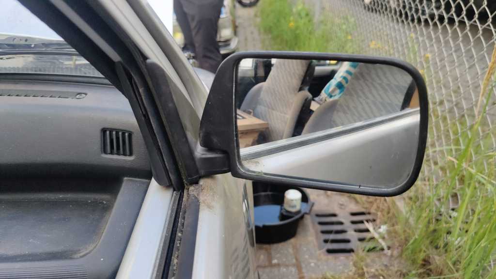

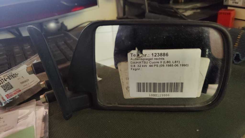

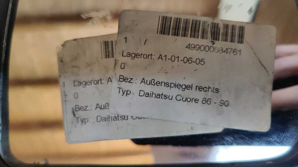

Replaced the ugly right mirror with a OEM used L80 mirror

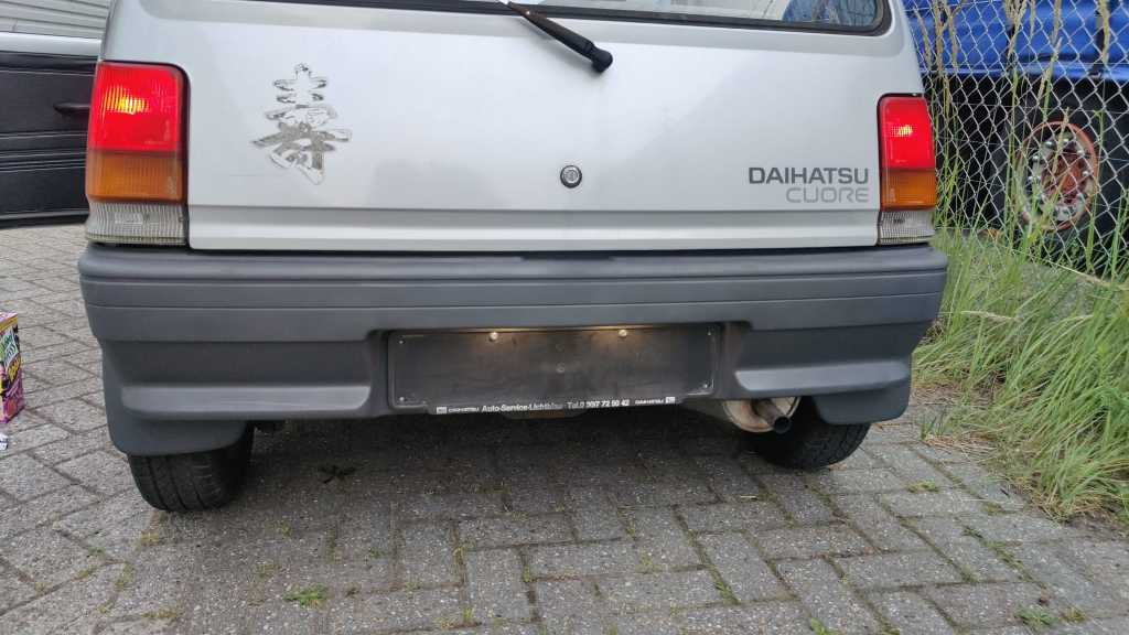

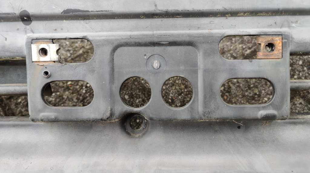

Installed Nos Philips 4000k warm white LED in licence plate light

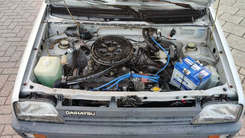

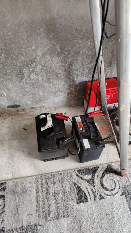

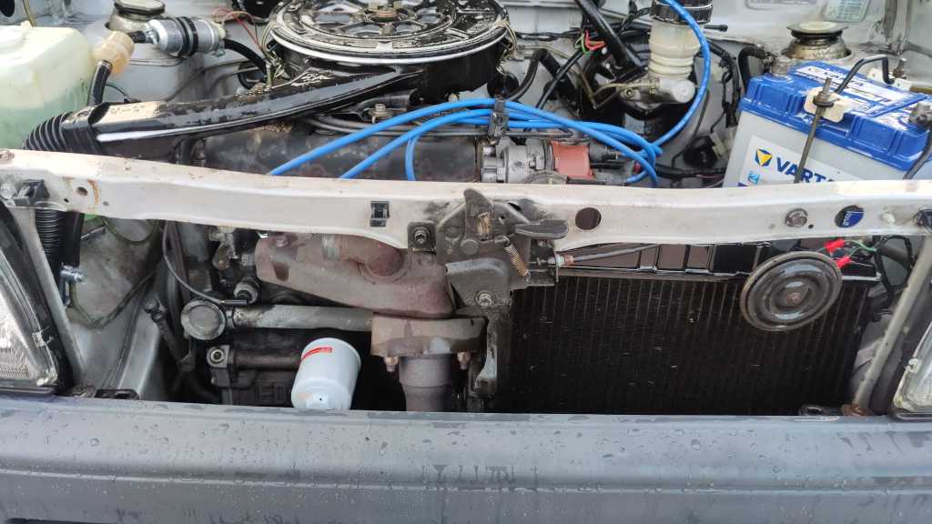

Installed Varta A15 Battery as the other one is empty on recharge

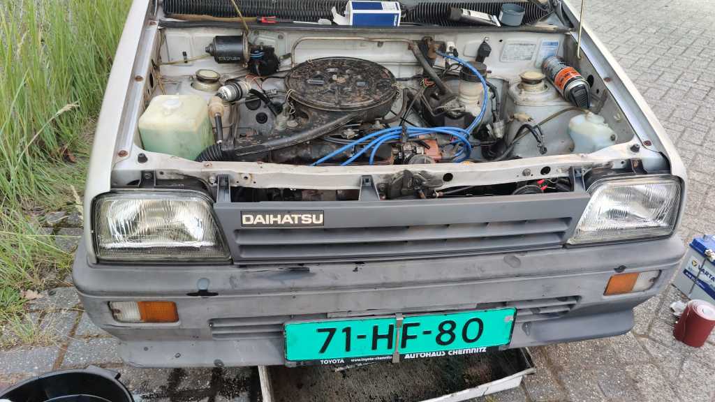

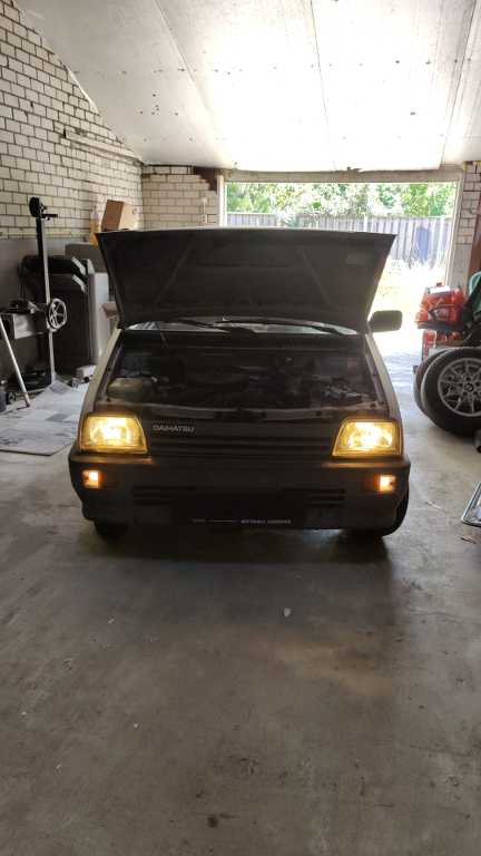

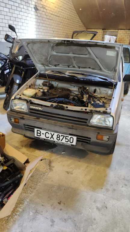

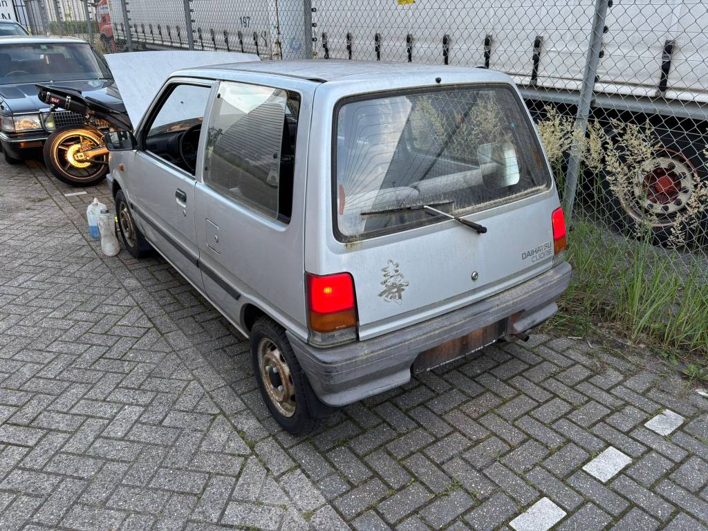

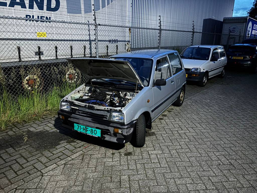

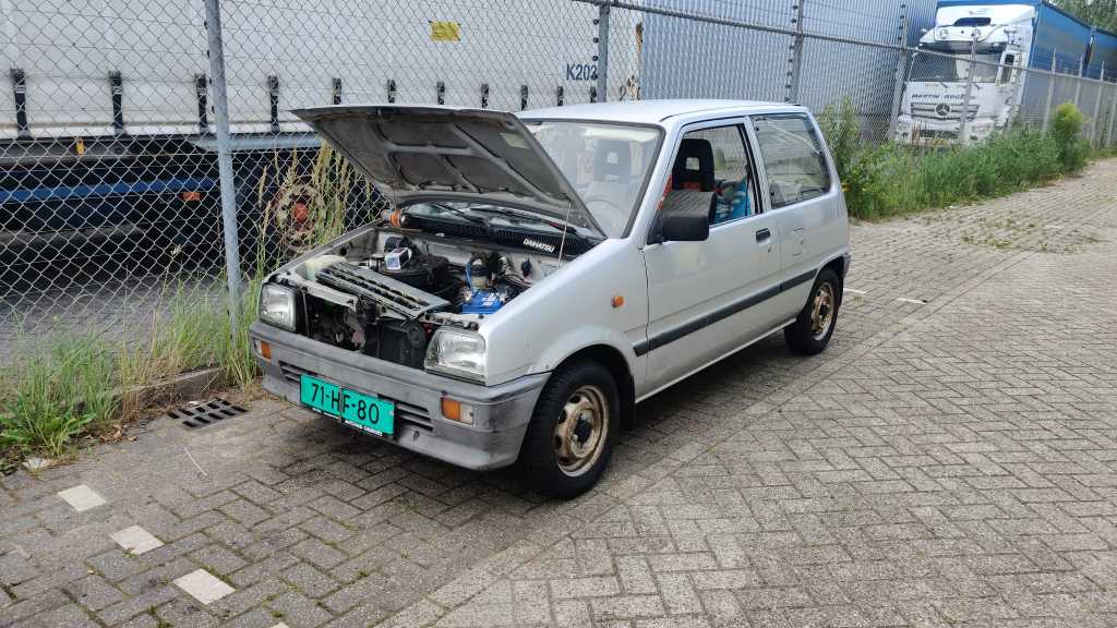

So I went to JCS today for 2h and was in the afternoon spotted some cars and went to fix my L80 again.

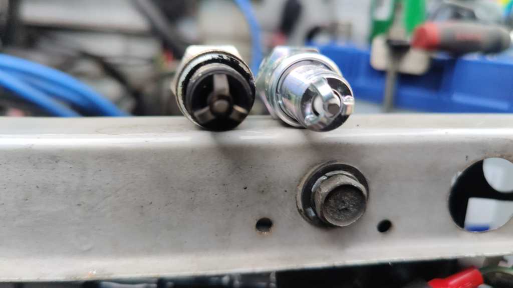

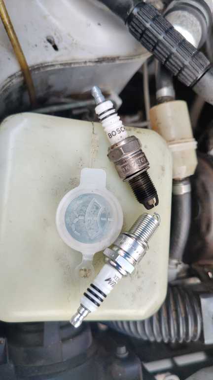

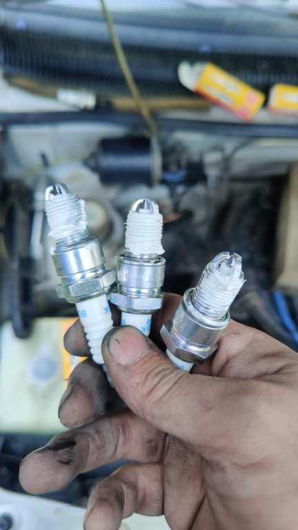

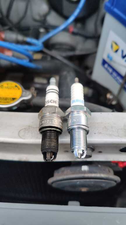

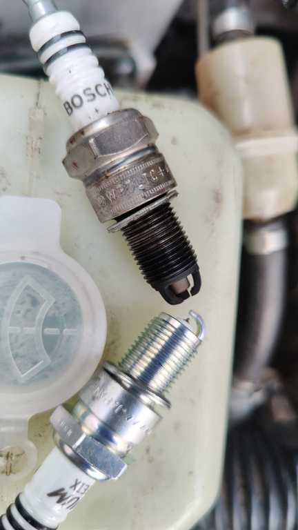

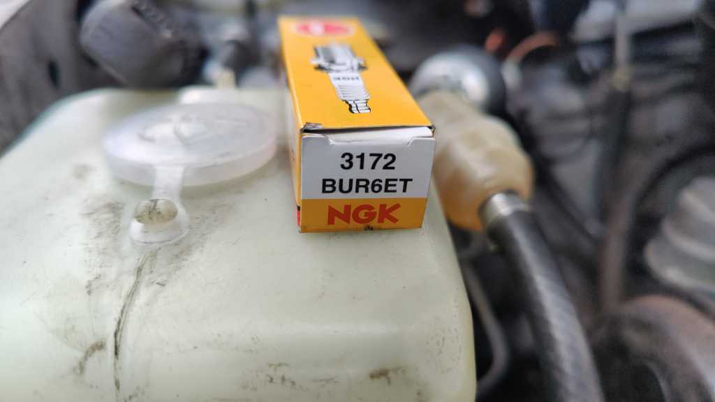

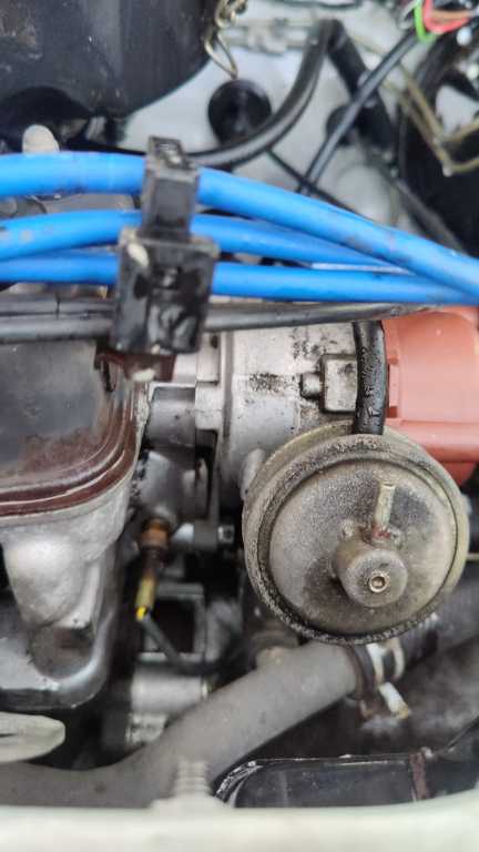

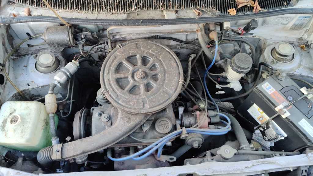

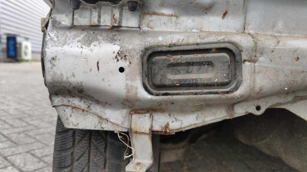

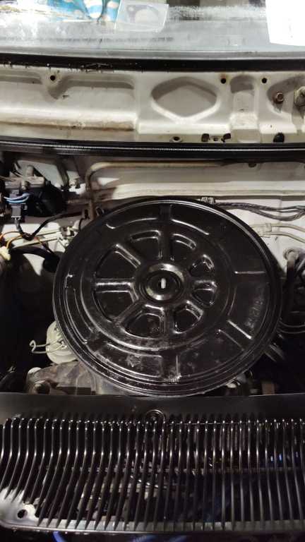

Done cosmetic stuff today and only changed spark plugs today
Also washed engine as clean as possible

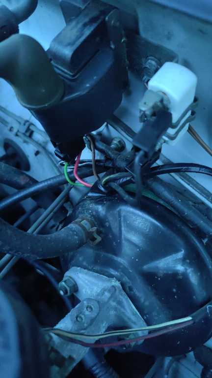

Had loads of pops and bangs after installing the correct spark plugs

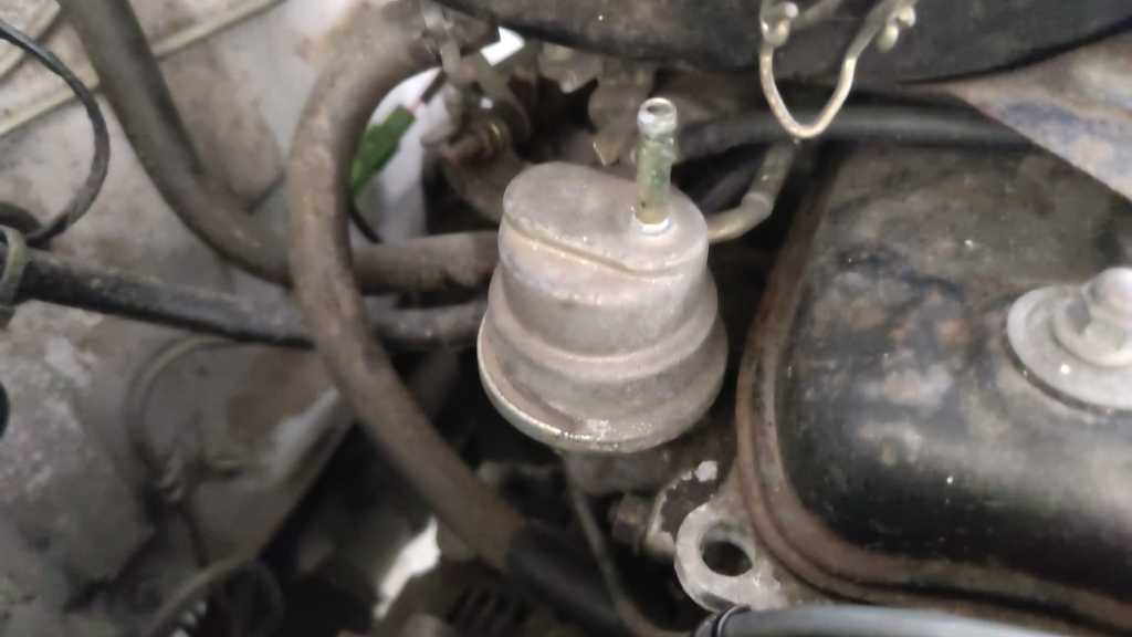

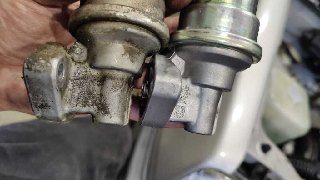

Need to get rid of the electronic pump as it wired on the ign coil

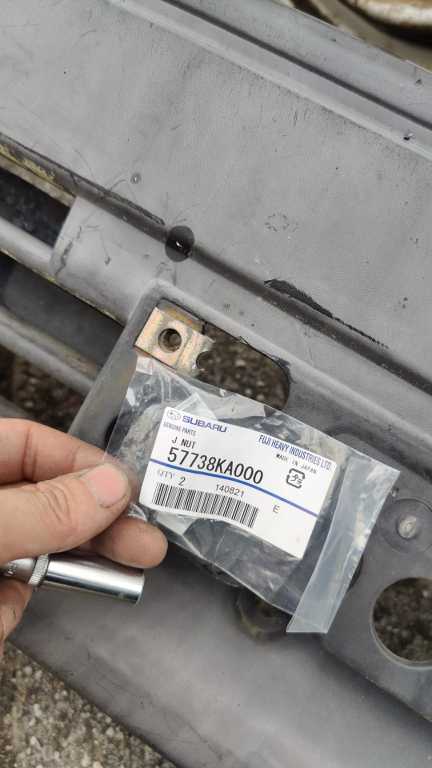

Fixed the licence plate J hook also

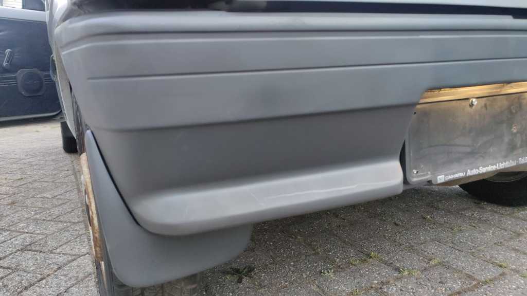

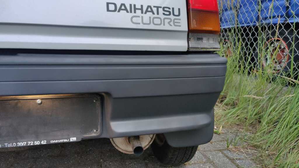

Painted front and rear bumper with motip grey 04075C
Polished rear lights and front indicator lenses
Did loose all fasteners to grease them
Pressure washed engine block from the old grime
