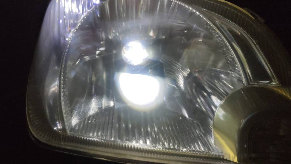

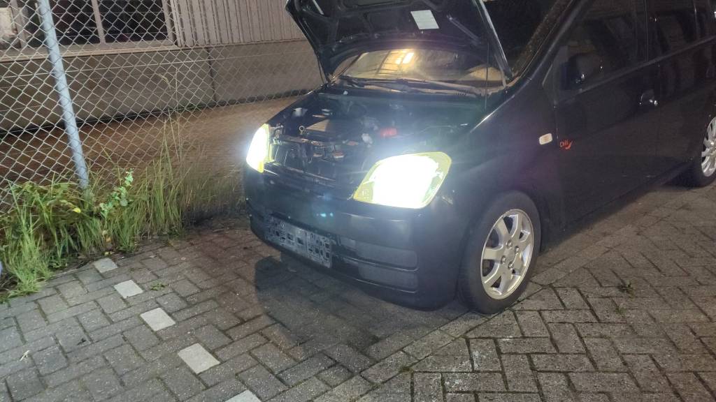

So I have my LED projectors in

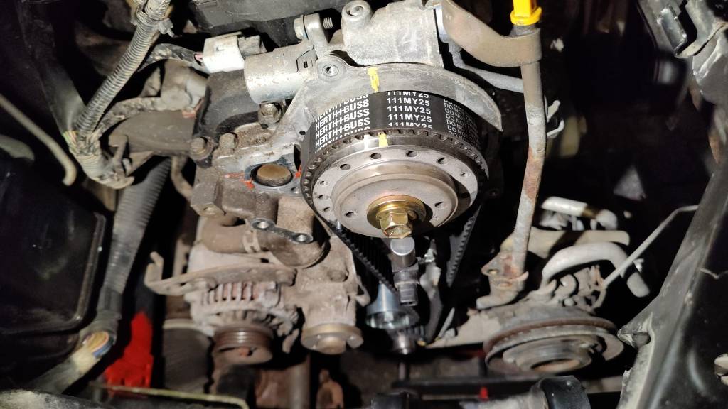

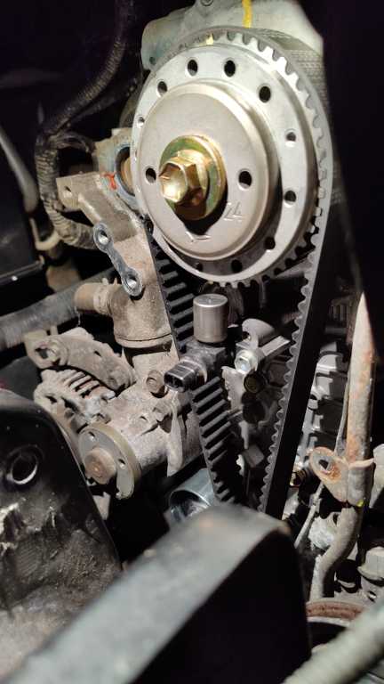

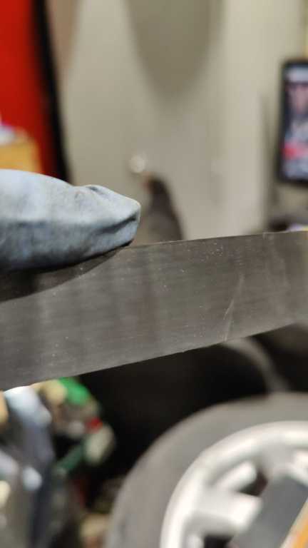

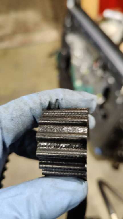

I also timing belt and serp belts .
They are the original ones from 2007
After that I did Led projectors into the headlights

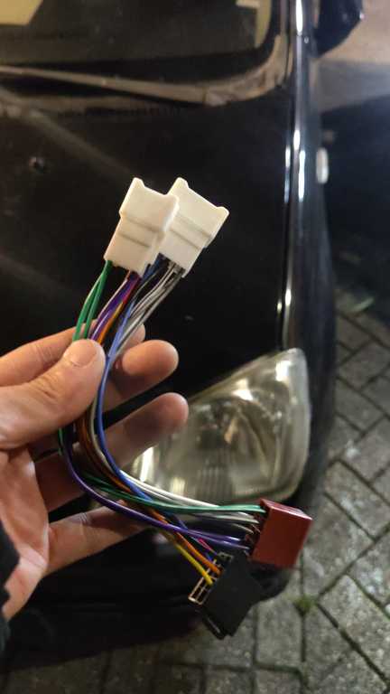

Radio adapter loom also came in

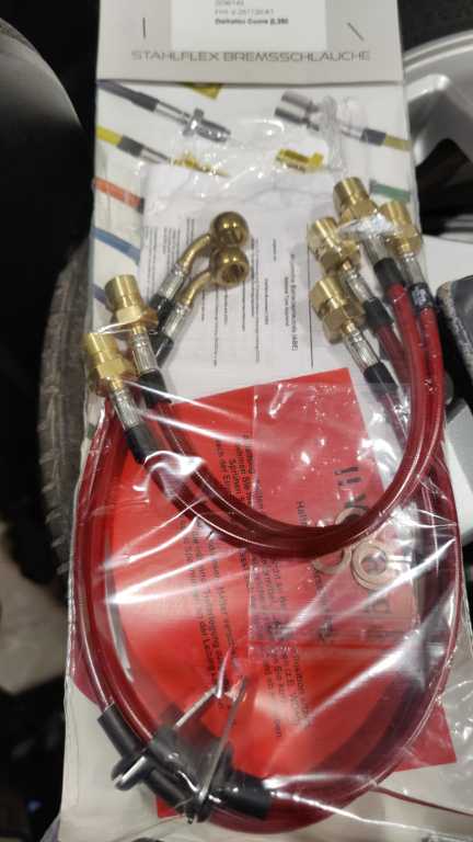

I got my brake hoses in from Germany(not sponsored in any way)
I used them before they deliver exact fitment.
I have adjusted my headlights to correct height (1.0-1.2%)
Pictures of timing belt (2006 Dec)

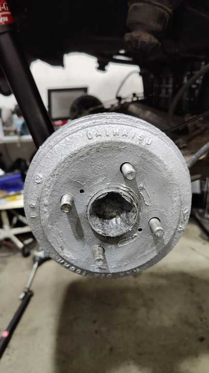

Painted rear drums

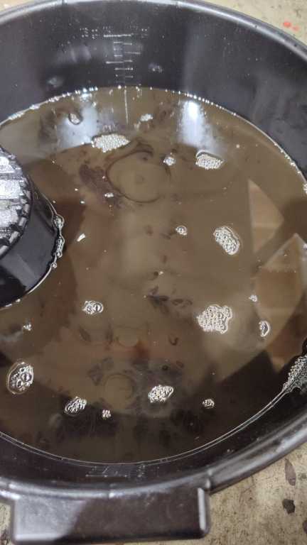

Changed gearbox oil and new gaskets

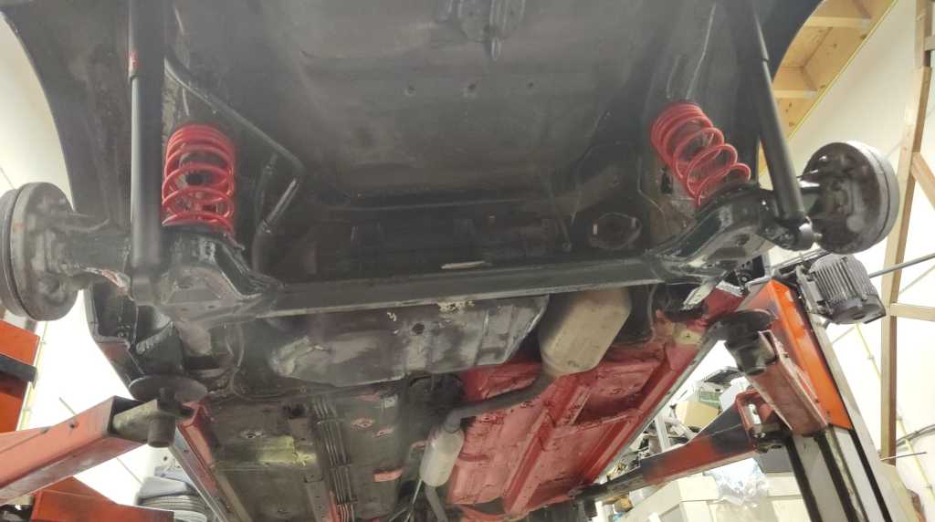

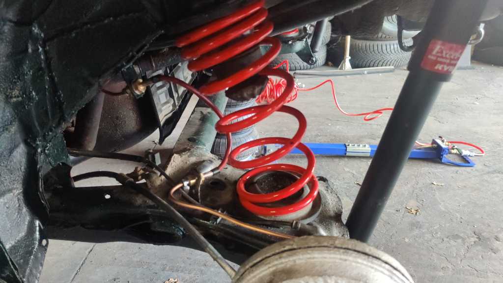

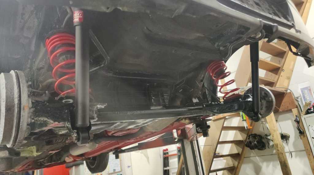

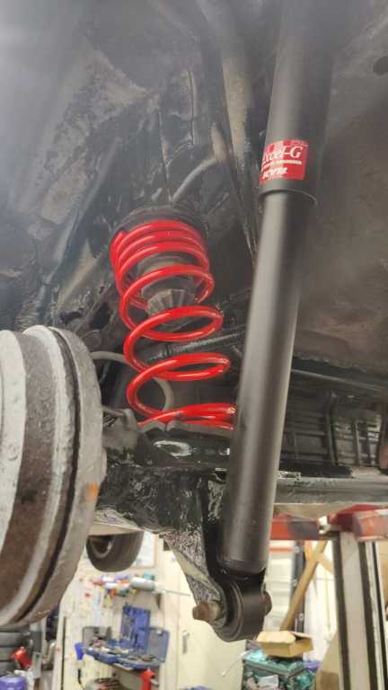

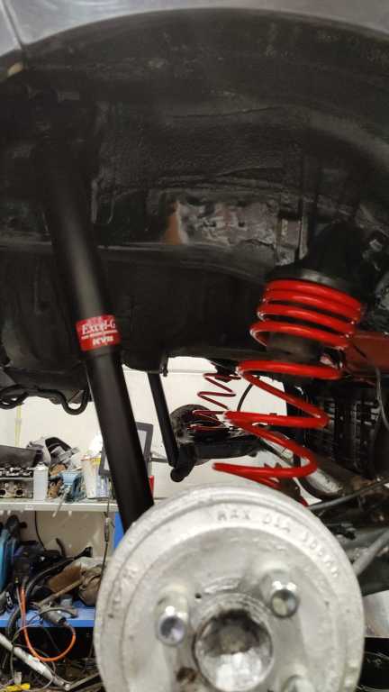

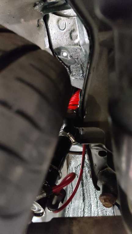

Changed rear shocks (M401)
Changed rear lowering springs (L701)

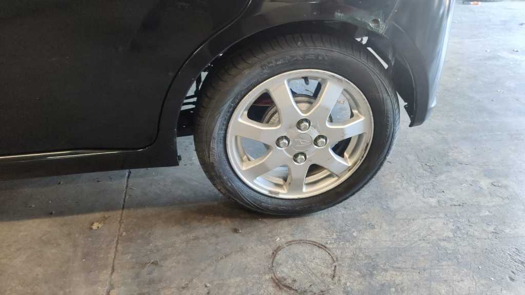

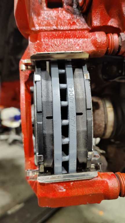

Changed front brake hoses in

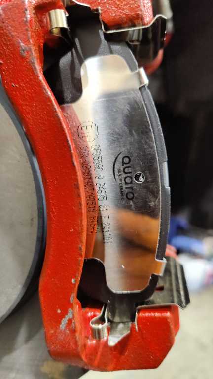

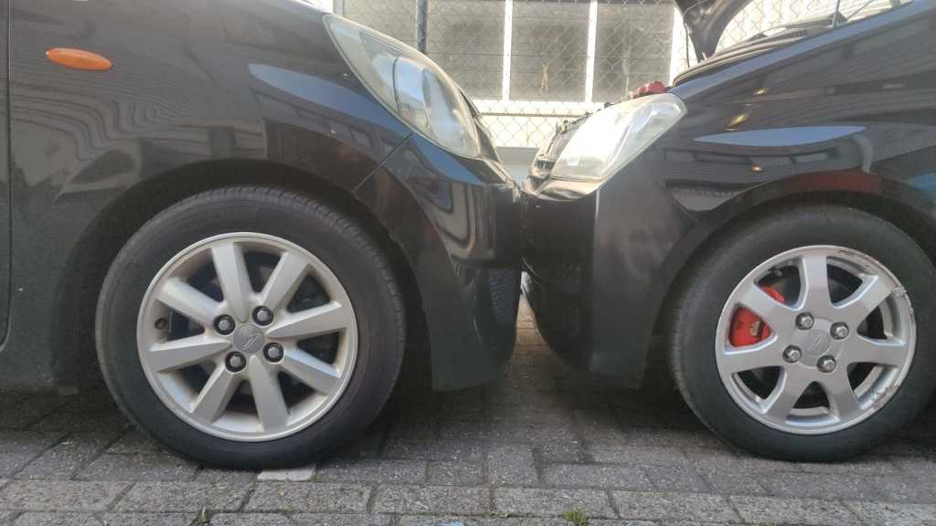

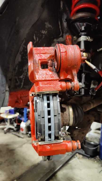

Changed front brakes to Materia brakes (254mm)
Will bleed system when rear brake lines,hoses and master cylinder has been changed

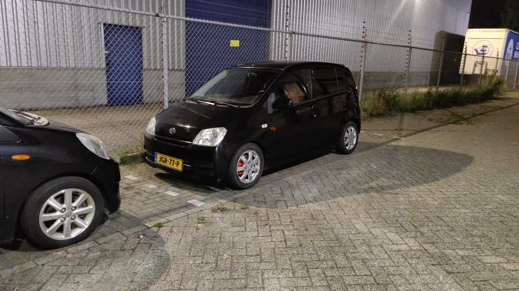

Just received email from RDW.
They approved the registration.
Due long not been registered they need to check with the German amt if it is not stolen…
paid import tax a 0,00 euro

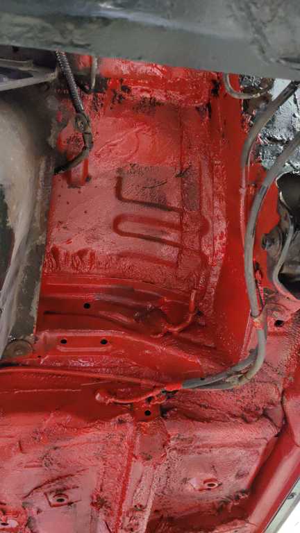

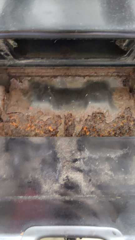

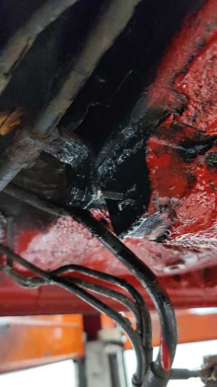

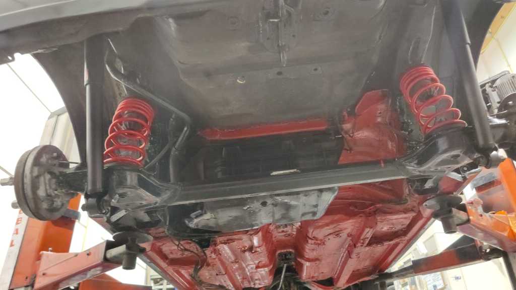

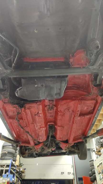

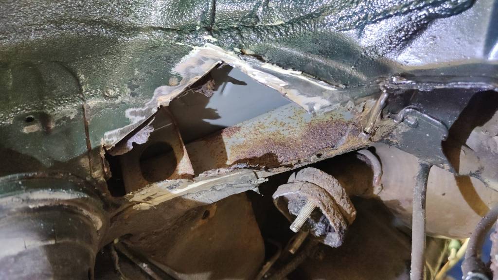

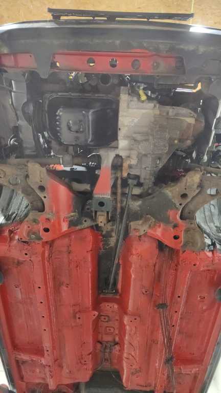

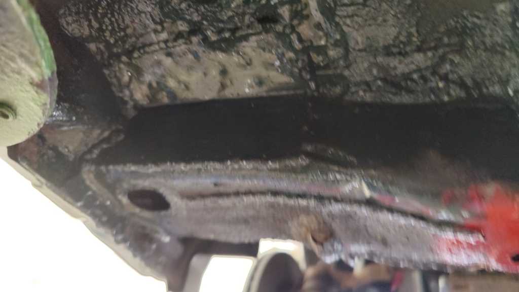

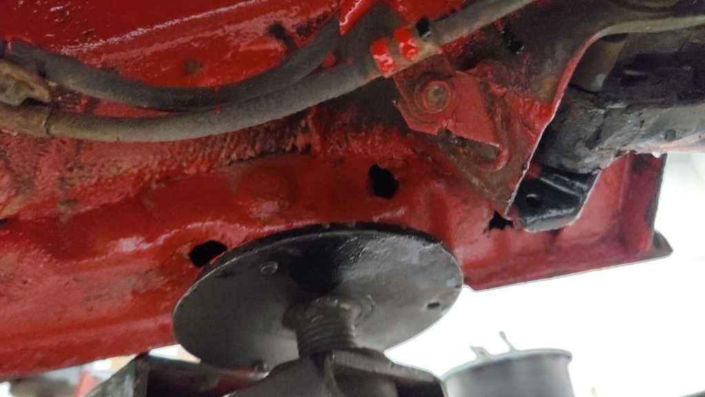

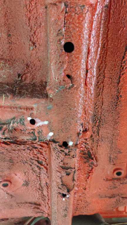

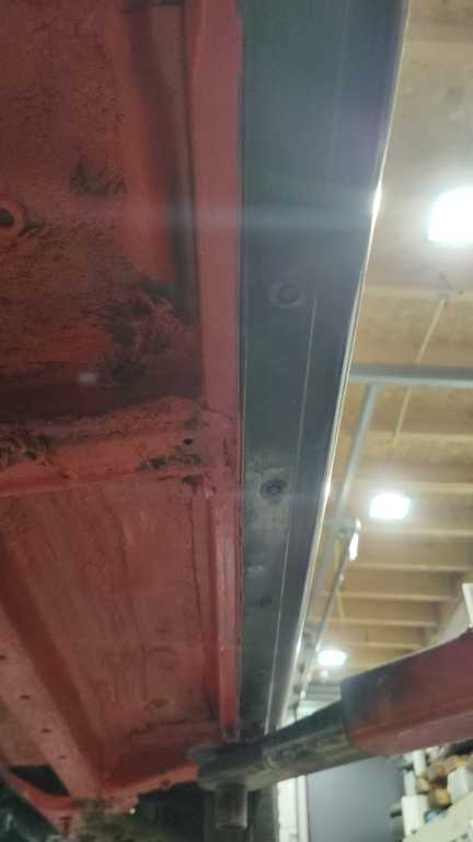

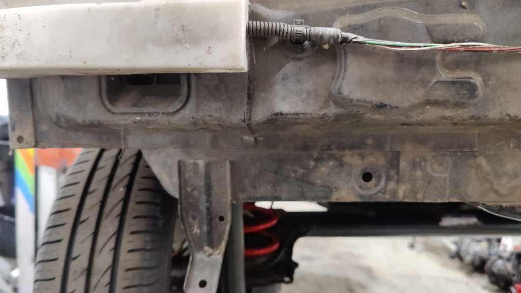

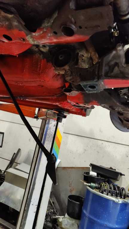

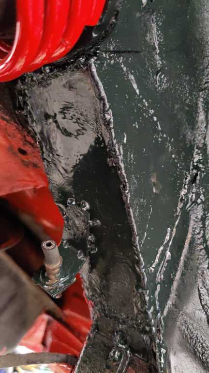

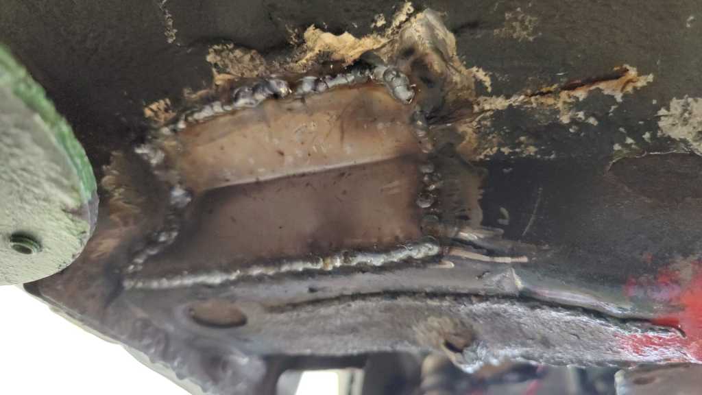

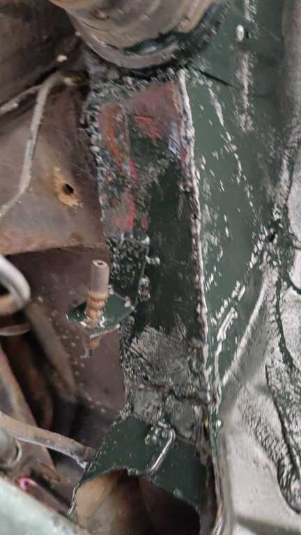

Removed and repaired the rust

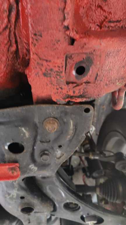

Painted the whole undercarriage red

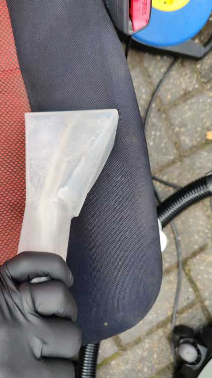

Deep cleaned/rejuventad the interior

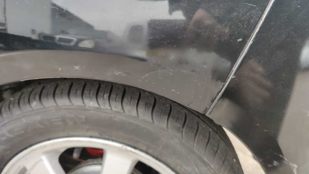

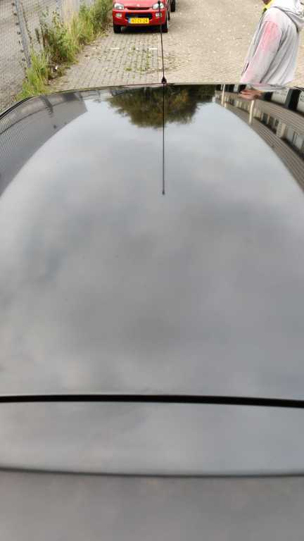

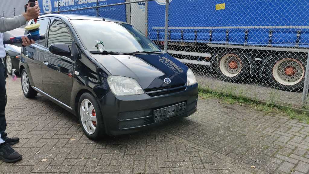

Polished the whole car removing the haze on the roof

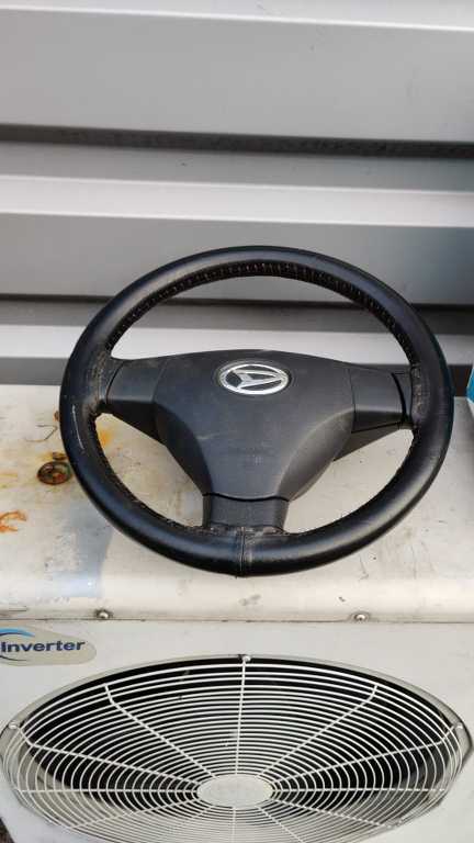

maybe installed L276 steering wheel

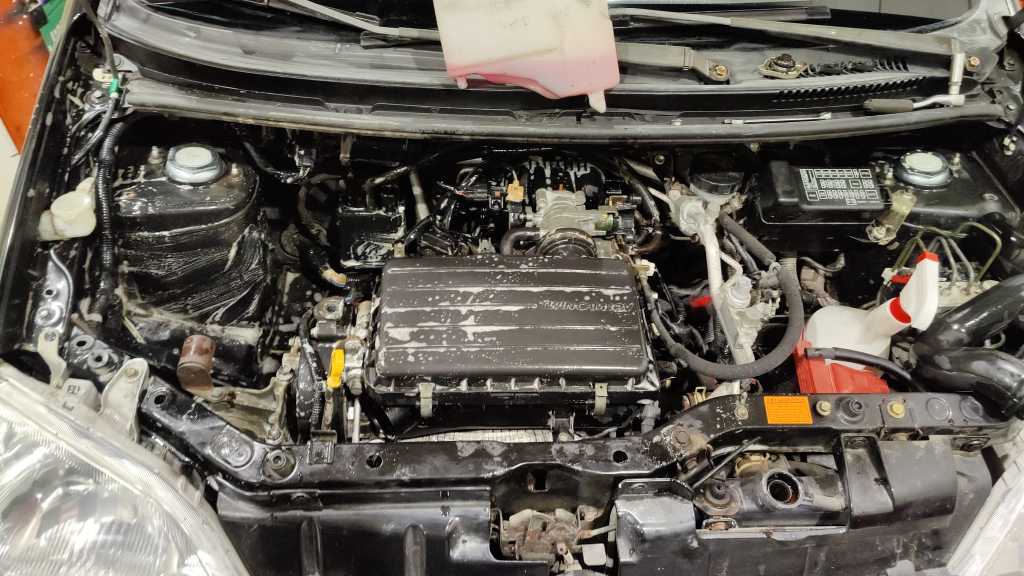

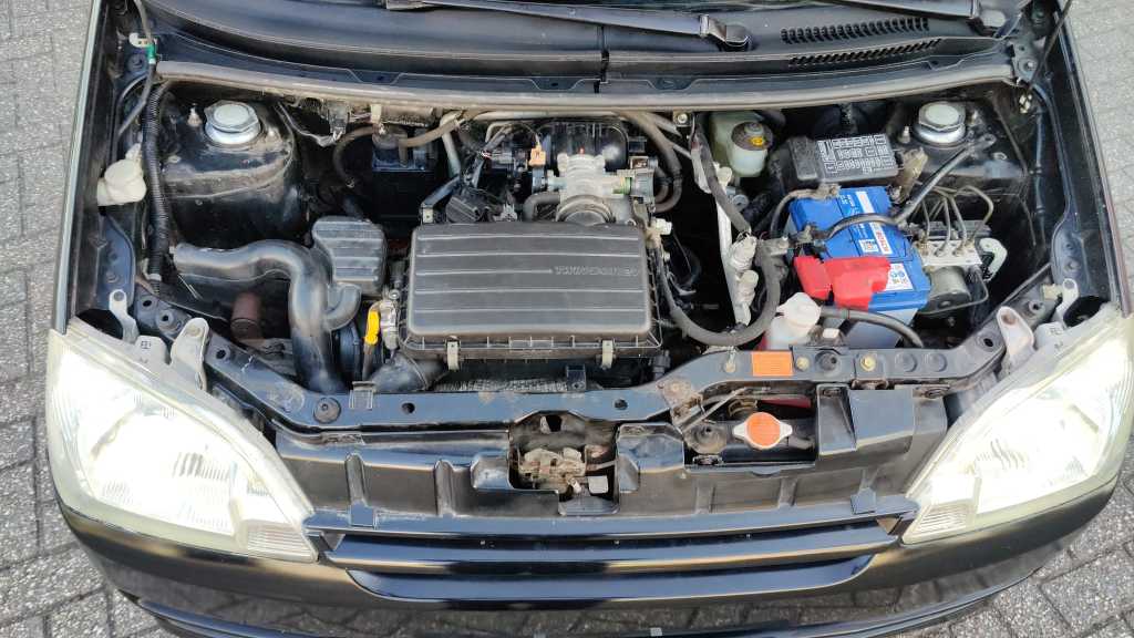

Detailed engine bay
Installed Terios BMC 22.66mm

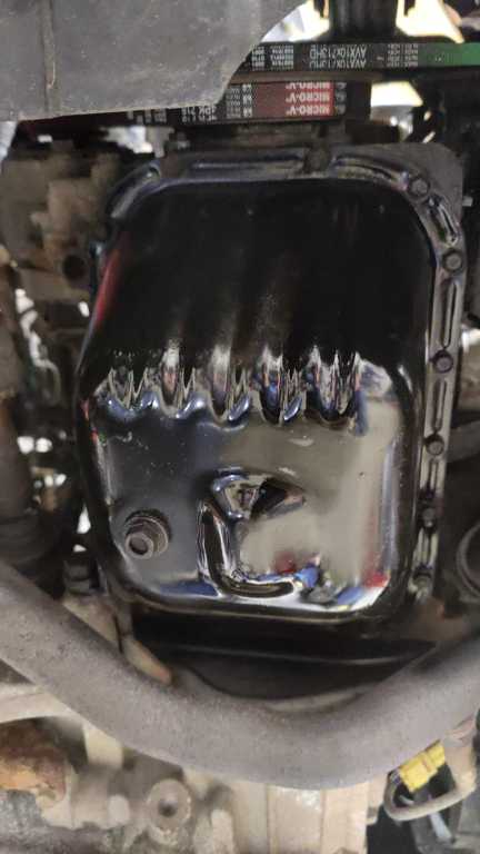

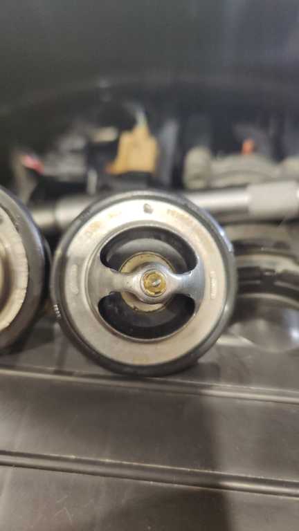

Replaced thermostat and coolant (G12, JASO M325)

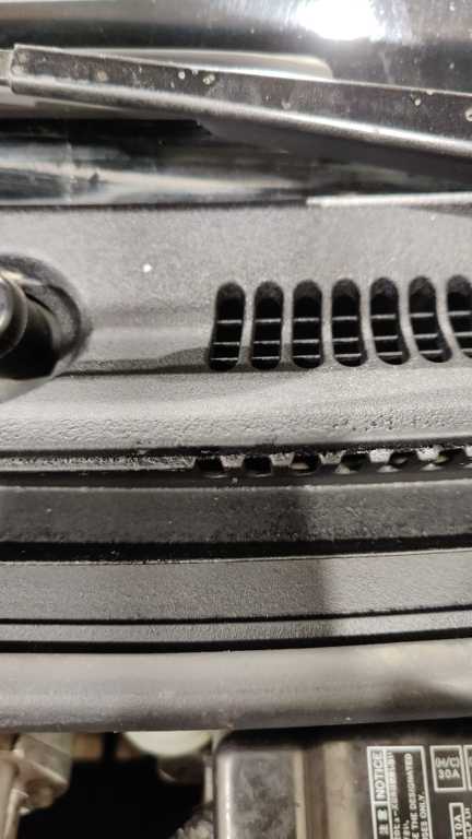

Cleaned up paravane under the wipers
Painted wipers and paravane trim

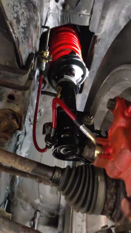

Cleaned paravene

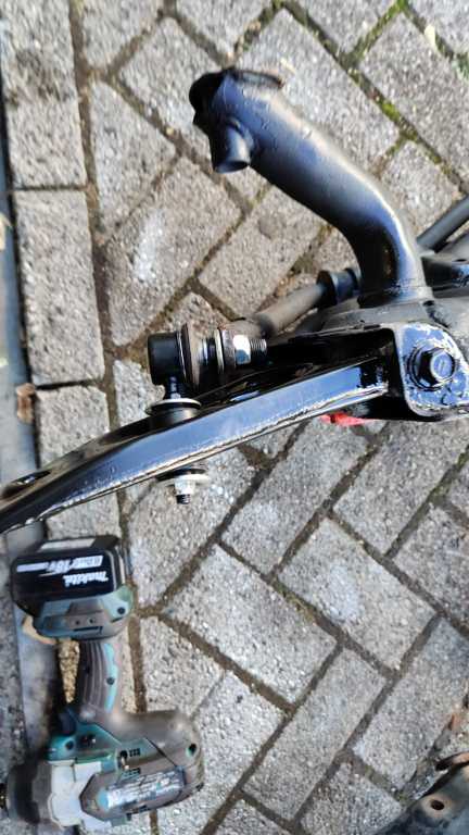

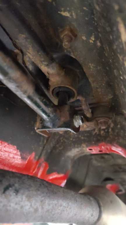

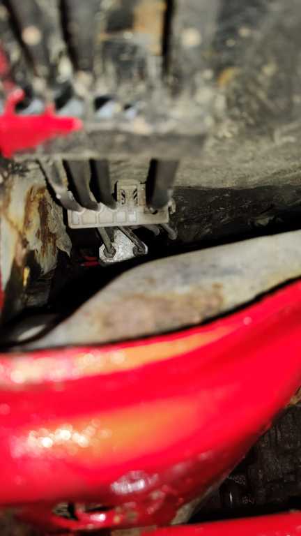

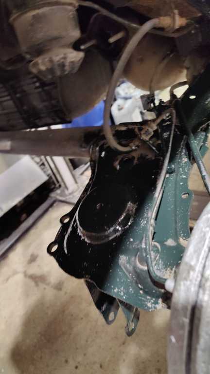

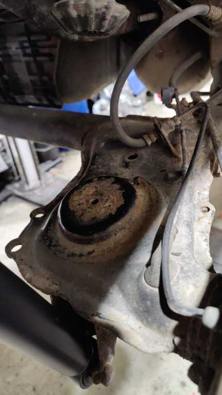

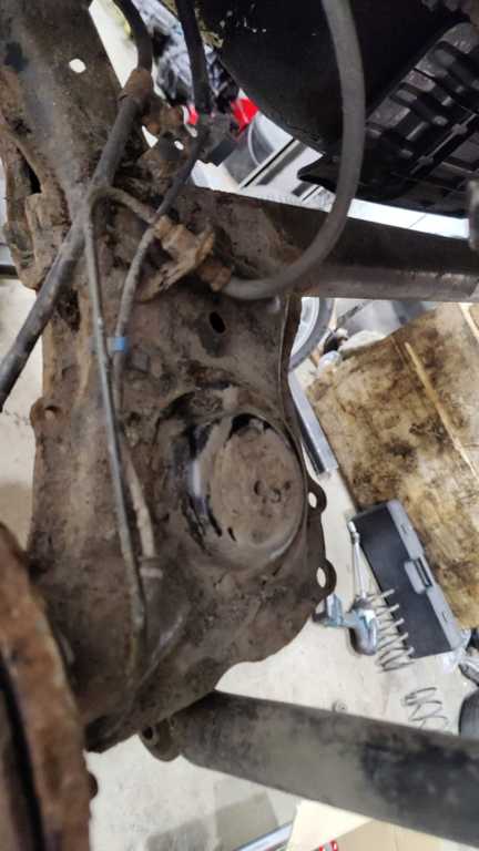

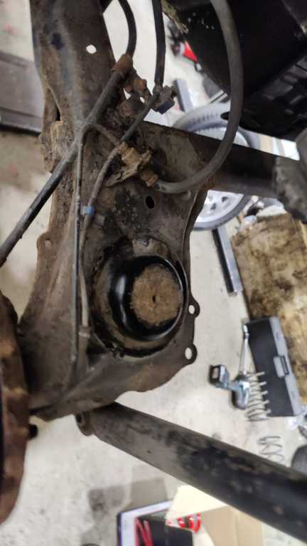

Replaced subframe (better one), added sway bar, links and new wishbones

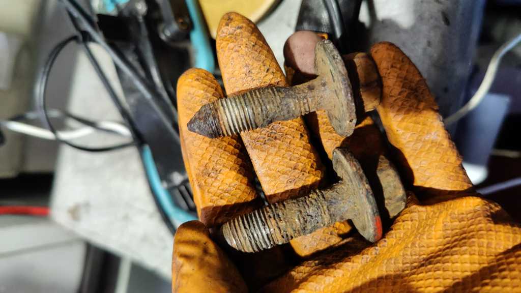

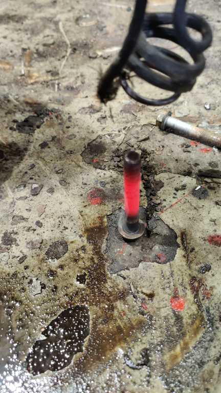

Bolts are very hard to remove esp. rear wishbones ones.

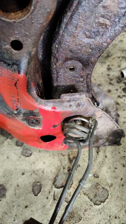

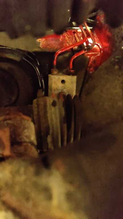

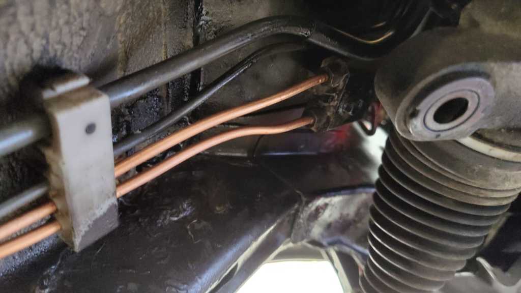

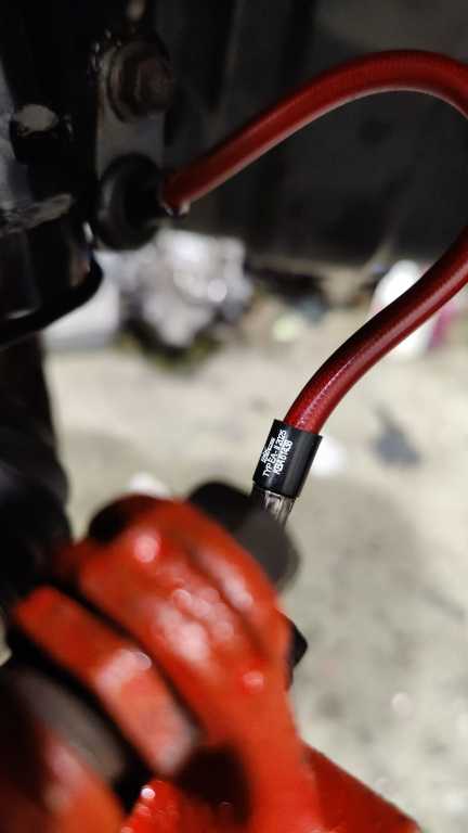

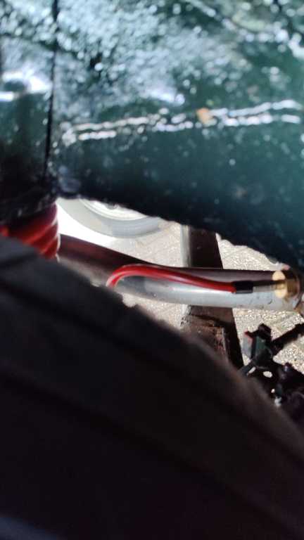

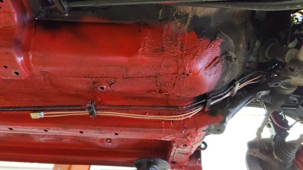

Installed new rear brake lines all new.
Installed brake hoses rear braided
Bleeded brake system
Made a between connection piece
Next time no need to remove subframe

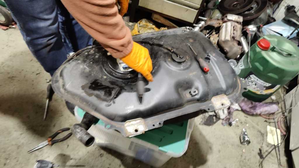

Emptied fuel tank for L701 fuel tank swap

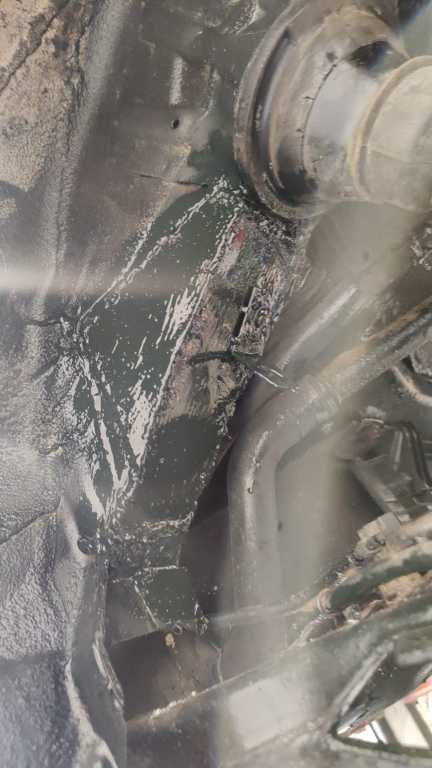

painted Hammerrite behind the subframe

Broken in brake pads and discs

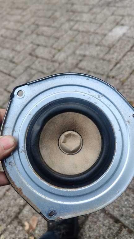

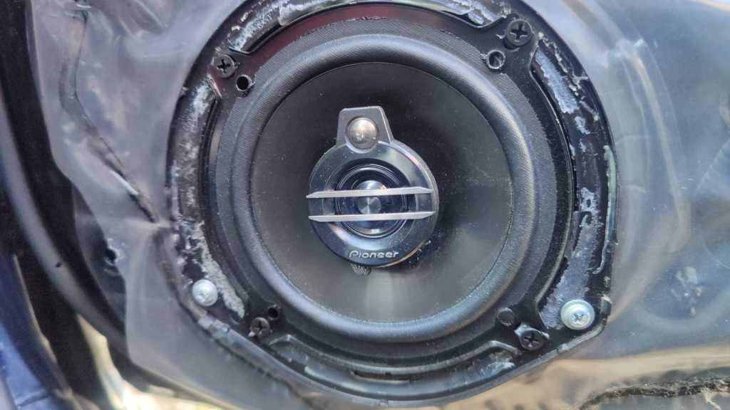

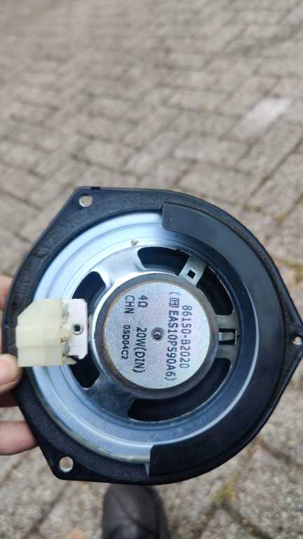

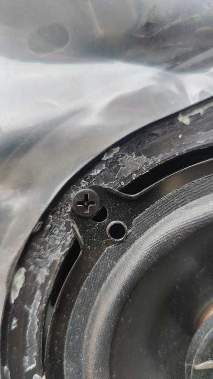

Speakers

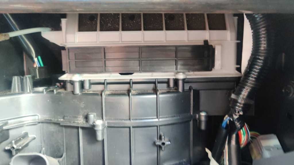

Cabin filter

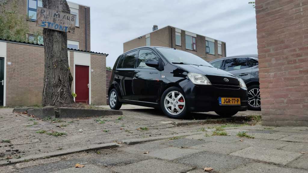

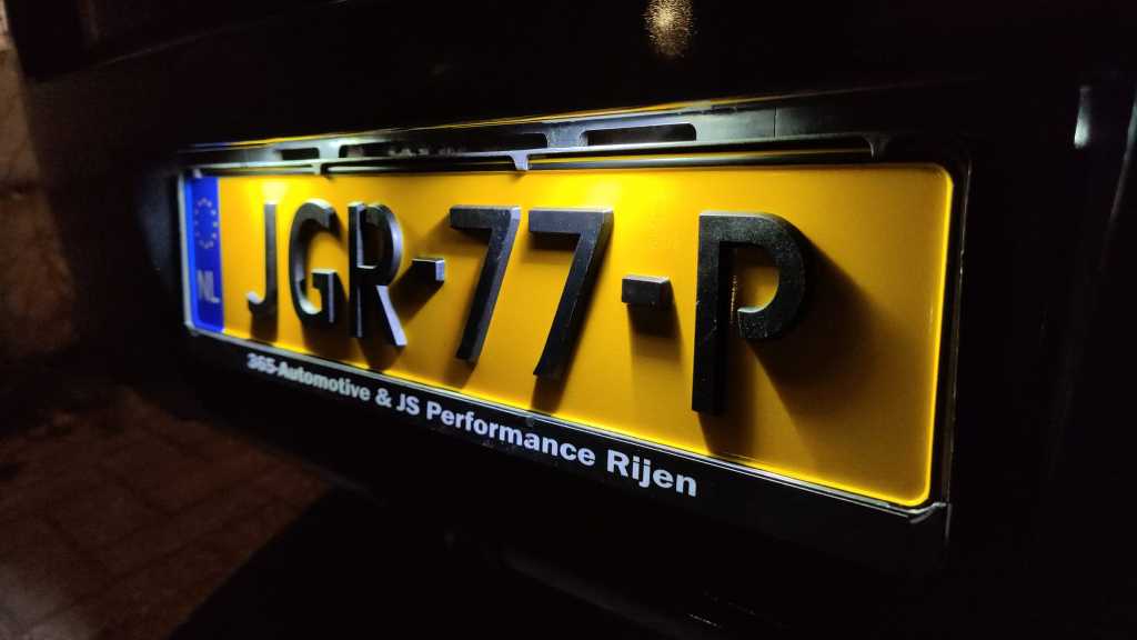

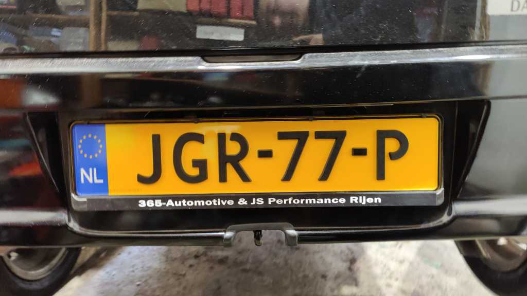

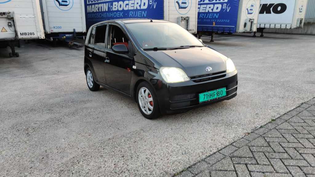

Got my licence plates

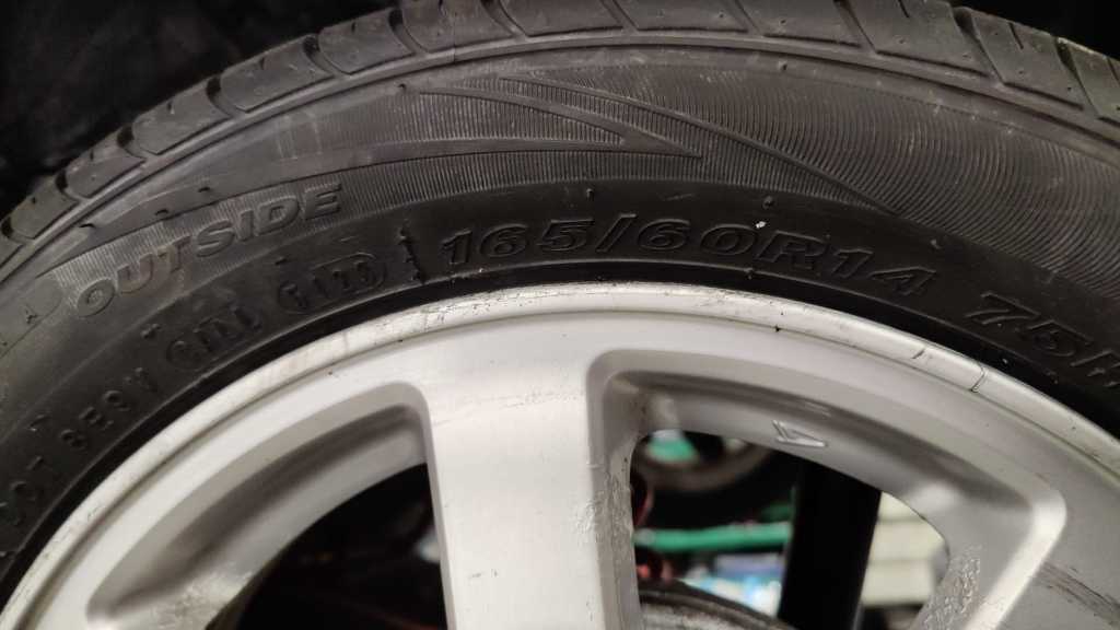

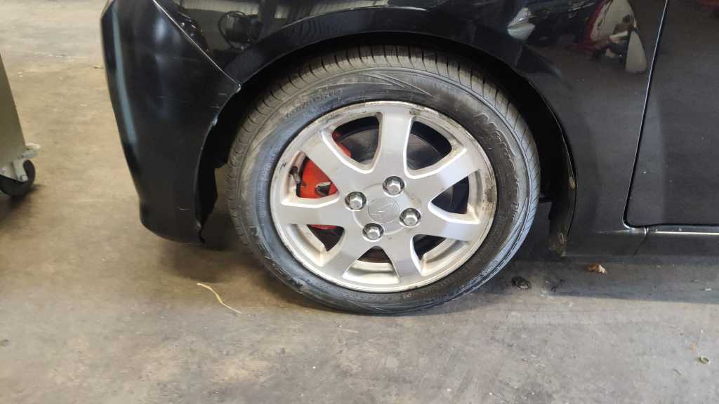

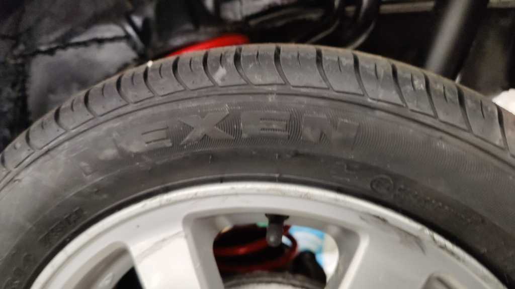

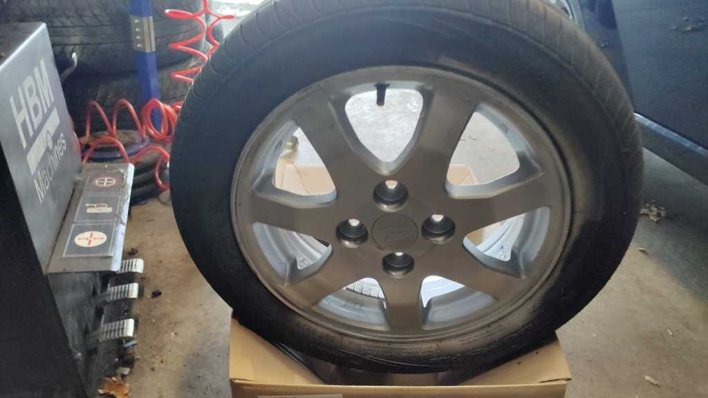

Installed new tyres

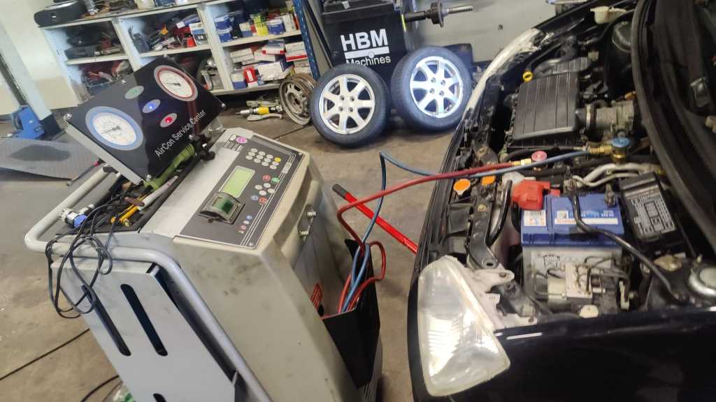

Filled the A/C

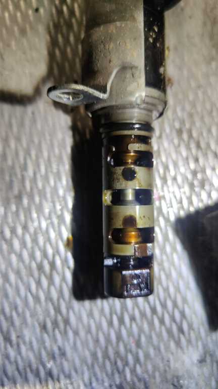

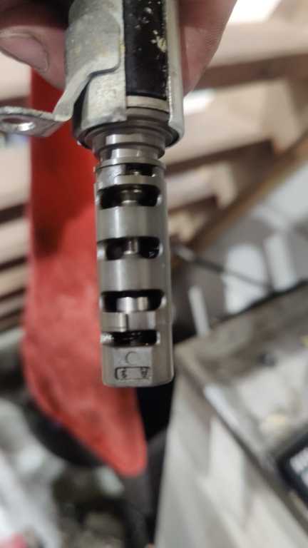

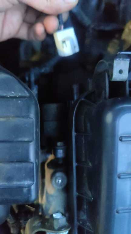

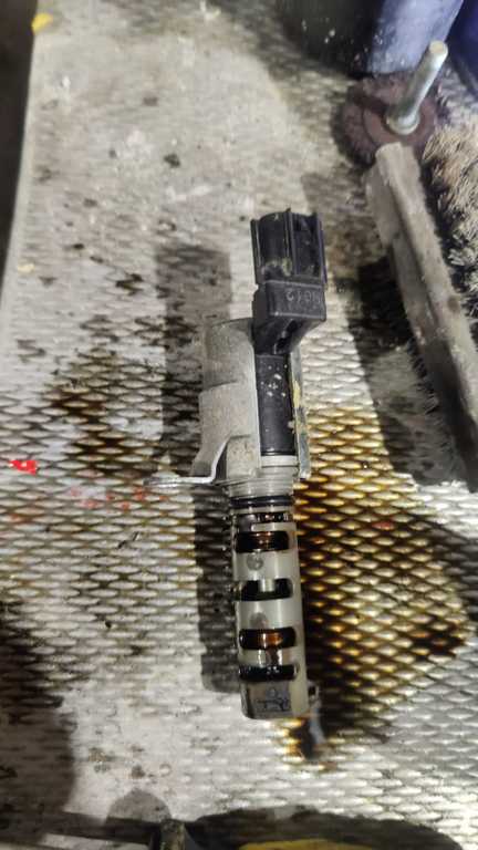

On the road back a P1349 code
DVVT solenoid disconnected and went to work
Cleaned DVVT solonoid as it was clogged

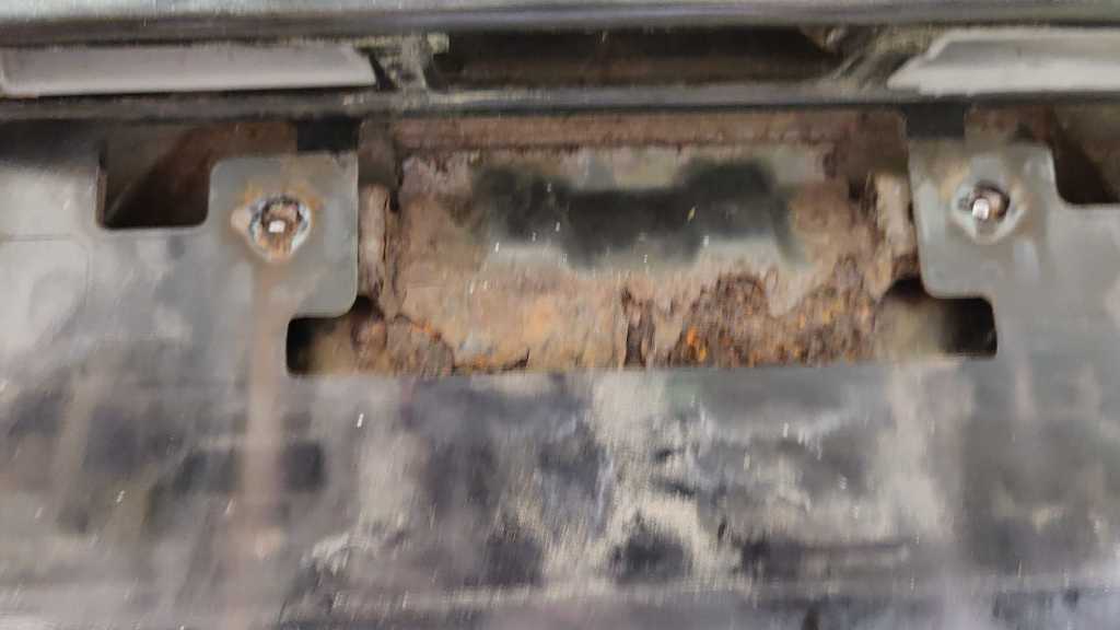

Resanded rear bulkhead
Repaint rear with Hammerrite with black
Redone rear bolt for licence plate and replaced the rear square m6s
Painted front paravane trim with crinkled paint

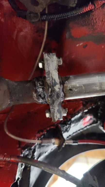

Repaired the mid pipe flange to rear pipe

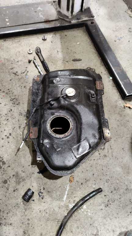

Cleaned tank outside painted it
Replaced the tankvent valve
Cleaned tank filler steel connection with sandpaper and cleaned hose also from rust

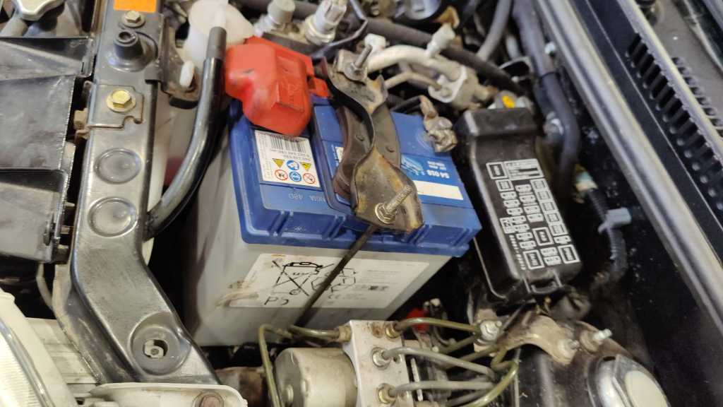

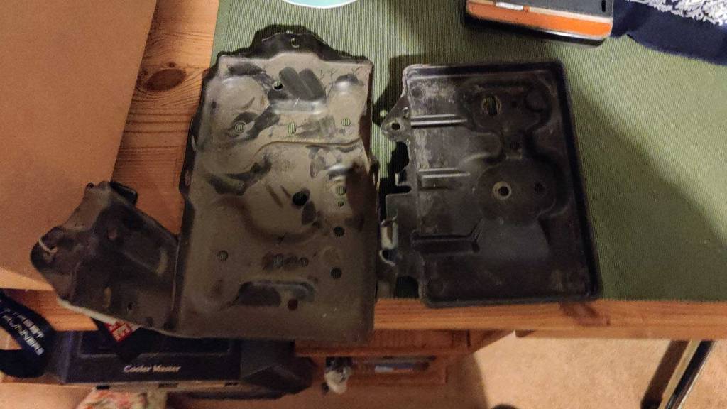

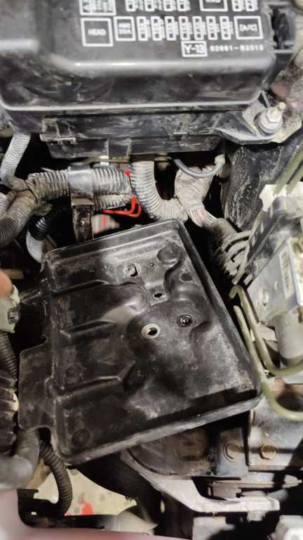

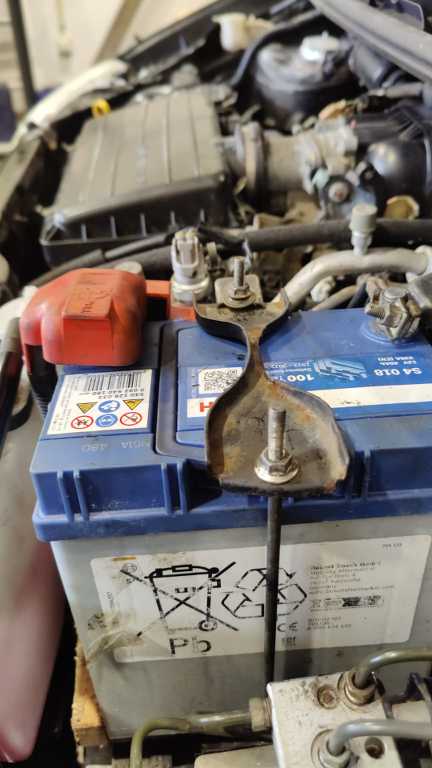

Replaced battery holder with a Subaru vivio battery holder
Replaced battery tray with a Suzuki alto 2012 batterytray

Got APK inspection today.
No comments on the mods
as they are stunned at the work I have done
Also got my emission sticker in

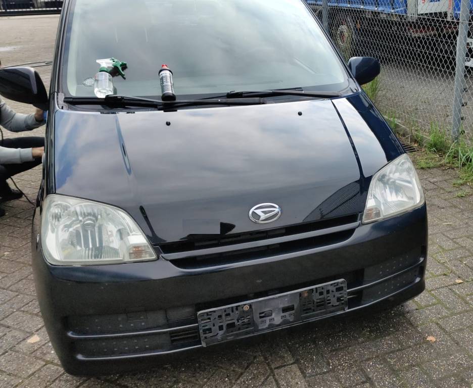

Washed the car from dirt
No brush just only water

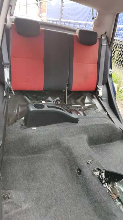

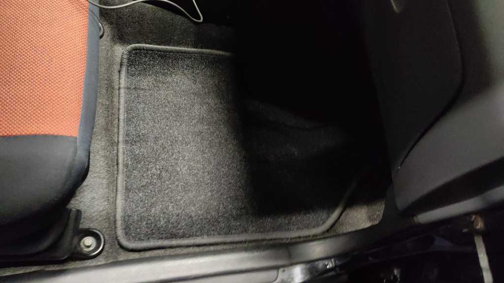

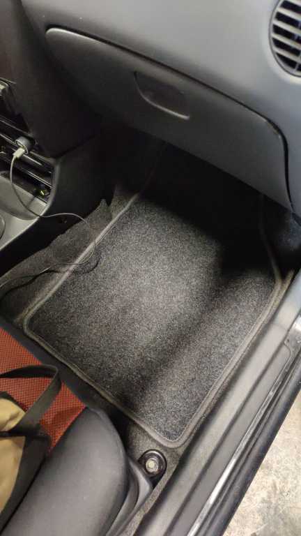

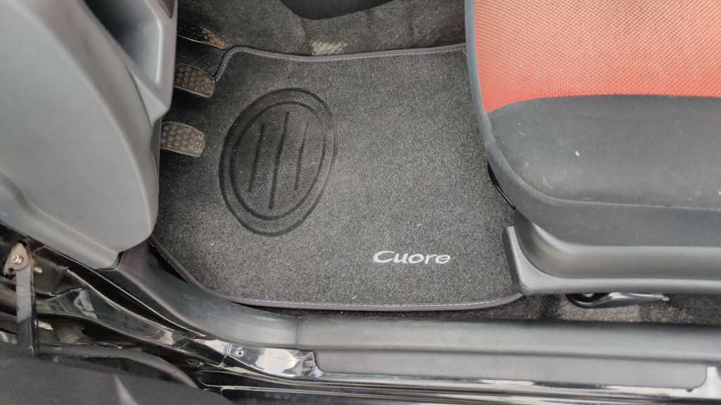

Found my L251/276 floor mats

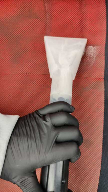

Deep washed it and drying now

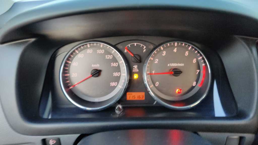

1L:21km = 4.76L/100km is good for its age will see what the lucas injector cleaner will do

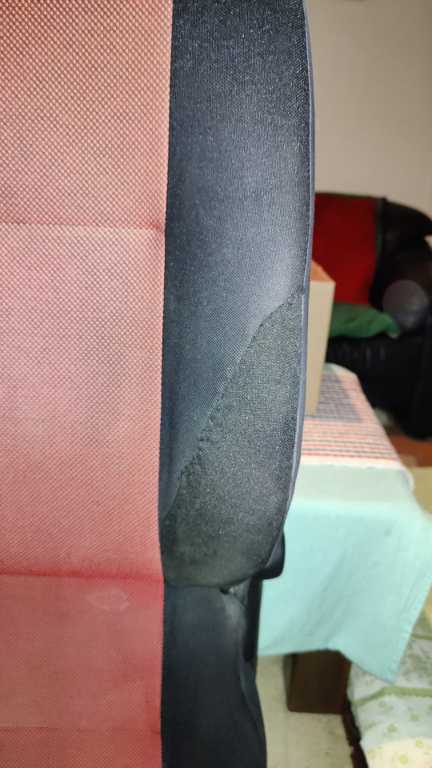

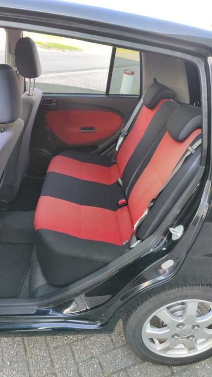

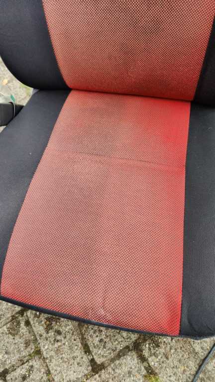

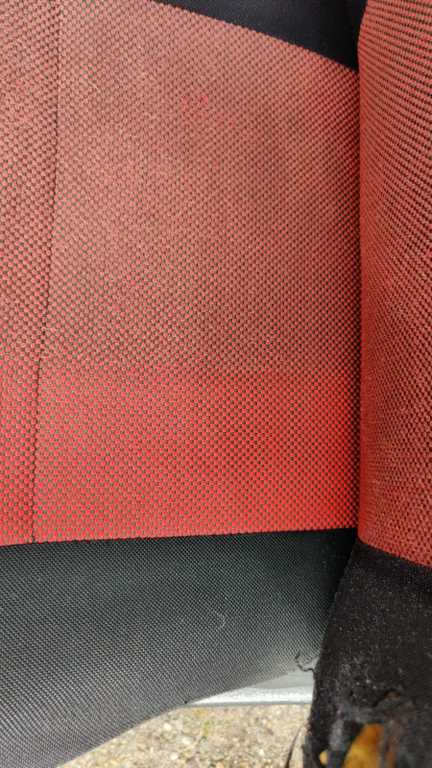

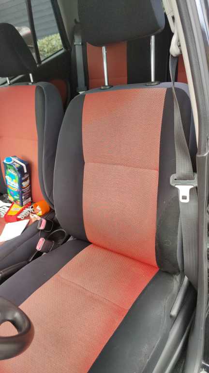

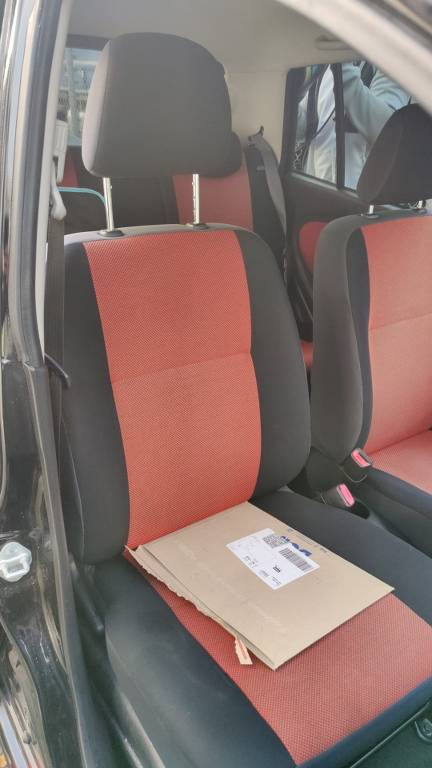

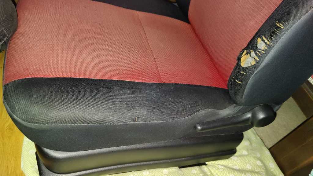

Took the driver seat out and found a donor seat to replace the fabric
Greased really thin the headrest pins as they didnt move good
My mother is good at sewing
She replaced the fabric, filled the foam up to its original height

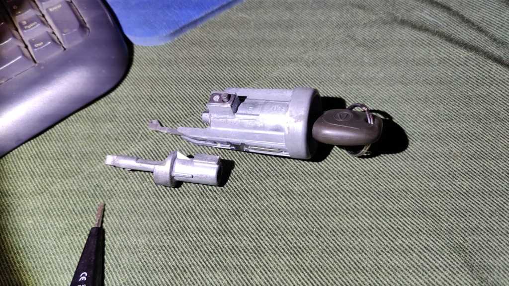

I also lubricated the ignition lock

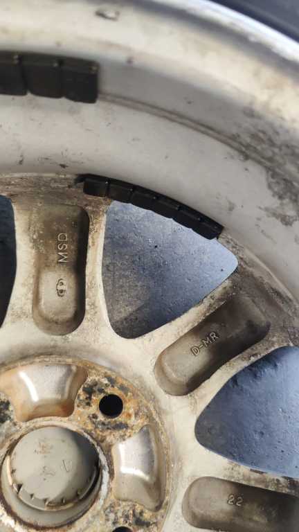

I did paint the oxidised parts of the Trevis wheels
Will remove the silver paint off the tyre soon

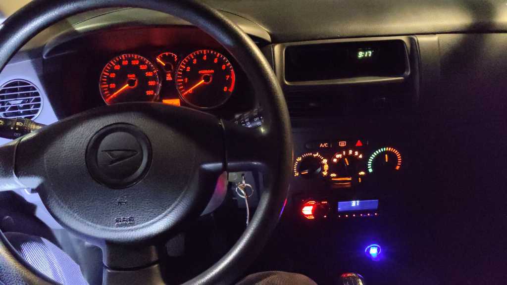

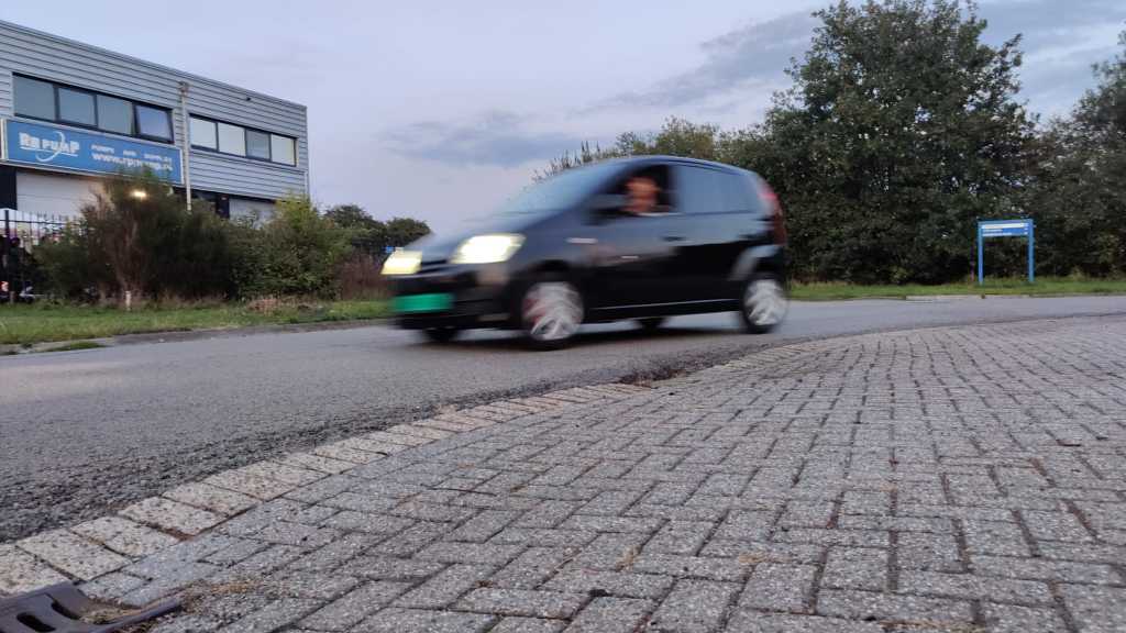

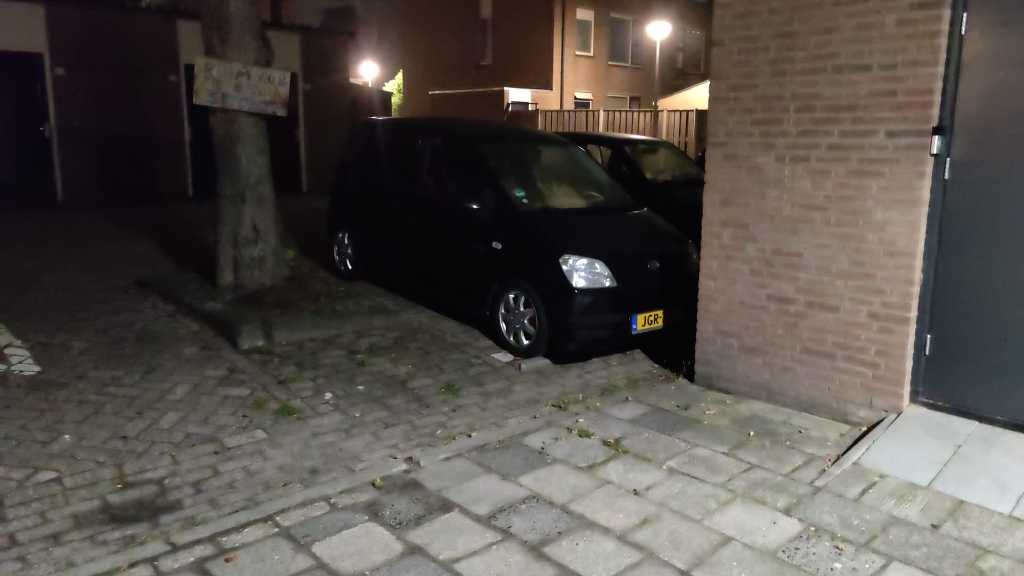

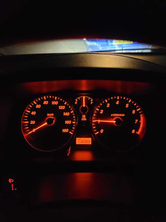

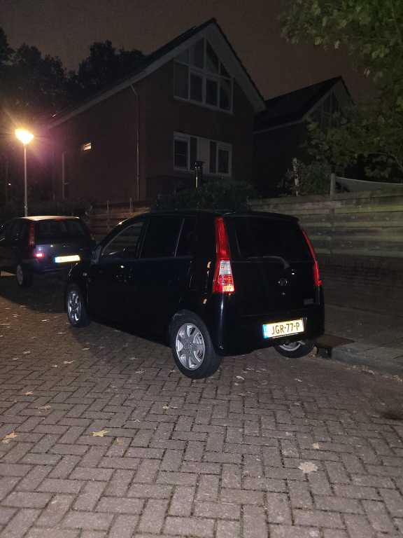

I also made a nightshot of the car

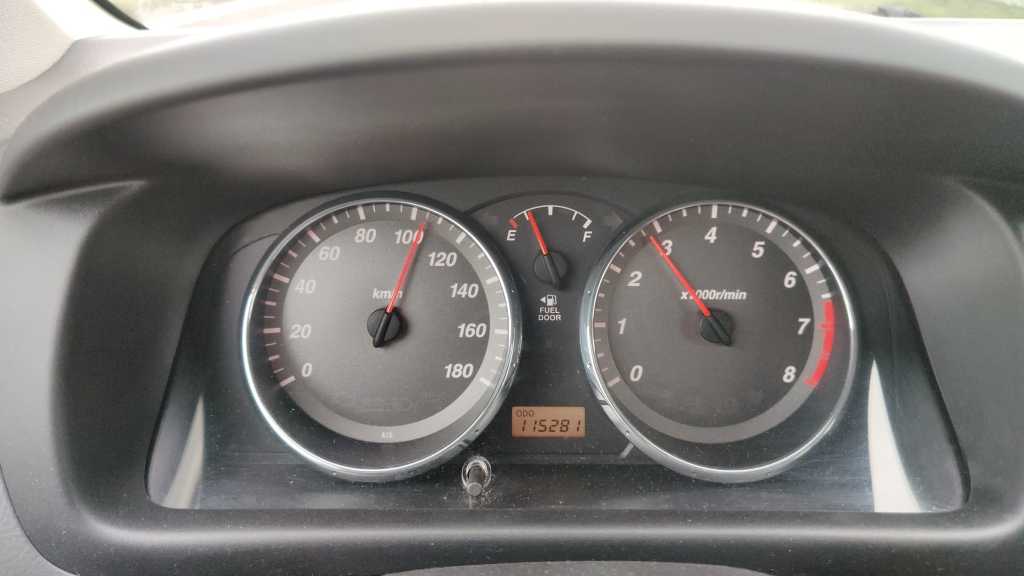

The Chili has never been running highway speeds higher than 100 km/h
So I am pushing it this time to get the engine a bit looser

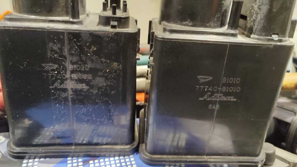

My evap valve has failed this week.
Will inspect it later and replace what is needed
So far no problems except that
replaced fuel tank due rust leak
replaced evap system due collapsed canister
replaced evap sensor

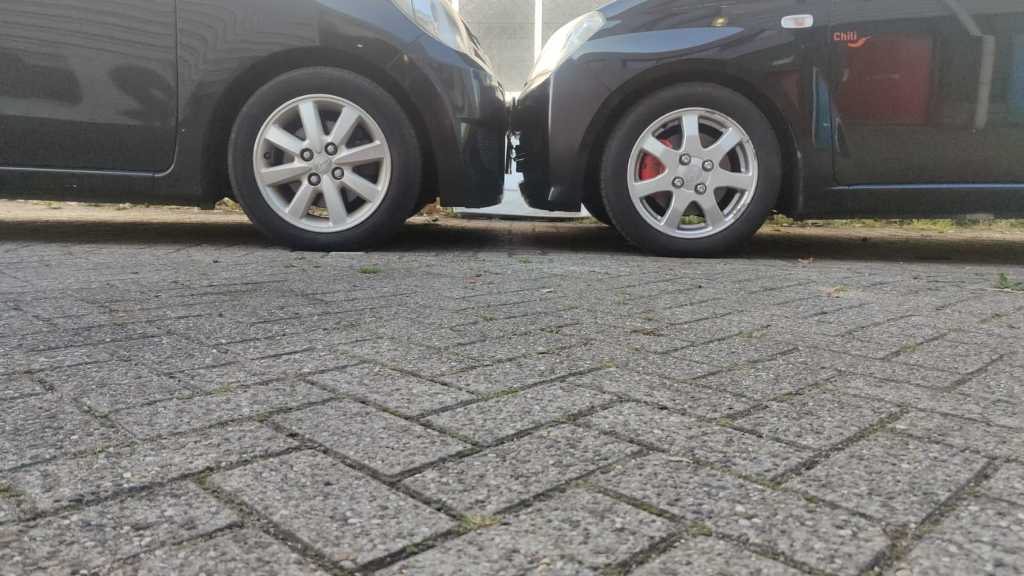

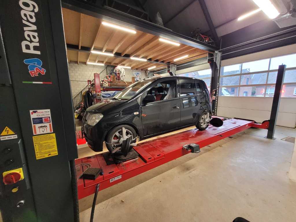

did alignment on the chili
sprayed wax in all crevices under the car
What were the specification results of the alignment? Were adjustments required or did you have this done, as a precautionary measure?
Because of the suspension and subframe upgrade
