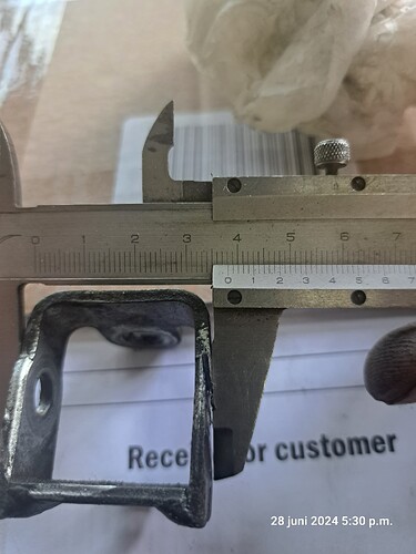

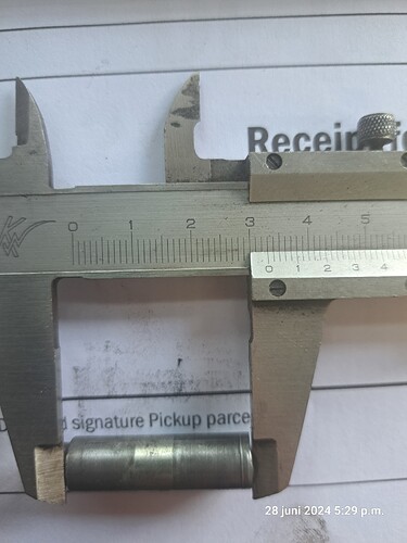

So i recently was tired enough of the lame handling gearshifter…so i cut of the small side and took the pin out at the gearbox. Took out the worn plastic bushes and replaced them for some newly made brash bushings. Tightend by an nut and bolt, and it feels like new again.

No i haven’t, but as you can see the measurements in the fotos. I simply used a 15mm soldering fitting, two 15 to 10mm reducers, soldered it all and changed the outside diameter to 13mm. Then you end up having the 13/10mm bushing. Using yellow plumber fittings is cheap and fully brass.
