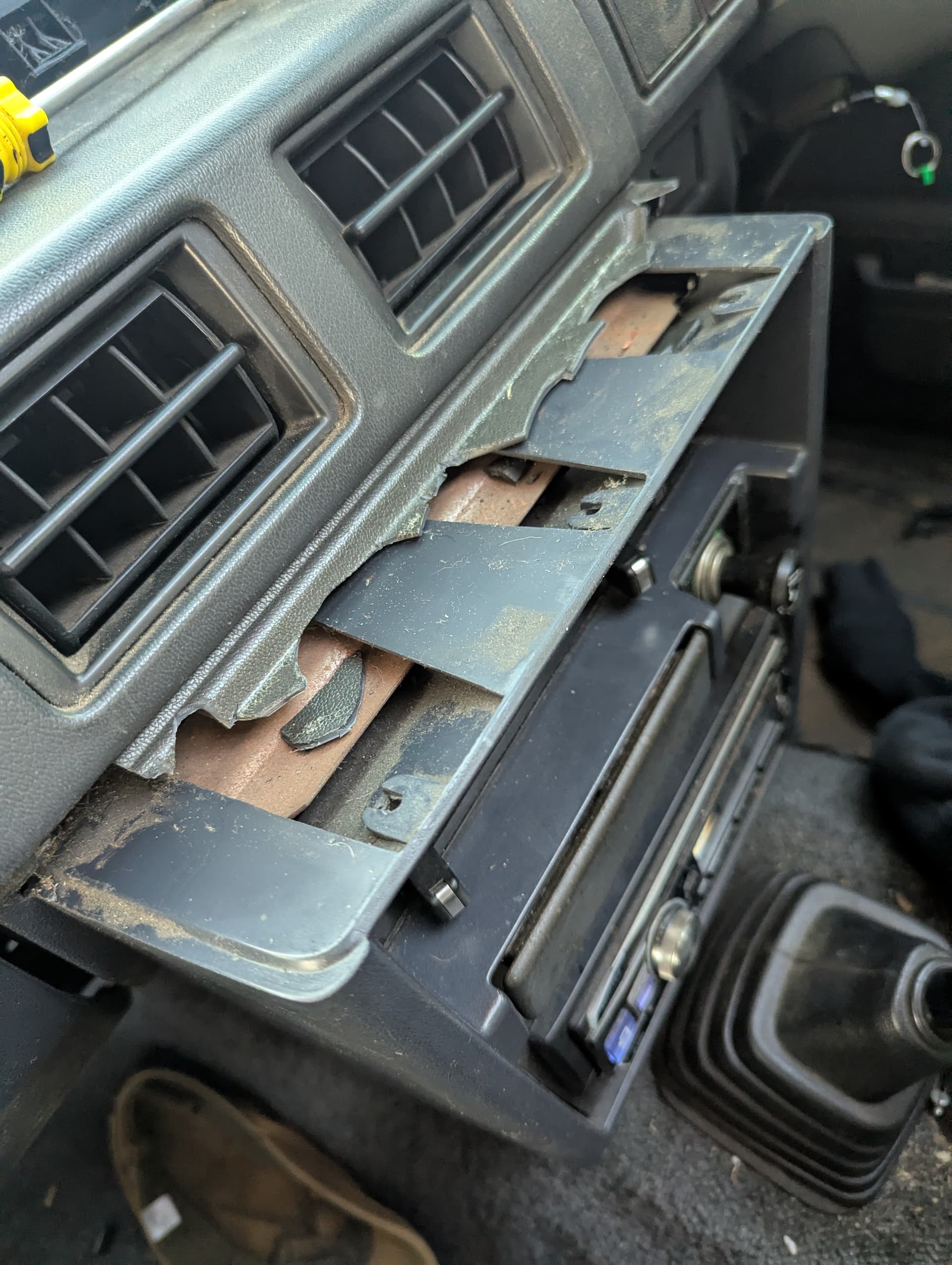

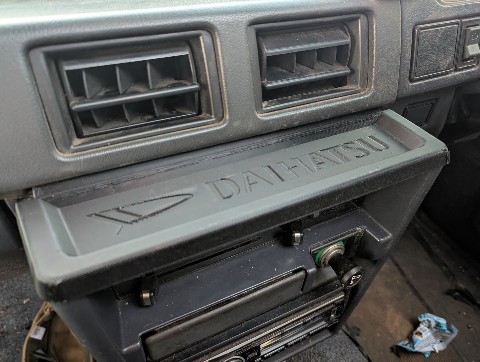

Found a 3d Print of the Commonly broken coin tray on Feroza’s. I added the logo :smiley:
This is done in PLA right now, Waiting for ABS to arrive.
I’m not sure if the original designer is on here, but here is the STL link
https://www.printables.com/model/1407441-daihatsu-feroza-coin-tray
If your tray is broken as much as mine was, you can undo the three back screws without taking the dash out, using a pair of pliers and a lot of patience. The model uses pins not screws making it so much easier to install.
