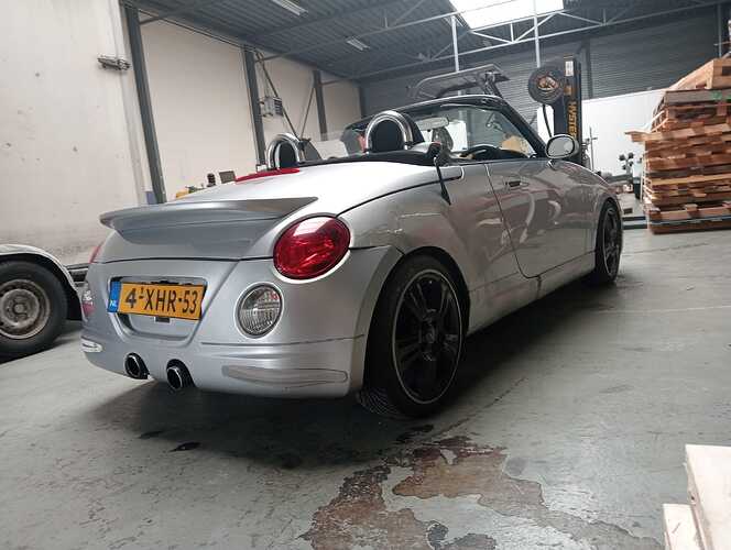

So we arranged to meet yesterday (Friday) at 9pm at her unit.
@marc0tjevp and i drove a couple of hours across the country to go see it.
And there she stood…
After a bit of talking the deal was made.
I was so excited that i wanted to take it home right away. Which was a pretty big surprise to her, so much so that it took a few minutes for her to process it.
Shortly after i registered the Copen to my name and the Cuore Classic to her name Marco and i drove all the way back in the Copen.
Immediately after leaving we found out the windshield was very greasy and dirty and the wipers only made it worse.
So we made a quick pitstop to fuel up and clean the windshield and wipers. It got a little better but still not great. Luckily it stopped raining before halfway.
We made it home safely. Marco around 2am and i around 3am.

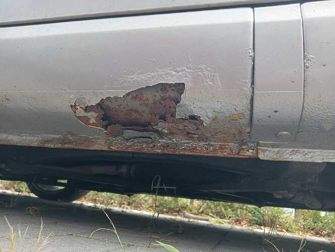

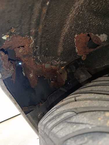

Yesterday i thought i made a lot of progress because i finished the drivers side sill and footwell.
Instead of fixing the rust properly one of the previous owners or their shitty mechanic decided to literally use ducttape, caulk, expanding foam and bog to fill the holes. Barely anything was welded. But this side is now “properly” fixed (on this side at least).
Today i was planning on fixing the other side. But then i noticed a little hole in the rear inner arch. So i started looking all over the rear inner arch and immediately lost all motivation to do the passenger side. I knew the sill was bad just like the drivers side.
But as mentioned i noticed a little hole.
And another small hole
And then a bigger hole
And then this
Then i looked on the drivers side…

Made some progress by blasting the rear of the Copen. It’s not perfect, but it’s good enough for now.
The little rust bubble on the arch kept bothering me. So stupid me decided to wire wheel it away. That was a absolute nightmare of a decision. What did i get myself into.
It’s that I’ve got too much invested into it otherwise it would’ve been crushed most likely. Maybe I’m crazy for even attempting to save rusty money pit,

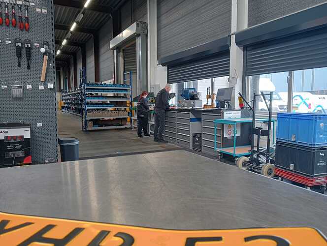

After putting her back together we took her for a quick little drive and dropped her off at the garage so they can hopefully give her a clean bill of health. :crossed_fingers: :grimacing: :crossed_fingers:

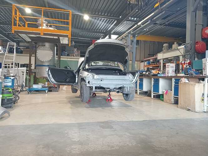

And she’s back inside. This time in our storage facility. Cause i (hopefully) found a decent donor. Tomorrow i’ll be going to pick it up literally on the other side of the country.
I’m going to try to fix and swap everything over in a week as i’m free from work next week and because i want to drive it ASAP. Cause even though i only drove it a couple hundred km’s in total i’m already hooked. And the noises it makes… :drooling_face: :drooling_face: :drooling_face:
I’ve seen a lot of things as a (former) mechanic. But i’ve never seen a airfilter rust before.
I hope to start work on the Copen this Sunday.
I’ll let you guys know how it goes tomorrow with the ‘‘new’’ shell.

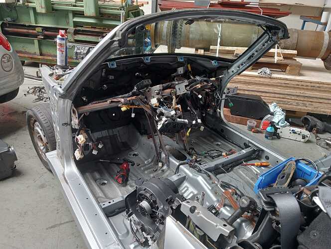

first things first
So i decided to take apart the donor first to see the exact state of it. Of course there were a few visible little rust holes and some surface rust, but i found nothing else other than minor surface rust which was quite the pleasant surprise.
Of course i started attacking the surface rust first (the holes will come later as they’re very small).
Despite it being one of the “complexer” Daihatsu’s it comes apart very quickly and easily. Before i knew the original Copen started looking very naked and parts scattered everywhere. So out came the boxes to put the stuff in I’m not going to use.
for F sake Daihatsu

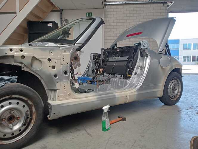

While taking the roof off of the original Copen i was faced with the challenge to get 8 bolts out that looked like this. Either Daihatsu was afraid of the roof flying off or someone in the factory was having a bad day.
In Rust We Trust
I found a treasure in the original Copen from it’s life in the UK. Apparently not only their cars rust to hell.
the right way and my way

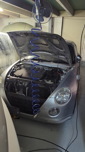

It might sound weird, but to get the interior finished the engine needed to go back in.
So more time spend getting rid of surface rust and treating it.
And of course a nice time to service the engine. (Side note! This is technically not the right filter, i had a few for my Gino laying around and it fits so why not).
Lots of new bolts, copper grease and paint later everything is coming together nicely.
Then finished the interior.

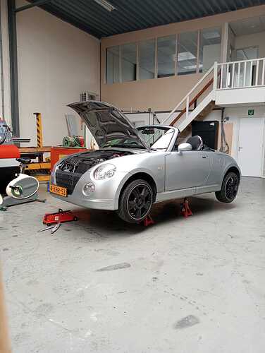

It took way too long since i did any work on my little girl. Finally got the motivation (and a little push from @marc0tjevp and @Coen) recently. Dusted off some of the parts i bought about half a year ago.
New moped airfilter. Cause it was what was on it and because it’s the only one that fits.
Also fitted a new genuine turbo coolant hose and clamps. Cause it was leaking when @marc0tjevp and i went for a little drive 7 or 8 months ago. No more jubilee junk. The crazy parts is that they ship the clamps under tension.
After getting the last couple of things fixed i brought her away for inspection and she passed without any problems or advisories.
