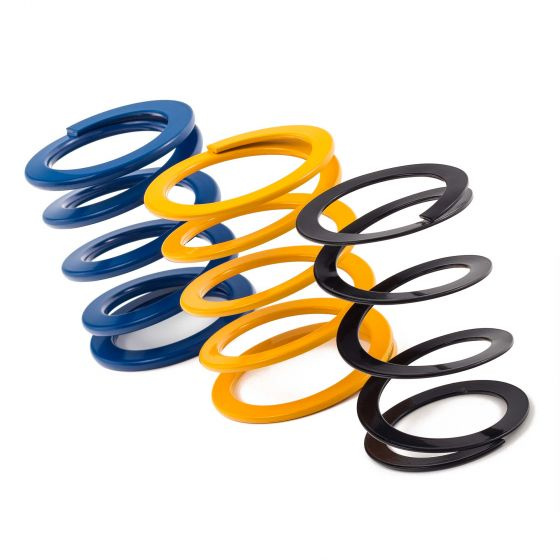

Flat section helper springs can solve the captive spring issue. They would raise the car a slight amount and depends on the rate. Once the weight of the car is on them they go flat and have have no rate, as in “solid”.
Or run a perch of some sort. I’d machine up HDPE bases in the requisite thickness if rules said I couldn’t touch the spring seat. Sometimes I have cut (turned off the in the lathe) the spring seat and welded back on. Mainly though I do this with std diameter seats and they come down such that the tire just clears (nom 25-30mm). Other times I turn up my own adjustable threaded section and seats.
Helper Springs! Yes, that’d solve the issue. I see Eibach has some 95mm ID (3.75") Helper Springs.
