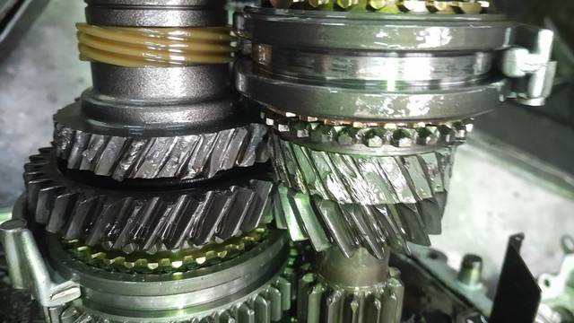

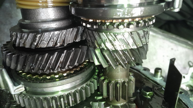

So my Sirion m300 1.5 3sz gearbox broke
3rd gear broke on cluster and counter gear

Gearbox lasted 340k kms which is quite good
Can I use 3rd gear from another gearbox to rebuild this one?

My 3rd gear broke on the original box sending lots of metal pieces into the box probably damaging other gears
