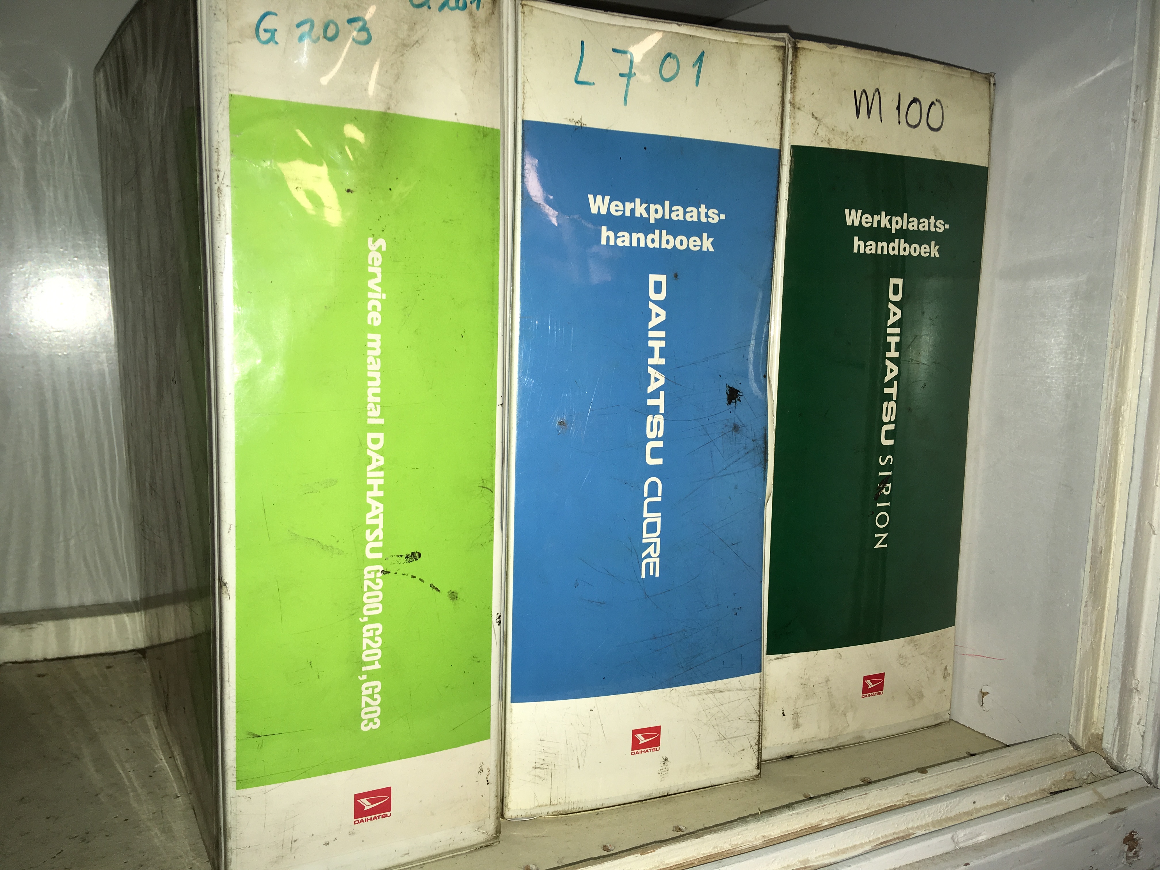

small update, picked up some Original workplace manuals for the G200 series, L701 cuore and M100 sirion. The G200 is inclusive the body repair manual. bought them of a Honda dealer.
Also picked up a L701 Avanzato/TR front and rear bumper from the wreckers. Don’t really need it as I don’t have an L700 but could nog let it go into the shredder. (also took out the dash cluster as it included the tachometer)

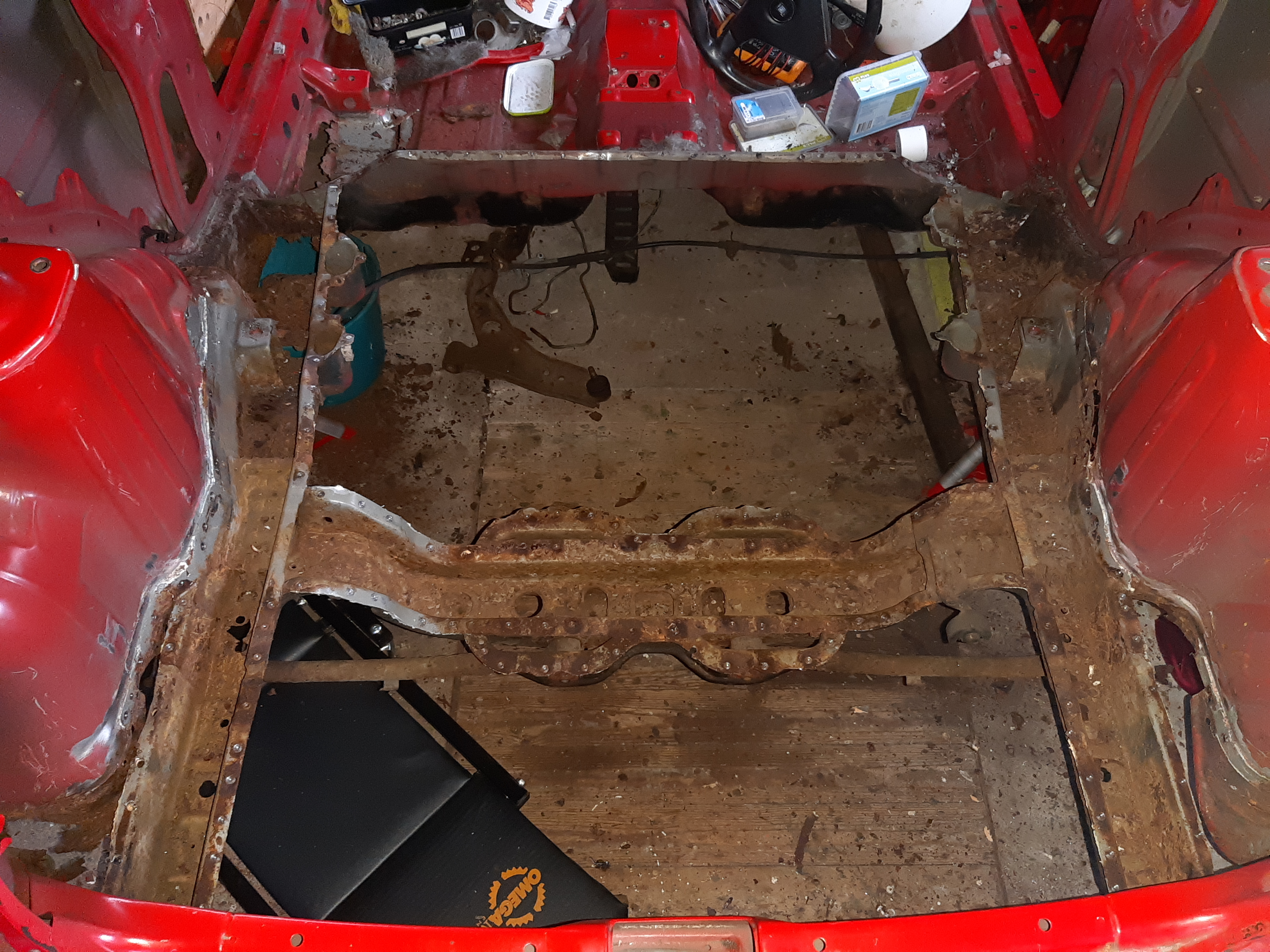

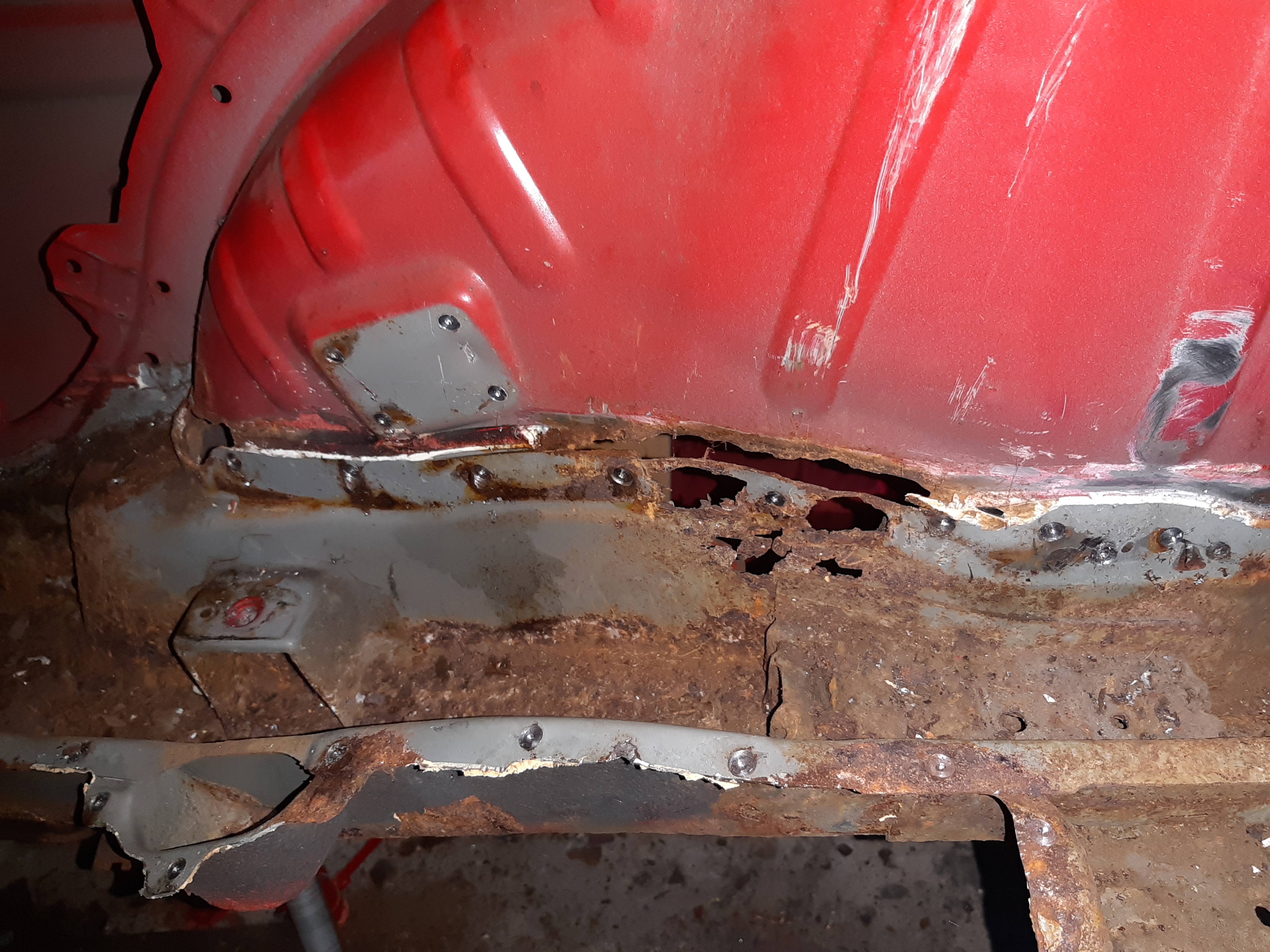

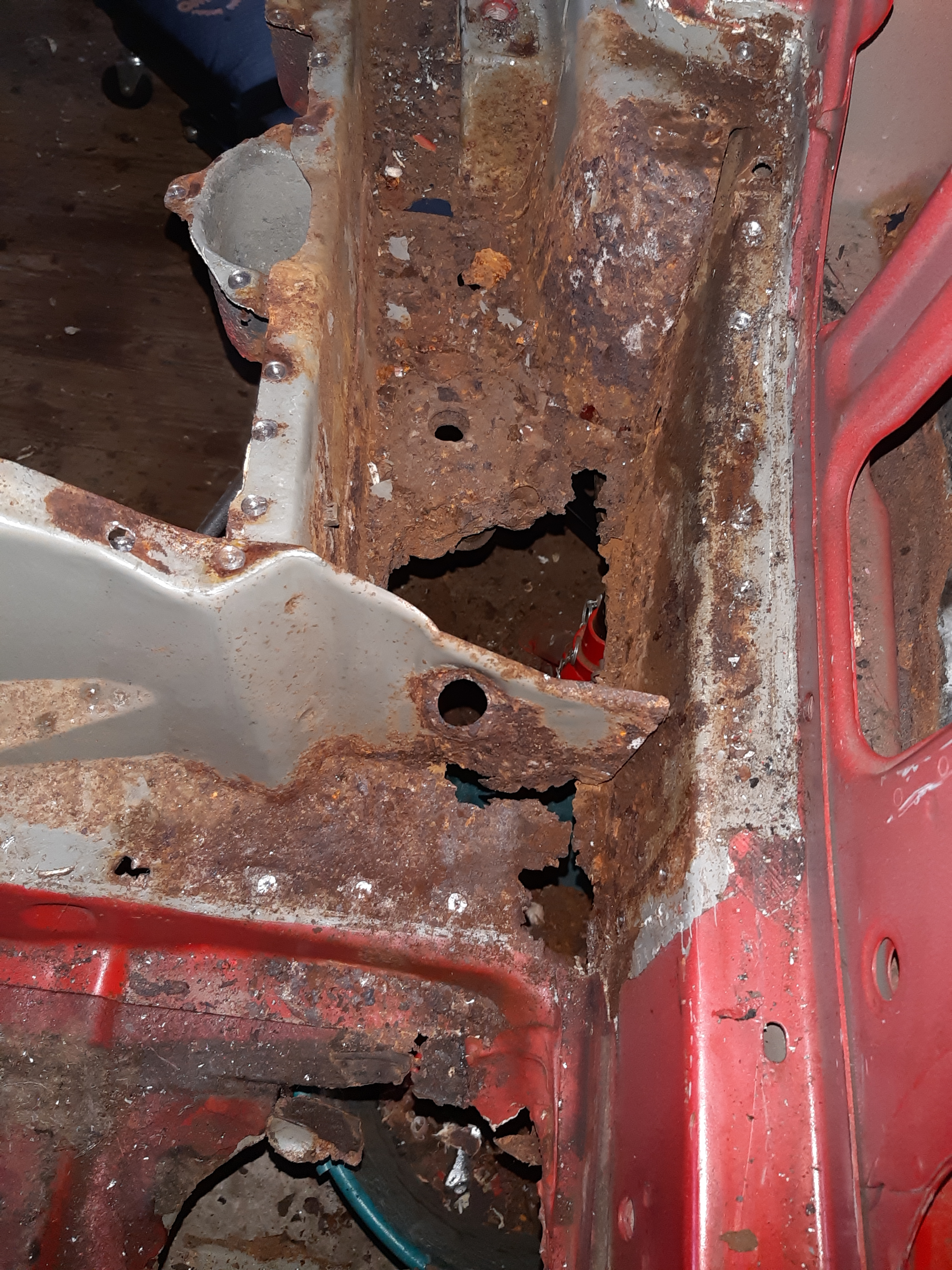

So update om the Detomaso, I took out the rear floor as there was quite some rust. And well the saying rust is like an iceberg seems to be true. The rear frame is pretty much rust with some metal here and there.
So first thing now is to get the frame rust free again. Same for wheel arches at the inside, need the replacement.
When that’s good, I can hang the car in the rotisserie and get working on the sills which are, well they don’t really exist anymore. So work enough for the coming period :blush:

The detomaso is in a bad place at the moment, the car has had several welding jobs done to it in its live, not all very well done. The rear is completely gone, it turns out the chassis frame on the car has been welded over it. The old sheet metal was still there and they welded new (very thin) metal over it witch is also completely rusted, the floor is gone the frond is crooked due to an accident its been in ones. So far not much has remained of the car and we are contemplating what to do as a next step. To be continued.
