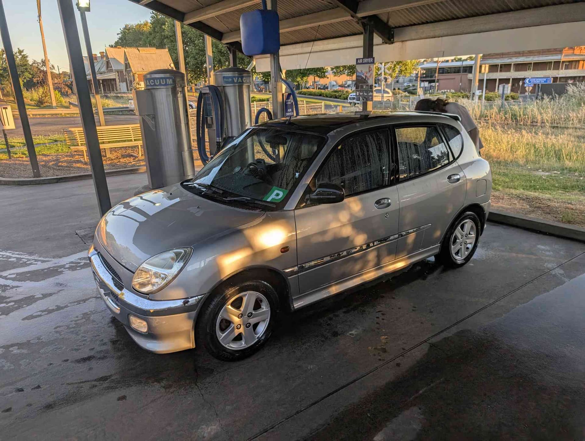

Sirloin (2000 Sirion Gtvi)
I recently bought my dream car and drove it home from NSW to VIC
I have wanted one for ages and finally own it.
So far i have replaced the front lower control arms, cleaned the pcv valve and done an oil change tho unfortunately it burns oil past 5k on high mileage 15w-50 plus some lucas so i think it needs rings. It currently has a p1346 and i suspect i need to clean out the VVT solenoid or buy a new one as it doesn’t show symptoms of crank angle sensor.
As for plans for this car? OEM+ I want to keep it clean and close to original and take care of it. I will probably put some new shocks and some lowering springs and drive it for the rest of my life if possible!

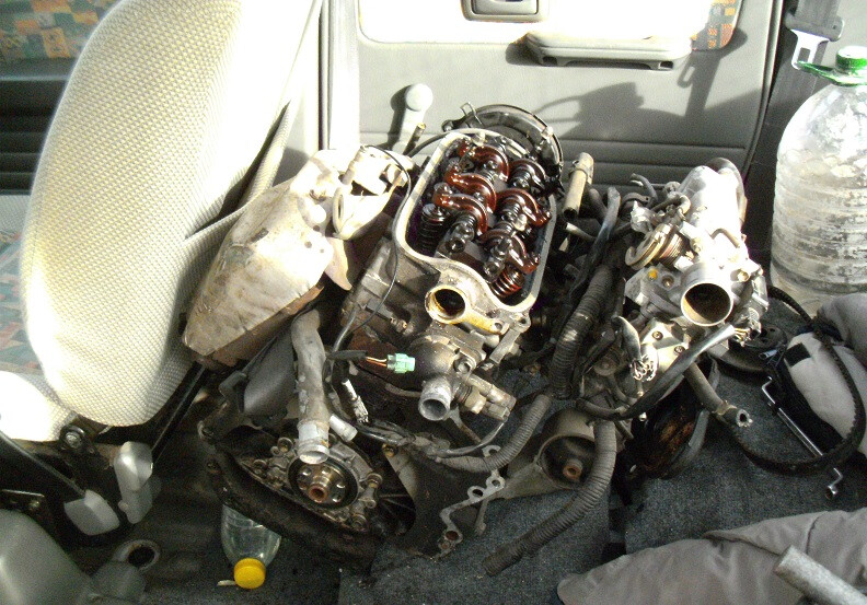

I once purchased a used ED-20 which was labeled to have had 194k, before it was extracted. The camshaft looked almost new, compared to my worn-out original which had only about 115k:
Of course, I’m not sure if that wasn’t a replacement engine or not, given that the vehicle’s odometer has no way of knowing. The piston to bore wear, however, looks like it has noticable side wear, indicating prolong periods of high-speed operation, since that’s when piston speed is at its highest. Whether the wear is excessive or not would be better off determining through measure and not simply visually

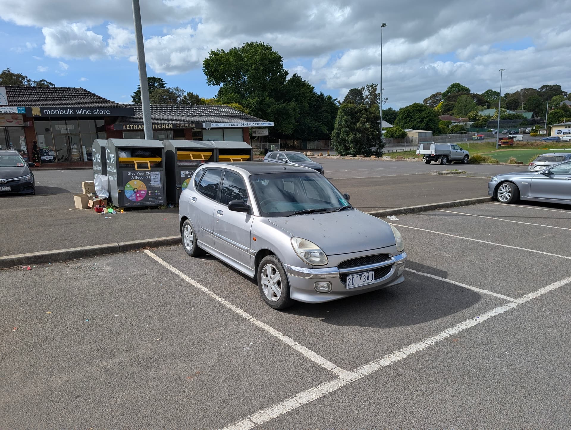

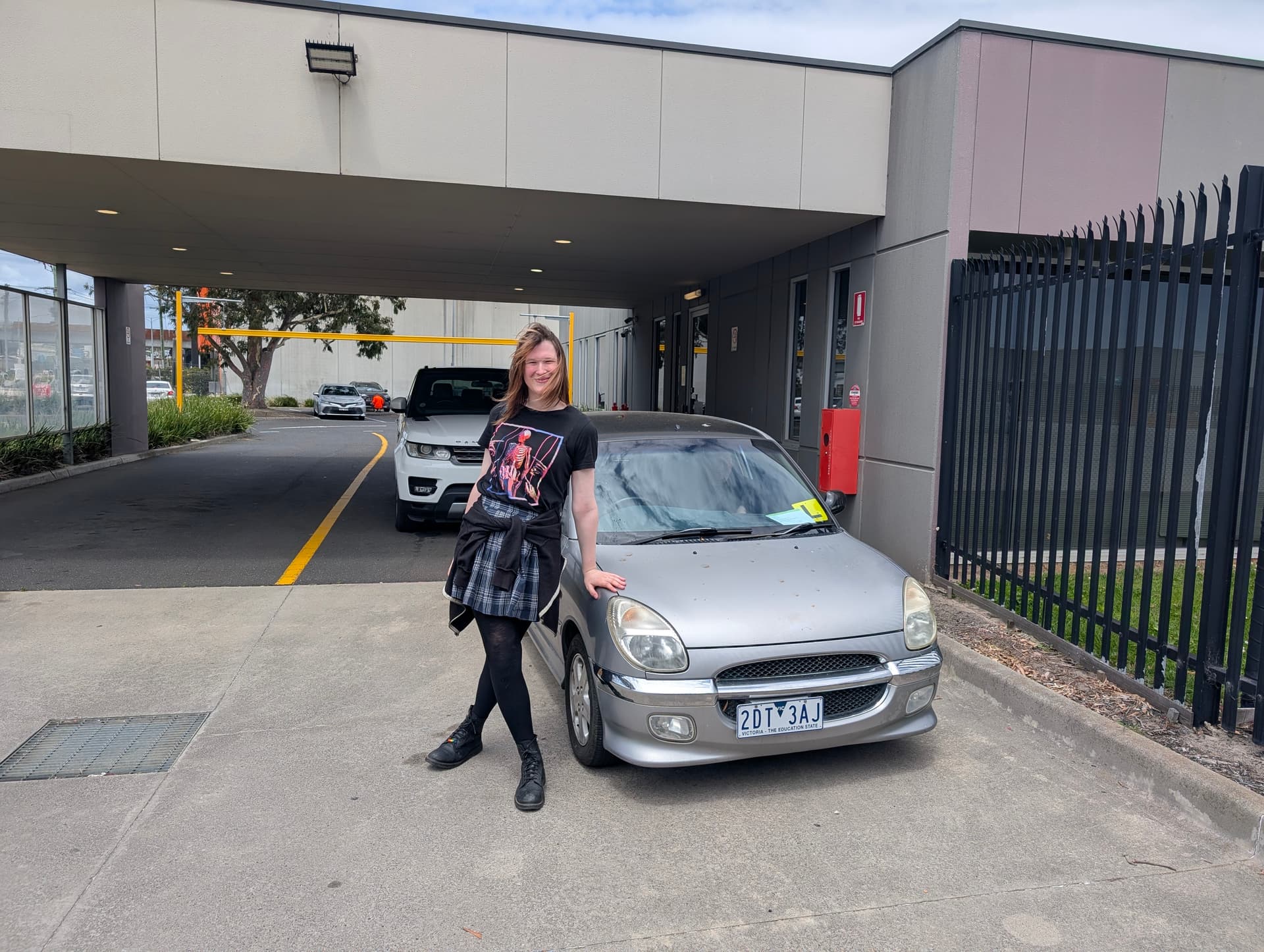

She’s on the road now!!
I replaced the Brake rotors so the annoying judder is gone and i gave him his nose (Front Badge) back, but more importantly i PASSED MY P TEST I CAN FINALLY DRIVE HER ALONE! … also i swear i own more than one shirt… lol
Well done on license and getting some smoother braking. :slight_smile:

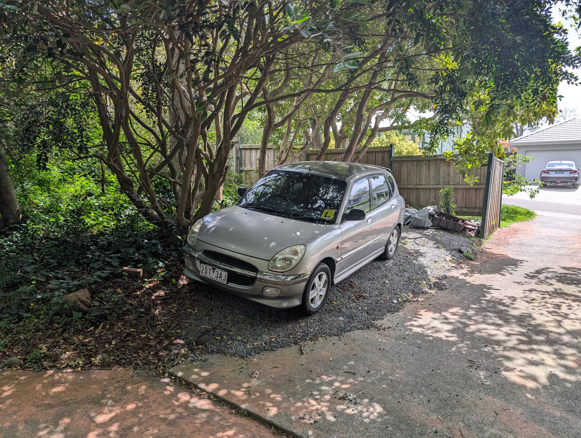

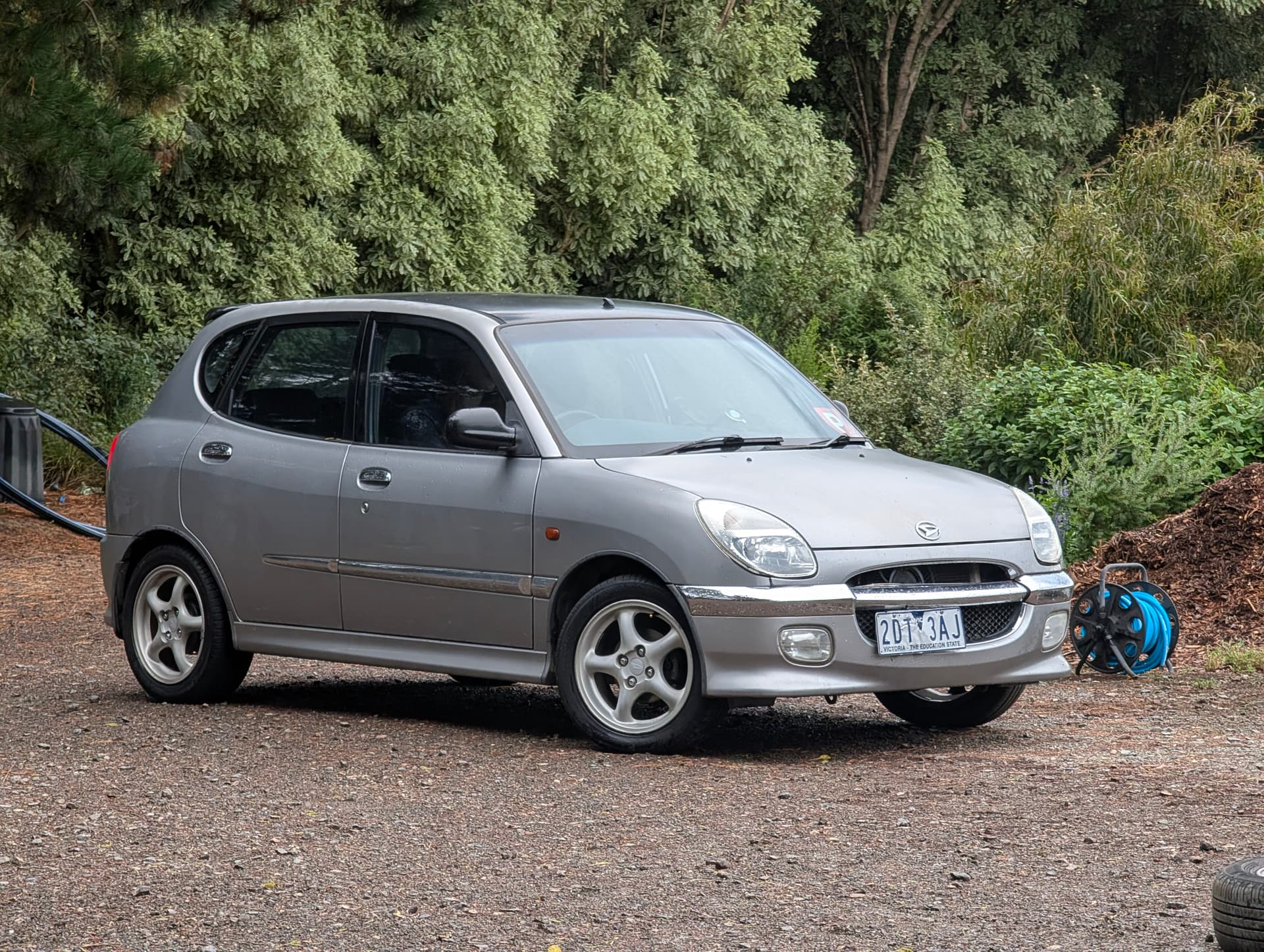

got some nb miata wheels with 190/50r15 pilot sport 3s on them :slight_smile:

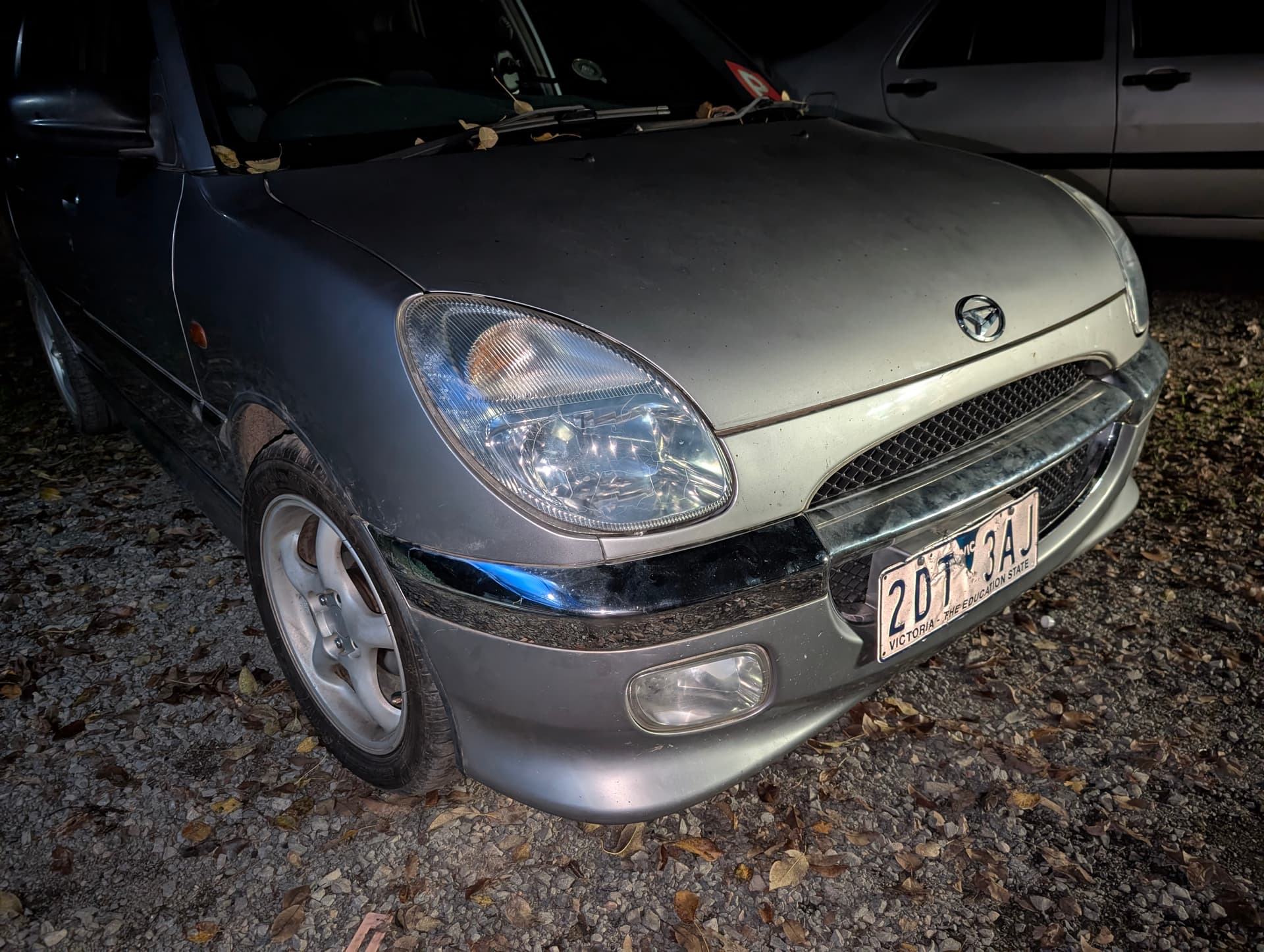

Finally replaced bits of the front fascia, so just gotta get a bit of aircon hose and it’ll be back in ship shape! I replace
d the cam angle sensor to fix the code too.

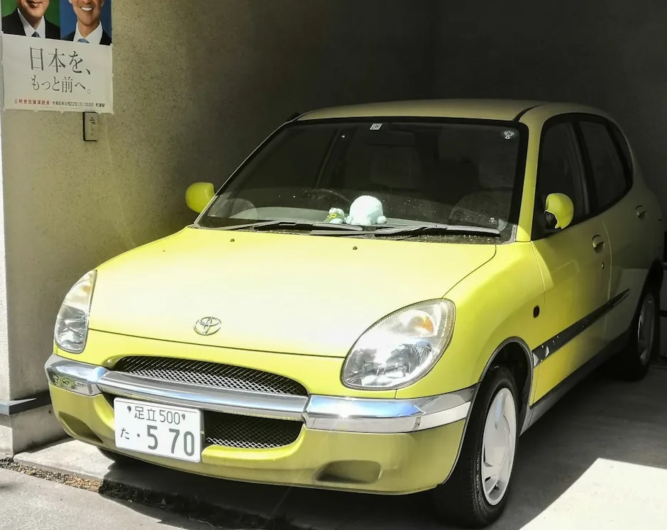

Toyota’s rebadging could broaden parts availability?:
