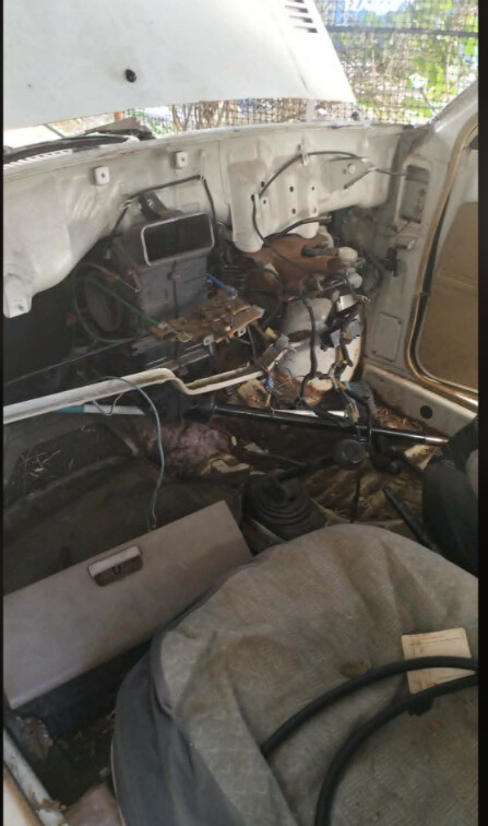

Be expecting a lot of rust in places you wouldn’t think.
I can take a few pics of what’s left of my donor car to show you the worst areas.
Good thing is there’s not a lot of car to rust in the first place.

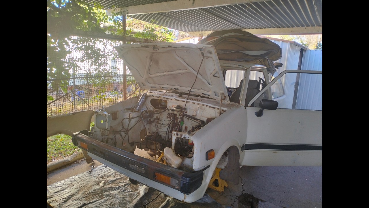

yeh that would be helpful thankyou. I have had a bit of a look and yeh there is a bit of rust but not as much as I thought there would be. I will be stripping it out to get a decent look at it and I do want to get it running on the original 2cyl first but it may end up with the efdet in there.

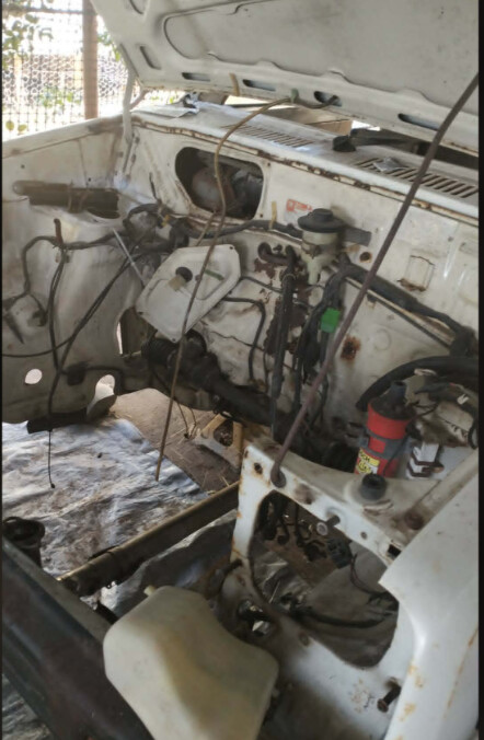

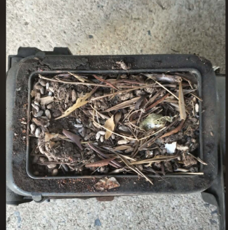

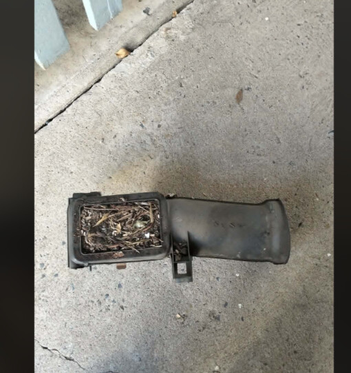

The wind coming in must have been really smelly.
Did some more today.

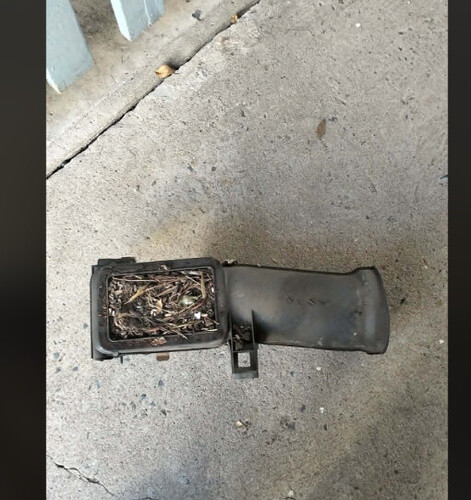

I used the garden blower to blow out as much dirt and rat poo as I could as alot of it is unreachable.

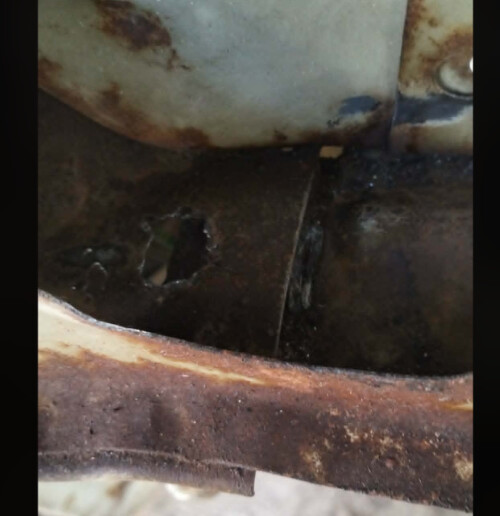

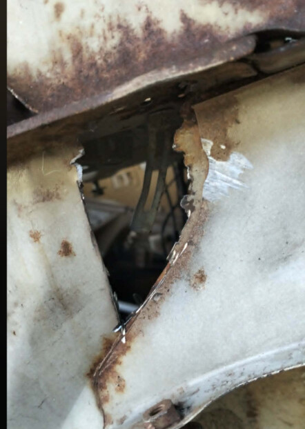

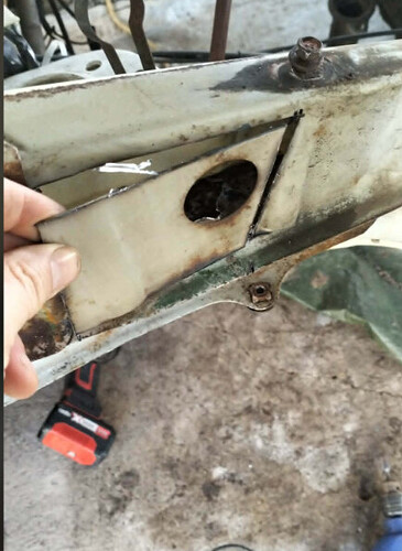

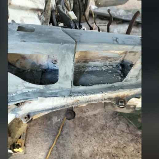

Had to cut a hole so I could get to the rust to be able to rust convert and plate it. This is in the driver front guard.

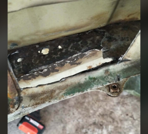

This is behind it and I think I had cleaned it and rust coverted in this pic but not sure.
another one I took care of
and another I didint get to but cut out the crap.

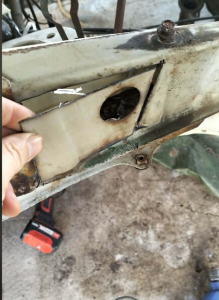

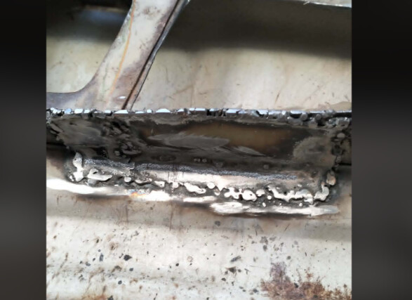

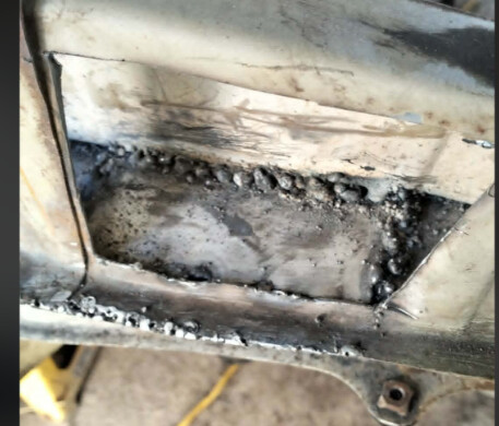

The big hole actually got 3 pieces of metal patched over it. One on the outside as picutred. Then i put another on top to cover some small holes further in (no pic) and then one on top to bring it in to the inner skin and add as much strength as possible.
Bottom
Top
The other bit also shows before the other top was on

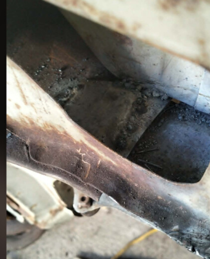

I then found an old tin of kill rust but could not find a paint brush so a tooth brush had to do to get some in there lol One of the draw backs of living on the edge of the outback, not much option when you dont have or cant find what you need.
I never got to the triangle bit or welded the hole i cut back on as yet.
As you can see my welding skills are not the greatest and I uses a gasless mig as it is what I have. I will make things look pretty later the focus is more getting the rust fixed first, pretty later.
