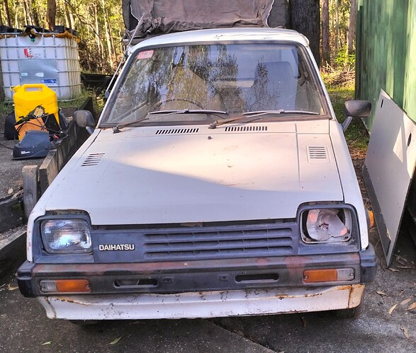

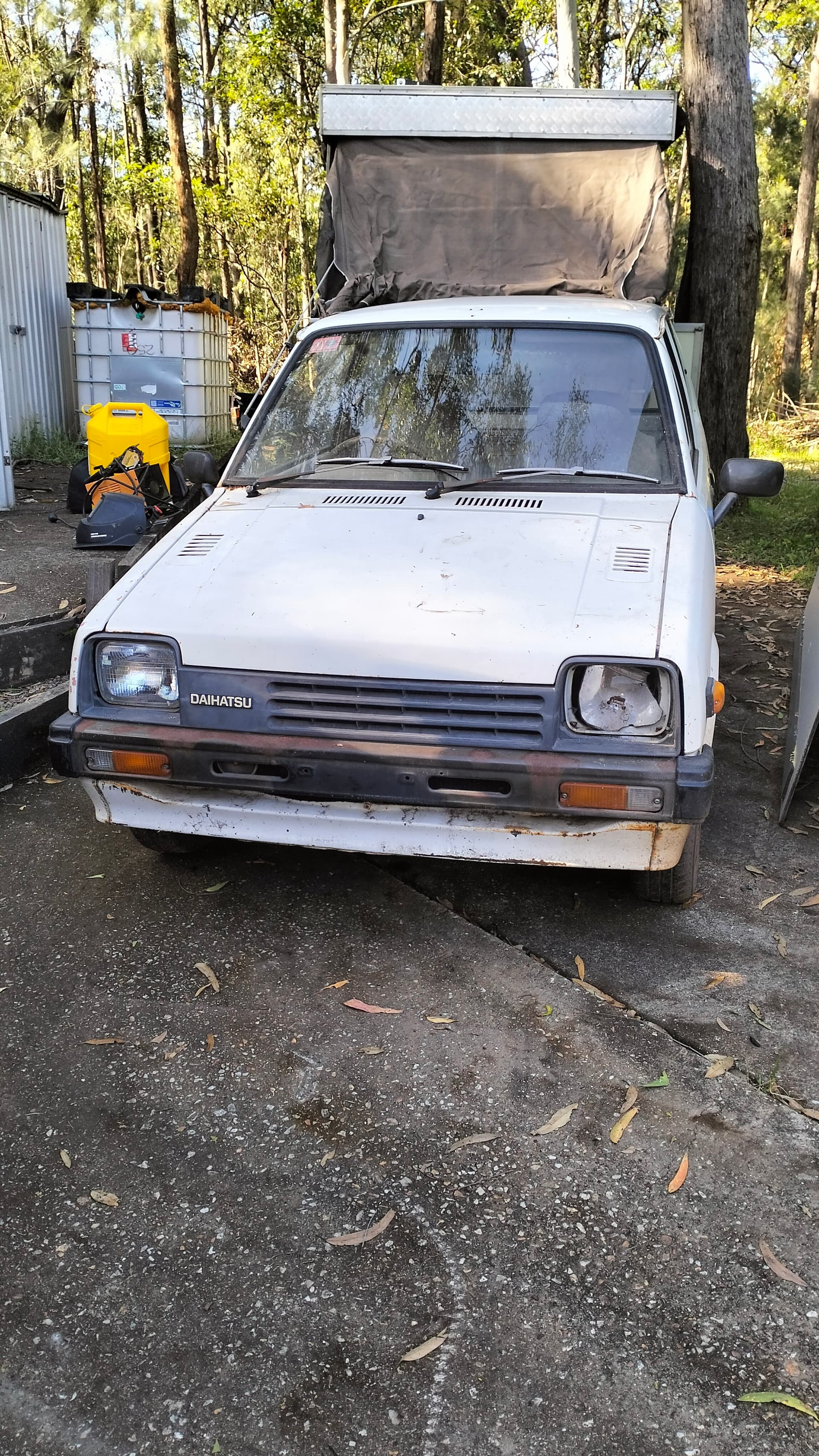

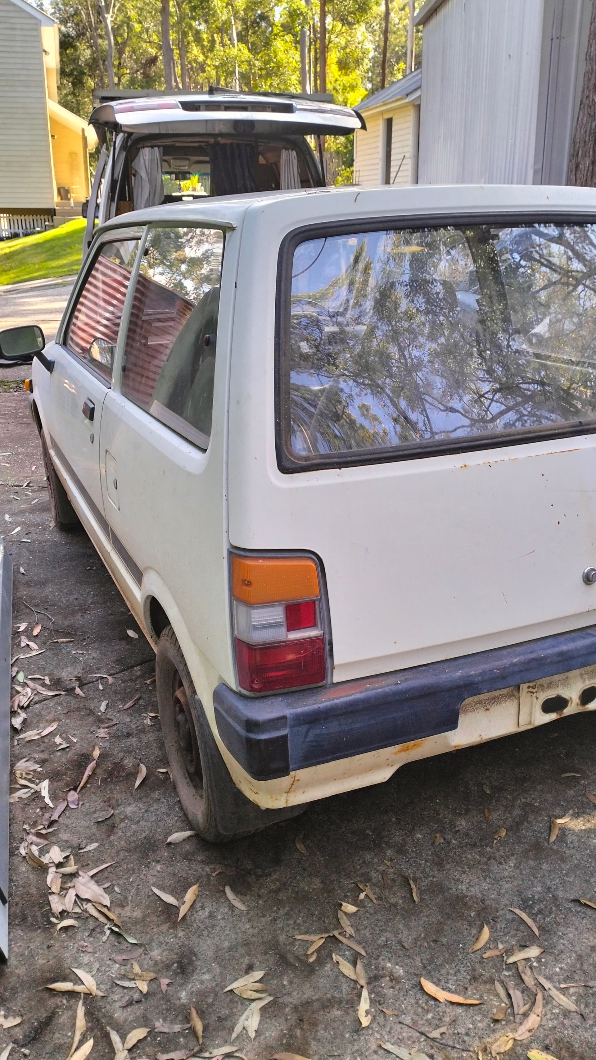

I was on another Daihatsu Facebook group the other day, and when I dropped in an advert for this wonderful car was there and the advert was 2 mins old. The price was right, and I sent a message.
I figured I missed it, but about an hour later, I got a message back saying, "I can come and get the car ". (The price was … Free).

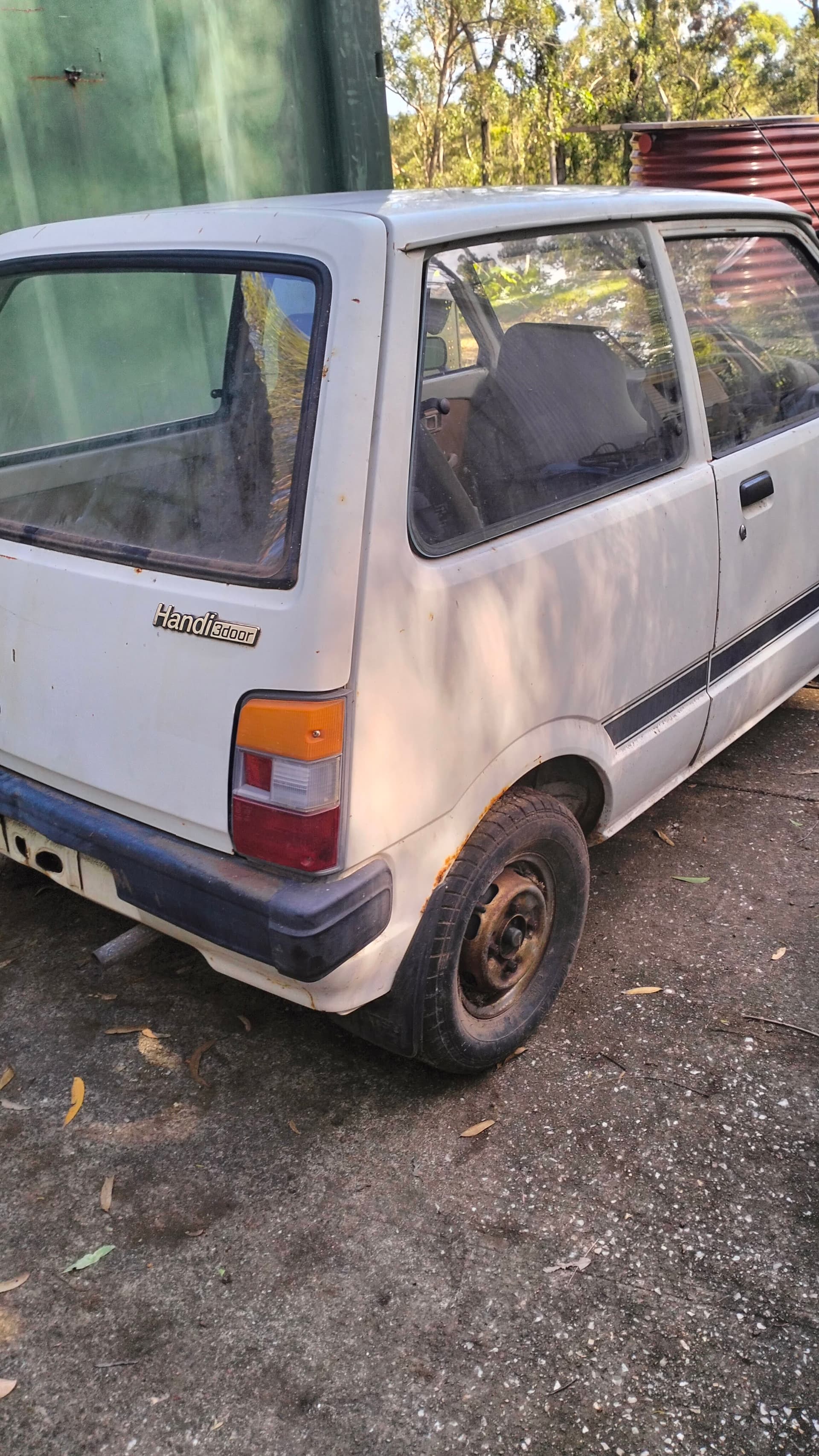

So the next morning, I hooked up the trailer and went to get it. The guy used it to teach his kids to drive. They overheated it, and it sat in the shed for 7 years.
I really haven’t done anything to it yet. I haven’t even started it or washed it.
I sort of figure for the name I may go with Storm Trooper to keep with Dales theme as he has wookie and darth, I mean its white and will probably miss the mark on everything. Either that or Handi-Job. What are your thoughts’s Im not really sure.
Anyway as you can see it does need alot of work but I would like to save this one.

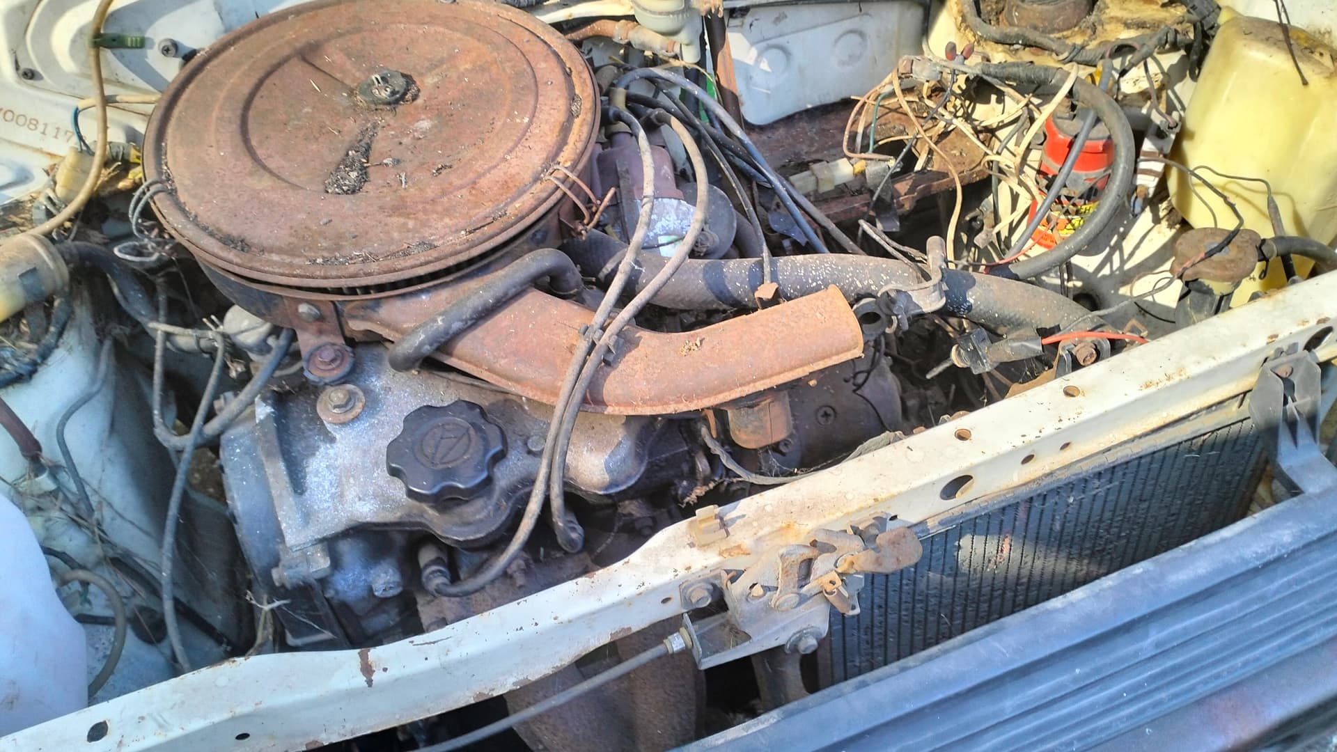

As for plans- I will see if I can get the 2cyl running and really decide form there. If I was to upgrade the engine I would have a choice of the efdet with the turbo gearbox or an ejde. Either one would be a big power upgrade but lots of cosideration on what I need to do to make it happen will take place.
What do you think?
2cyl refreshed?
efdet?
ejde?

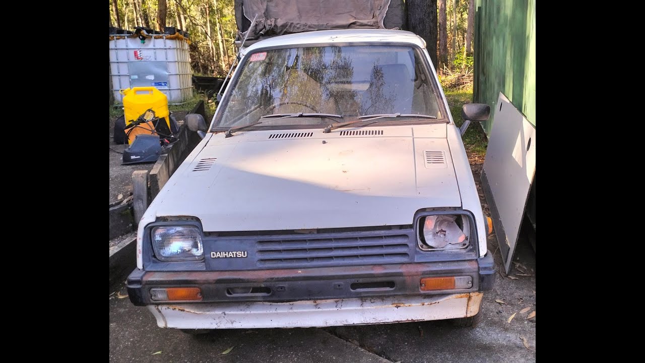

anyway here is the pics.

If there’s no coolant in the system, chances are that it leaked out, after the overhead blew its head gasket. If the head gasket is still intact, I’d leave it as it is, for awhile.
Replacing the drive train with the one you’re planning will give the car quite a high final drive ratio perfect for doing burnouts, given the smaller circumference of those 10 inchers

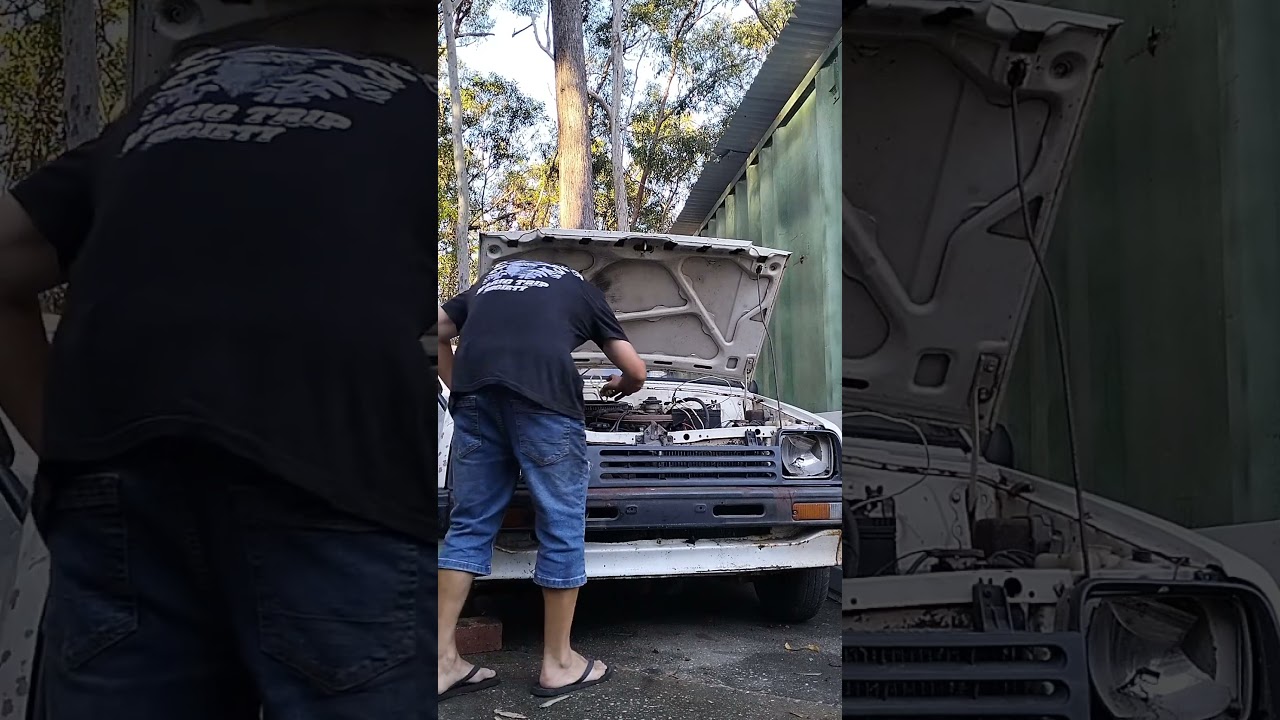

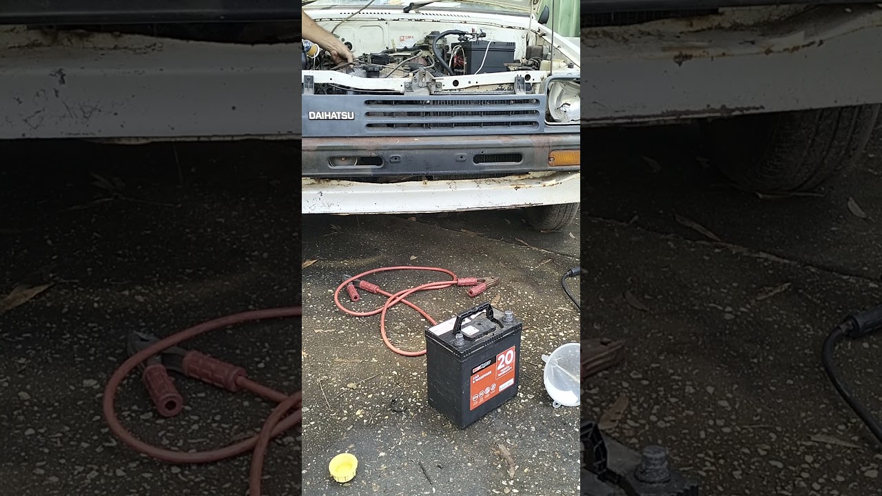

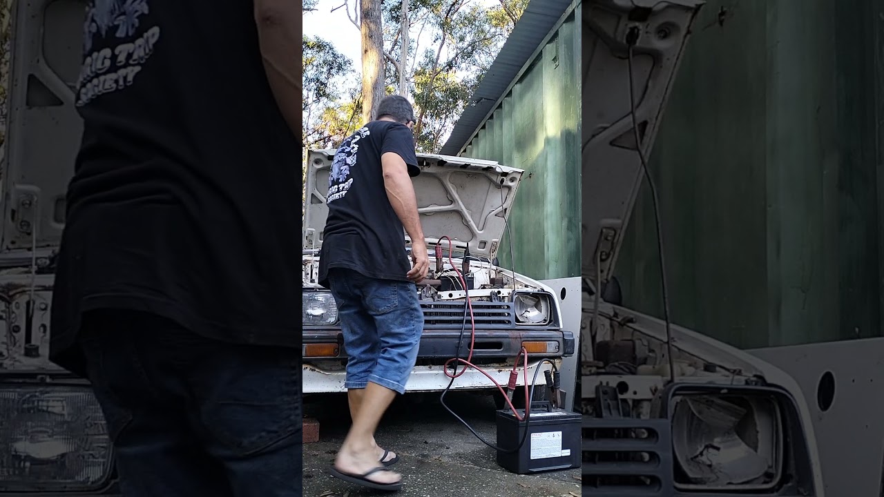

So I made a few attempts to start the Handivan. Here is the first one and we will see how we went.
Attempt number 2. It was the same day just my pc and phone is being terrible transferring the video’s. I still have one more to go lol.
I forgot to upload this one. Sorry very late. I didn’t realise until I did another vid.
Now I got to remember to upload them.

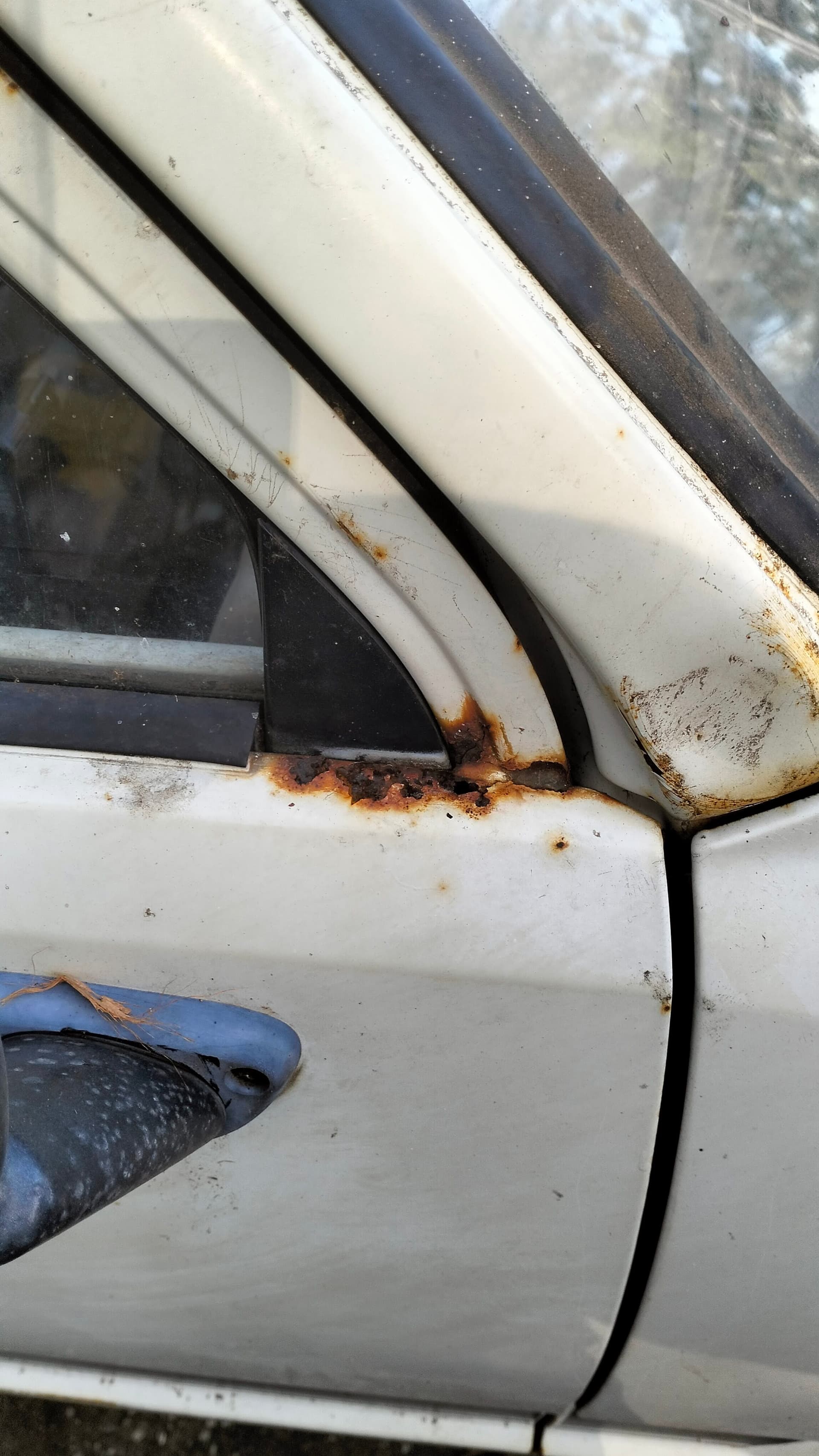

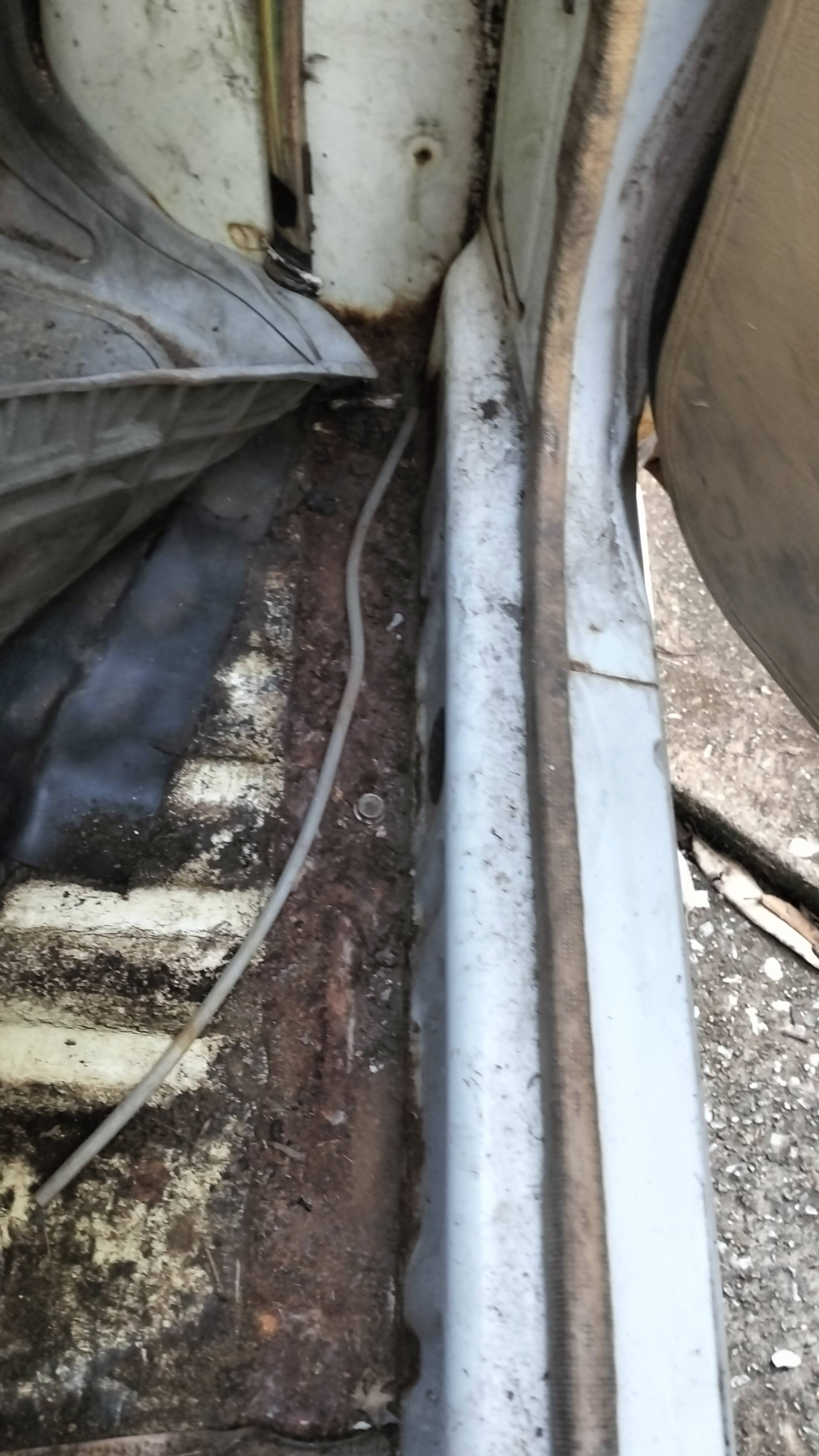

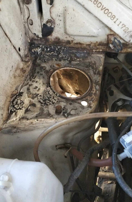

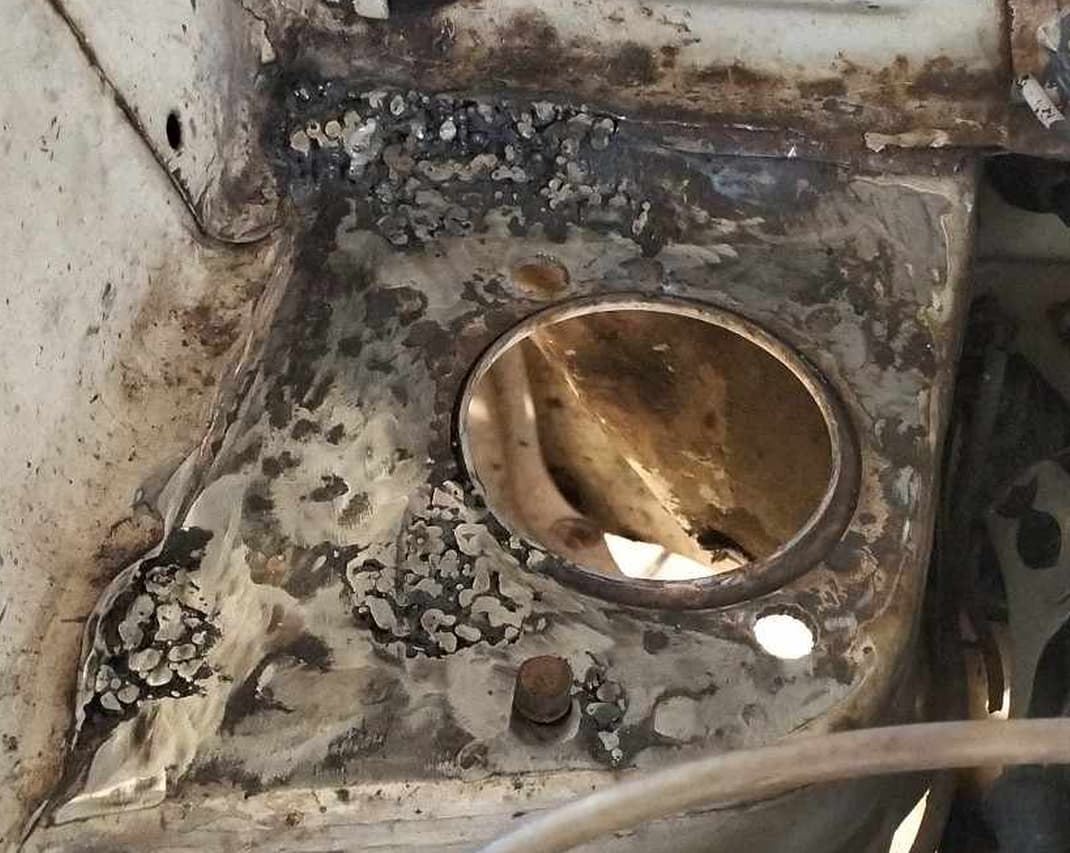

Whilst this looks terrible the strut tower is now solid and my screw driver wont go through any of it.
Picked up a gasless mig for $30 which was a fluke for that price.
Been a while since I used one but it was either that or the stick welder.
It is a work in progress and I opted for completely welding the holes up especially at the back corner and it gives me practice again too
I could have used sheet to put in there I chose to completely weld the holes instead as in some spots I could not see where the rust stopped and the metal began and a really tricky spot. Welding went through to metal and I was able to build it from there.
I will be doing a bit of grinding to shape it more and the use of some light filler to make it look pretty and not horrible.
Then it will be onto the next.
The best way to find out where rust ends and metal begins is to use an oxygen/acetylent torch for melting down the areas suspected. You could then stick or MIG weld new metal onto where it needs to be attached
That’s all good if you have such equipment or access to it. I use what I can and what I have available.
I got lucky twice, finding my stuff, because brazing is becoming a dieing trade, similar to how leading sheetmetal panels is no longer done and those who still know how to do it are dieing out. The more people give this up, more often will this type of equipment get available at both analog- and digital flea markets

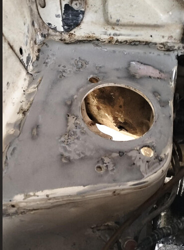

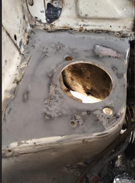

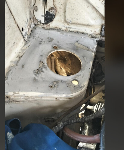

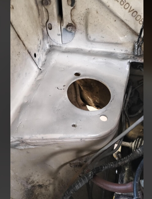

A little bit of bog and sanding today and a light paint coat to seal and see what it needs next time I go back to it.
I did do more welding and rust converter before i started bogging and sanding.
