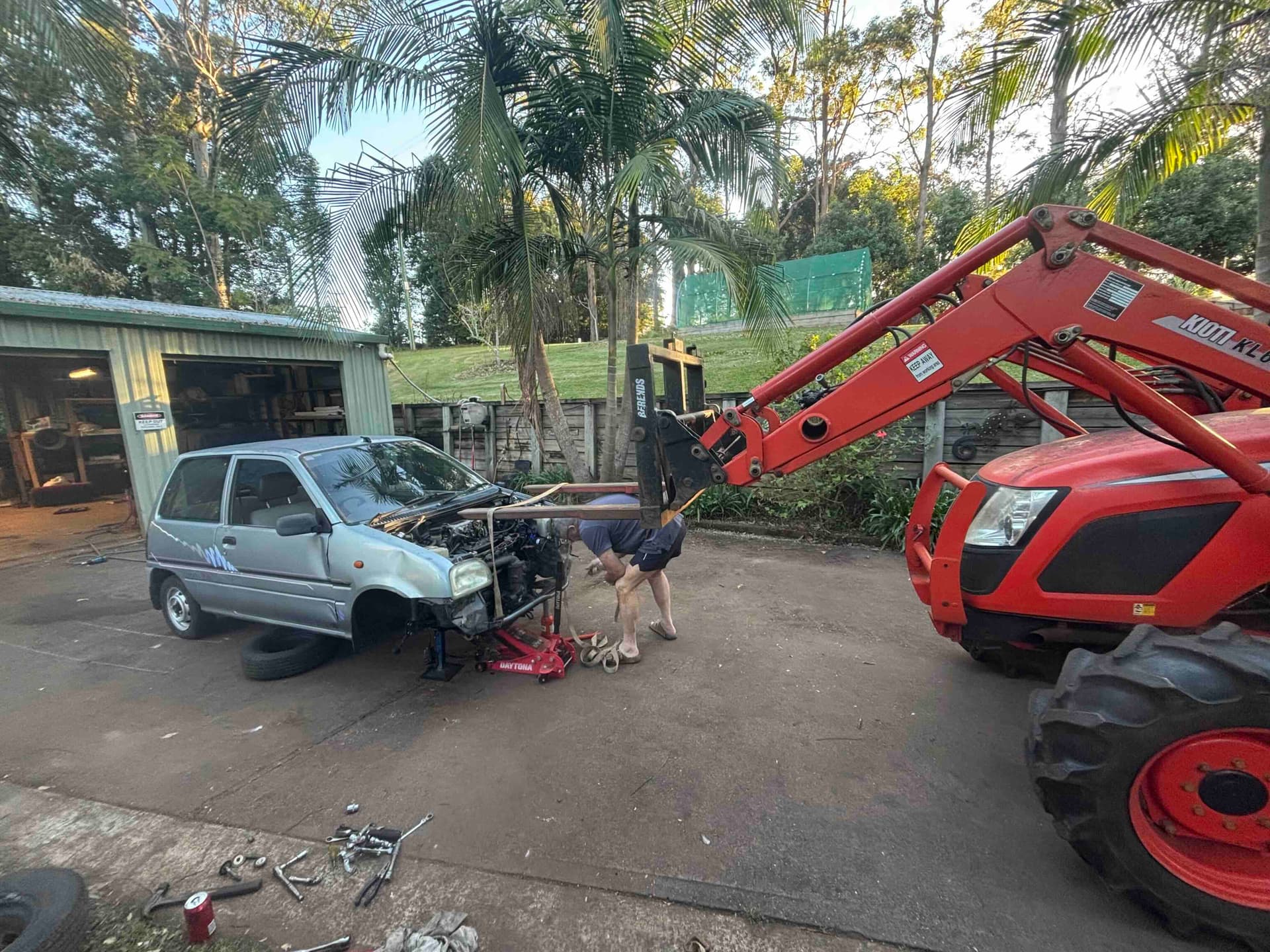

Finally got the new engine in yesterday. Still a lot of work to do from here but getting the engine in has got me excited again. One of the subframe bolt holes is cross threaded so I need to get a tap and see if I can get that moving smoothly again. Next is moving over the ECU and figuring out the wiring. And putting in a fuel regulator?

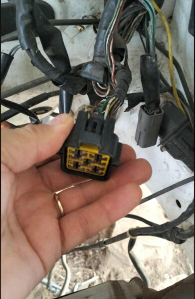

The driveshafts (driver side atleast) need to be custom or cut n shut. The wiring for the engine as I said is more basic dont change fuse box or you will over complicate things. On the sirion engine loom there will be a small green plug that doesn’t go into the ecu. That plug is the key to powering your engine. I cant remember which wires are which but with mine they were spliced into the Big Square plug in the L200 Engine bay. I will go take some pics for you soon to show what I mean.

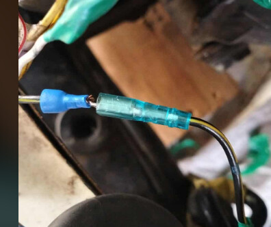

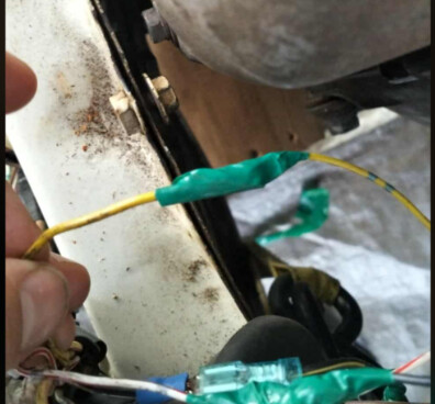

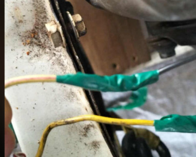

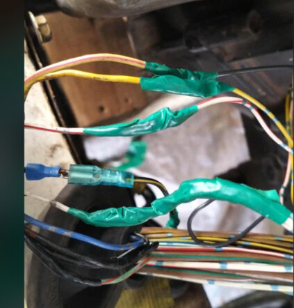

Not sure this if this will help. But here is some pics to try to help. Keep in mind that this was used for an efdet but an ejde was wired in the same way before it . Also I did not do the initial wiring on my L2 for the EJDE. When I got it it was a spaghetti mess and is still a lot like that.
If this helps great, just the colours may vary depending on your engine loom. There is also heaps on info on this forum regarding this. @144p has some good info as well as @ceiliee have some good write ups regarding pinouts and the swap.
Here is the pics for you incase it helps also.

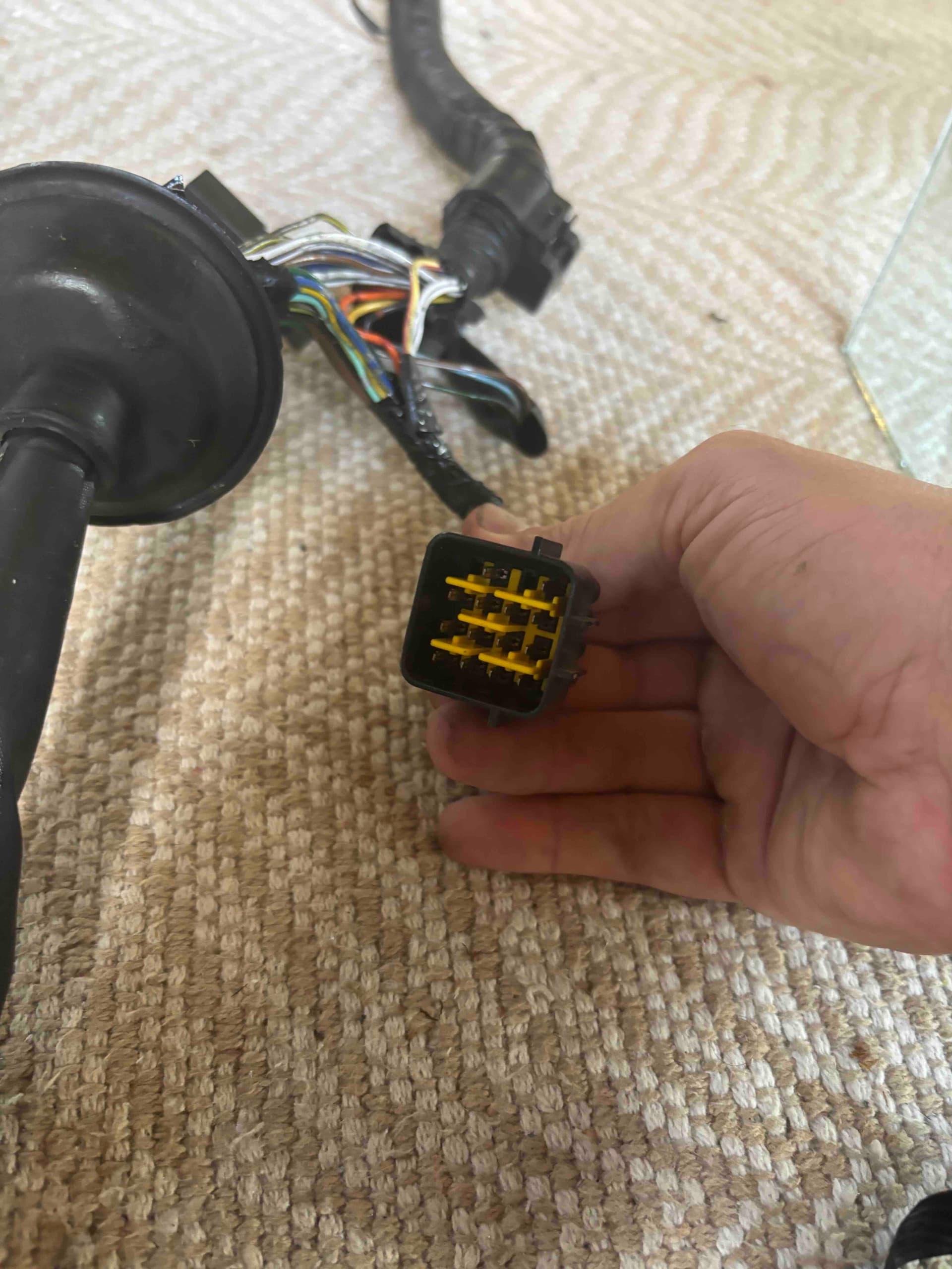

The plug you will look for in your L200 ^^^
wires on the other side of the plug (ejde side) Yellow to yellow ^^^
yellow/red stripe to black ^^^
white red stripe to white red stripe^^^
White silver dot to white silver dot (many) ^^^I believe this is for injector’s etc
Black yellow stripe to black yello stripe..

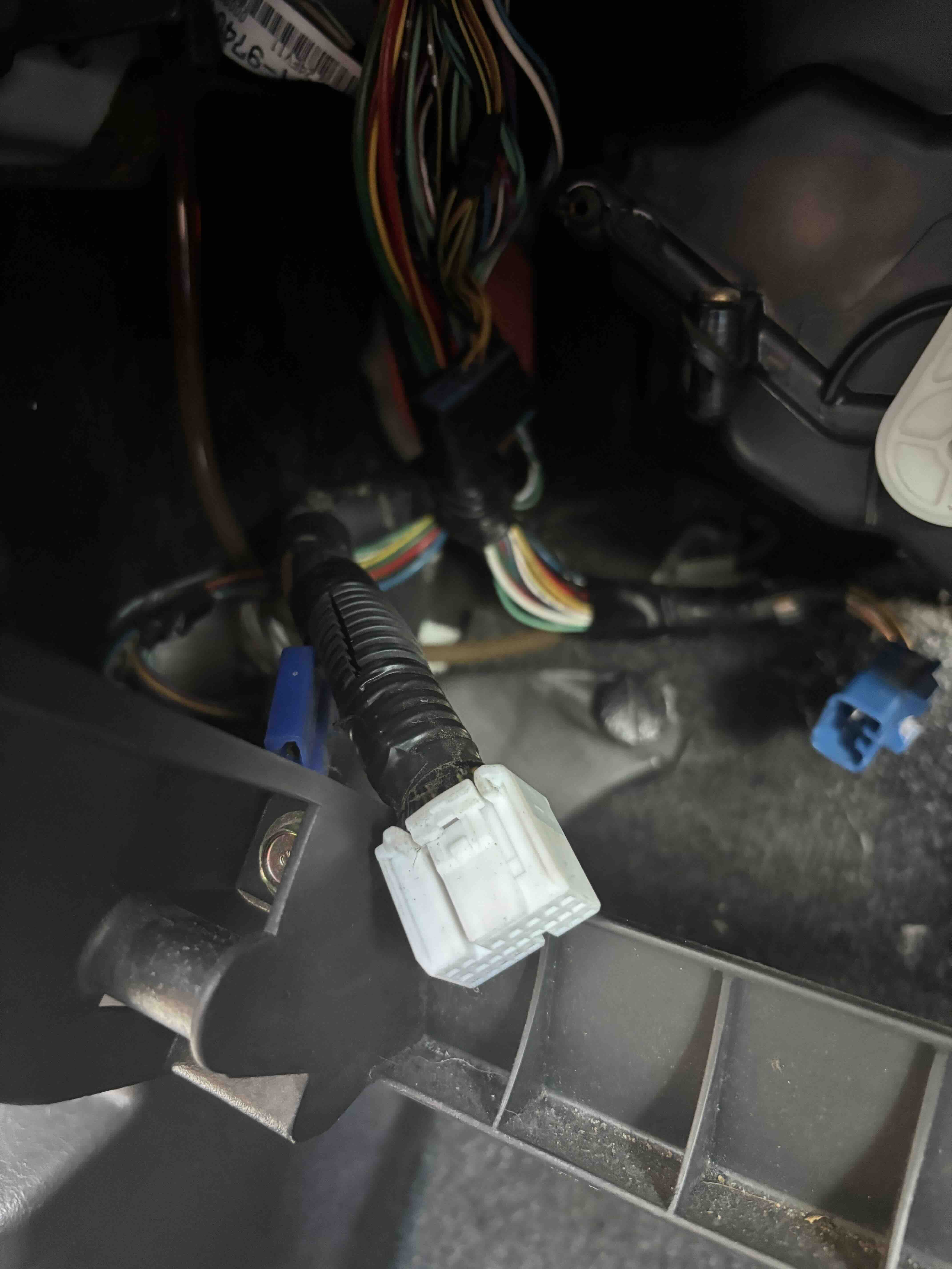

Below is a photo of the plug that I’m guessing I need to cut from the sirion so it can plug back into the sirion ecu? Wanted to check before I go cutting it.
And then basically connect to this plug from the Mira loom? So that it can plug into the fuse/relay setup in the Mira engine bay?

That wasn’t the plug I was referring to. The one that I was referring too in the ejde engine loom is a small one usually green or maybe blue in colour that does not connect into the ecu.
