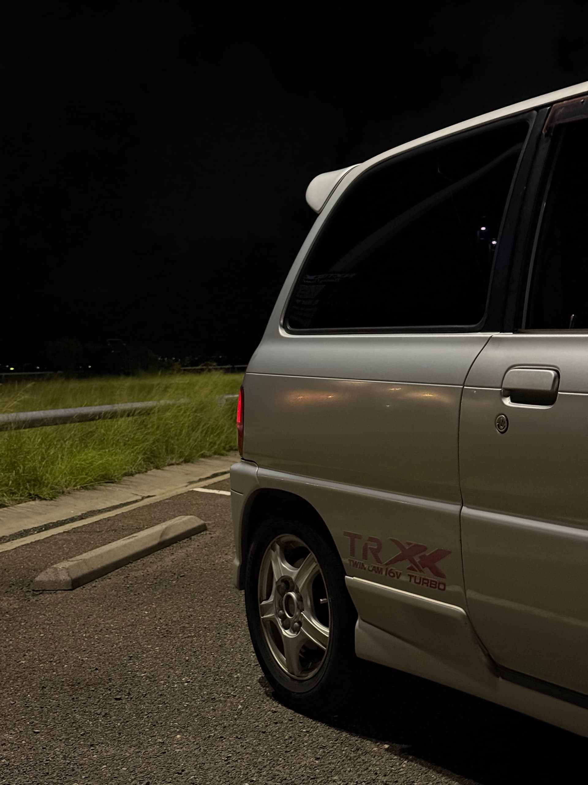

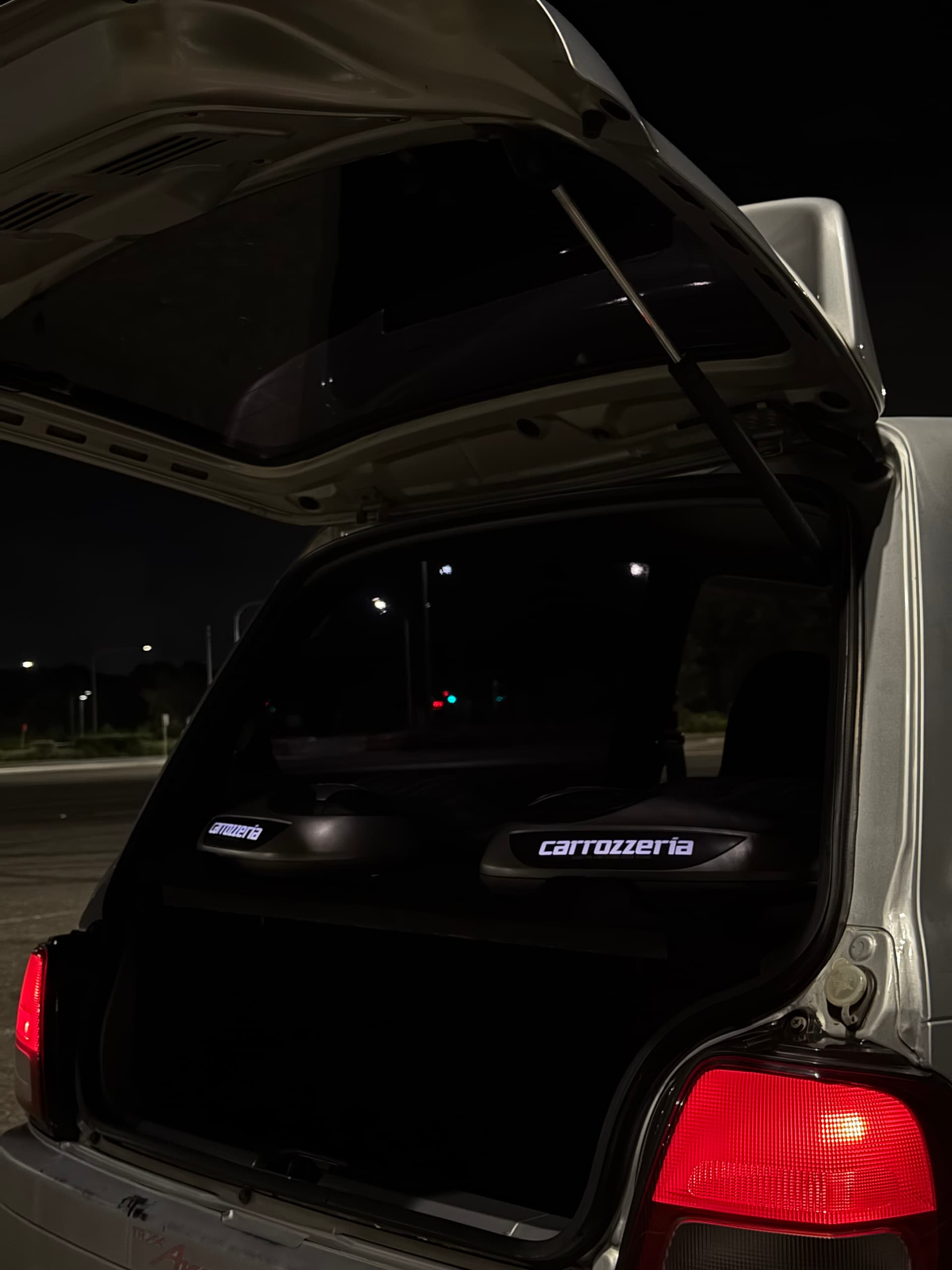

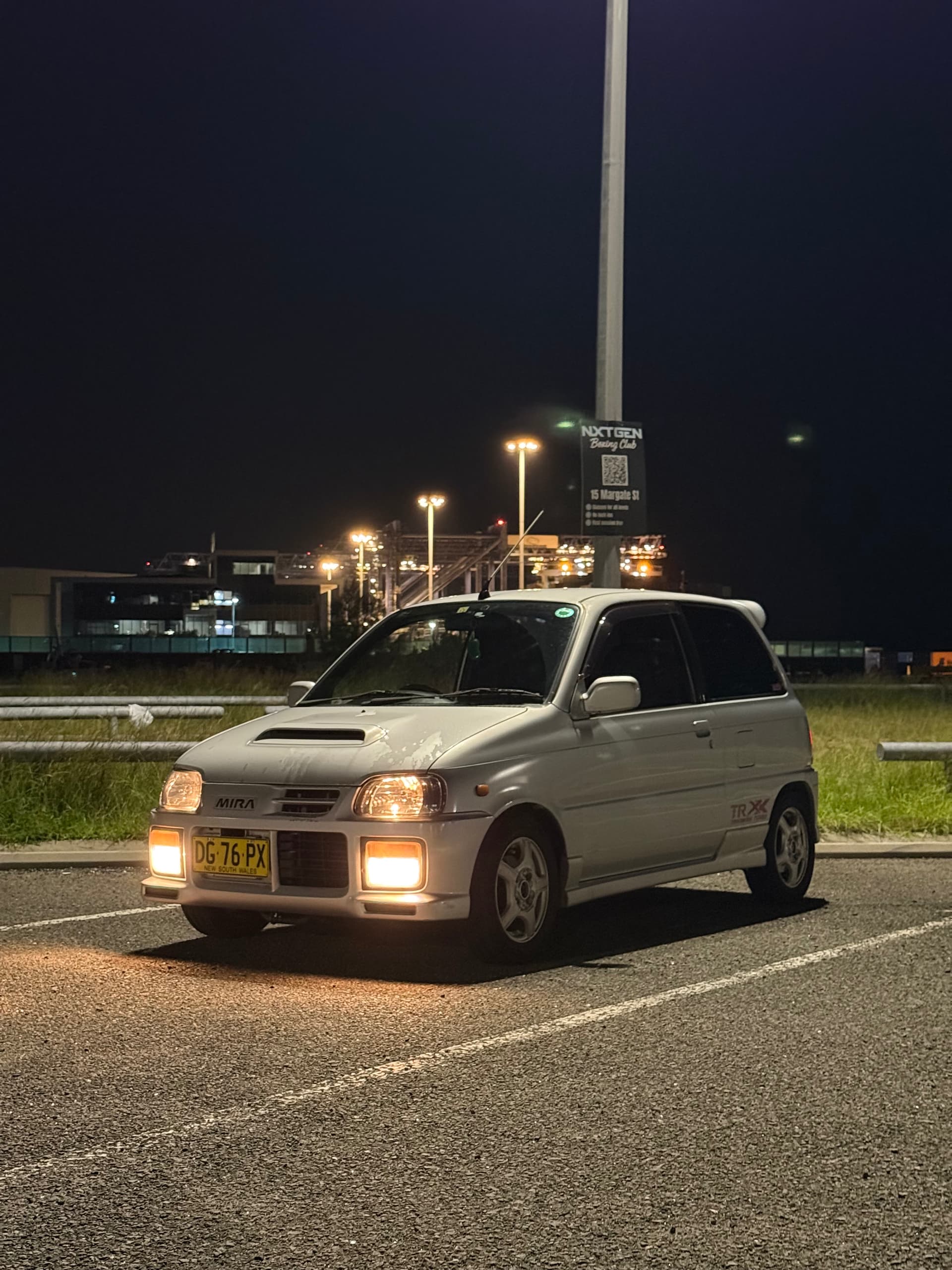

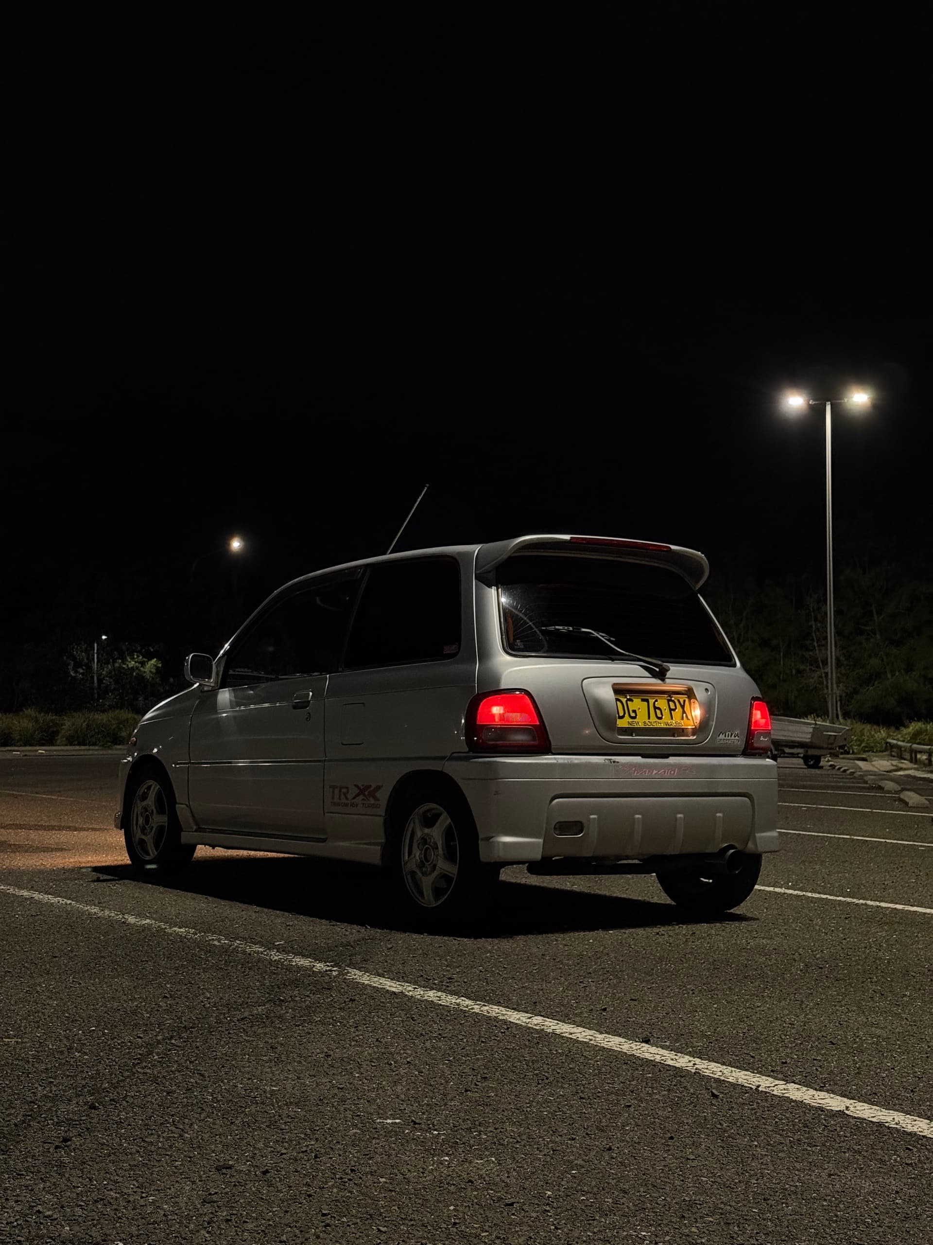

Hey everyone, I’m Tom from Sydney, Australia. Just picked up my first Daihatsu, a 1997 Daihatsu Mira TR-XX Avanzato R L502S with the JB,JL engine and I’m already hooked on these kei cars. Looking forward to learning more about the platform, sourcing parts, and restoring/modifying it properly.
Also chasing some advice from anyone local in Australia on the best places to source front CV shafts/CVs for these cars, or interchangeable parts that fit the L502S platform. Excited to be part of the LiveToDai community.
Welcome to the forum oh man your L5 trxx looks awesome.
Very cool L502!
