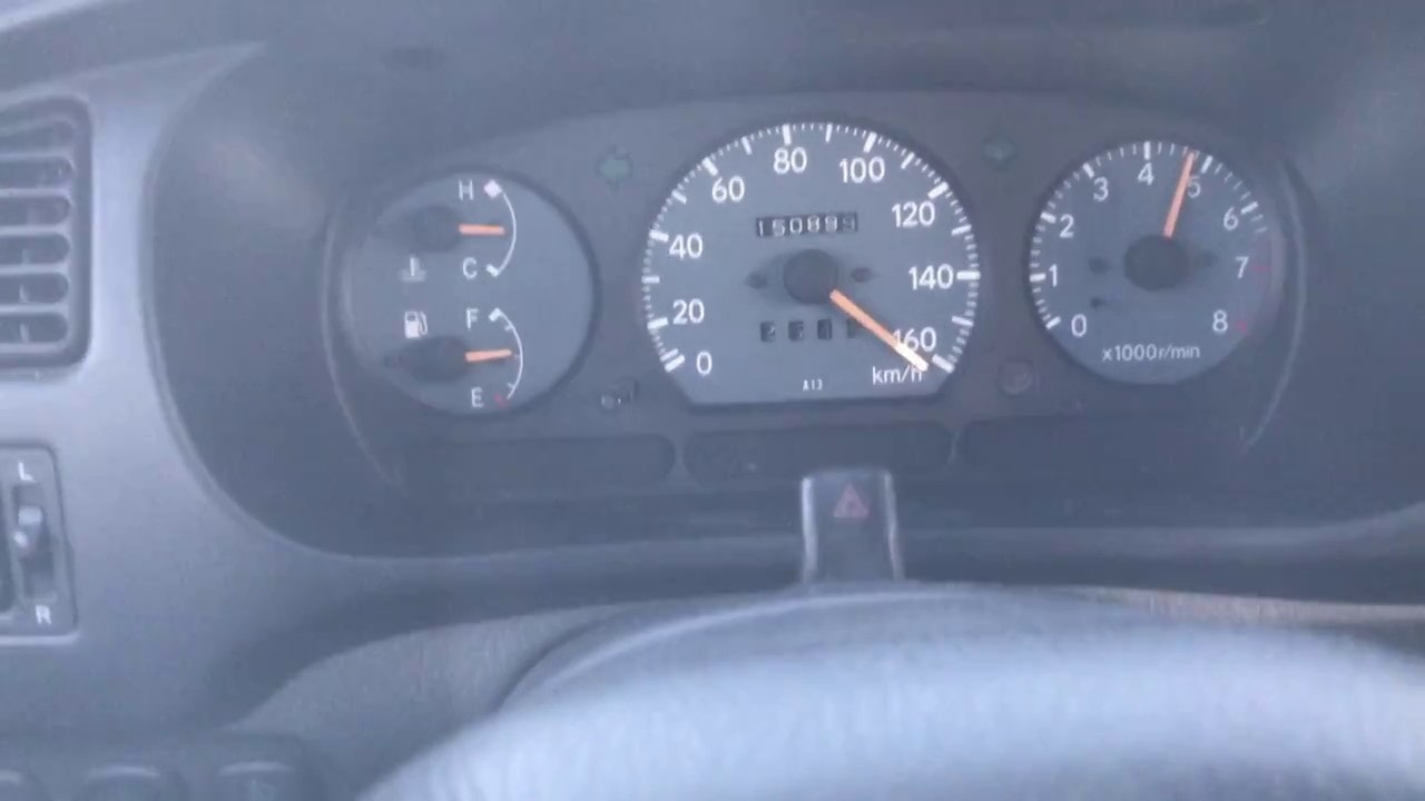

I have a 1998 Daihatsu Mira L701 with the 1.0L EJ-DE 3 cylinder.
I swapped out the original cluster with one with a tacho, unsure what car it came from.
At 100 km/h in 5th gear, my tacho is showing around 2,250/2,500 RPM.
Does that sound right, or could the tacho be from a 4 cylinder and therefore reading incorrectly?
What RPM should an EJ-DE be doing at 100 km/h in 5th?

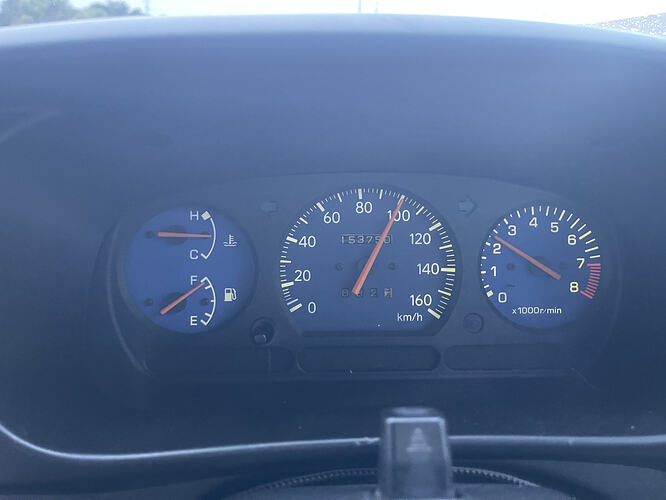

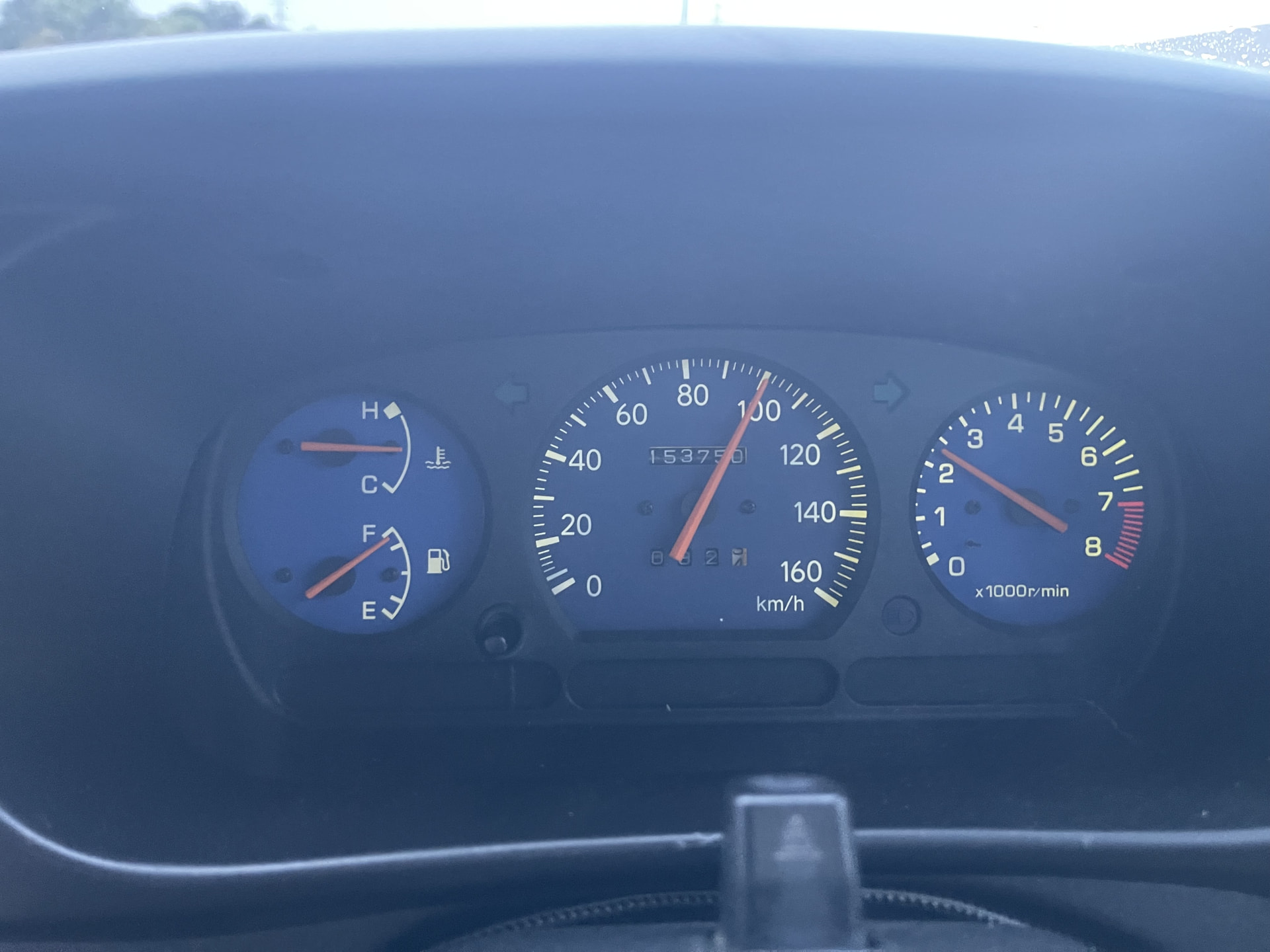

Doing a hundred in fifth, I got 2300 revs
which gearbox? L251 or L701?
is the cluster from a 4cyl car?
