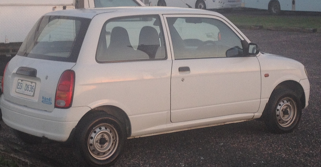

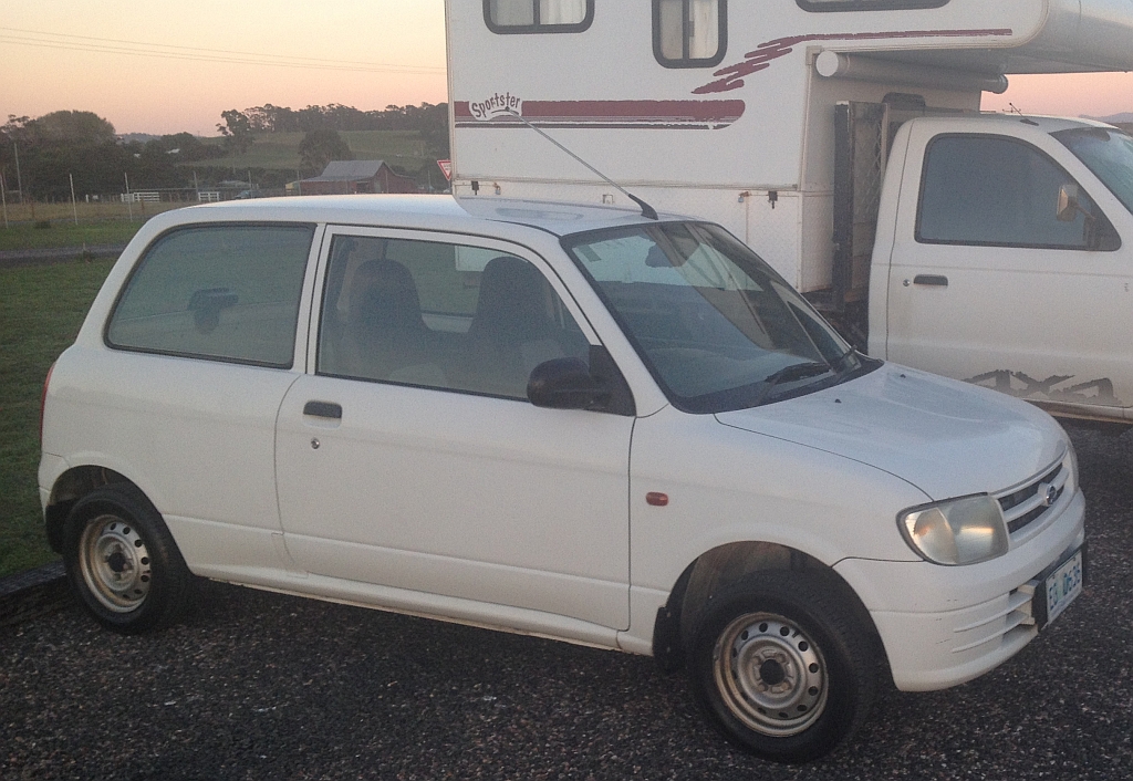

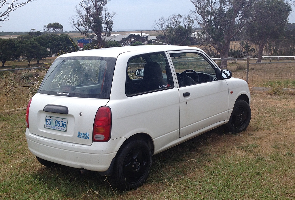

My little work car
Some like these with the Gino front and all sorts of add on. But your white L700 is, in my mind, perfect. You did say “work” car, but it could be a quick little work car that would go very much unnoticed and be a heap of fun to drive.
It’s such fun to drive. Kind of reminds me of a Mini 850 I had many moons ago. I am very surprised at the turn of speed. I will probably just keep it stock. Some little things need doing like passenger sun visor and driver’s mirror.

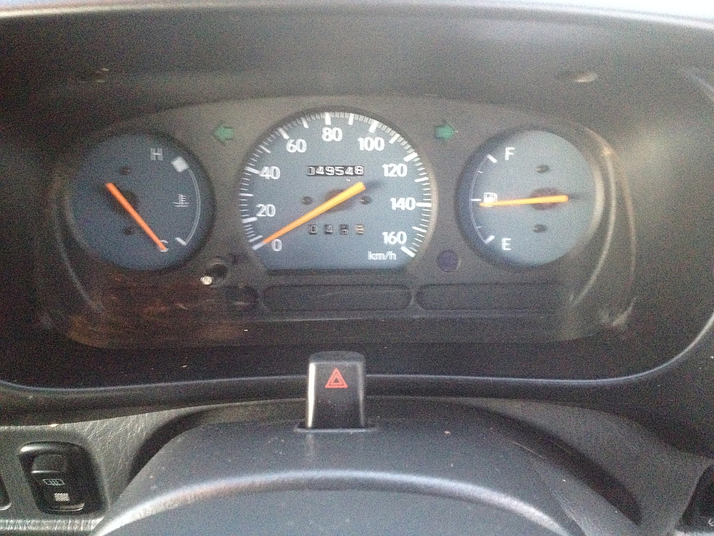

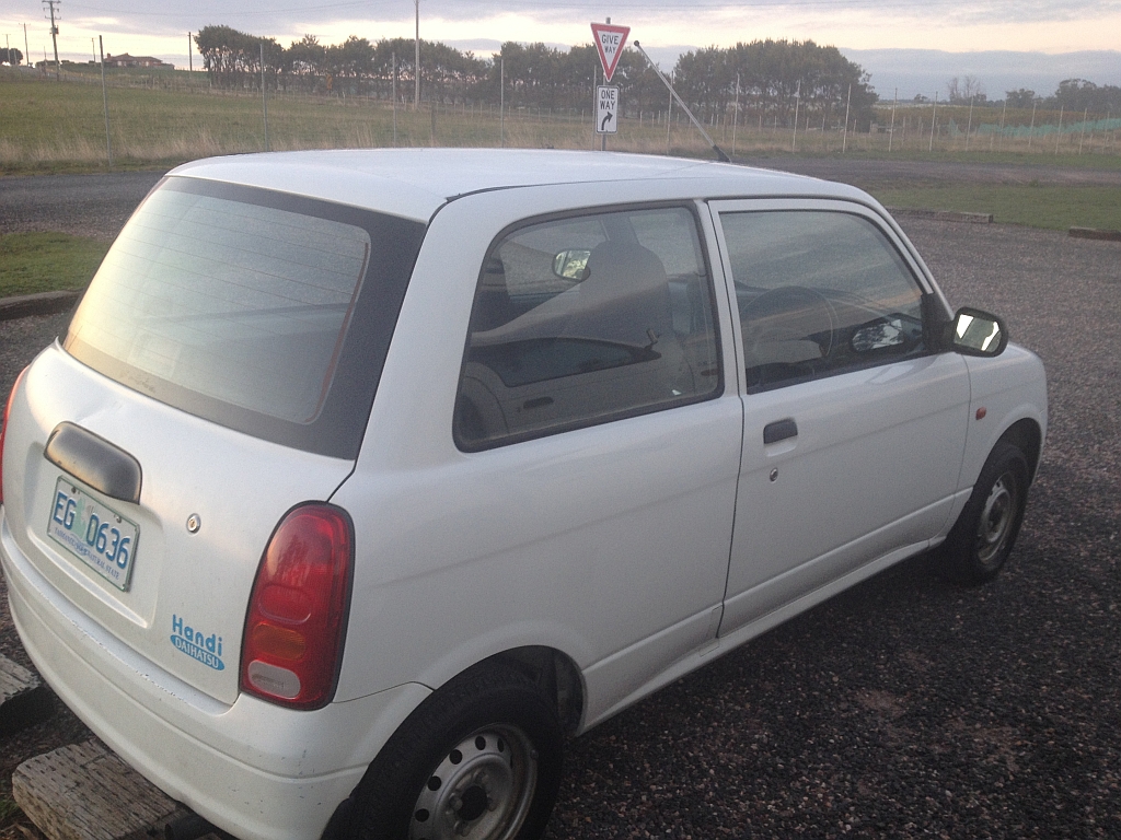

Well I have had the car for a week or so now. Changed oil and had a radio installed. The installer was amazed at the condition and said the speakers were brand new! Seems that this model came with aerial and fitted speakers. I am so impressed with how much fuel I don’t put in the thing. Just ticked over 50000ks. Done 400 ks and just over half a tank.
My right front mirror will be replaced with one sourced from a helpful wrecker in Braeside. @Mr_Gormsby I wonder how to change the spring rate or to drop the rear. If anyone can point me in the direction of which rear shocks I need I would be grateful.
A couple of mates laughed out loud when they saw me roll up in it. Little do they know how much I laugh when I am behind the wheel.

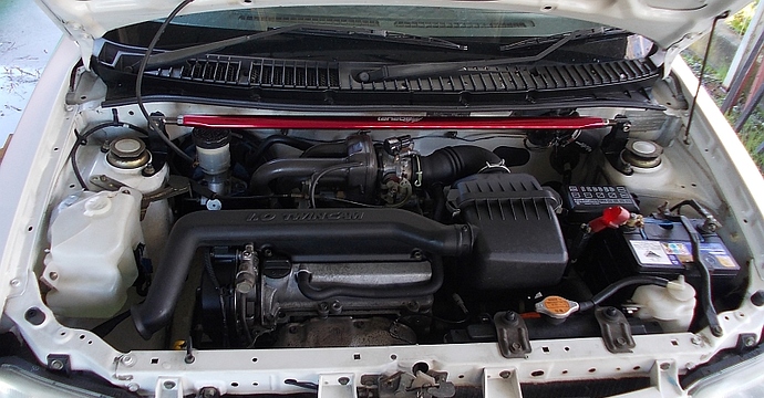

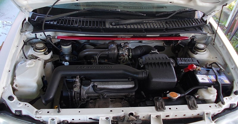

So added a strut bar. Makes it feel a bit better in corners.
I see in one of the threads here that a Copen rear sway bar might be beneficial.
Will any year model fit? The Handi is a 1999 model.
