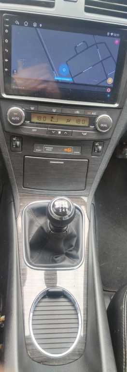

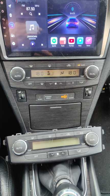

midconsole cupholder in:

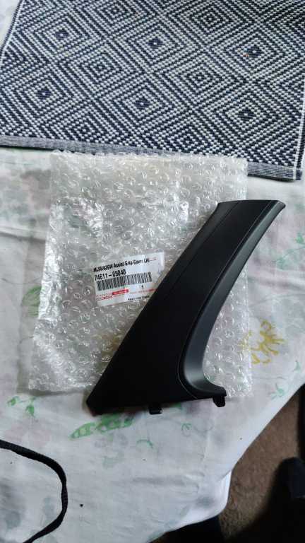

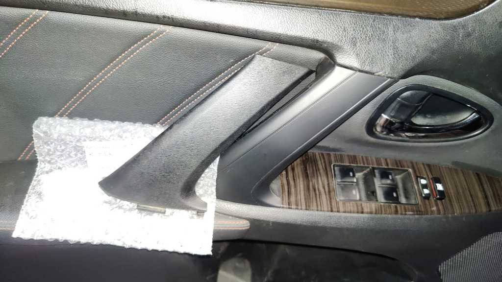

Door trims wont fit on 2009-2011 models waiting on 2015-2018 door panels they do fit

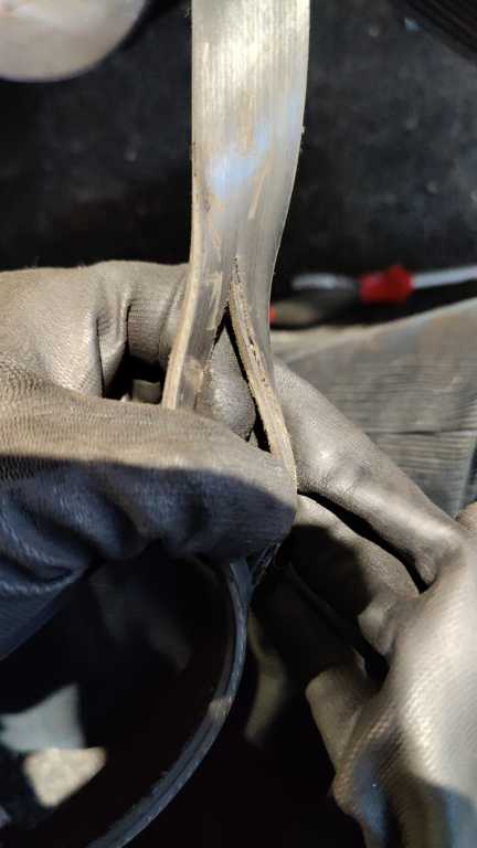

I also replaced the auxiliary belt which a p.i.t.a. due the space of this huge engine.
The old one when I was removing it the belt split in 2 pieces on one spot so well overdue.
318000km on a factory belt is very good. I used the same brand as the factory brand so longevity of the belt is guaranteed.
Tensioners and pulleys are fine

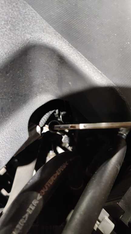

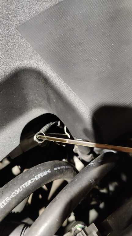

The tensioner is super tight you need a extension wrench go get it off.
I blocked the tensioner like this as I am not with 2 persons today so I need to use this way to install the belt

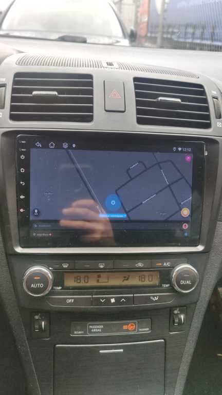

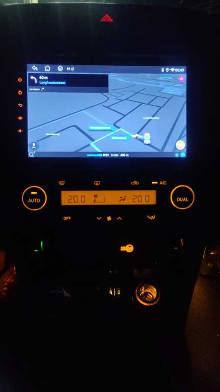

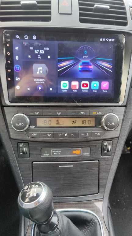

I have also received my android radio
upper air vent without cracks and broken vents
on the right side of the picture you can also see the door handle trim pieces
Installed android radio. Android auto is included.
Before:
After:
Comparison 3 gen of Avensis T27
Installed Waze:

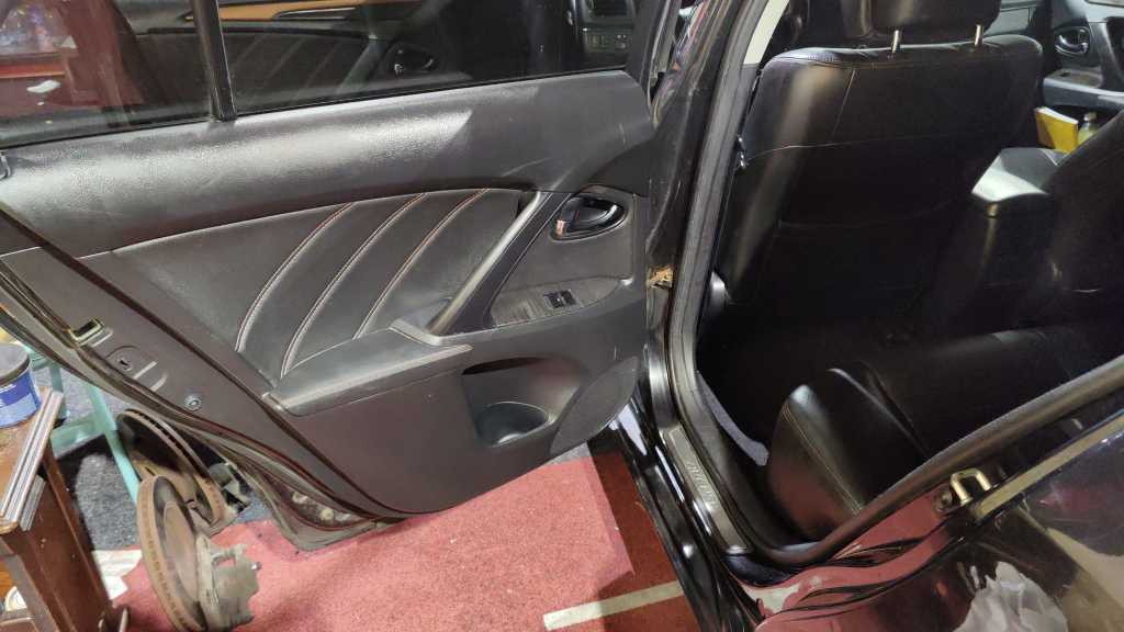

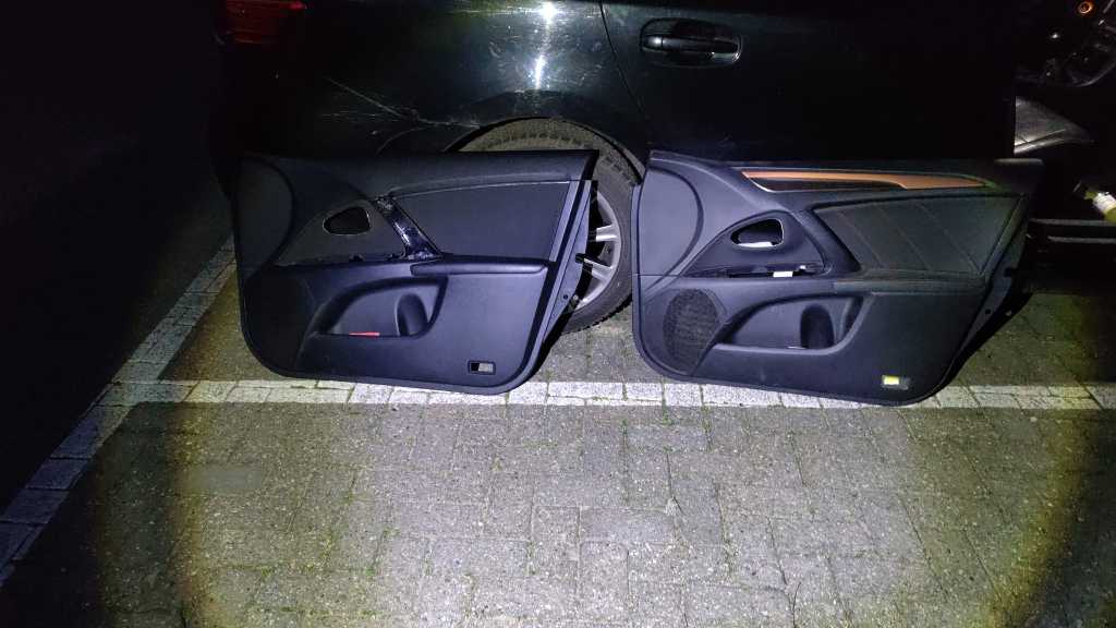

Got my 2018 door panels in:
So the Avensis is now:
gen 2 look outside
gen 1 engine/drivetrain/suspension i.m.o. best one
gen 1 2 and 3 interior combined
About 1hour to install all 4 incl. unpacking

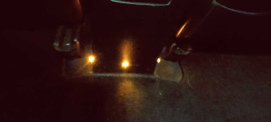

installed also foot well lights led amber:

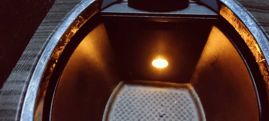

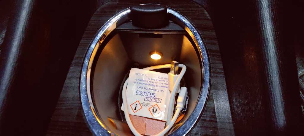

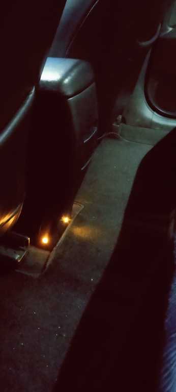

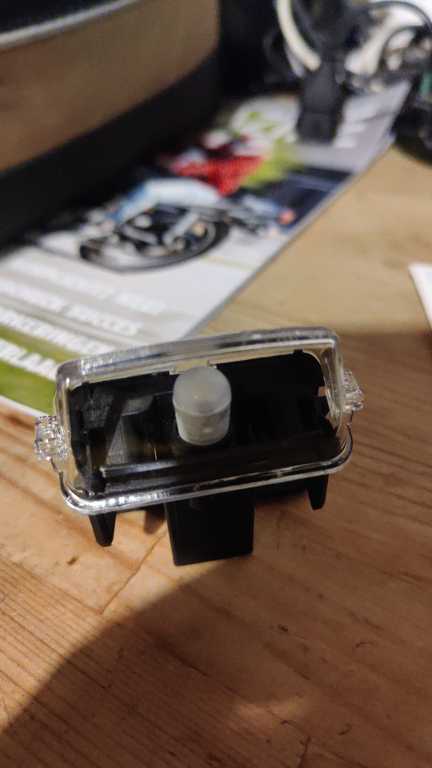

installed my rear foot lightening and cupholder light:

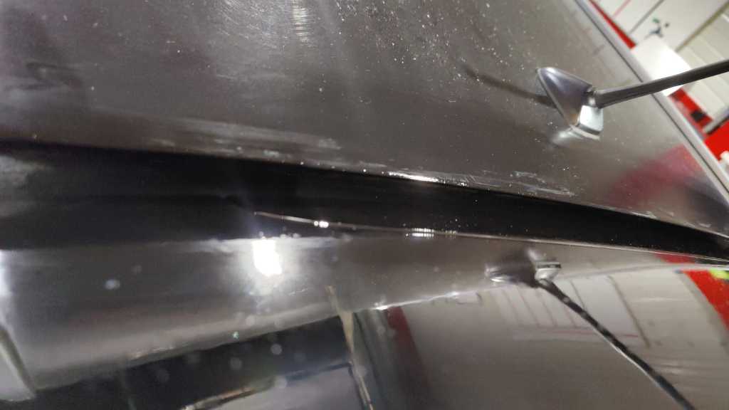

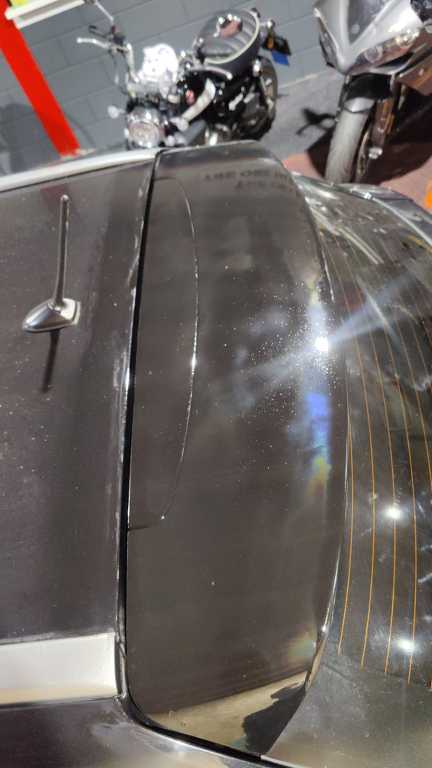

I repaired the flake rust spot behind the rear spoiler.
Its not the best but better than red flakes.

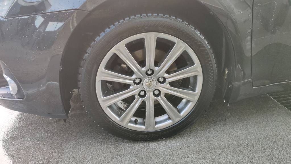

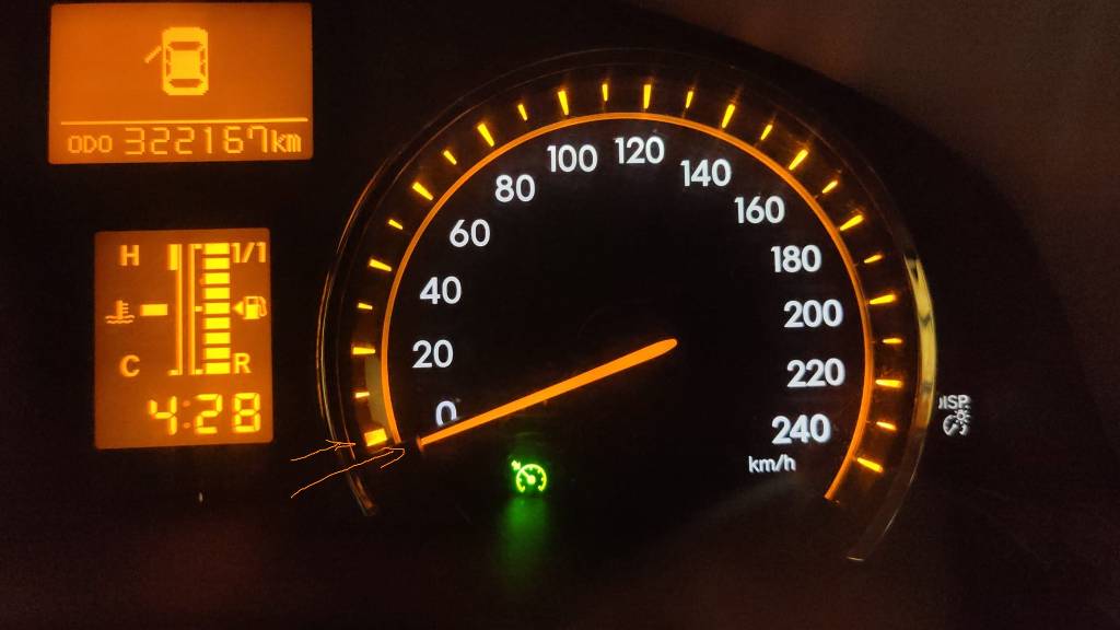

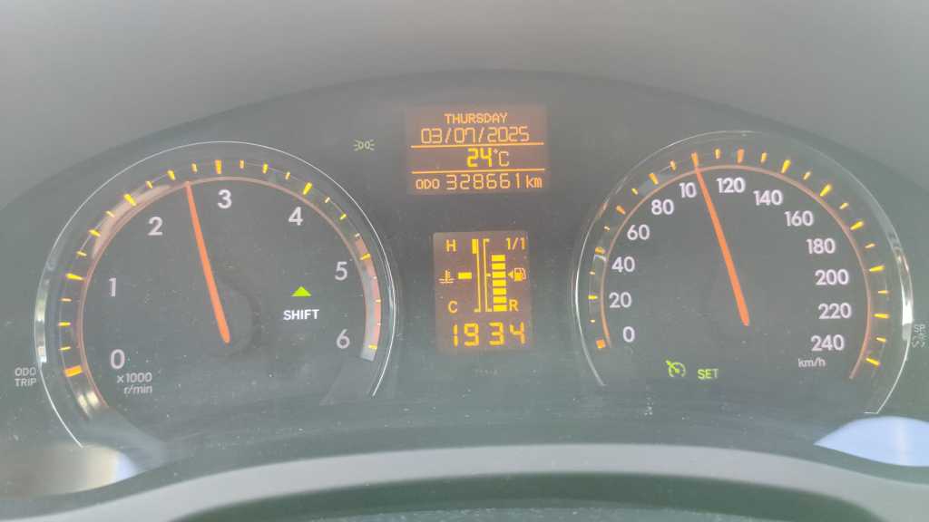

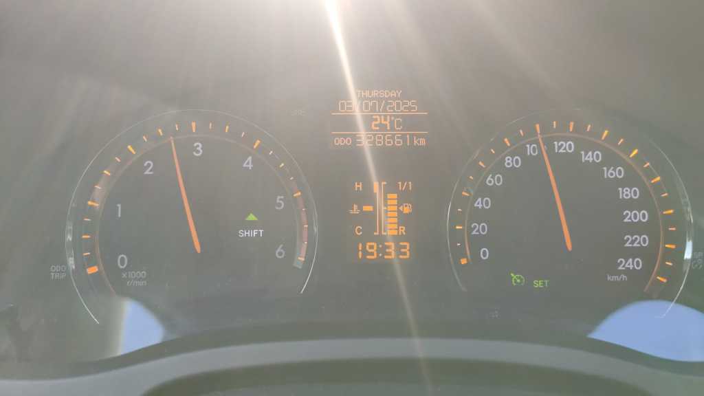

Adjusted speedometer according to 17inch wheels
After putting everything back
0-60 km/h - GPS accurate
60-100km/h +4Km/h over GPS
100+ 5-6 km/h over GPS

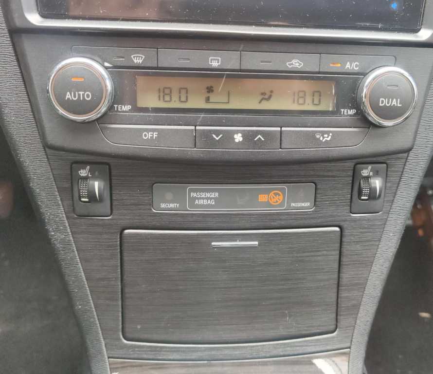

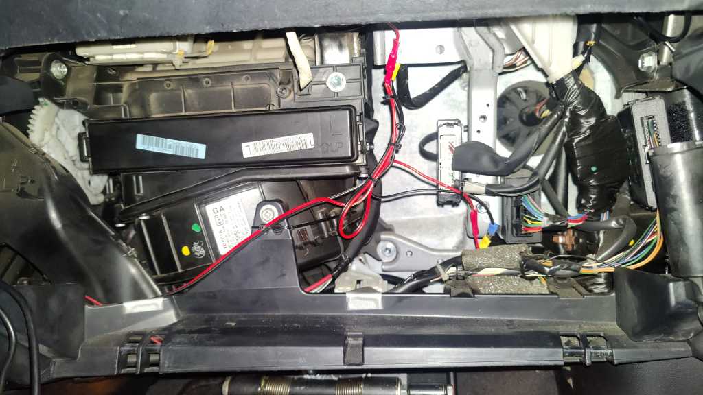

Installed heated seats button

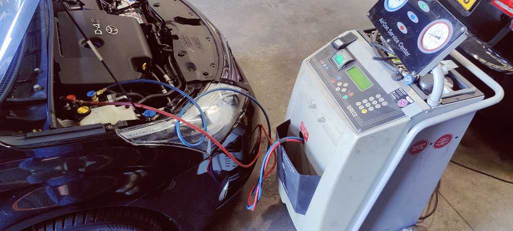

A/C is also refilled. It was 150gr/450gr so now its working perfectly.
Need to make/find the loom to install on the seats
Left switch is different colour
I wouldnt mind, Much easier to know which one to touch

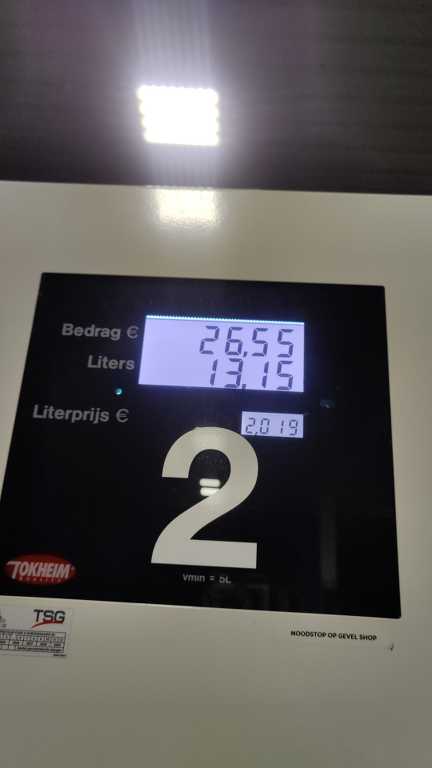

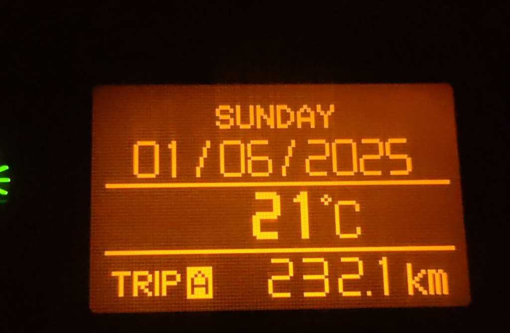

Fuelled up again.
232km/13.15L = 1L:17.64km
5.6L/100km
Almost close to oem consumption which is
5.5l/100km

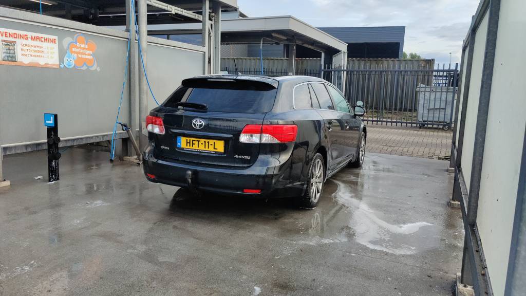

Washed car clean. So many bugs
