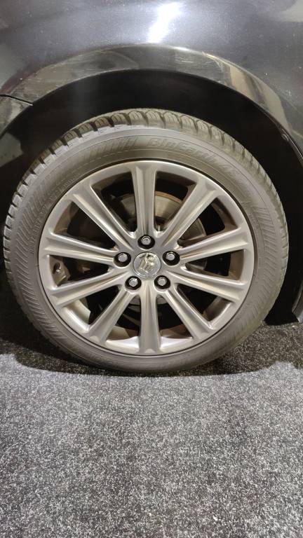

OEM wheels back on
OEM Lexus NX wheels, need other tyres they are too high

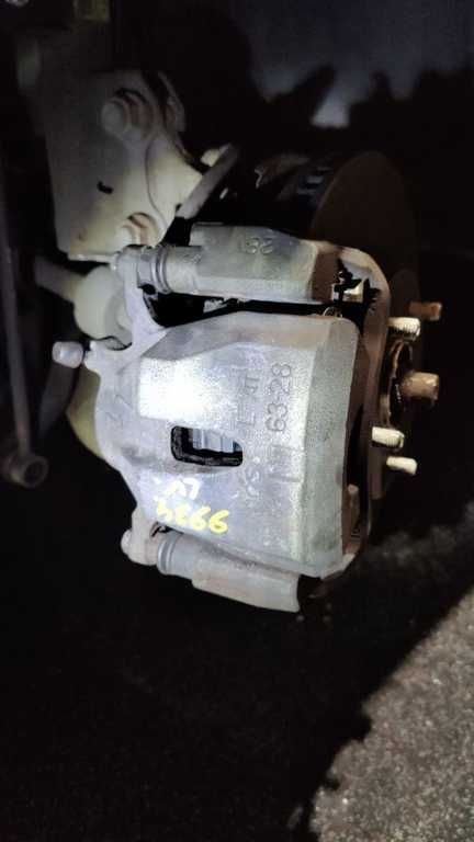

Got my brake calipers in:

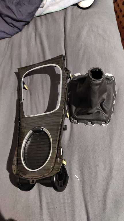

Replaced my midconsole trim as the old one had stains you cant even remove with scotchbrite.

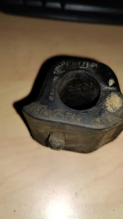

I also wanted to renew the sway bar bushings on the subframe unfortunately they come in different sizes so I will wait again.

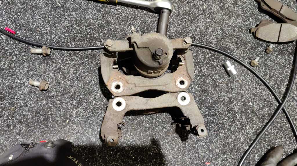

I also measured the bolt holes of the RAV4 brake calipers and they are identical:
24.2mm vs 20mm
Upgraded front brake system to Advics 296mm. Its from 295 to 296 but, thickness much thicker compared to whats on the car. Needed for towing so more heat dissapation

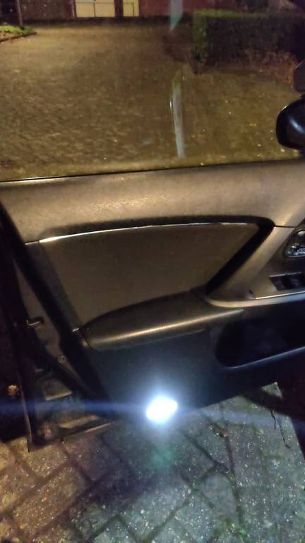

I also installed courtesy light LED
